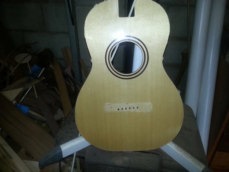

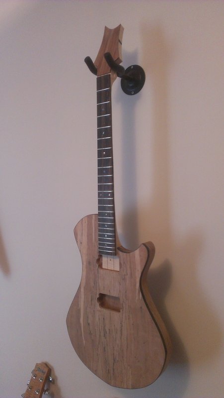

Everyone has their moments. Here's my first one for this year
Sometimes once you carve you find things you don't expect, for example in this Sassafras top there was a small hollow cavity under the surface.
I carved through the hollow as it wasn't very deep, but then I wasn't happy with the resulting shape of the carve. QC steps in, cuts it up and I've got some new timber on the way that is even better than what I cut off.

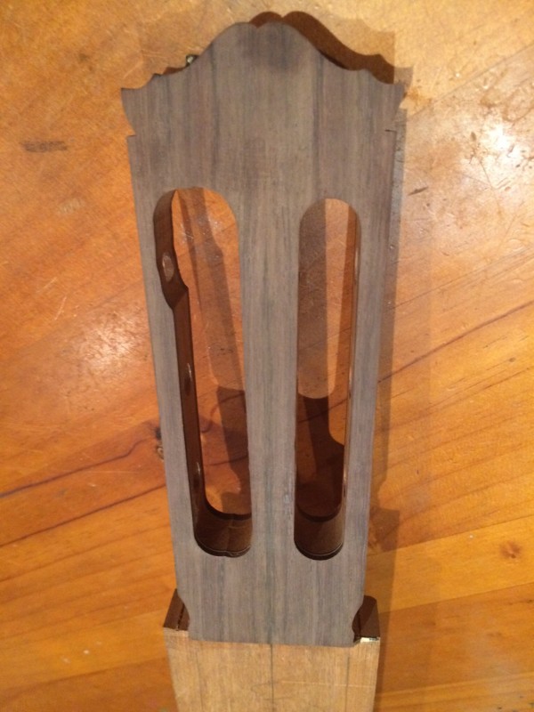

Post by Wayde Christie » Wed Feb 19, 2014 11:47 am

Wayde Christie
Re: Guitar disasters forum? Build tragedies maybe?
Ask me why the dowel is in there too :)
Post by kiwigeo » Wed Feb 19, 2014 11:50 am
Wayde Christie wrote:Ask me why the dowel is in there too :)
Been there done that.
My gaff was not actually putting the tuners against the side of headstock to check fit. With the holes drilled I "discovered" that the tuner plate would end up sticking 10mm past the end of the headstock.
The router cutter "nick" is easily fixed. Plane off the IRW rear veneer and re-do it. If you're anal like me...re-do the upper veneers as well. The nick in the side of headstock....it's going to end up covered by tuner plate so I wouldn't worry about it.
Not as big a disaster as it first appears.
Were you routing holding the router or was it done on a router table? It looks like you tilted the router a bit and ended up with the nick.

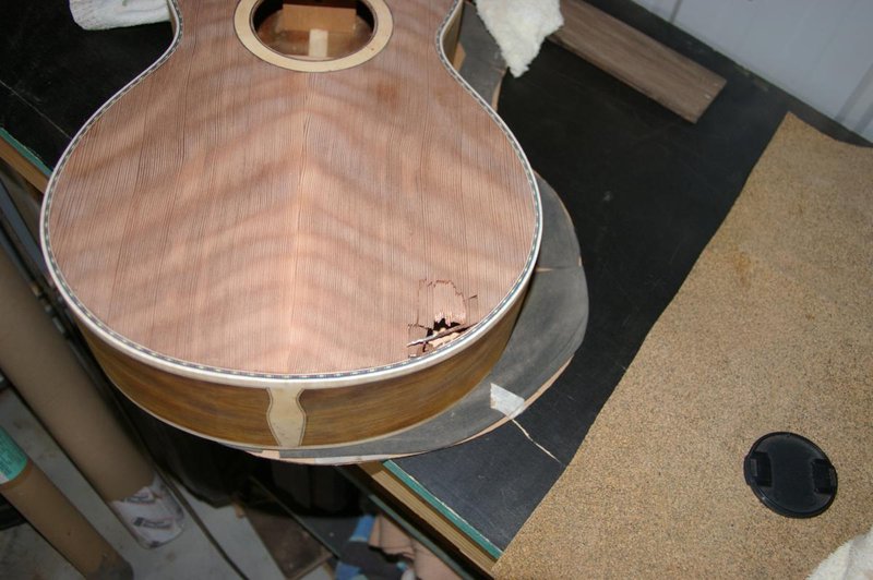

Wayde, I don't usually let anyone know how it happened....I just accept that it did!.....still not very nice when it happens....here is one of mine and the story of the "save"...
viewtopic.php?f=1&t=4181&hilit=accidents+happen&start=0

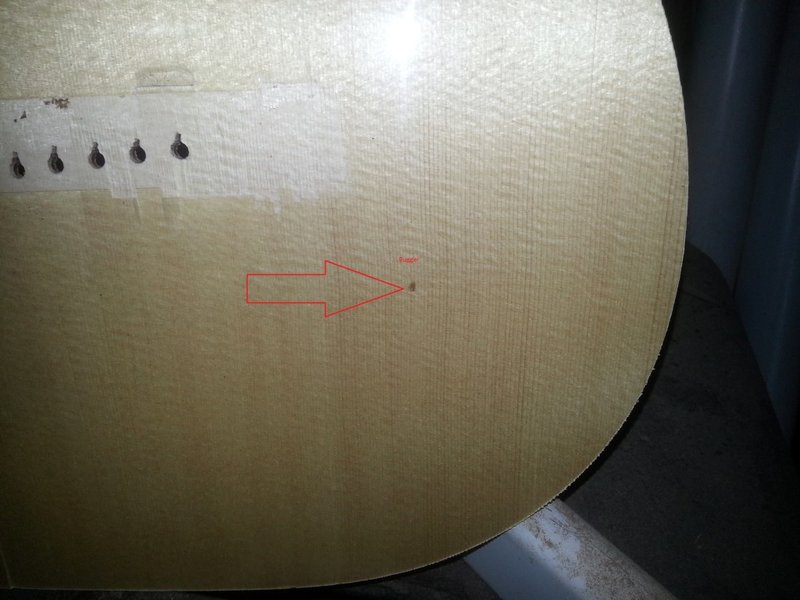

Post by Bob Connor » Sat Feb 22, 2014 6:09 pm
This happened last week.
A screw was protruding through the saddle slotting jig and punctured the top.
Routed the top off and built a new one which was sprayed yesterday.
Bugger.

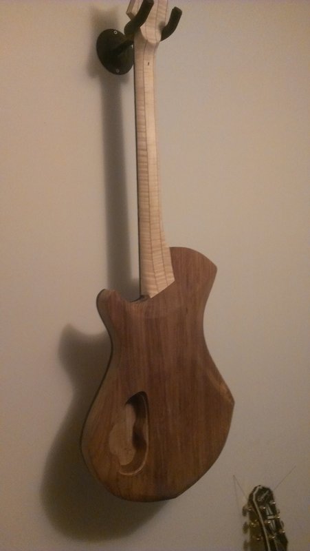

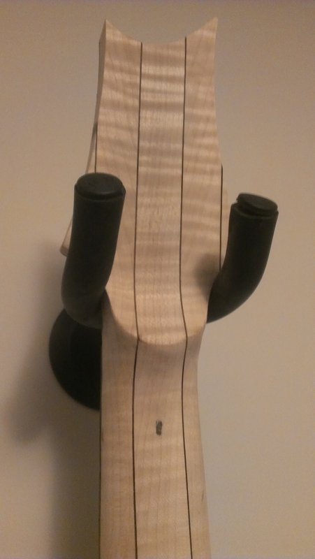

i have been putting together my own design of a single cut guitar (yup its electric) and i am VERY excited to get it done. I was carving the neck and I got a bit greedy with the thickness. I love thin necks (the thinner the better) and I should of stopped at 19mm but...i wanted 18mm...so file, file, file away until...bam!
super happy with the shape
back carve is awesome
beutiful flame maple neck...and a truss rod :(
yup...thats the truss rod channel...from the BACK of the neck! :cl
what a dolt
totally thought i had the measurments exact. 6mm fretboard + 10mm truss rod channel = 16mm right? thought i had room for an 18mm neck :?
anyway...ripping it off an making a new one. thank buggery its for me and not a customer!

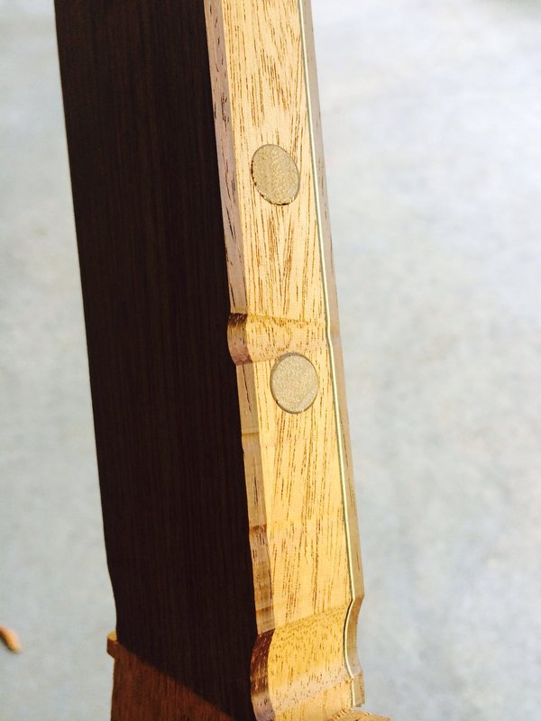

Post by Wayde Christie » Thu Mar 13, 2014 9:41 pm
When a bearing on a router bit dislodges.
Post by kiwigeo » Thu Mar 13, 2014 9:50 pm
Wayde Christie wrote:When a bearing on a router bit dislodges.
Oh shit!! :shock:
