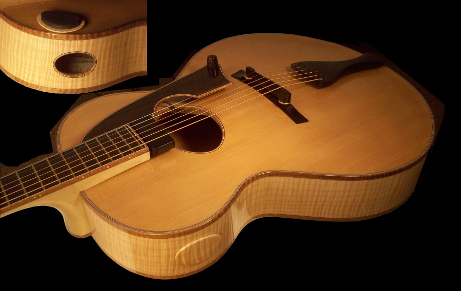

I did one a couple of years ago.... used a wide open X (about 86 degrees... close to your dwg. by the look of it) and added a transverse brace under the pickup.
- 1102 fr body-full bk.jpg (129.2 KiB) Viewed 9449 times

Well Tod I'm not totally familiar with falcate bracing but i believe it's mainly designed for use on steel strong flat tops and not suitable for a carved archtop.The main thing that puzzles me is how Bob has used parallel braces in the example I've shown and got it in the position he recommend in his book, let alone anywhere near the bridge posts.
Dave, magnificent looking guitar, well done mate.
how did it sound compared to a similar build with'F'holes?

Thanks Rod. Yeah, you have to fiddle a bit (including soundhole placement) to hit all your marks. I expect Bob altered plate thicknessing down the center to allow for nonstandard placement of parallel bracing.
The guitar sounds nice ... very rich & full ... less of a mid-range bias than an f-hole body, all else being equal. (One contributing factor is the inevitable lowering of the main air resonance using this soundhole configuration vs f-holes .... about 110Hz on this one vs the more typical 130+ range.)
I also put in a capped soundport, which is nice for the player.
