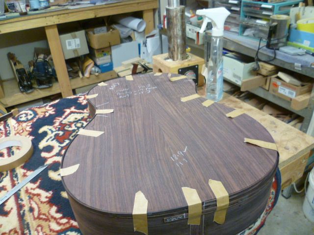

he last few days have been spent mainly tap testing and playing around with body resonances trying to get a feel for trimming of same. Next job will be installing binding.

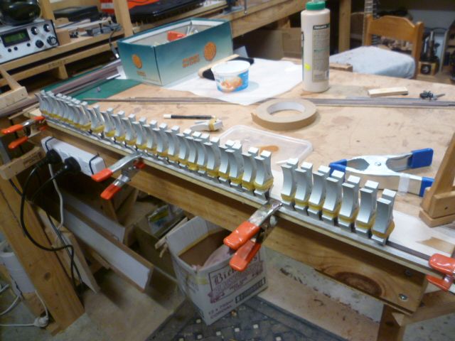

Nice clamps . you used other ones on the kerfed lining .
Do these extruded Aluminium ones not work as well for kerfing ?
I thought they were designed for the job for some reason which I cant remember ?

auscab wrote:Nice clamps . you used other ones on the kerfed lining .
Rob,
The aluminium clamps are supposed to be lining clamps they came from Blues Creek Guitars. Unfortunatelt they dont have quite enough clamping power for that purpose so they get used only for light clamping duties.

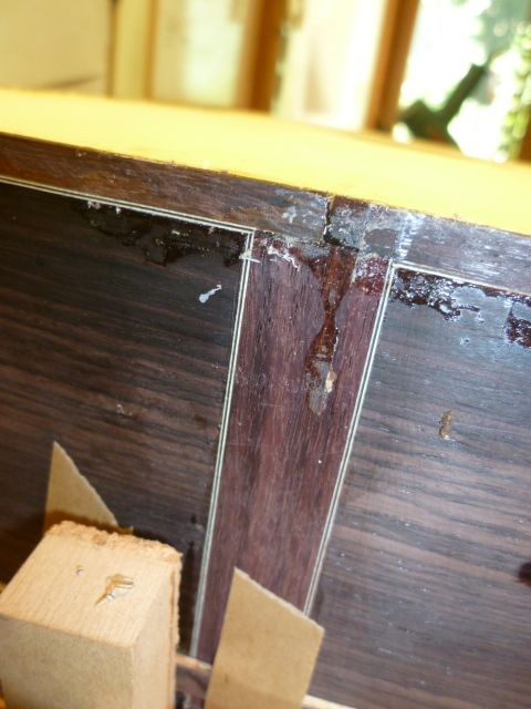

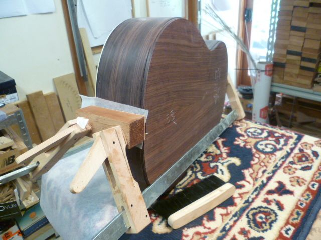

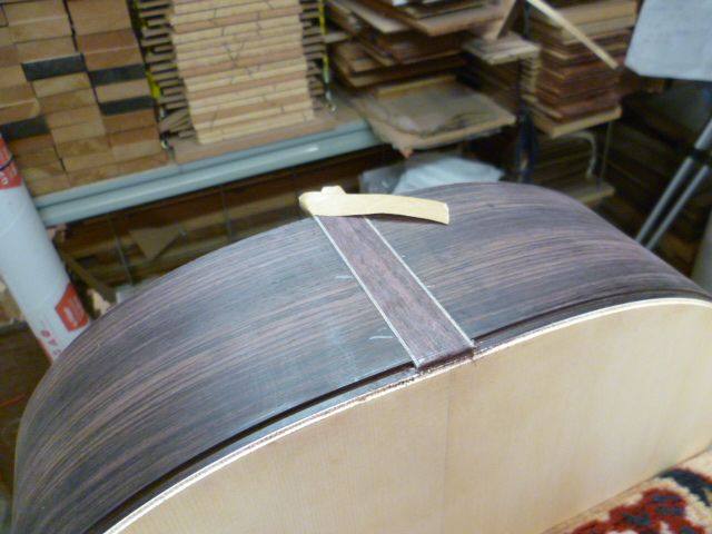

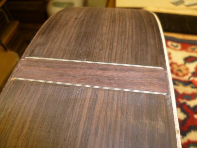

The butt strip is in and I bent up the bindings on the bending jig. The bindings needed a bit of a touch up on the bending iron to get a good fit.
Butt strip glued in.

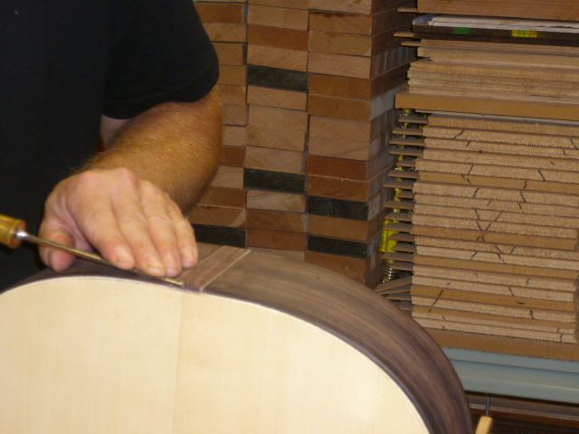

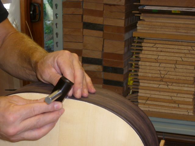

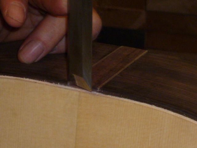

Trimming the end of the butt strip and cutting a 45 degree chamfer on the purfling to match a similar chamfer on the purfs on he bottom of the bindings. I trim the end of the butt strip using a Schneider gramil.
Back bindings ready to go.

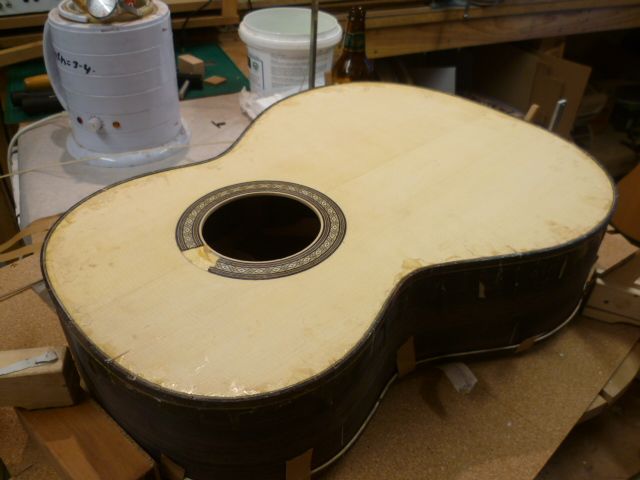

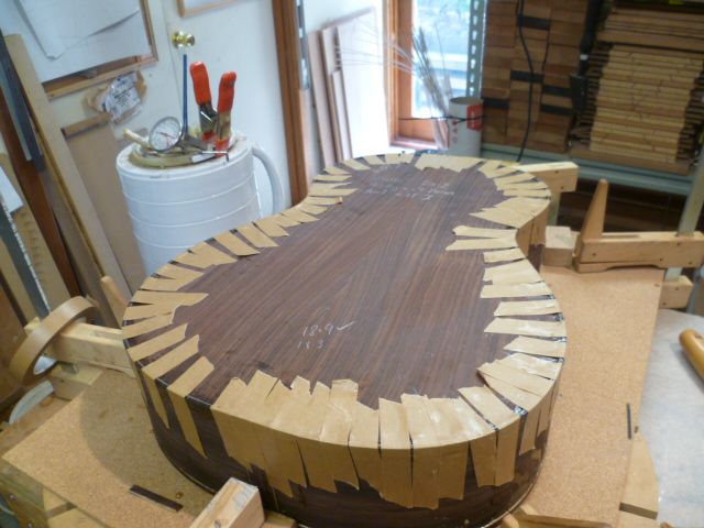

Bindings all done. I use hide glue for my bindings as the ability to undo the joint with a bit of heat is useful for adjustments and if you need to go for lunch halfway through the job.

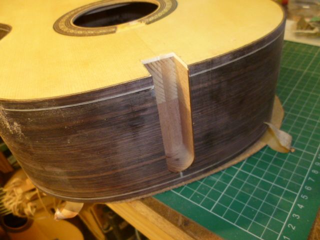

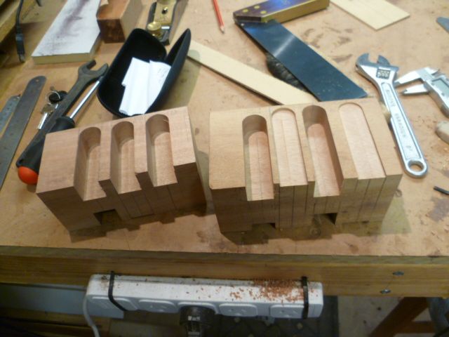

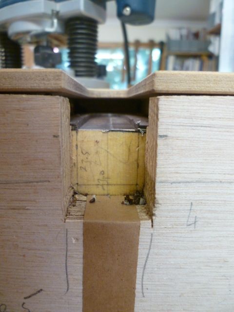

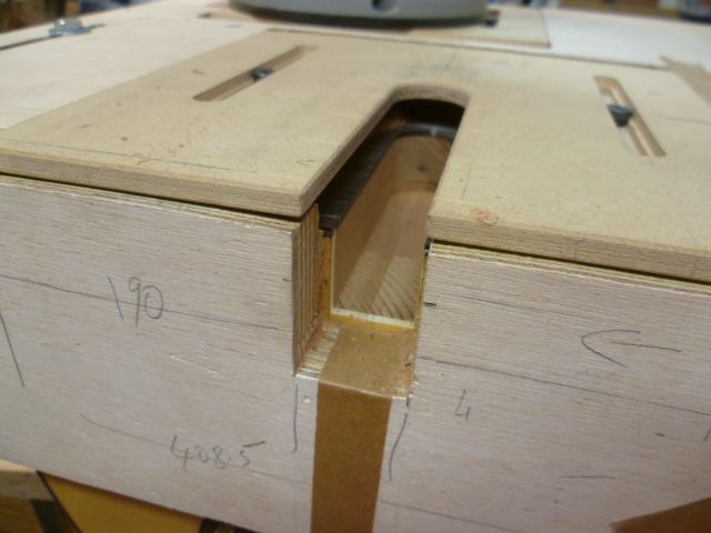

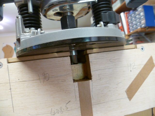

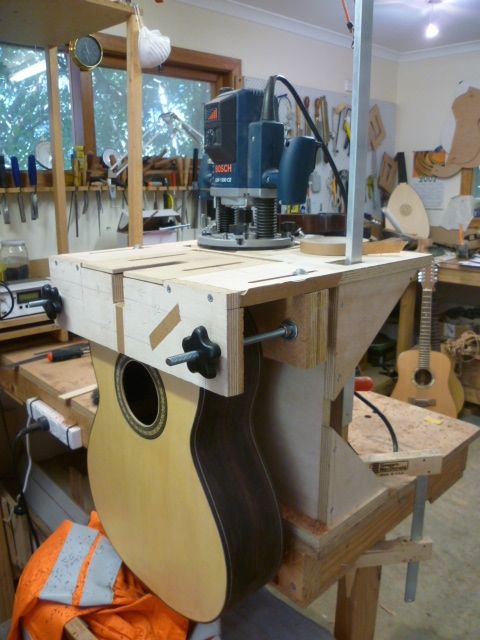

Today I finally gathered up the courage to cut the body mortise with my new LMI/Robbie Obrien neck tenon/mortise cutting jig. The jig is designed for a router with a guide bushing fitted. Ive had some major problems with getting guide bushings for any of my routers (7 of the bldi things) that are the right size and dont shift position halfway through a cut. I finally went with the Bosch and a standard Bosch guide bushing. Not being the trusting type I did a few test cuts...well actually at least 10 just to make sure everything was working ok.
Body clamped in the jig. Note chair underneath as insurance in case the guitar falls out of the jig (it didnt).
Checking positioning of the cutters on the mortise markings. The cutter is never perfectly centred in the bushing ni matter how much you f**k with it so this is the best way to make sure the cut is accurate. I made a short cut at the opening of the mortise and then re-checked position of the cuts before doing the main cut. Cutter is a 1/2" straight double flute cutter and the bushing is 5/8" OD. This gives a 23mm wide mortise.
Cut finished and all looks ok.
And Voila....not a bit of chipout. Time for a beer.

Looking good! I have used a couple of different versions of that jigs for routing the mortise. One with templates sized for a guide bushings the other template requiring a pattern following bit. I have had issues with both so there is a bit of give and take. I like the guide bushing because I can make the cut with multiple small passes.
With the pattern following bit I needed to get a bit of the correct depth and make full depth first pass cut to engage the bearing on the template.
With the guide bushings, the bushing really needs to be carefully centered on the bit and the bushing needs to be treated nicely so it is not knocked out of round.
I ended up preferring guide bushings.
