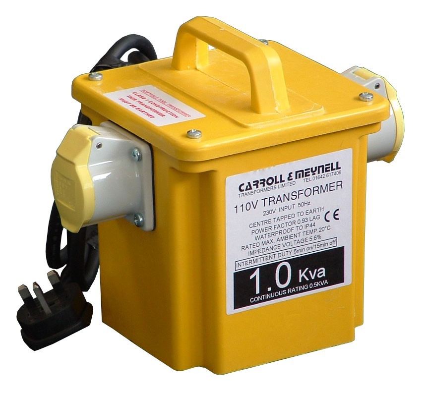

Post by Bob Connor » Sat Mar 29, 2014 9:10 am
We've got one of these which Dave bought with him from the UK. We've got a few things that we use it for, one being a Festool sander that Lillian got me in the States for a fraction of what they are selling for here.
You can only use 110 volt tools on building sites in the UK.
