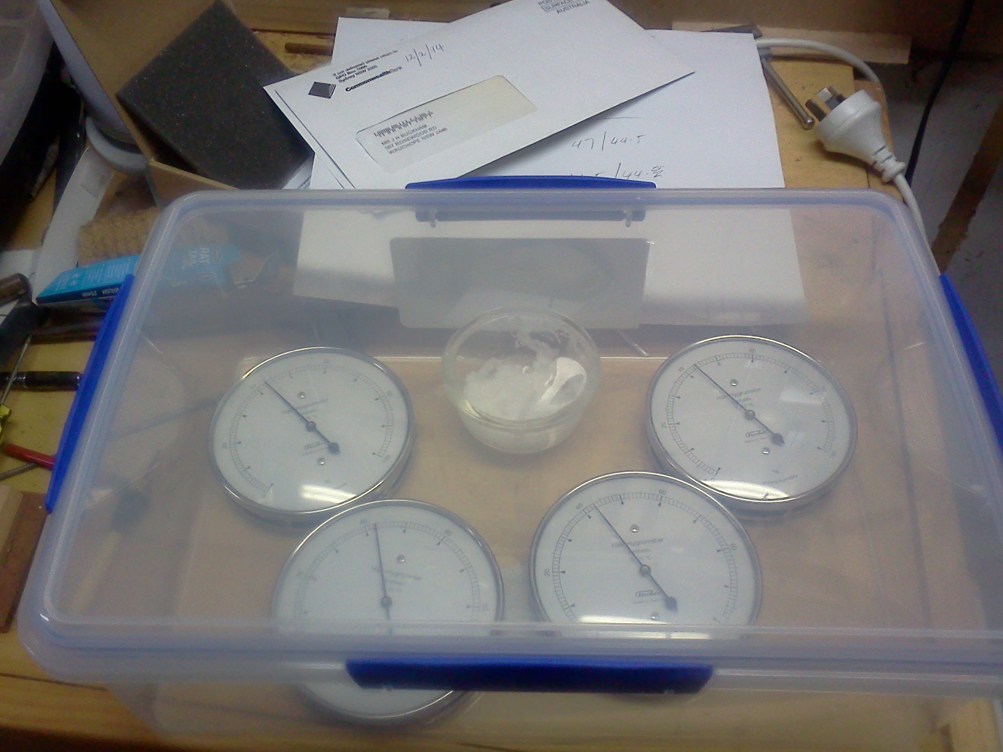

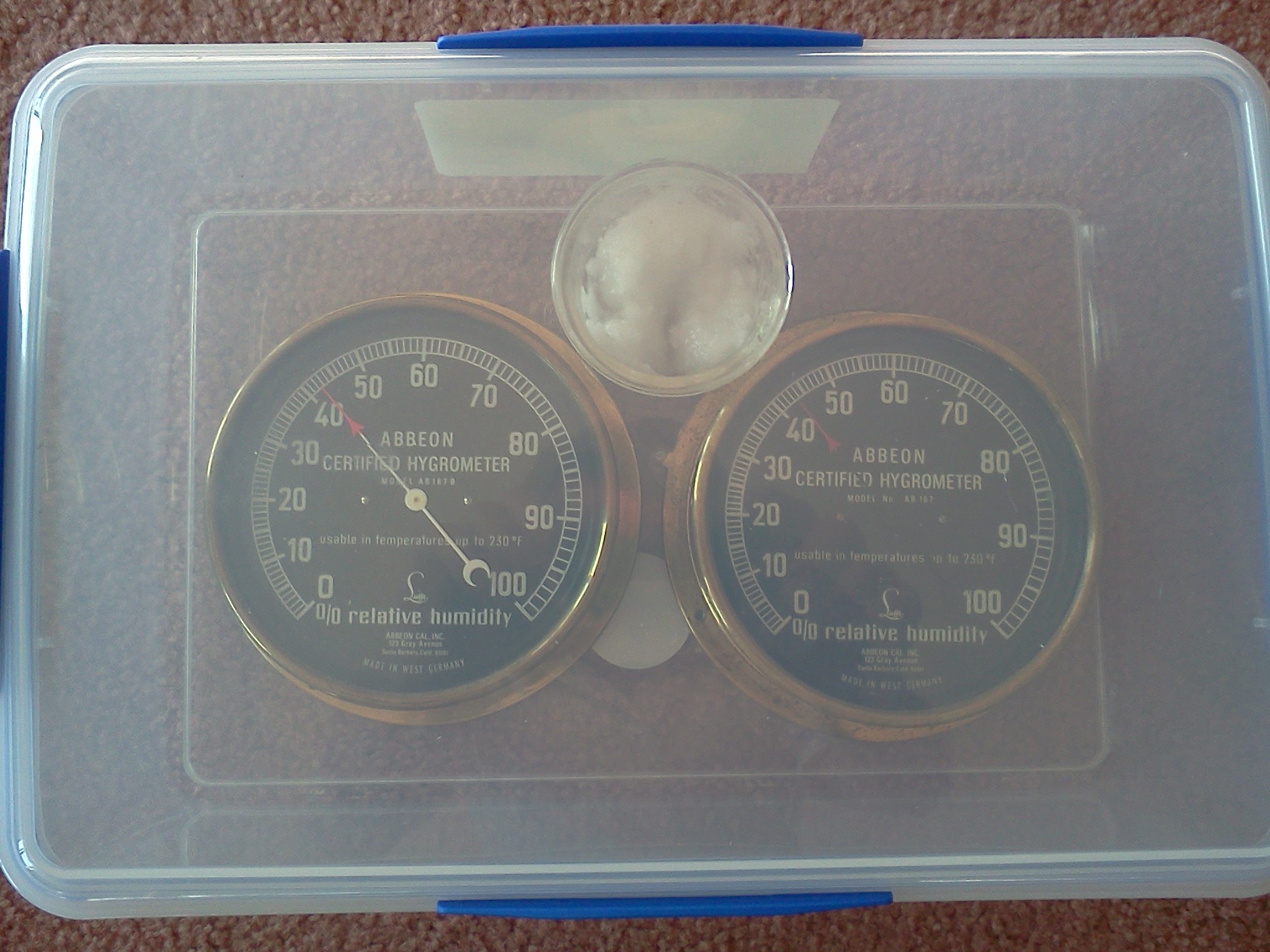

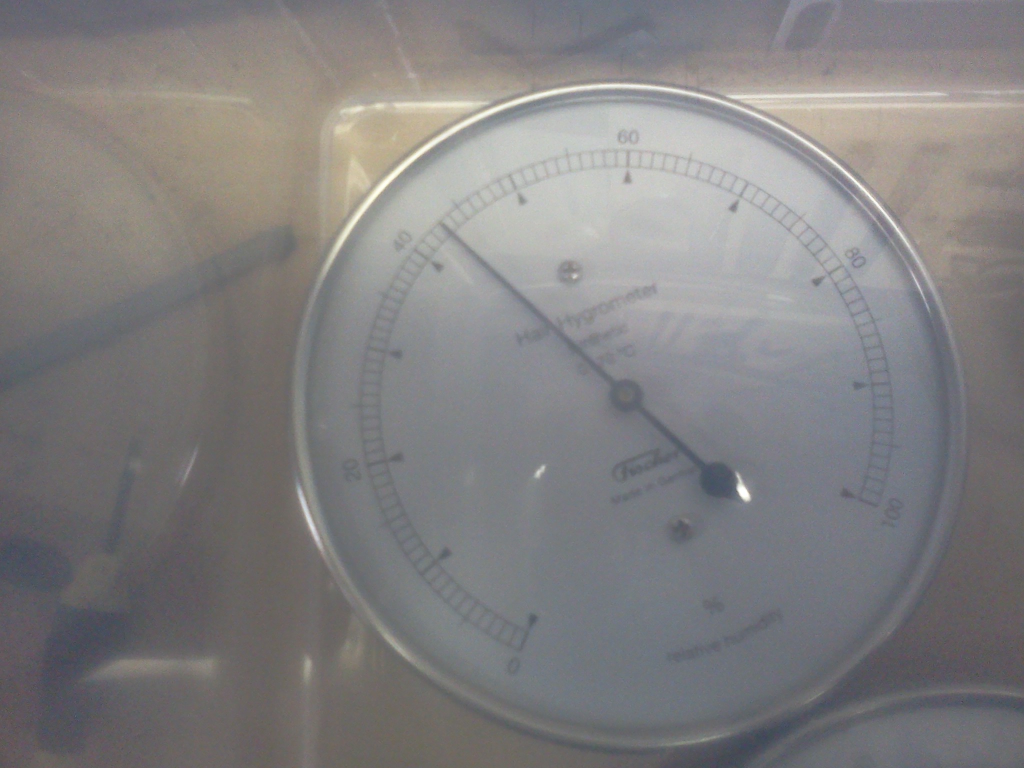

Pics of Calibration using saturated salts.
My setup,as I mentioned, was able to replicate what Kevin did in the lab . There are just a few things to keep in mind. Patience is necessary as you need to give the salt some time to stabilize the environment in the desiccator (lunchbox or similar). Distilled water is needed to wet the salt so that you don't introduce other salts that may be dissolved in the water that may skew the results. Put the salts in a glass or ceramic dish, preferably a shallow one. Do not use plastic for this.as the salts are exothermic when first wet, hence the need for something like glass or ceramic. Wet the salts out with some distilled water but don't add to much so that you have free water in the bowl. Try to spread the wetted salts out as much as you can to maximize the surface area available to the atmosphere. Put the dish in the desiccator with the hygrometer. Let it stabilize for 24 hours before you take a reading. One way to be certain that you don't have it too wet is to put some more dry salts in a different dish overnight and see if the measured RH comes down from the first reading. If it does then remove the dry salts and allow the wet dish to give up some more of its moisture to the atmosphere in the desiccator. After 12 hours it should be exactly 43%RH in there. Check your hygrometer and calibrate as necessary remembering that it is best to do this when the RH in you workshop is low as when you open the top to make the adjustments you will be handling it in air that is not controlled like you had in the desiccator. You should have enough time to make any necessary adjustment to the hygrometer with a small screwdriver on the calibration screw that is usually accessible through the back or the side of the instrument. The salts can be kept in the sealed container for the next time you need to calibrate your instrument. It would be a sensible precaution to calibrate it every 12 months.
Hopefully this information will help us understand the subject better and give confidence in using this essential lutherie tool
Here is a helpful link to a table that gives the RH of various salts
http://www.omega.com/temperature/z/pdf/z103.pdf

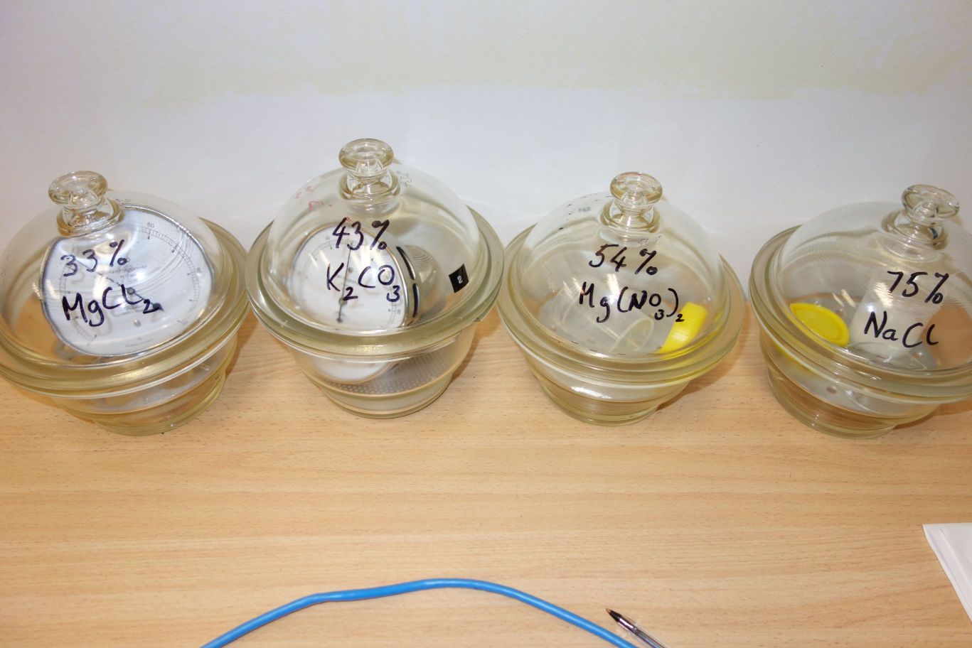

If you do a search on hygrometer calibration Potassium Carbonate seems to the compound used.
Luke72 wrote: ↑Thu May 24, 2018 5:58 pmI know this is an old post, but has anyway clarified whether or not the potassium BI-CARBONATE (KHCO3)- (the link that Mike Thomas posted) can be used with any success instead of potassium Carbonate (K2CO3)? I have some Potassium Bi-carb so i thought i'd give it a go...and it failed. It came back with readings closer to the 70% mark and i know my 6 hygrometers can't be out that much! Maybe i added a drop to much water or maybe it just HAS to be potassium CARBONATE and not Bi-carb.
