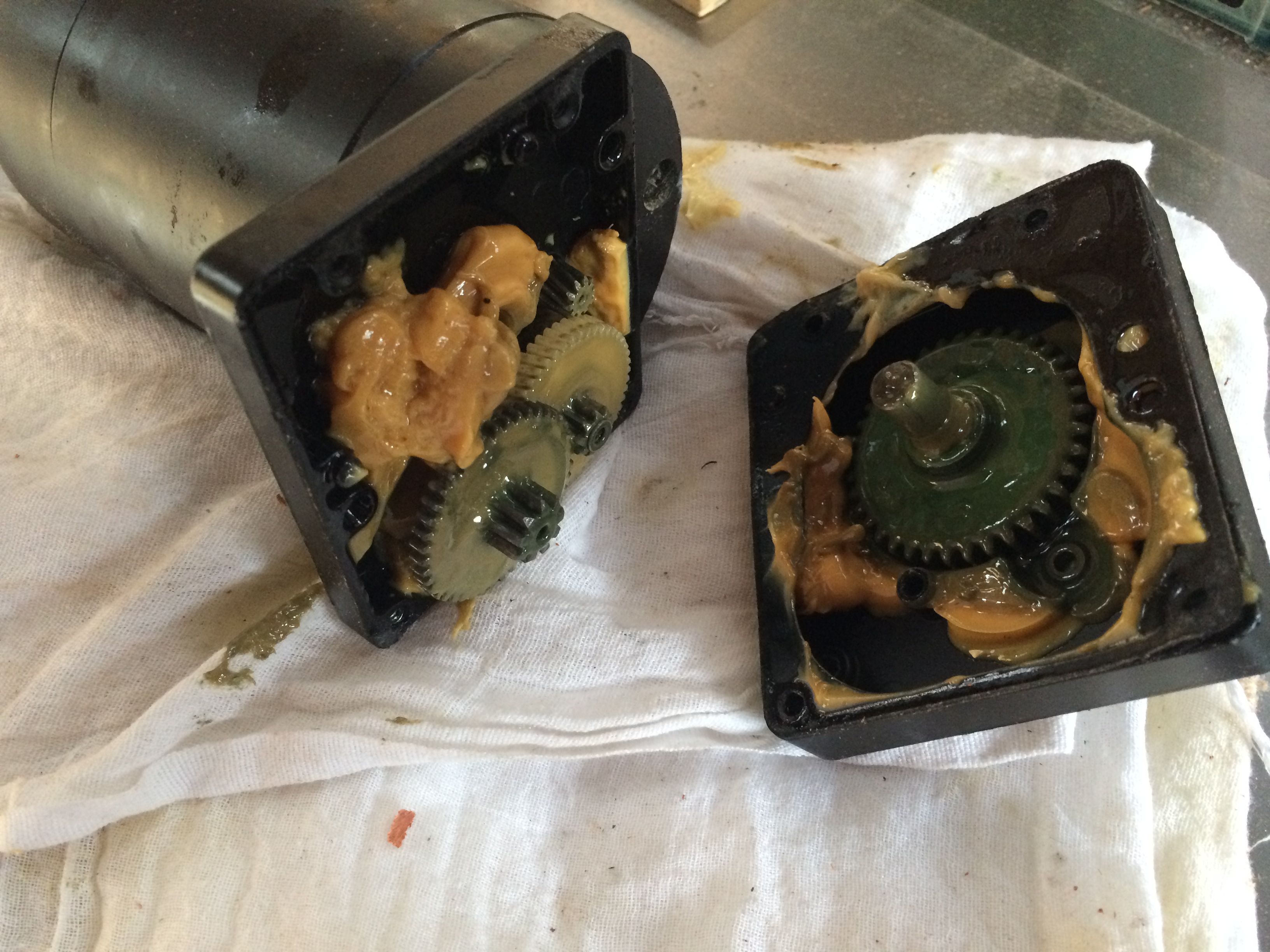

Cracked open the gear box and found this.....I think this sh*t is supposed to lubricate the gears??? Either that or someone dropped their peanut butter sandwich in the gearbox.

Re: Frick what now???!!
Post by sebastiaan56 » Mon May 12, 2014 8:37 am
Looks like the shit Ive been hacking out of my lungs...

I spent an hour trying to dismantle the gearbox from the motor yesterday to check the motor bearings but gave up.....looks like you need a gear puller to get the cog off the motor shaft before the gearbox will come off. Ive got better things to do with my time. :?
