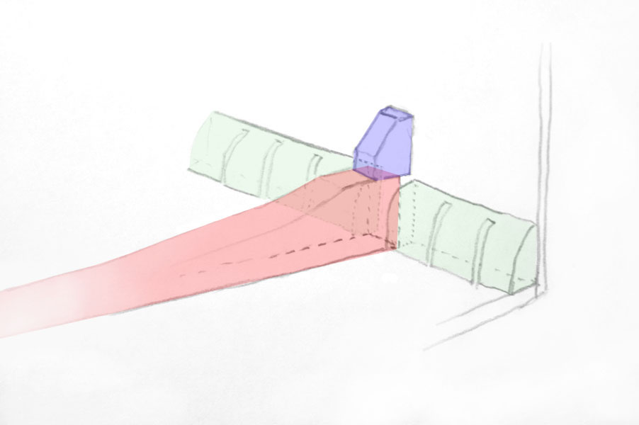

I made a drawing of Romanillo's method. Yes, he makes the bars thinner towards the center. Antonio de Torres left the braces at full height throughout the whole length, rounding their top over except at the ends where he let them square so they could rest on the consoles glued to the sides.

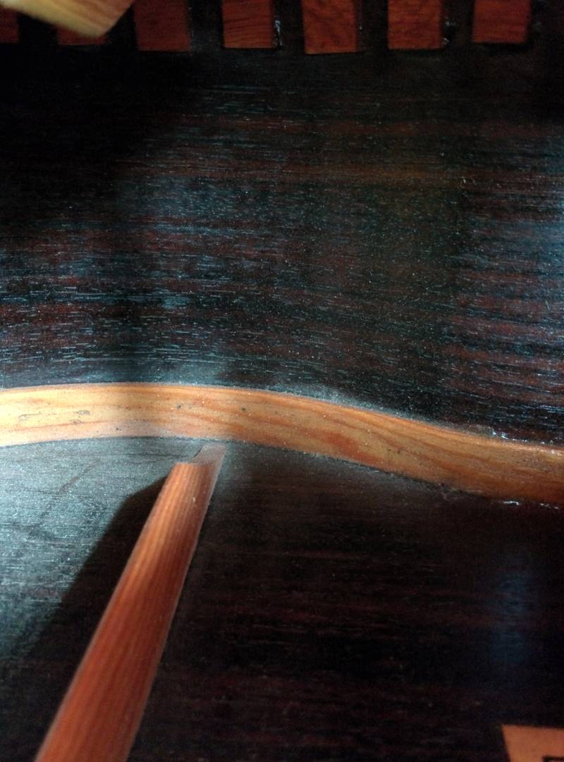

I've actually done that a few times. Doesn't seem to adversely affect either the structural integrity of the guitar or its tone. Here's a photo of one of the back braces on an instrument that I made in 1976 - still in my possession, still played most days, has never had any structural problems in spite of the hard life it has led.I would not be keen on feathering out these two ends to nothing before the lining

Nick, my negative opinion on feathering to nothing (which you have quoted in part) was specifically for the two ladder braces supporting the bridge on a Selmer/Macafferi style guitar.Nick Payne wrote:I've actually done that a few times. Doesn't seem to adversely affect either the structural integrity of the guitar or its tone. Here's a photo of one of the back braces on an instrument that I made in 1976 - still in my possession, still played most days, has never had any structural problems in spite of the hard life it has led.I would not be keen on feathering out these two ends to nothing before the lining
I was not expressing an opinion on Back Braces or any other form of Top Braces
