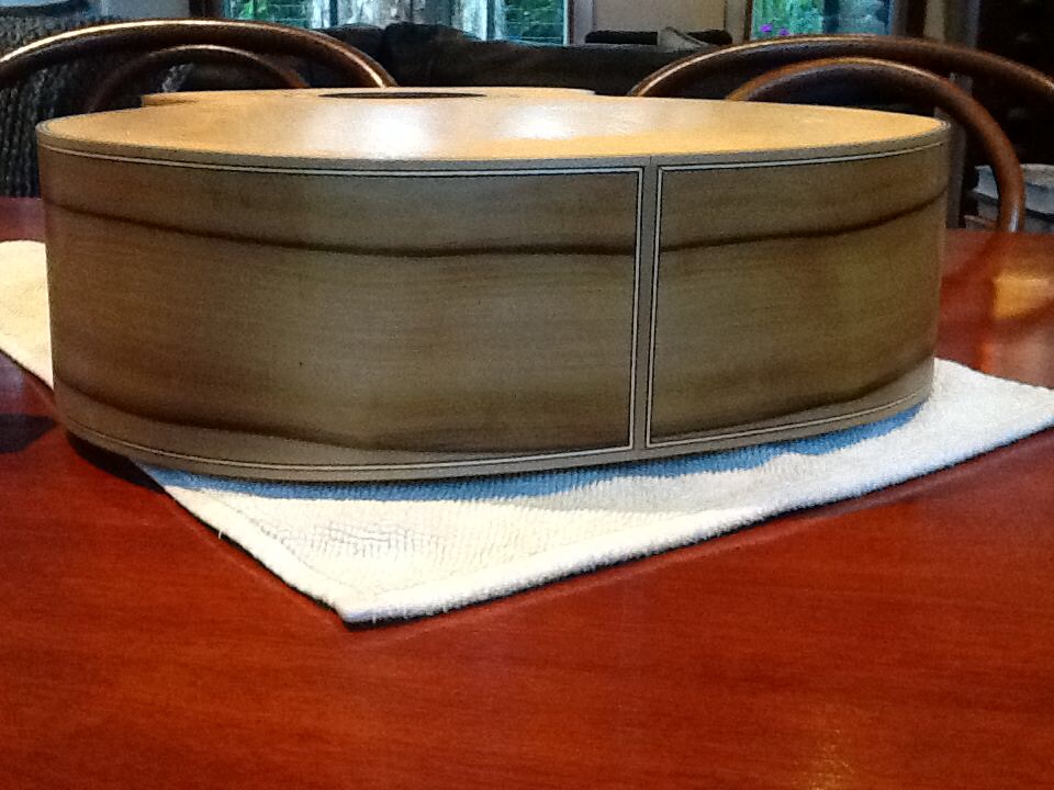

Re: grain thru binding
These are Black heart Sassafrass, and look pretty nice with the guitar finished...
it's a bit hard to tell on the picture but I guess that's what I'm after
but Bubinga has a figure simmilar to cocobolo or such, so really obvious
and if the lines dont go through it defies the purpose of the whole thing
so cutting off straight binding is a no go...
