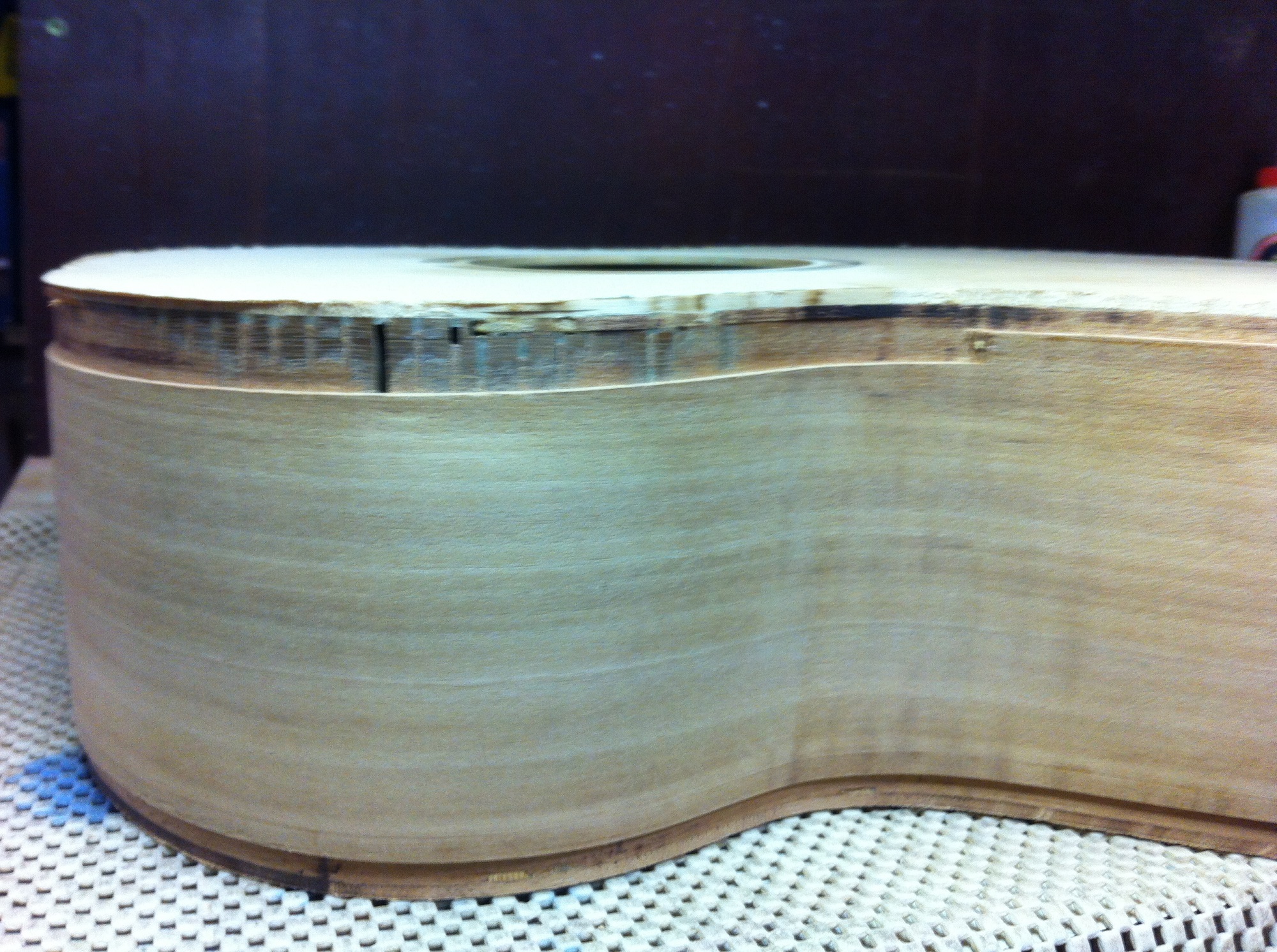

Had everything set, was watching base of trimmer to be sitting flat on top. didn't expect cutter to work down. :oops: :oops: :cry:
Still enough side material glued to kerfed lining. Going to have to get the creative juices flowing to fix this one. Maybe some fancy binding. Any ideas.

Spectacular! :shock:
Lately, binding channel routing mistakes seem to be en vogue. :?
The first idea that comes to my mind for converting the mistake into a feature is the rosette design Allen is using now on his ukuleles. This would not only allow to integrate the step from the wide part to the normal width (actually height) of the channel, but also would break up the otherwise bold binding section in the upper bout into several strips and thin lines.

You're lucky the cutter didn't completely fall off, you could have really hurt yourself there :!: If you have offcut material from those sides (what wood is that, by the way?) you could bend a piece of it to the shape of the upper bout, clean up the 'step' where the slip-up happened and glue it on there.
I would suggest a scarf joint where that extra binding will join the rest of the side. leaving it a bit proud of the original binding cavitiy.
Then re-do the binding cut, making sure the cutter is not going anywhere.
Fixing it this way, you won't have to make any change in the original design, and if it's well done it should not be visible to those that don't know about the fix.
Hope I'm being clear and that this helps!
As a teacher once told me : 'If it's wood, you can fix it.'

I had a more minor version of this same mistake happen once, due to the bit working loose in the collet. I did what Joel is suggesting and grafted in a piece of off cut from the sides. If you try this just make sure that you get it around the same way as the side, not mirror imaged or book matched because then any runout in the grain might make it lighter or darker than the adjacent wood (like you see in some book matched tops or backs sometimes). In my one it is in the same place as yours on the upper bout, which is a hIghly visible spot to the player. My repair is noticeable to me because I know about it, but no other player of that guitar has ever picked it as a defect.

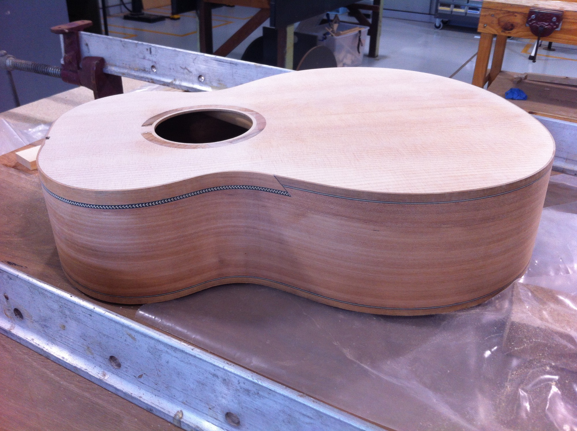

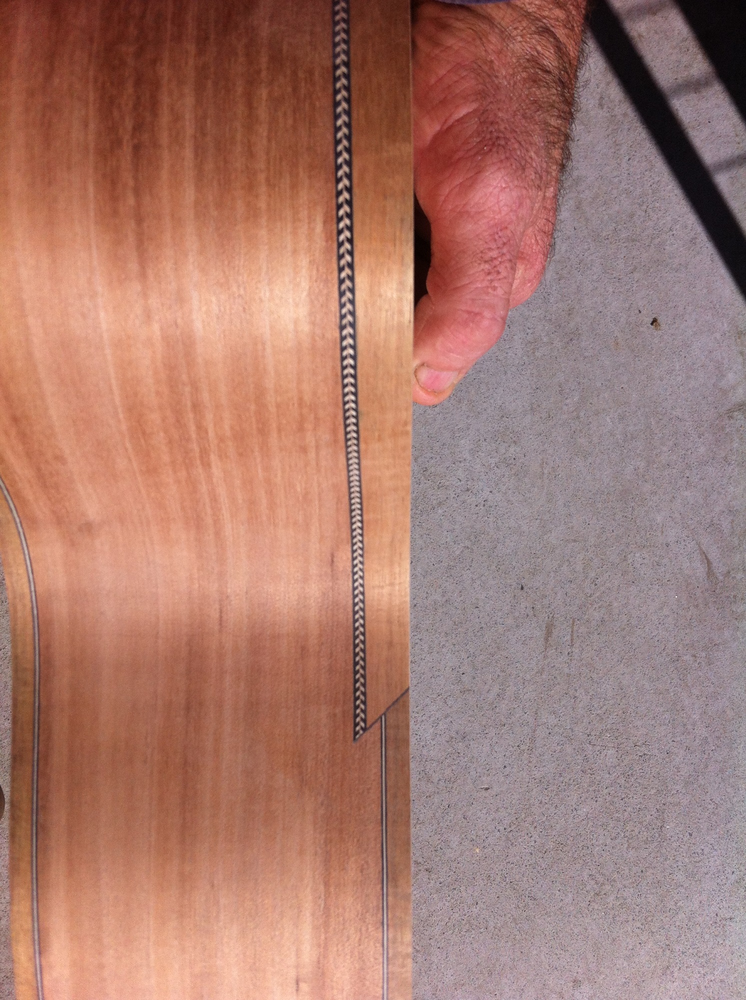

This is my fix up.
Here is the end graph

Nice!
Good, clean save there

Well done! :cl
Now it looks a bit like a racing car. :)

Thinking outside the square Soulman....
To be honest when I first looked at the pic I didn't like it but after another few looks I find myself struggling to find a reason not to like it.. 8)
