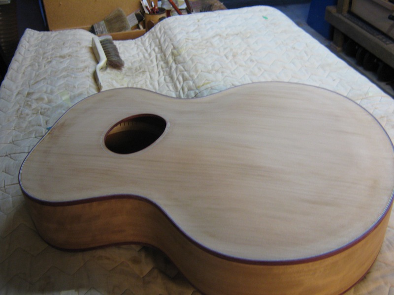

Post by rocket » Thu May 22, 2014 7:45 pm

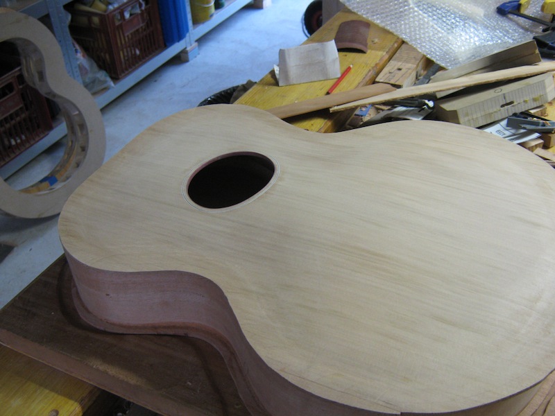

For those who like to romance just a bit here's a couple of pics of a 16" Qld maple WRC oval hole X braced arch top.

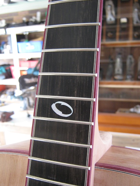

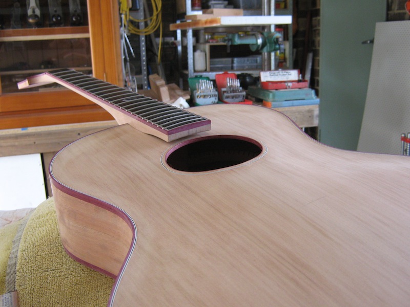

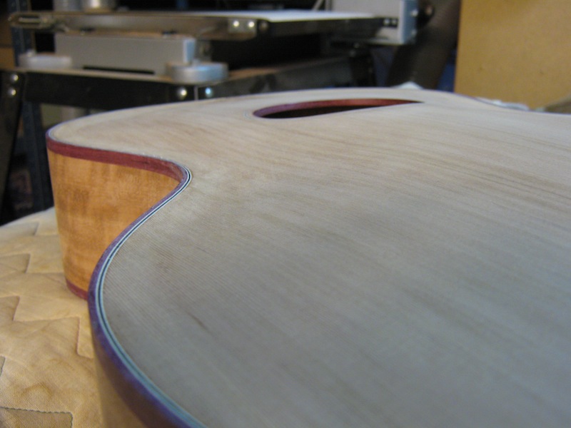

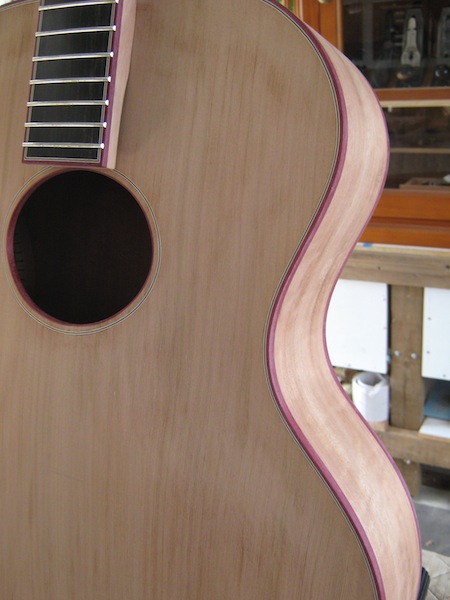

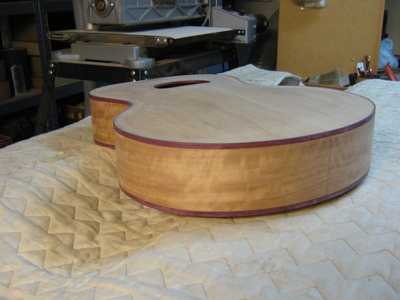

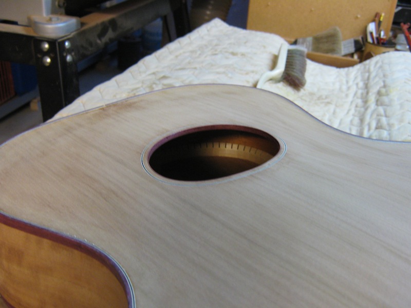

So,, i've closed this box up, used purple heart binding with wbw violin purfling and now just finalising the recurve.

Post by EricDownunder » Tue Jul 01, 2014 5:04 pm
Look fantastic, love to have a go at building an arch top one day.

Post by mlp » Tue Jul 01, 2014 6:40 pm
wow, thats looking pretty amazing. super tight grain on the soundboard, any suggestions on where i can get me some of that??

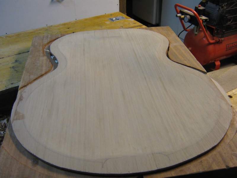

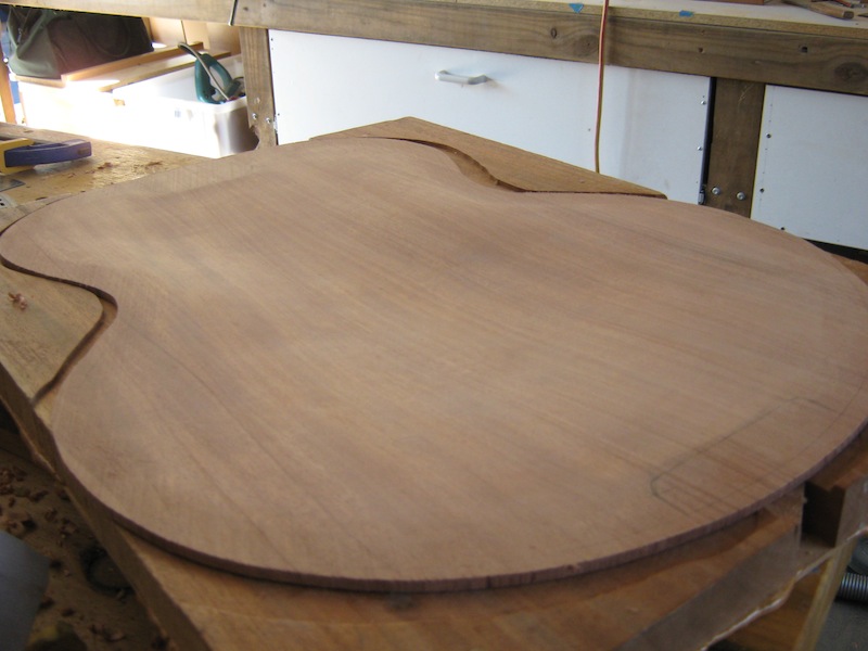

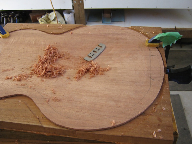

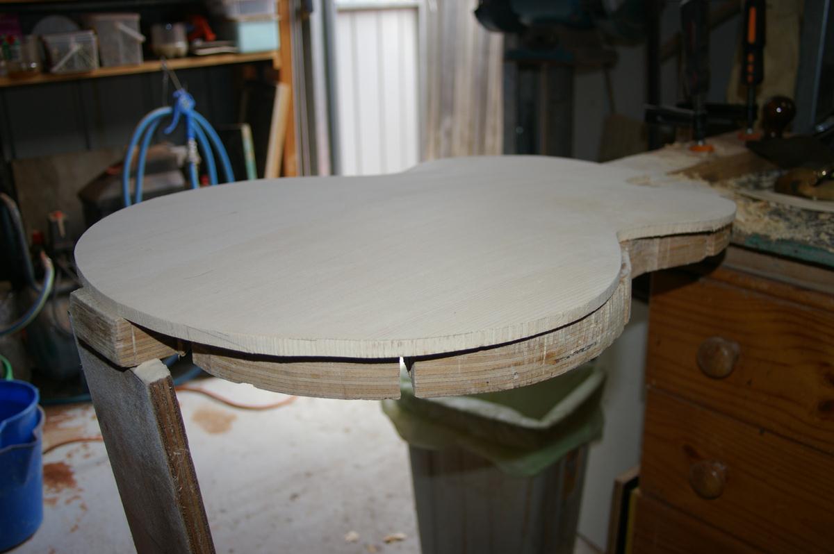

Very nice Rod. How wide is the recurve? I've just started my first archtop and there's a few things i'm not sure about, recurve is one of them. This is the Lutz i got from Mario. Thanks.
Re: Just a bit of romance
Post by rocket » Tue Jul 01, 2014 9:57 pm
Markus, i picked up that cedar at my local yard in Melbourne, Mathews timber , Rooks road Vermont, Wayne the deepest point of the recurve is set just inside, about 3-5mm the line of the linings or kerfing, looks like you're making good progress on your Lutz top, don't forget to final thickness the edge of your plates before you fit them to the sides, from the pic it looks like you are at that stage !

Thanks for the reply Rod, i've just ordered a safe t plane and am waiting for that to do the sides. I've got the thickness at about 5/16" all over, should i remove more and get it a bit thinner now? Or is that done later? Thanks again Wayne
Post by rocket » Wed Jul 02, 2014 7:16 am

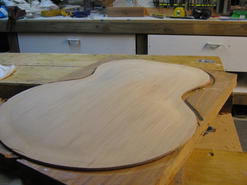

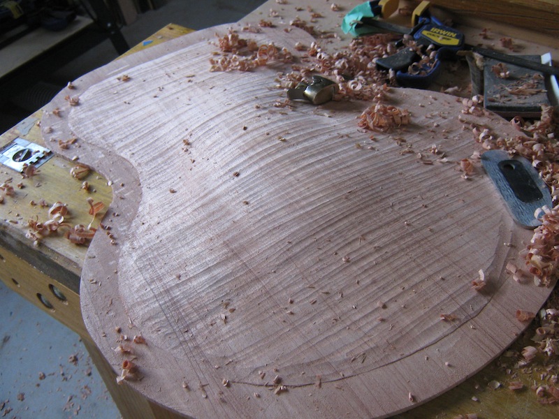

You need to finalise your tapered thicknessing before you close it up so from where you are now, when you get your Safe-T-Plane, thickness the perimeter in as far as your recurve area to about 4.5mm, that will leave a bit of a step in what your top is now, blend that into your arching, when you are happy with the exterior of your top you can finalise the thicknessing by removing material from the inside,use the same procedure for both plates, after the box is closed and binding is in, then work the recurve.
This is an example of the perimeter thicknessed and blended into the arching and the inside finished.

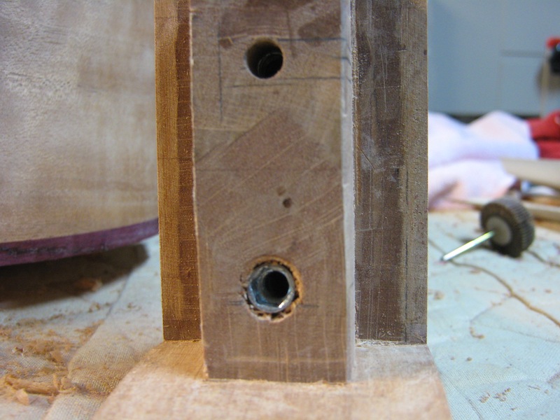

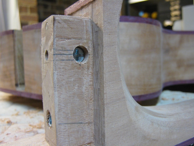

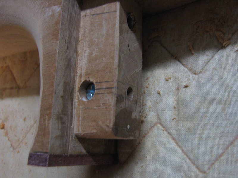

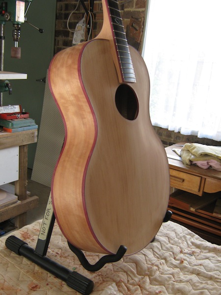

Second bolt on neck for me, this one was a lot less traumatic although i couldn't decide which method to use so i used both the screw in insert and barrel nut methods, so i must be at least half right!! :D :D

Post by needsmorecowbel » Mon Aug 18, 2014 8:16 am
Real Nice! Got any pics of the neck tenon and body mortise Rod?

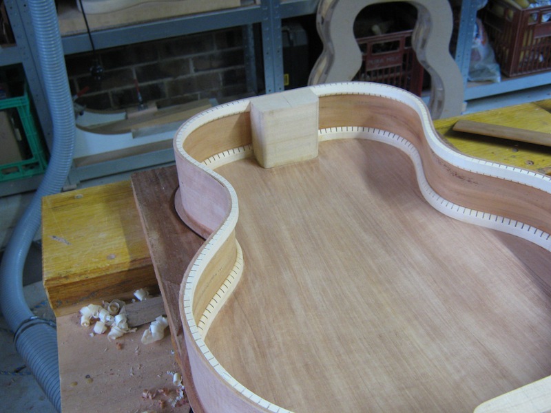

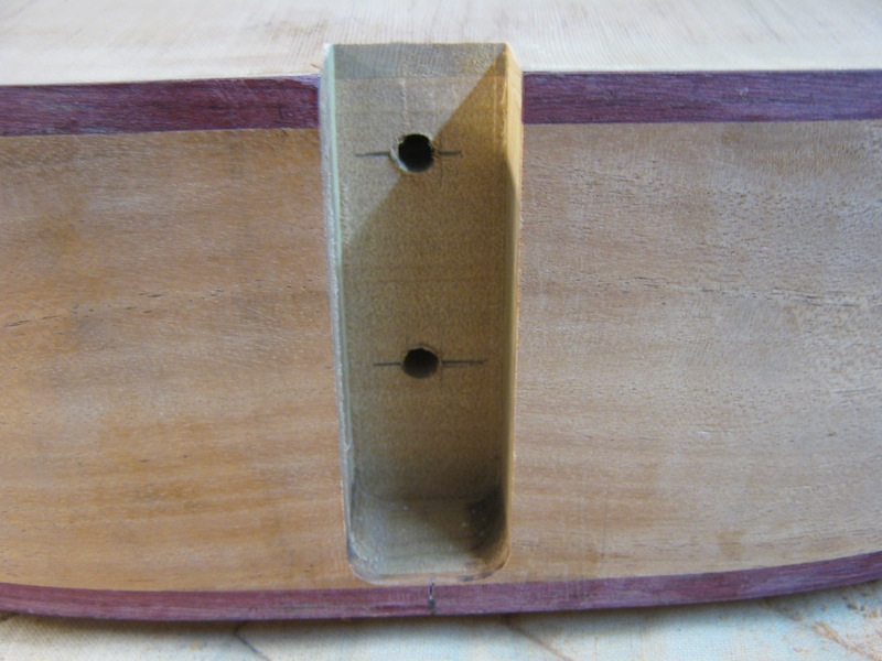

Post by rocket » Mon Aug 18, 2014 7:26 pm
Some more pic's for Stu.
The screw in insert is yet to be set in epoxy
Cheers,,
