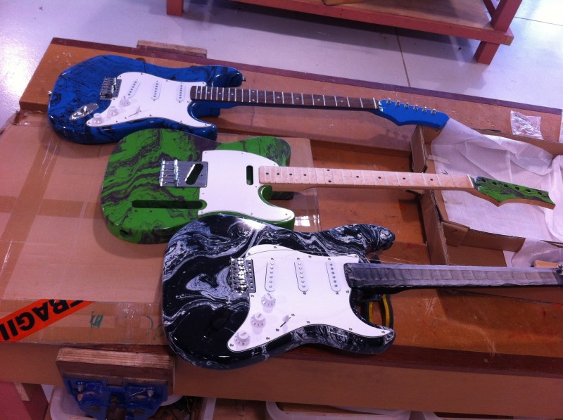

Try model paints or maybe an automotive distributors. I've used both model paints and enamel from pressure packs. Some colours react better than others. You can get fluro paints in pressure packs. Just so long as it doesn't dilute with water as the paint forms a skin on top of the water. I haven't yet done any trials with auto enamels but think it would work well.
Here is some I have done. I have helped some students do these before school. An hour per week. I used White Knight pressure packs.
Ross

For pressure can packs thats pretty good
