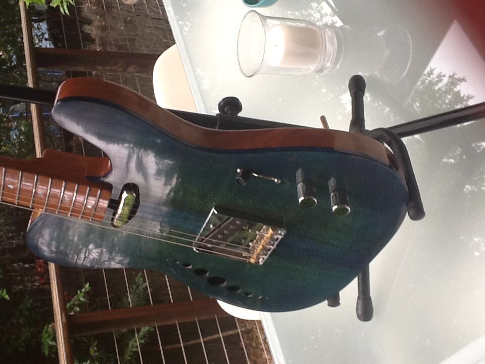

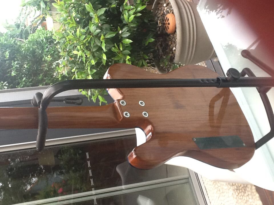

There are better sources than me on here for solid body timbers, but Blackwood and Qld Maple are pretty common and both can have some awesome figure in them. Even un figured, they are attractive timbers. Or, you can do a drop top of almost anything, Eastern Maple, blackwood, etc, etc. I made a tele out of scrap timbers left over from a bathroom renovation I did at home.
I'm also working on a neck thru copy of an Ibanez Musician with a Qld maple neck and blackwood wings that I got off a mate a while back...
You might have a look a Demonx thread in his guitars in the gallery. He favours a style similar to what you are chasing and has some examples of his work in that thread.
Of course, you can pick up a chunk of mahogany, and paint it, so it'll look like whatever you want it to....Lots of alternatives and only your imagination can limit you.
Re: the pick up. I had a guitar with lacetones in it before. Good pickups.
The top is Silky Oak, dyed blue and everything else is New Guinea Rosewood. I'm also working on a neck thru copy of an Ibanez Musician with a Qld maple neck and blackwood wings that I got off a mate a while back...

That is a very sexy tele
