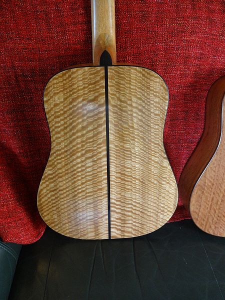

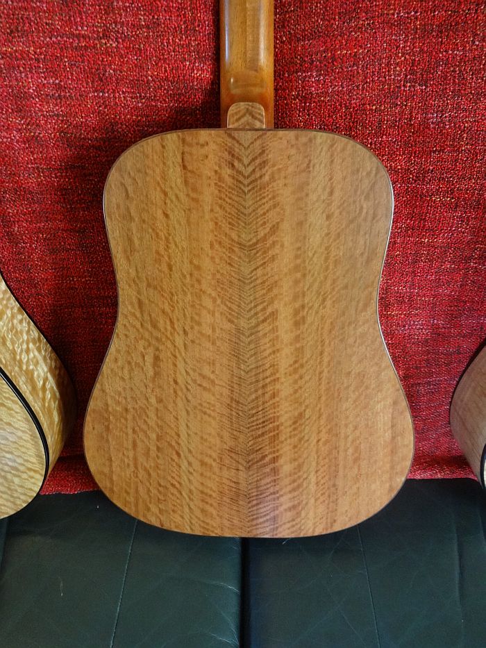

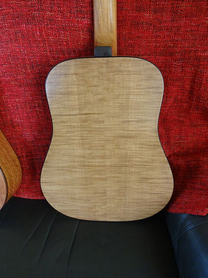

The Albany lads have made quite a few instruments using eucalyptus sp.
Both Maurice and I have used blue gum and I have also used Sydney sugar gum and wando AKA (in the west) white gum.
So many species ... easy to get them confused. I stick to the local names ...
Need sharp tools ... except for the wando, the timber has little tap tone but ends up making good sounding guitars.
All the instruments pictured are 3/4 dreadnaughts.
I think maurice tried WA red gum (marri) but found it hard to bend ...
The inimitable Tim S has some silver wattle but not sure if anyone has used it yet.
Regards Peter
