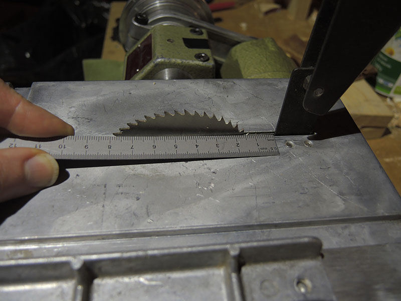

I own an old Emco Unimat which I can convert into 1001 different "stationary" dwarf power tools. It has a splitter at about 30mm behind the blade, so I assume this is not really thought to prevent kickback but rather to simply hold the blade guard.
Would it be smart to keep this item in museum condition instead of using it or am I overestimating the danger of kickback on such a small saw? (90mm diameter blade, 100 Watt motor).
I have no intentions of tweaking the saw because adjusting it is a hassle, so it would not be worth the modification effort. But maybe I would look for another miniature tablesaw that would be safer to use, or at least would be worth a modification.
Any thoughts on this?

Kick back is caused by a fence that isn't set up correctly, and wood that starts to pinch the blade as tension is released during the cut. So you're splitter is taking care of one, and the fence should be adjustable.
You can also add feather boards to hold down the work piece for added safety.
As well, with such a small blade, you aren't going to have the tip speed of a larger saw.

The fence of my saw is not adjustable but it is absolutely square to the groove in the table where it runs in, but I have to set the whole table right in order this groove will be square to the blade... You guess what kind of pioneering hobbyist piece of machinery this was 40 years ago.
I had a look at the numbers and it turns out that the linear speed of my saw's blade teeth is about five times slower than that of a 10" table saw (recommended speed for my saw is only 1600 rpm). Five times less speed means 25 times less kinetic energy in a piece of wood of the same size being kicked back in a perfect manner. So I think I'll give it a shot.

Any kickback is dangerous, regardless of the saw power, IMO less powerful items become more dangerous because we push them to the limit and have a tendency to get careless because we get frustrated with them.
But yes you can get kickback on a small saw, and yes it can still take your fingers off.

my advice is never EVER use a table saw without a riving knife.
personal experience about ten years ago... my boss had taken the knife off to kerf some mdf for a job as the knife sat higher than the blade and didn't put it back on. the following day i saw the knife wasn't in but used the saw anyway thinking that with my experience i would be fine. anyhoo... was pulling the carriage back when my pinky or the material touched the blade and my hand ended on top of a 96 tooth saw blade at 4000rpm.. luckily the extraction guard was sitting high so i was able to lift my hand off the blade instantly screaming the F word and cradling my hand ..It is the worst feeling to look at your fingers and try to move them but not have them move. there is more to the saga but in summary flip flop ring, middle and index finger severed on an angle thru the primary knuckle but the nice doctor put them back on although one of them is crooked.... can post a pic if you like but its a bit gruesome
just to share
just to share
Re: Is kickback an issue with miniature tablesaws? (100-250W
Something I've never taken off my table saw and don't plan to. It is there for a reason!Strings wrote:my advice is never EVER use a table saw without a riving knife.
Even with this I have had the odd kickback, if you use something often enough it'll happen eventually, but it's best not to help it happen.

However, it was never my point to suggest to not use a riving knife or splitter.
One problem I see with my miniature saw is the distance of the splitter from the blade which I thing would be unacceptable for a bigger saw, and maybe is so for a miniature saw too.
In any case, as Allen pointed out the linear speed of the saw tips is considerably less on a 4" blade than on a 10" or 12" blade. On my saw, the tip velocity at the recommended low speed of 1600 RPM would be less than 30 km/h.
Last evening I was assembling that saw, and there are many details that I dislike. A proper setup which has to be done every time I would use it after having it stuffed away, takes at least 30 minutes, and every blade height adjustment (which actually is a table height adjustment) involves a new, careful table-blade alignment).
Oh well, maybe I'll just put the tablesaw attachment in the "museum" (the wooden storage box, that is), but I hope to do with it at least some cuts on wood this weekend.
The good news is that the mini-lathe (which the whole thing actually is) works fine.
