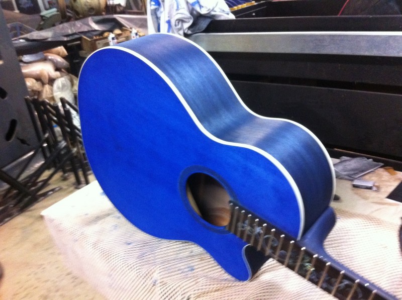

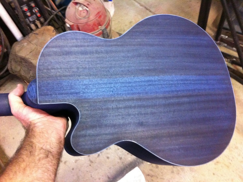

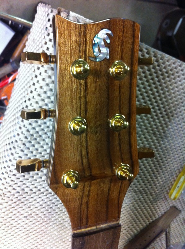

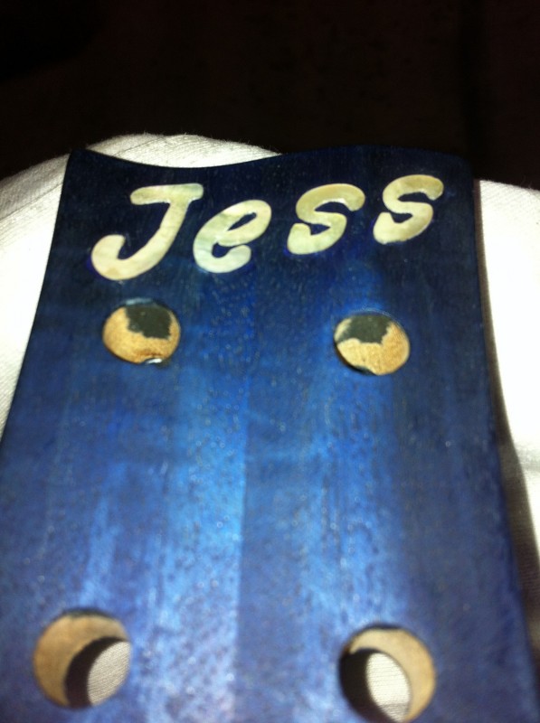

Here is an update of the QLD Maple body. I have done black die base then blue over the top. I used water to dilute dies. Next time I will try Metho as the wood swelled a lot more than I anticipated.
Finished in Mirotone gloss
Inlayed headstock with Abalone. Shell from Esperance W.A.

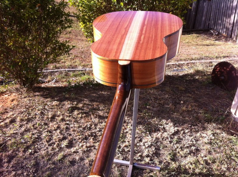

Post by soulman » Tue May 27, 2014 8:08 pm

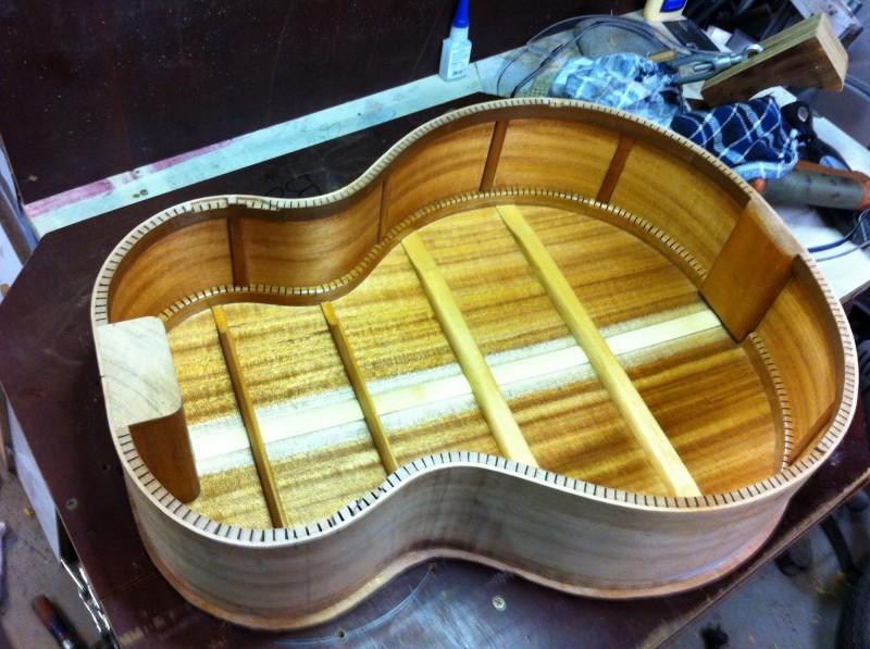

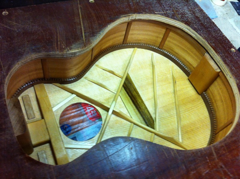

Here is an update of the last of the three guitars I started end of last year

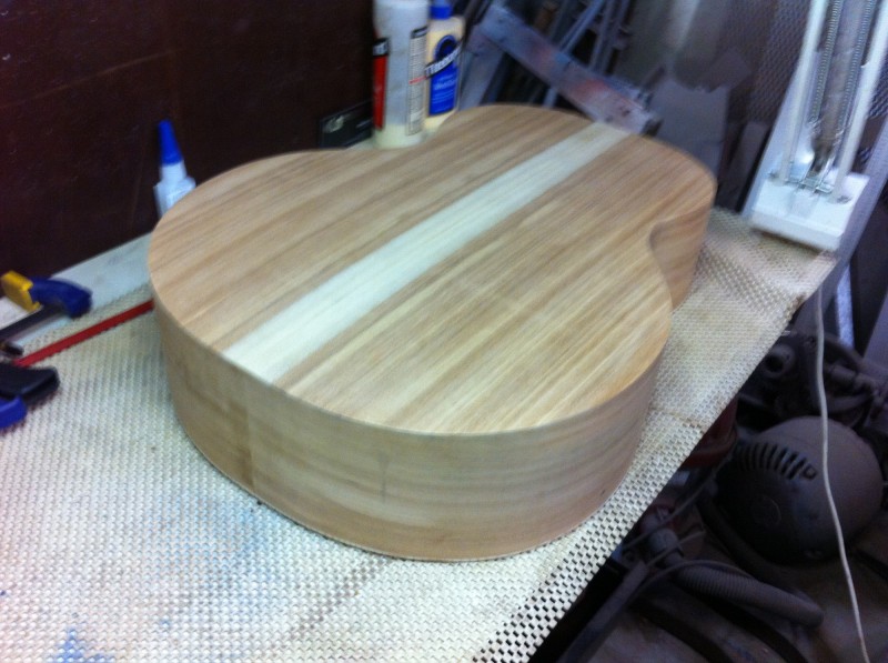

Post by soulman » Wed Sep 17, 2014 10:04 pm
This is the last of the three that I started.
Qld Maple B&S, Spruce top and Walnut for neck, fingerboard, Headplate and Bridge.

Post by Nick » Thu Sep 18, 2014 6:15 am
soulman wrote: I have done black die base then blue over the top. I used water to dilute dies. Next time I will try Metho as the wood swelled a lot more than I anticipated.
Next time when using water based dye, wet the wood with a wet, but not soaking, rag a few times first. Wait until each 'coat' drys and sand (this gets rid of any grain that's raised because of the water) with 240 grit. Keep the wetting/sanding process going until you don't get any grain raised after a wetting. The wood is good to go for dye then :D

Post by soulman » Thu Sep 18, 2014 6:54 am
Thanks Nick
I will have to give that a go.

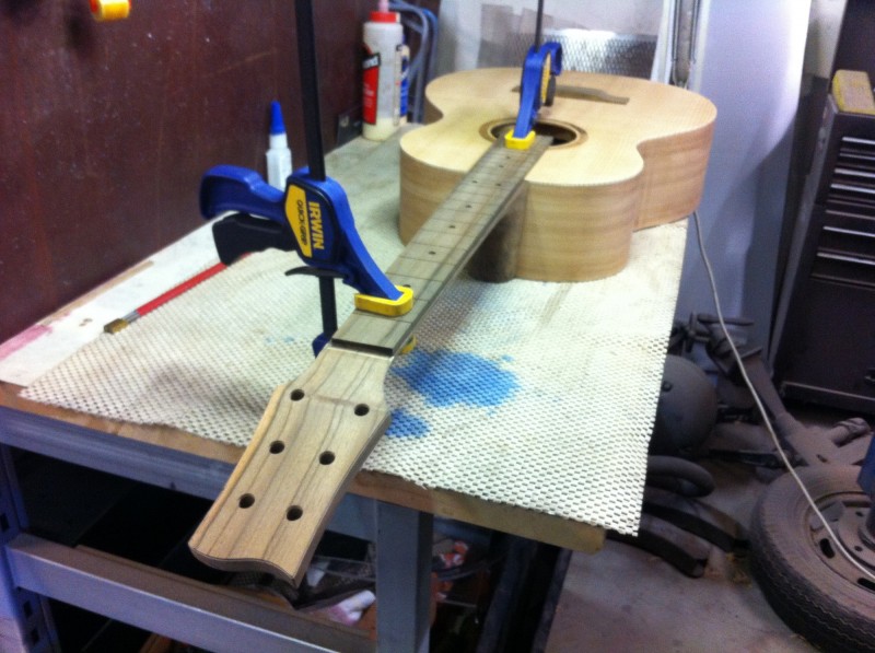

Just noticed the Titebond two in the background, what do you use that for?
soulman
Posts: 160
Location: Ipswich QLD
Re: First acoustic builds.
Post by soulman » Fri Sep 19, 2014 11:53 am
Hi Nick.
I've used it to make binding as it has a higher heat tolerance than original. I haven't tried bending the binding I've made yet so we'll see. I've started a dreadnought and will be using it on that.

Hmmm, I wonder if that titebond II will work for rosette's & purflings! :?
Post by kiwigeo » Sat Sep 20, 2014 6:17 pm
soulman wrote:Hi Nick.
Ross
+1 I use Titebond II when making up my own binding/purflings. For gluing in bindings I either use hide glue (first choice) or Titebond I. For rosette glue in where I don't want any risk of swelling I use epoxy glue.

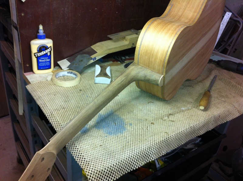

soulman
Posts: 160
Post by soulman » Sat Sep 27, 2014 10:38 pm

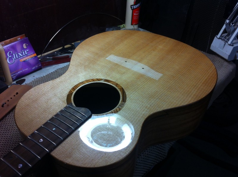

love it when the clear goes on. getting close now.
