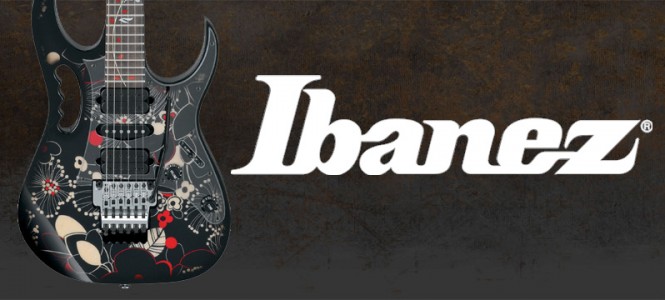

I like the grain of the body with that sort of grape colour (is that what it was?). The lower 'horn' doesn't do much for me aesthetically, with it coming to a point I would have gone with a more radiused approach similar to say the Ibanez. But that is just my thoughts, one man's meat is another's poison as they say :wink: Also a little constructive 'tip' if I may? when drilling tuner holes in your headstock, use brad point bits. They are less likely to want to 'wander',

Post by Nick » Mon Oct 13, 2014 1:31 pm
hazboticus wrote: I quite like the pointed horn :P
Yeah sorry, didn't explain that very well :oops: I like pointed horns as well, I mentioned the Ibanez because they still come to a point but they sort of scallop out the cutaway rather than the small radius and straight ramp to the point you've executed here.
Such as
To my eye it would just 'flow' better but as I say, it would be a boring world if everybody liked exactly the same things! :D
Such as
AH yea now I know what you mean. Yea I beleive the next iteration will need a bit more scooping out :). Now I just have to take it apart and fix the neck alignment and Ill be gravy....
