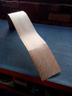

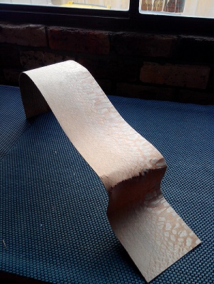

I need help in bending Brazilian Lacewood sides, they have alot of short grain and this has been the end result.
Tried bending with heating blanket 300deg F, bending iron. Tried bending with water & without.
The wood just seems to collapse once pressure is applied to either upper/lower bout/cut-a-way.
Don't know if temperature was hot enough, but too much water is definitely no good.

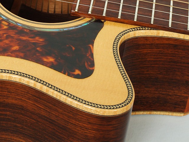

I'll second the SuperSoft II idea. It is the only way I've been able to bend 2mm thick curly maple bindings in the tight cutaway radii without breaking them. The grain of the curly maple I was using ran from one side to the other in less than 10mm. I have since used SuperSoft II on rosewood veneers that tend to split when bent into laminated sides, again with tight cutaways. I have not tried it on solid sides, but it is the best option I can think of.
