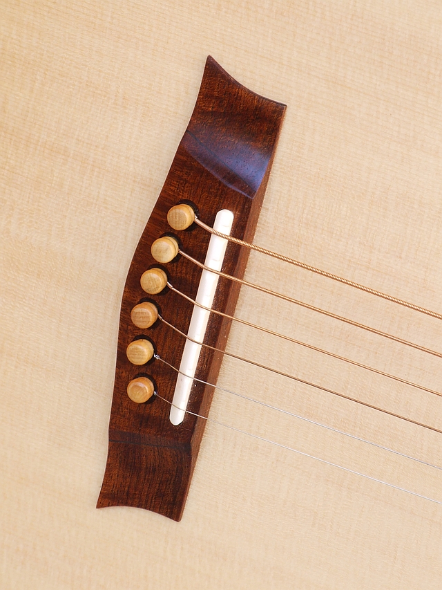

I've used it on bridges a couple of times and it does a good job. Also used it on non-guitar projects where it has worked fine. Not used it on a whole guitar. Lots of rubbing/frictional heat makes it set up harder and shiner, but a nice finish can be obtained just by wiping on and keeping the object warm. A couple of pics, both guitars with oiled bridges....
(The business seems to have been taken over, so I hope the formulations haven't changed,
