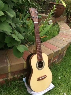

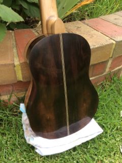

I sanded back with 180 grit and then scraped, especially the smudgy spots, after which I flood coated with shellac 3 coats, a couple hand rubbed and finished with micro mesh pads to 12000. Finally a coat of orange oil.
Photographs attached on the final finish.
Well that turned out alright didn't it? Looks great.
