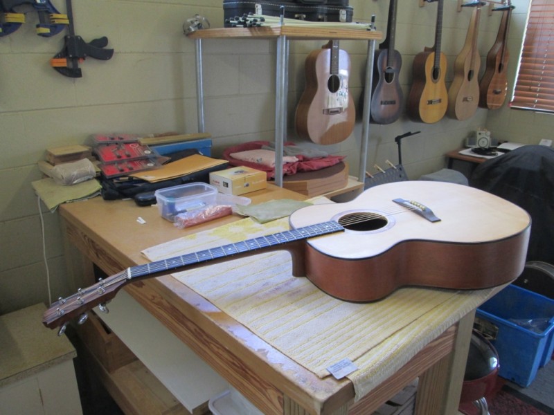

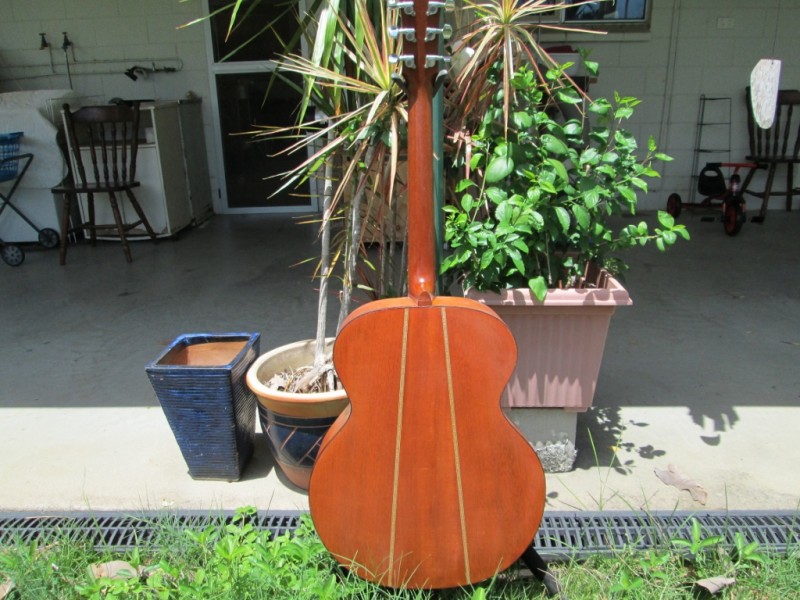

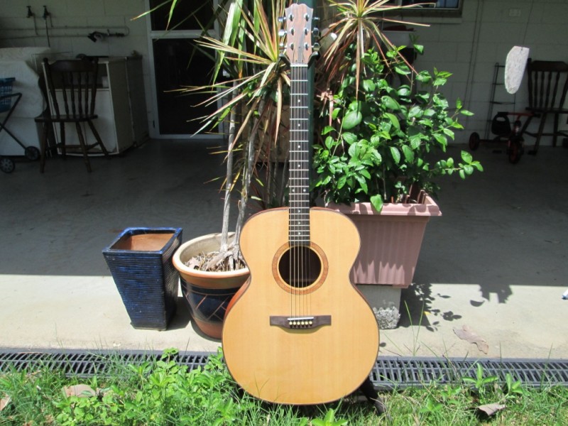

Post by ozziebluesman » Wed Jan 07, 2015 11:07 pm
Hi to you all and Happy New Year.
I started this guitar re-top sometime ago and my health went down hill so all stopped in the workshop. Health is much better now so back in the shop catching up on all my projects I had started. This Jumbo was going to be thrown out but I decided to have a go at a re-top and it worked a treat, I used one of the $10 Lutz tops that Shane offered on special. It's a big boomer, with great sustain and finger picks nicely as well. Very pleased at the outcome. A few final stage pics for you all:
