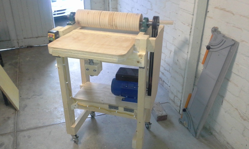

Thanks to Wayne for the link to the plans for a drum sander, and thanks to Fred for his photos of his model.
I got the courage to build one and here it is. It now has a dust cover and the hook-and-loop sandpaper on it. It worked well thinning my boards from 5mm downwards.

Nice one Andrew , that looks like a good project well done .
Where did you end up getting the motor, bearings and shaft from ?

Hi Rob,
I decided to get a Chinese motor from Conon Motors. It was listed on eBay but found they were located in Glen Waverley (Melbourne) - only 20 mins from me. So I went down and got a 2Hp motor for $140 (a 1.5HP motor was less $$). Hopefully it doesn't give me any trouble.
I had trouble matching the shaft size to bearings and pulley, but got there with 30mm sizing.
- 30mm bright steel shaft from RD steel in Bayswater for $30.
- Bearings from a W.A. via eBay for $20 each. Found out later that I could have got the pillow bearings at Melb Mach Co for $30 each.
- Pulleys from Melbourne Machinery company (thanks for that lead Rob). They only had the 30mm in double pulleys but that was fine. They were top quality steel at $40 compared to the Aluminium ones that were $10 each without a grub screw.
- Had trouble finding belts as I didn't know the types and measurements but I got there. Got belts from Rydell in Moorabbin.
- The only large sheets of adhesive backed industrial hook-and-loop was from The Sandpaper Man online - not cheap Velcro backing!!
Overall I had fun making something light industrial. The plans were good, but they forgot to mention one thing: to ensure you put the motor and pulley on the side that causes the shaft to rotate towards the wood as you feed it in. I ended up having to swap my motor to the other side as I realised it too late - all part of the fun!!

Nice job Andrew, looks way neater than mine.
