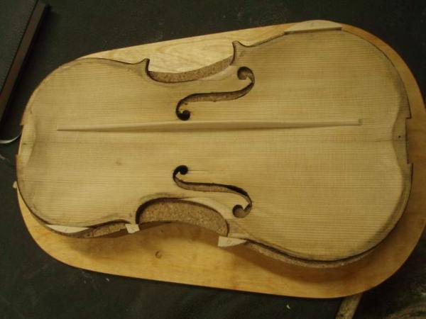

Im no cello expert but I believe cellos don't really have bracing like under an acoustic guitar top. There is generally a single "Bass bar" running along axis of the instrument and it appears to be offset slightly to the bass side.

The bass bar internally is the most noticeable difference, but you will also have to reprofile the fingerboard, most cellos have a hump just below the bass string, a symmetrical fretboard is okay to play on, so smooth arch similiar to the bridge, just kick the new bass side up an extra 2mm
