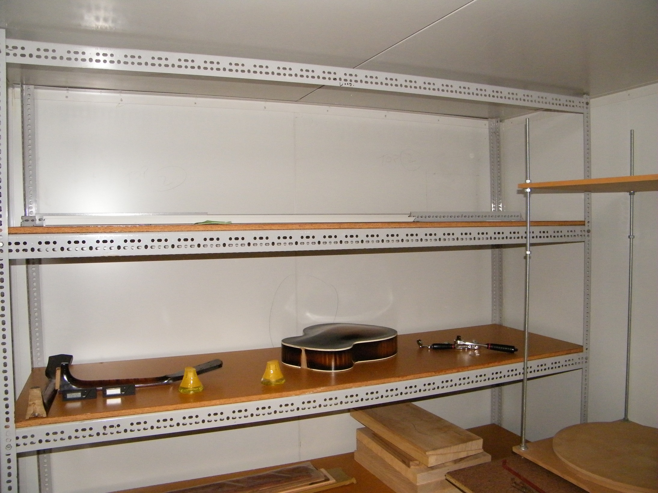

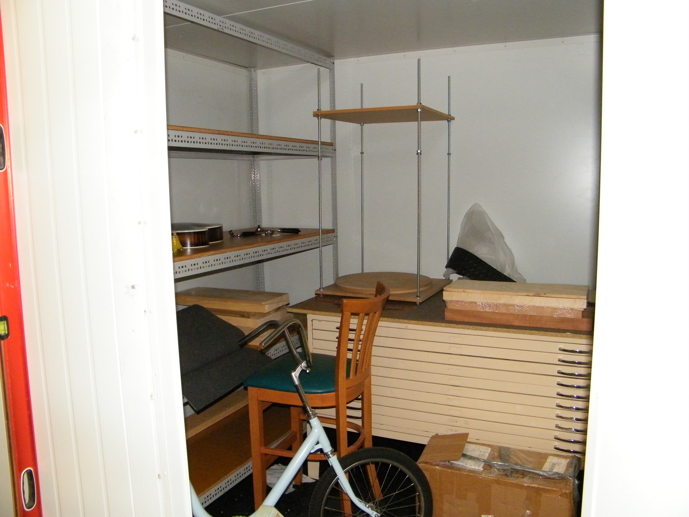

Cheers to Paul for his input on the construction process!
I'm now in the market for a dehumidifier so if anyone has any suggestions for a reliable unit to run in this small space it would be much appreciated.
Cost Breakdown -
50 mm freezer panel with a door - 2nd hand $300 (2.5m x 2.4m x 2.4m) - You could get this much cheaper if you knew someone behind the scenes
Aluminium for project - $300 - U channel for floor, 90 degree interior 40mm x 40mm, and door jamb
I cut costs by using pvc flashing from bunnings on the outside corner joins. It makes it look less professional but saved me about $200 in Aluminium. I put plywood flooring down on top of the concrete so it was less of a heat sink (will see in time if that was a good choice)
Tips:
-If you can keep the sheets in multiples of 800 then less cutting, less cost.
-The interior colour is generally an off white so if you are not fussed having mis matched exterior panel colours you can save some $$$. Especially if it is going to be against a wall or roof.

It's a worthwhile project Allan, Paul (Ozwood) said it took him an afternoon to construct his. I did the main walls and ceiling in about 8 hours with my dad (but we had a few walls that had to be inverted as the plans were wrong).
The corners are all butt joints and the center wall joins are tongue and groove so once you have got the aluminium U channel down everything slots together. We just used 2 pieces of 2400 x 1200 ply to make sure everything was square then double checked the diagonals.
Keep in mind when you are buying hinges that you have to rivet the hinges to the door jamb.
Stu
