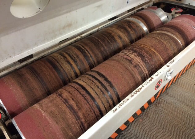

This is new paper I put on a couple weeks ago.
A mate of mine told me when he worked at a joinery they used to high pressure wash their paper!

High pressure washer gun does a fairly good job after soaking the belt overnight in warm soapy water.demonx wrote:This is new paper I put on a couple weeks ago.
Re: Carbatec Drum Sander
Seem to remember Kim put a bit of a tute up about cleaning gummed up grit strips? Came out like brand new if I do remember! I use a crepe dressing stick (Norton brand), makes a bit of a mess with crepe 'globs' all over the show, but cleans the grit nicely.
I knew the idea came from somewhere...yeah it was Kim's idea.Nick wrote:Seem to remember Kim put a bit of a tute up about cleaning gummed up grit strips? Came out like brand new if I do remember! I use a crepe dressing stick (Norton brand), makes a bit of a mess with crepe 'globs' all over the show, but cleans the grit nicely.

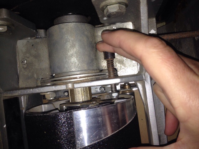

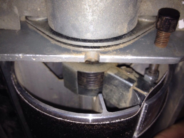

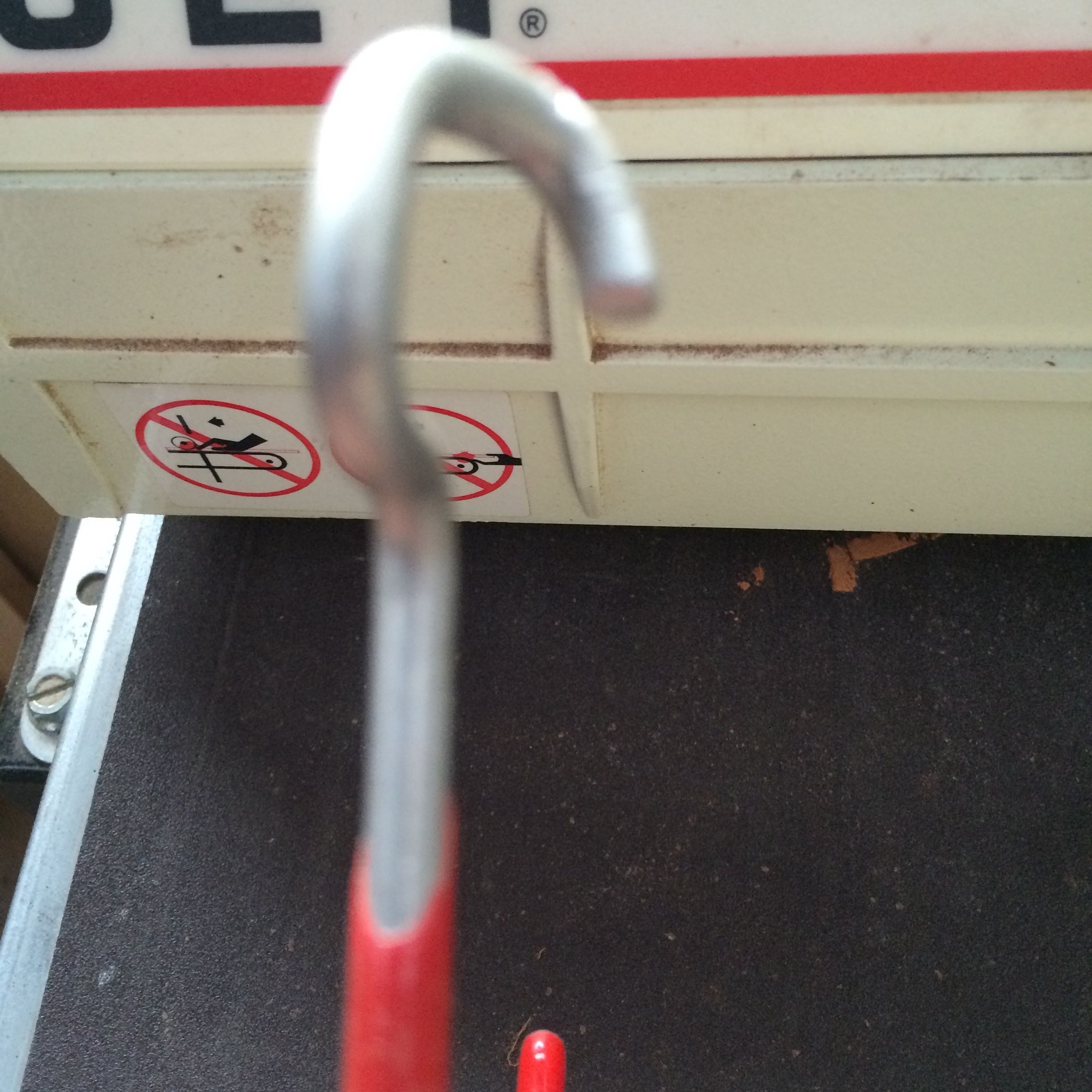

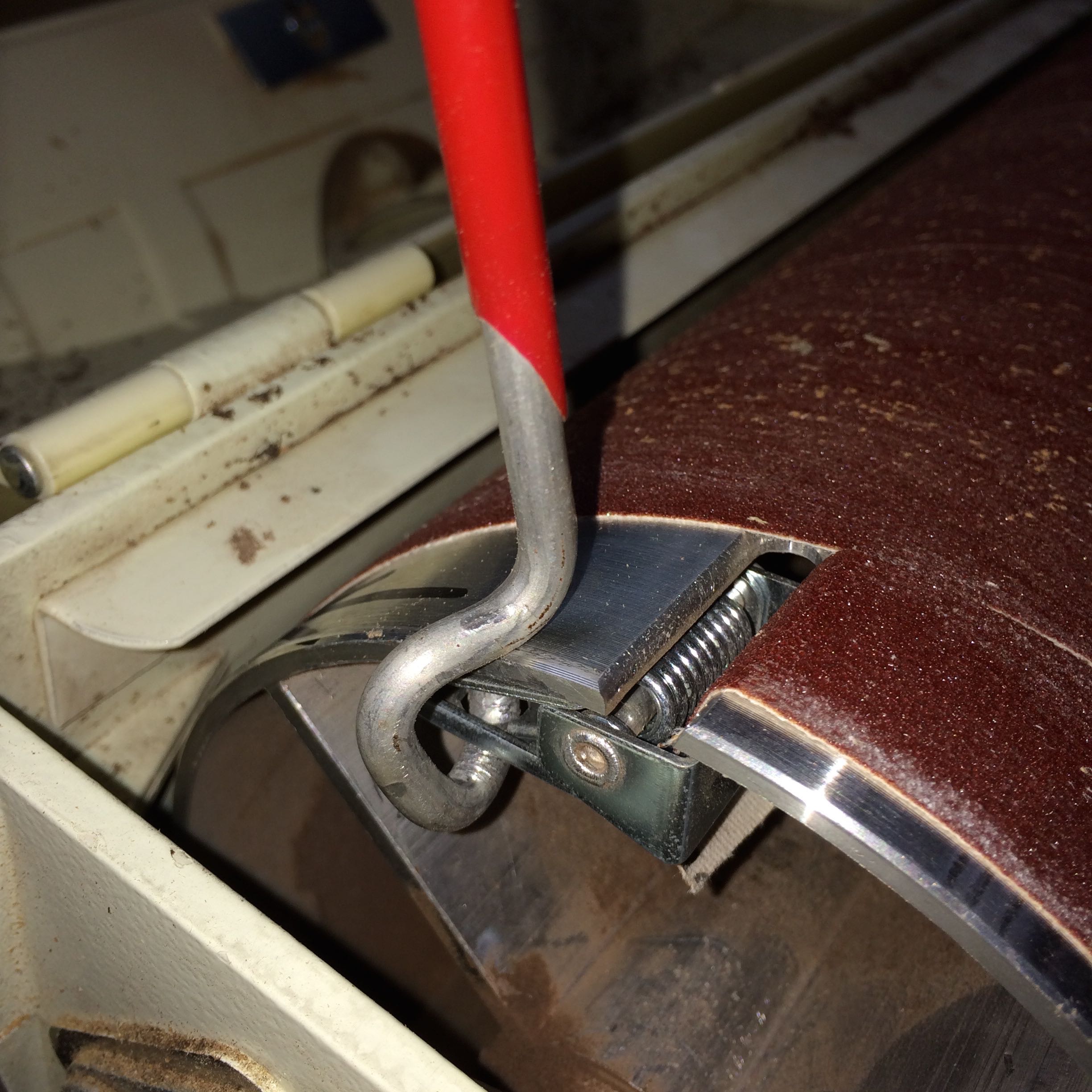

Have you guys got a spring-loaded pin on yours? Not as good as two free hands, but it gives you a bit more room and control to slide the paper in.
- image.jpg (75.52 KiB) Viewed 35716 times
- image.jpg (88.96 KiB) Viewed 35716 times

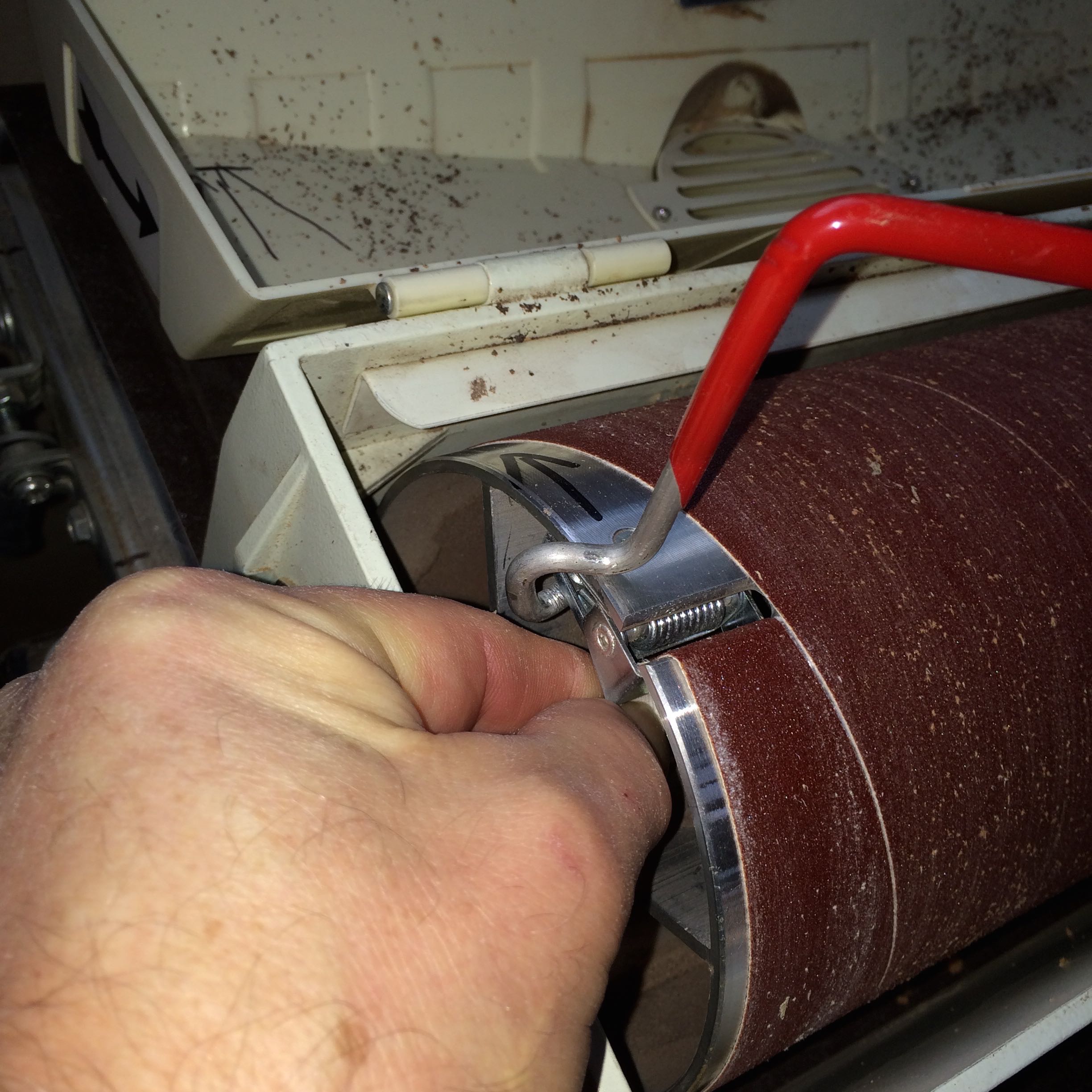

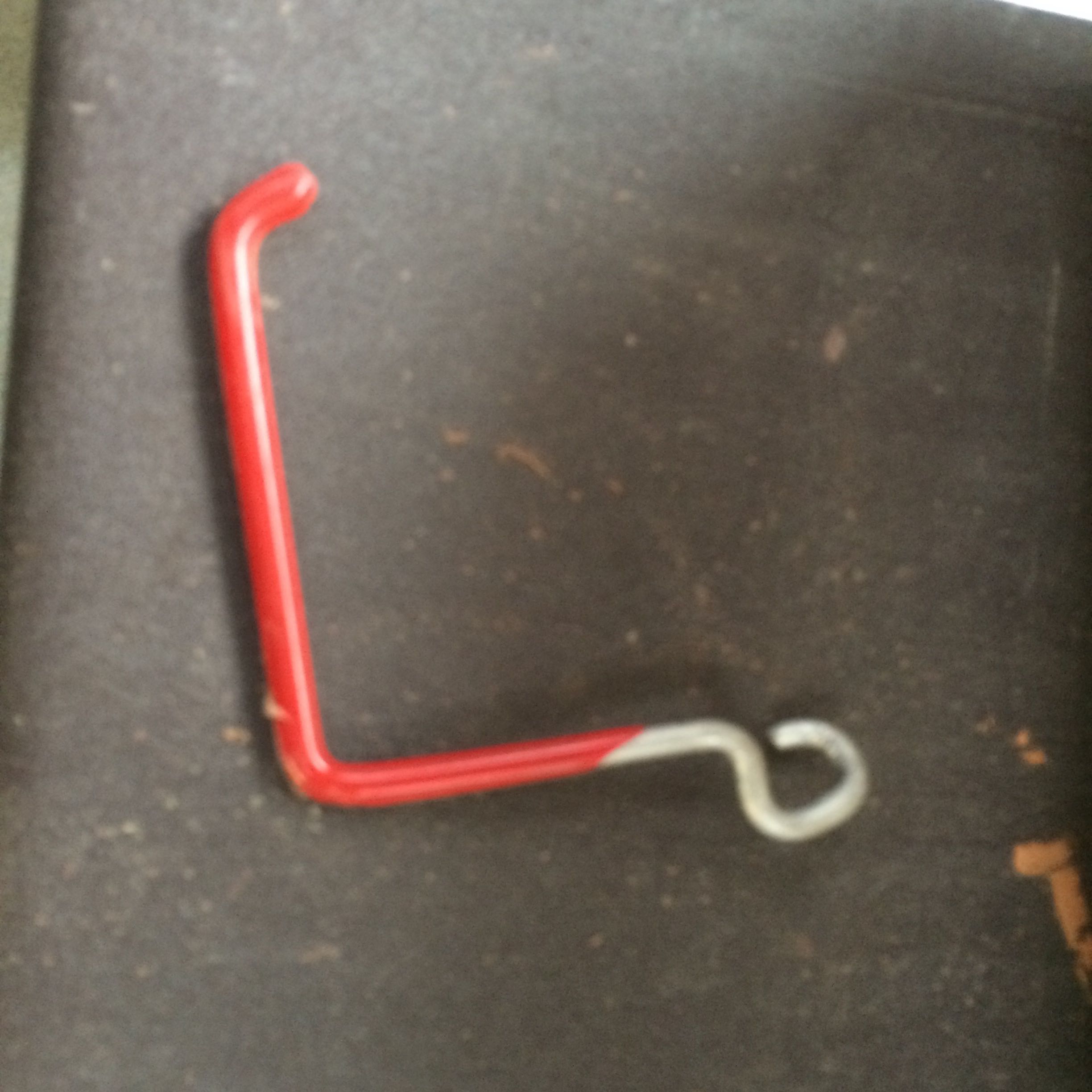

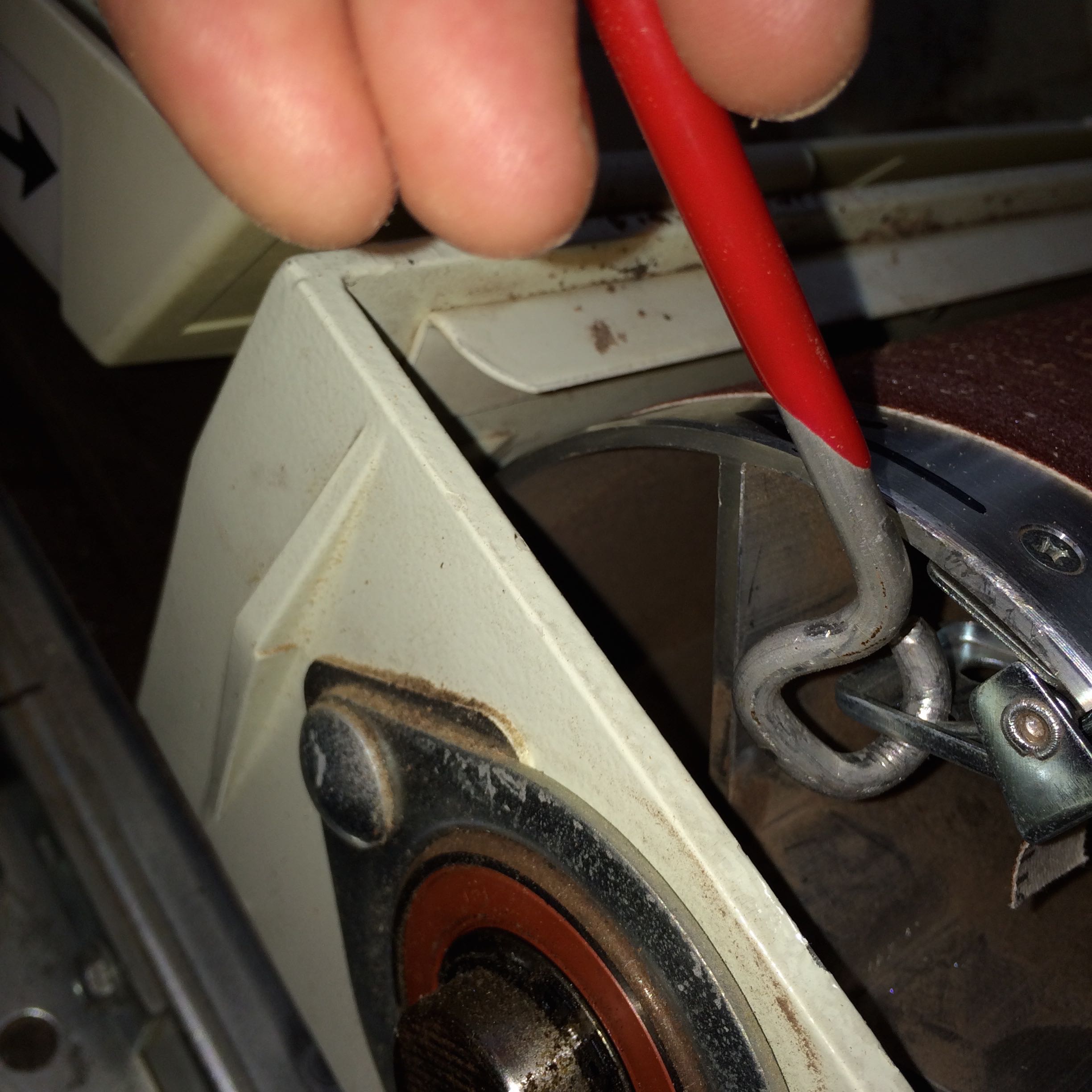

Pics of the hook device that comes with the Jet Performax Drum Sanders.
Hook is used to pull up and open the clamping mechanism.
The hook is twisted around so it rests on the drum and holds the clamping mechanism open.
With the clamp held open I pull the end of the sand paper through to ensure it's taught. The tool is then twisted and the clamp released and closed on the sand paper....while still holding the end of the sandpaper tight.

Thanks for the very helpful photos, I'll try to knock up some type of holding tool. I did try to jamb a screwdriver (that's what they're for isn't it?) and also a small clamp in at various times with limited success.
Cheers.
Cheers.
Ken
Haven't you got a six inch rule Ken?Crafty Fox wrote: I did try to jamb a screwdriver (that's what they're for isn't it?).
Thanks for the pics Martin, as you say, it's a remarkably simple tool, makes you wonder why the Carbatec version didn't have something similar, must only cost a dollar (if that) to include one.
