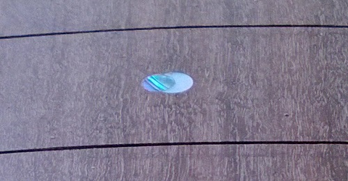

Not exactly what you want to do Todd but this worked fine for me.
dot markers.jpg (85.15 KiB) Viewed 27658 times
Matt

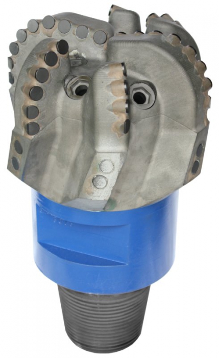

Don't muck around....get to work with one of these babies. Its an 12-1/4" PDC bit....cuts through rock like it's butter :)

Lex wrote:
Marty, could you get me one of those bits ,4mm please :lol:
Cheers and thanks
Tod G
6" is about the smallest size these bits come in.

kiwigeo wrote:Don't muck around....get to work with one of these babies. Its an 12-1/4" PDC bit....cuts through rock like it's butter :)
I saw one of them on the back of a truck yesterday; looks like someone's doing some fine inlay work up in the Pilbara!
Ken
Re: Fretboard Inlay
Post by kiwigeo » Thu Jul 02, 2015 8:41 pm
More likely to be heading offshore to the Browse Basin.....these bits are used in the oil and gas game. The round discs do the cutting and with no moving parts these bits have a much longer life than roller cone bits.
