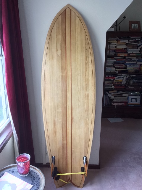

Paulownia with recycled WRC striping.
Looks lovely under jam.
Bends easily too!

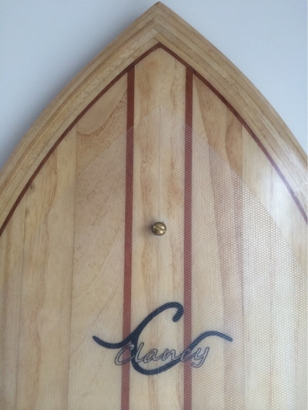

I reckon if you want to use paulownia for a S.S. Christian then don't forget the scratch guard.
Nice board Craig loose looking but what is the brass screw for, does it hold a set of handle bars on? Do me a favour and orientate that screw slot perpendicular or parallel with the stringer please.
Clancy
Posts: 620
Re: Paulownia Soundboard
Post by Clancy » Fri May 08, 2015 10:41 am
Hi Jim,
It is a tapered screw for venting when the board is not in use. (You screw it out only half way so you dont lose it!)
A ply 'fish-bone' frame is skinned with paulownia making a hollow board.
The air inside the board expands & contracts so the vent allows this to occur without damaging the board (apparantly the pressure can get high enough to crack the board even though its glassed)

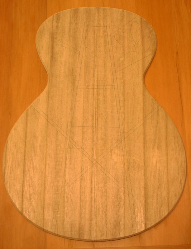

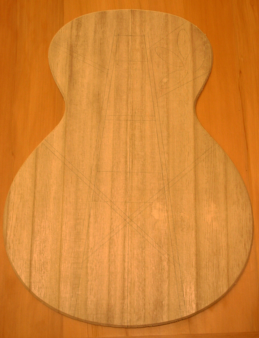

Post by christian » Wed Jul 22, 2015 5:12 pm
Finally got this Paulownia guitar under way.
After final thickness sanding the top came in at 3mm it's as light as a feather at 108grams.
I've glued up the back and sides, just have to brace up the top and add some lining.
Christian.

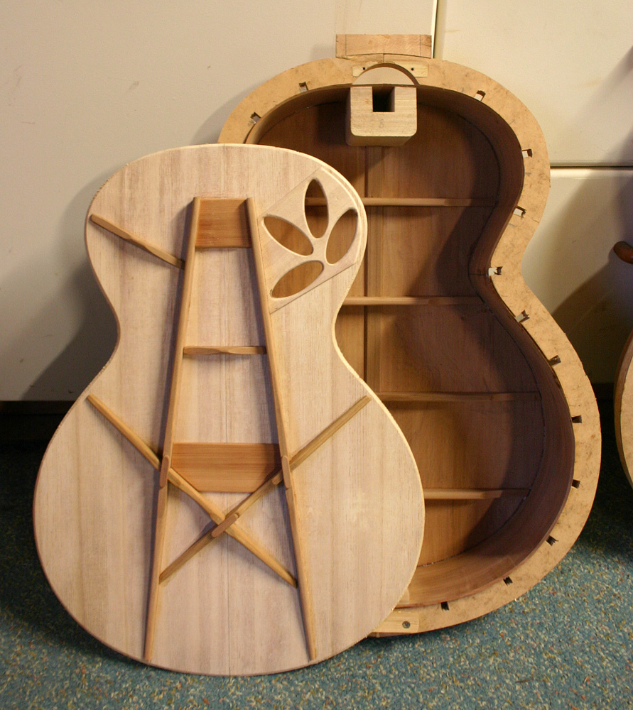

There don't appear to be any back/side linings?
Post by Nick » Thu Jul 23, 2015 10:07 am
kiwigeo wrote:There don't appear to be any back/side linings?
It's the new revolutionary "Kiwi" way, we can't divulge how it works yet (awaiting worldwide Patent confirmation) but it does involve fern roots and Kiwi poo, but rest assured everybody will be doing it this way in five years time and Christian will be raking it in on royalties! :P
Refer to last line in Christians post. :wink:

Ok yeah right but Im still intrigued....there appears to be glue squeeze out between the back and sides (see end of one of the back braces).
dotbot
Posts: 38
Joined: Sun Apr 05, 2015 7:17 pm
Post by dotbot » Thu Jul 23, 2015 10:58 am
kiwigeo wrote:Ok yeah right but Im still intrigued....there appears to be glue squeeze out between the back and sides (see end of one of the back braces).
Just a guess:
Christian does that nifty mitred-edge thing, so perhaps the back and sides are glued together and THEN the linings are glued in after.
Or maybe Nick is on to something . . .

Post by christian » Thu Jul 23, 2015 3:30 pm
And a good guess too Aaron! Sorry to disappoint chaps, no smoke and mirrors this time.
I add the linings afterwards because it's just much easier that way.
The top weighed in at 184g with all the WRC bracing, I must say it feels very much alive.
Hopefully it doesn't implode upon stringing up!

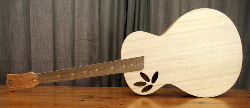

Post by christian » Thu Aug 06, 2015 11:48 am
Fast forward a couple of weeks, and its really taking shape now. I've kinda gone off shell inlays particularly Paua, so opted for a wood inlay
instead.
Christian.
