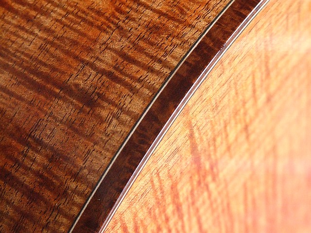

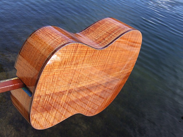

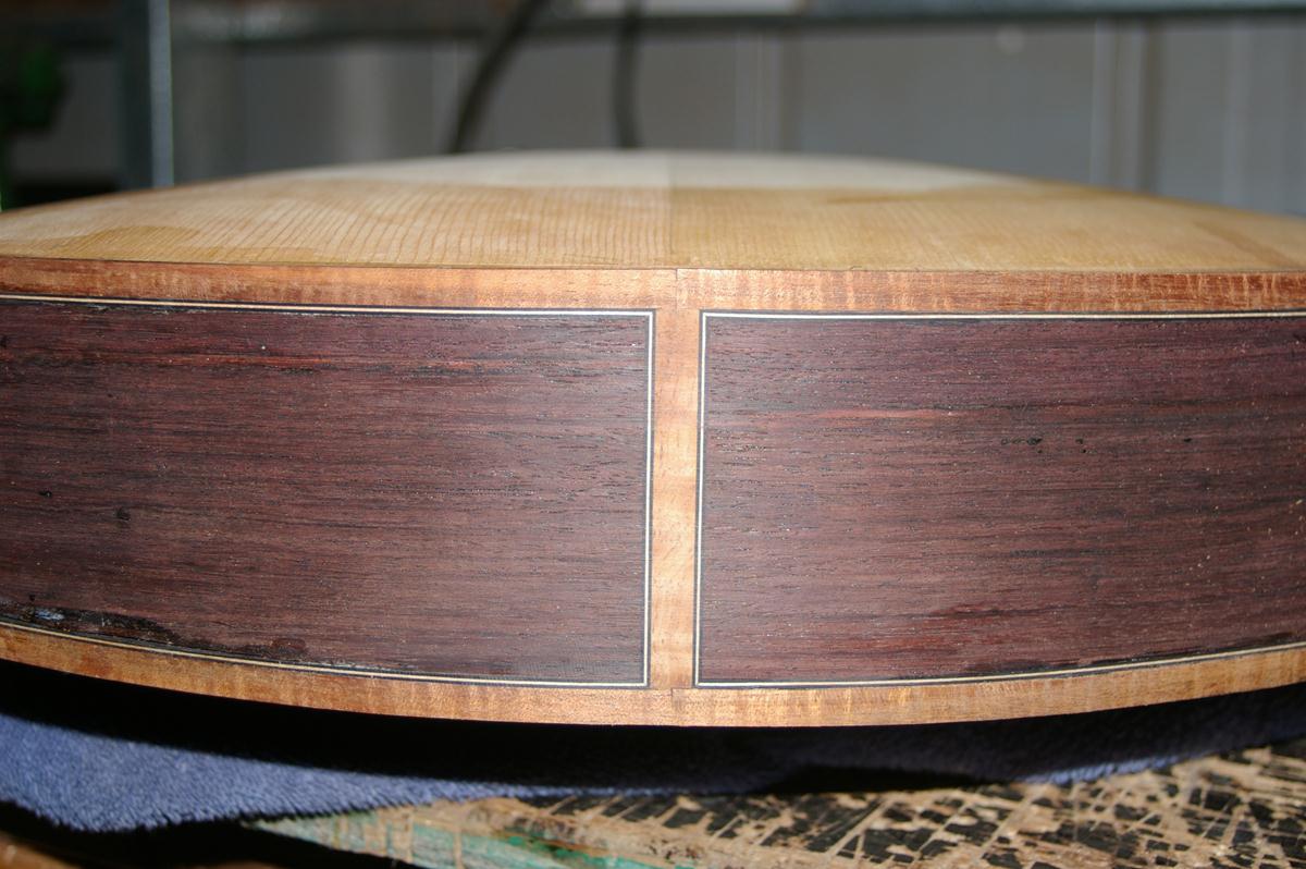

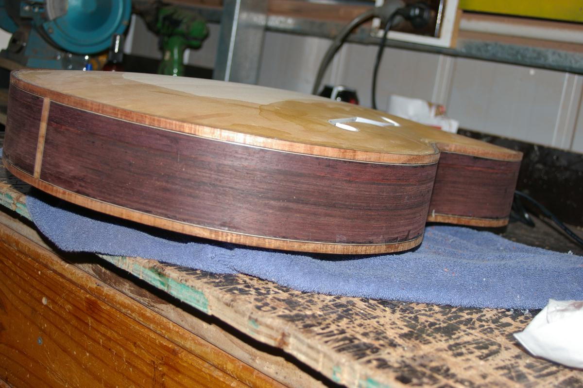

Tassie Blackwood bindings aren't too painful to bend. I do mine by hand on an iron. If the bend is a tight radius then make sure the binding is supported with a metal slat. Try using super soft or fabric softener to make bending easier.
The only issue I sometimes have with TBW is a bit of discolouration but a wash with oxalic acid or similar usually gets rid of the staining.
Attached is a current build..a parlour with TBW bindings.
Re: Bending wood alternatives...
Martin, thank you for your detailed infos, especially for the 2 photos!
Blackwood here in Germany is very scarce and ordering it from Australia is a bit complicated
because of the distance and shipping time.
So I just now have ordered a set of koa binding at a wood shop here.
I hope bending that will be a tad easier than snakewood.
I have only made one guitar until now (last year) which had maple bindings, a pleasure to bend.
Btw, do you use a router for adding a light curve on the top edge of the bindings -or is sanding sufficient?

To put a slight bevel on the outside edge of the binding I use a cabinet scraper....only a few passes are required. If you decide to sand the bevel in then make sure you use a hard sanding block behind the paper.

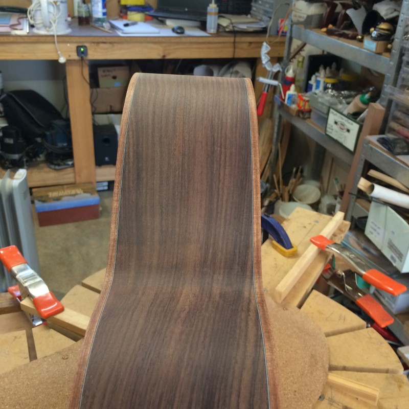

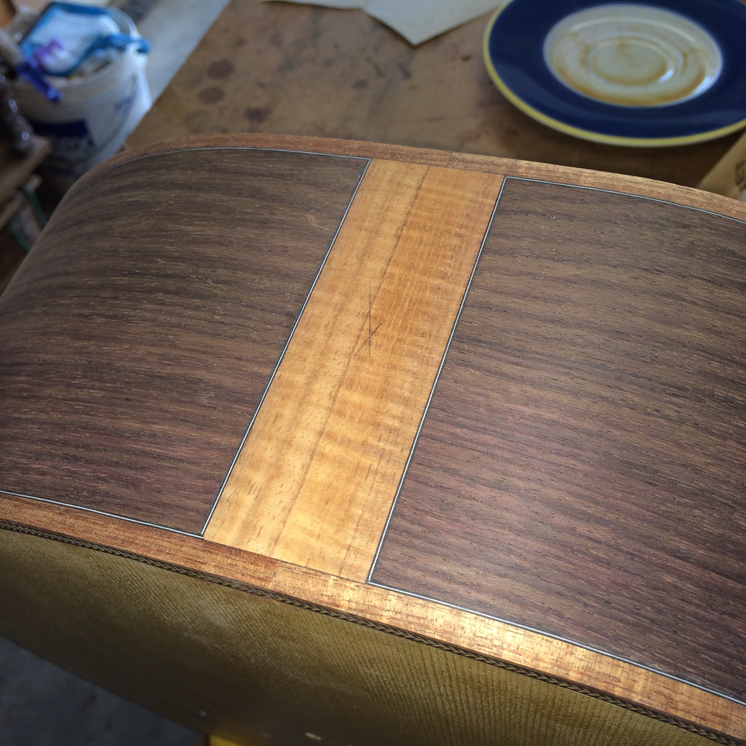

Here's some Koa binding, it looks very similar to Tas. b/wood. It can still be tricky on tight bends, I wrecked a couple of pieces before I got it right, both on the cutaway. I ended up soaking them in fabric softener. Wayne

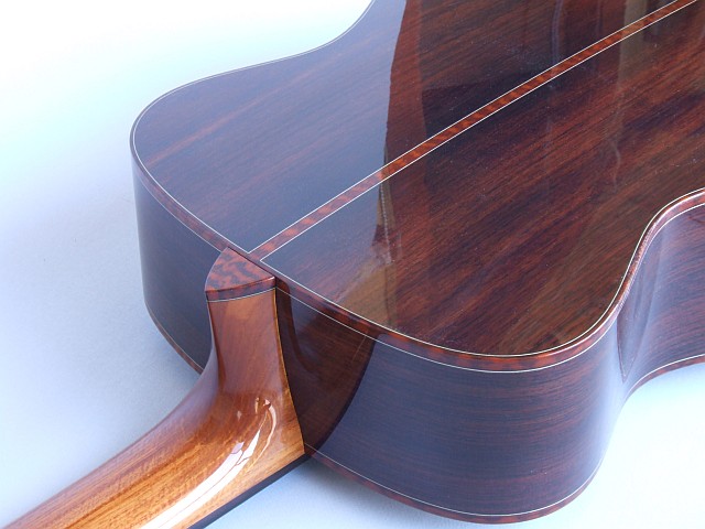

Sounds like you need more heat. Snakewood bends similar to bloodwood which bends similar to glass. You need to get it hot just short of scorching and then it goes plastic; then the curve sets like glass. Too many cycles and it gets really hard to bend.
If you want a real challenge, try bending this stuff for bindings (if you can figure out what it is!) Here's a closer look:
Blackwood doesn't need as much heat, but only dampen the insides of the curves on the figured stuff and watch for it kinking where the grain is really short through the piece. No softeners were required to bend these:If you want a real challenge, try bending this stuff for bindings (if you can figure out what it is!) Here's a closer look:
- DSCF6473s.jpg (125.4 KiB) Viewed 27958 times

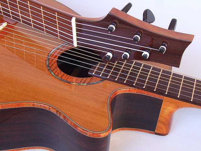

Yeah, I´ve got it
- at least the two first ones. Even the short binding in the cutaway isn´t too bad.
There´s the last tree bindings awaiting for their hot treatments.
One is still taking it´s bath in a mixture of fabric softener and water since yesterday evening.
I have got a spare one if it doesn´t work.
You can take look at them if you want:
here a touch of naphta brings more of the pattern and the yellowish/brown colors of the muninga wood
I still have to sand and then do the pore filling...
