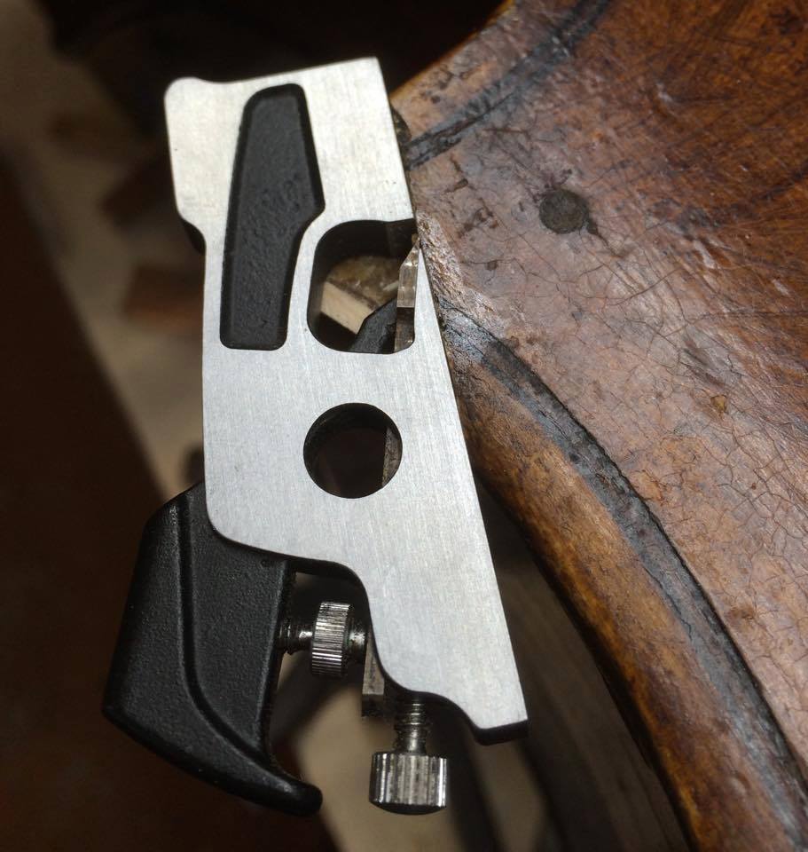

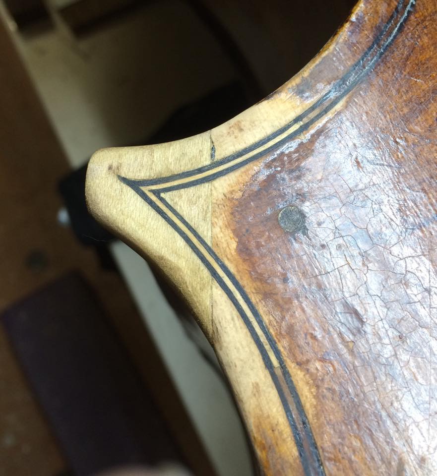

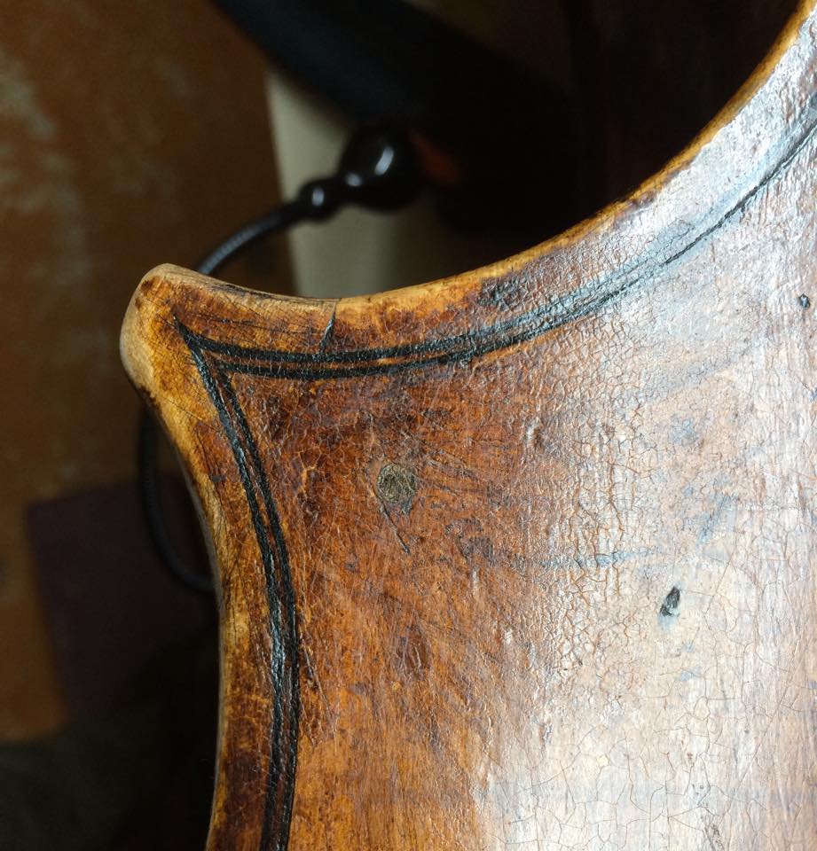

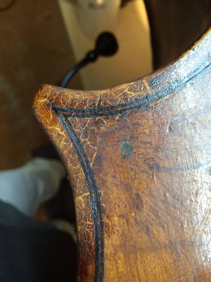

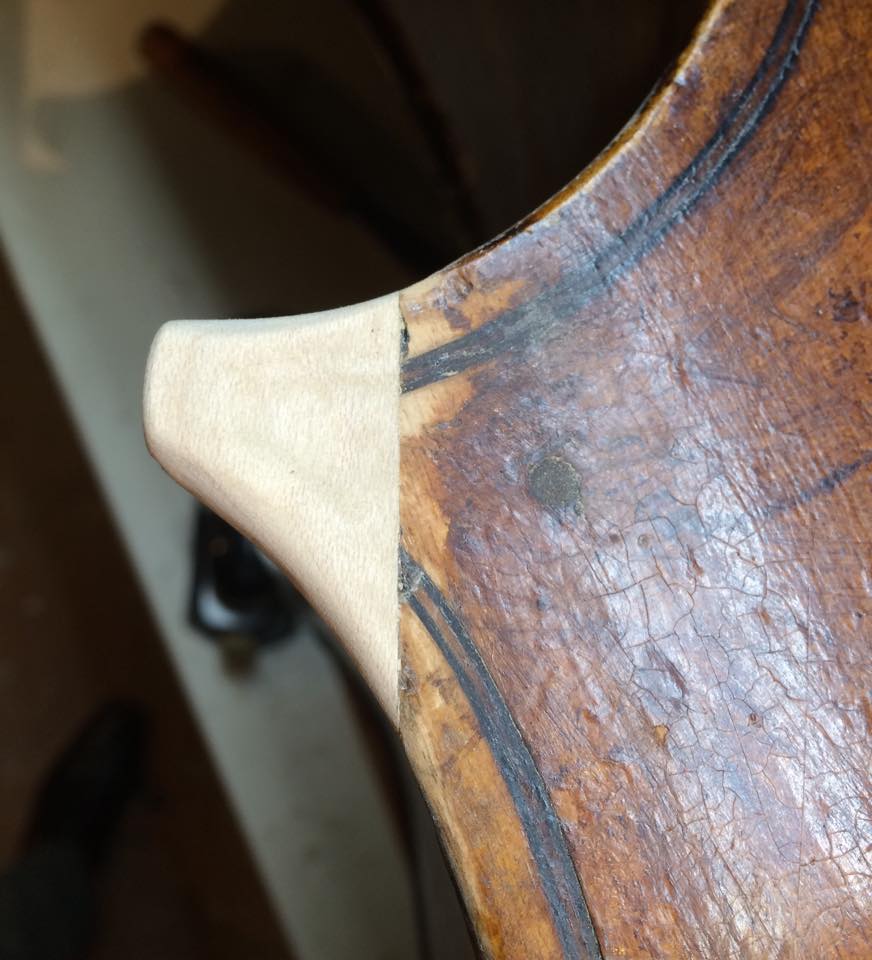

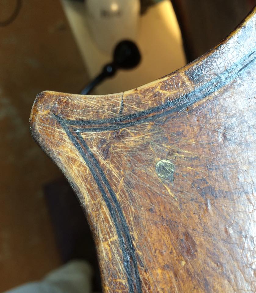

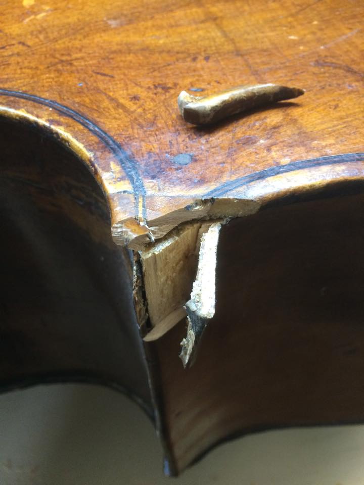

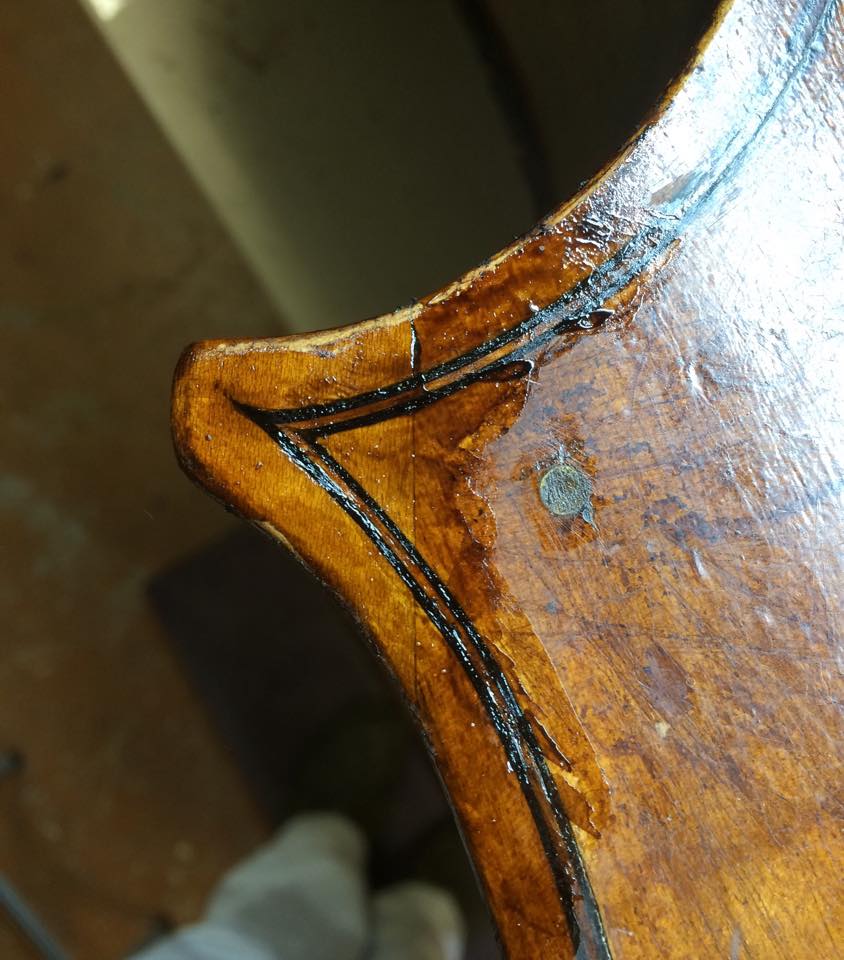

Here's a quick recap of a corner replacement on an approx 150 year old double bass.
The corner had already been chopped off diagonally by another repairer, but it was shoddily done, and it crumbled apart. If I had been replacing the corner for the first time, I would probably have tried to cut the damaged corner off in sections along the wood grain lines,instead of one diagonal saw cut. But as you can see, I think I hid the repair quite well.
Hide glue, shellac and custom made purfling ...
Getting the wear and cracquelure looking nice is quite a challenge.

And you mastered it very well!matthew wrote:Getting the wear and cracquelure looking nice is quite a challenge.
May I ask how did you achieve that cracquelure?
- matthew
- Posts: 1193
Re: Double Bass corner restoration
you have to use something that shrinks as it dries - like a clay pan - over a soft varnish layer. it's hard to control. too thick and you get massive cracks, too fast and it pulls away, too soft ditto, too thin or too slow the cracquelure doesn't work at all or it is too fine. too hard ditto ... a lot of trial and error.
I use a mud made of van dyke brown crystals. it washes off after. experimenting with other things ... fine clay might work well.

Thank you Matthew for describing this most interesting technique. I didn't even know what van dyke brown crystals are or that they existed. It would not be you if you hadn't experimented until getting this technique down to perfection. Congrats again!

i didn't invent the technique; I heard about it ... but there is very little published information on it. it's one of those things you either have to learn by watching someone else - or experimenting!
Oh and ... I haven't "perfected" it ... but I'm getting better at it.

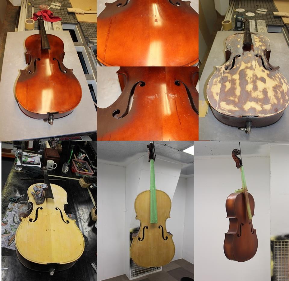

Here is a cello top I painted yesterday.
Before I did the work, there was 17 repaired cracks, and a graft of new wood.
I simply was making a point, I make recommendations and then do what the client wants, we average at least one restoration per fortnight, and that is strip to bare wood and full respray with all refurbished parts, be that from a guitar family tree or violin family tree
If I let my beliefs and feelings get in the way, then we would average no restorations ever, and simply do patch up repairs
My point, was not to knock your work, I found your repair very good. But we all approach things from different view points

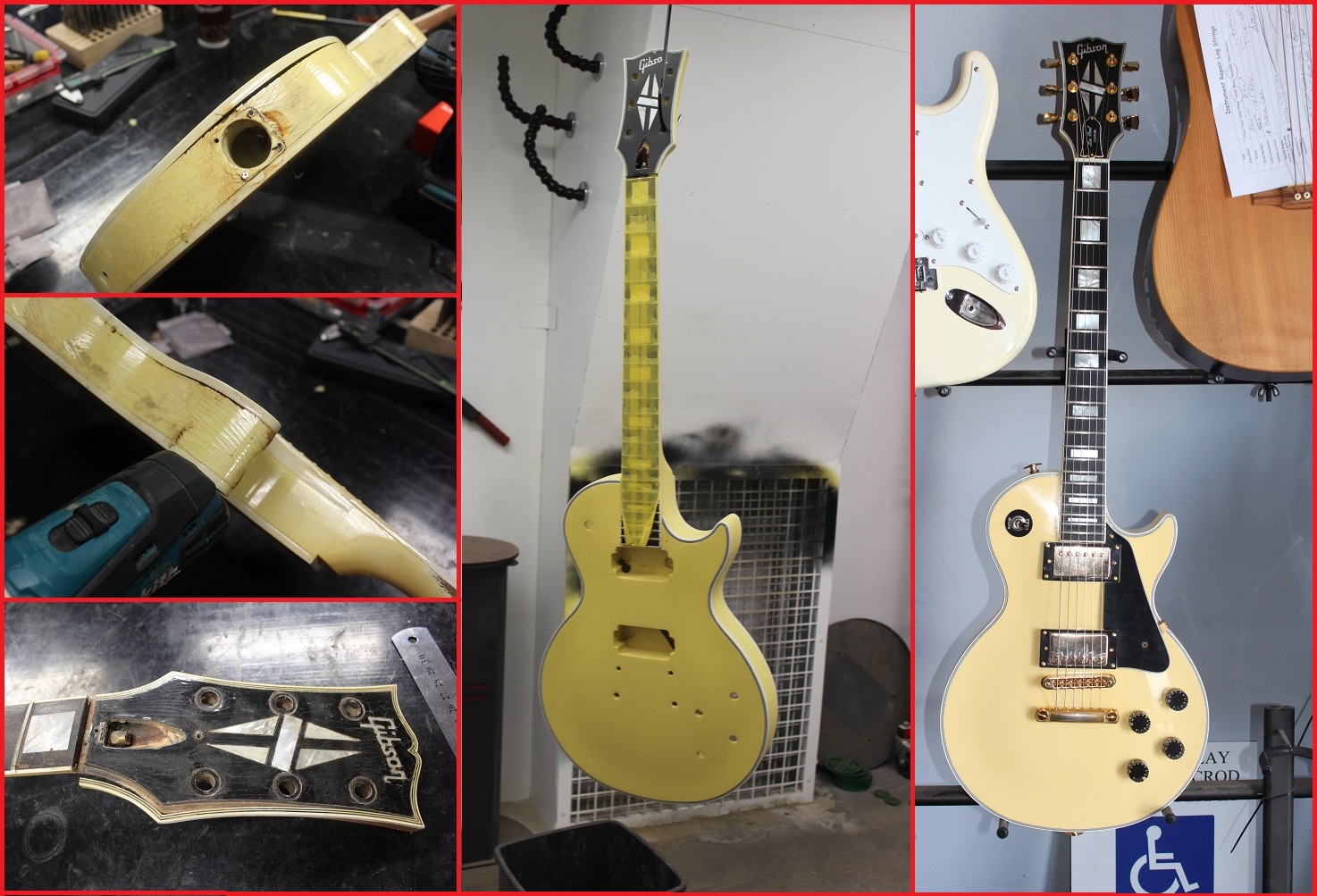

The Gibson above, the guy actually cried when he picked it up (that happy) there's more value to an instrument than individual groups perceived worth of that model of instrument.
