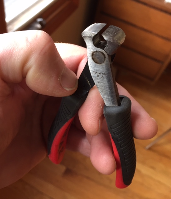

These are my pullers. A pair of inexpensive end cutting pliers - less than $10 here in the US from the hardware store.
The tops have been ground down flat.
Use plenty of heat when pulling, I use an old soldering gun. After heating try to gently squeeze the cutter jaws under the crown. Don't squeeze too hard, when they are ready they should go under without too much force. The angle of the underside of the cutters will work as a wedge. Once they go under, don't pull up and don't rock, move the pullers along the fret and nibble it up with small bites, you may have to add more heat.
I hope that makes sense.
