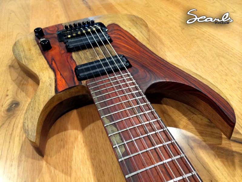

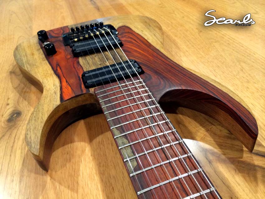

Building this Cocobolo guitar at the moment.
Used Titebond on a fresh joint.

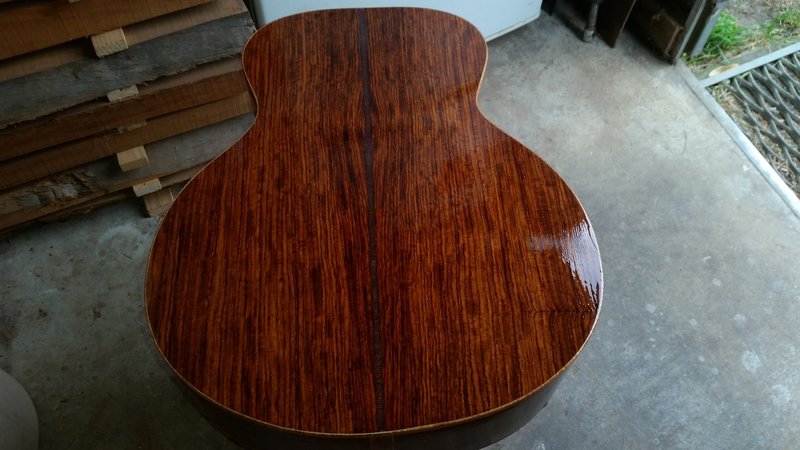

Cocobolo, use epoxy.
Titebond "could" work sometimes, epoxy "will" work.
Attached pic I used Cocobolo for the top, board and binding. Epoxy as adhesive, no issues.
