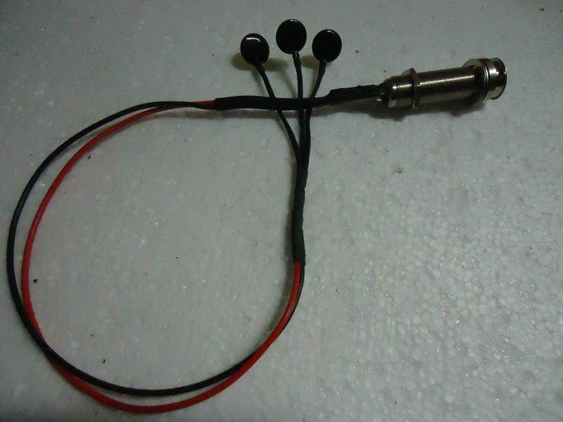

A guy who bought one of my guitars("Rose Cliche") asked me to install a K & K Pure Mini, He bought it from our one and only music shop at about $240.
I thought it would be a good opportunity to make a faker pure mini and put it in the guitar I play which is similar to his and compare the El Cheapo to the real McCoy through the same pre amp and amp.
I bought 20 discs for three bucks and some potting epoxy for eleven so it looks right but am chomping at the bit to be able to do a side by side comparison. Will reply here with a opinion once I am done.

This should be an interesting test, I have wondered if there is anything special in the discs. May I suggest that shielded cable will be mandatory, a break in the shielding between a piezo and pre amp / amp will introduce heaps of noise.

I should add that I had assumed that shielding would be needed and I do have shielded wire so maybe I should re-make it with shielding.

So make it again with shielded wire, trouble is the shielded wire I have(the smallest I could find) is heavier than what I used and I had considered that. The wire is thin but the flex is thick giving it the extra weight.
Okay so you reckon that when it come to these discs the ceramic may differ from disc to disc making for higher or lower output.
The last time I used cheap discs I used wire without a shield and when plugged straight into a electric amp the noise was low, certainly tolerable.
So thanks for the heads up guys I will go borrow that guitar(with the cheap un-shielded discs) back and see how it sounds using the K & K Pure XLR preamp with the same amp and decide if I need to further buggerise around to get a reasonable plugged in sound.

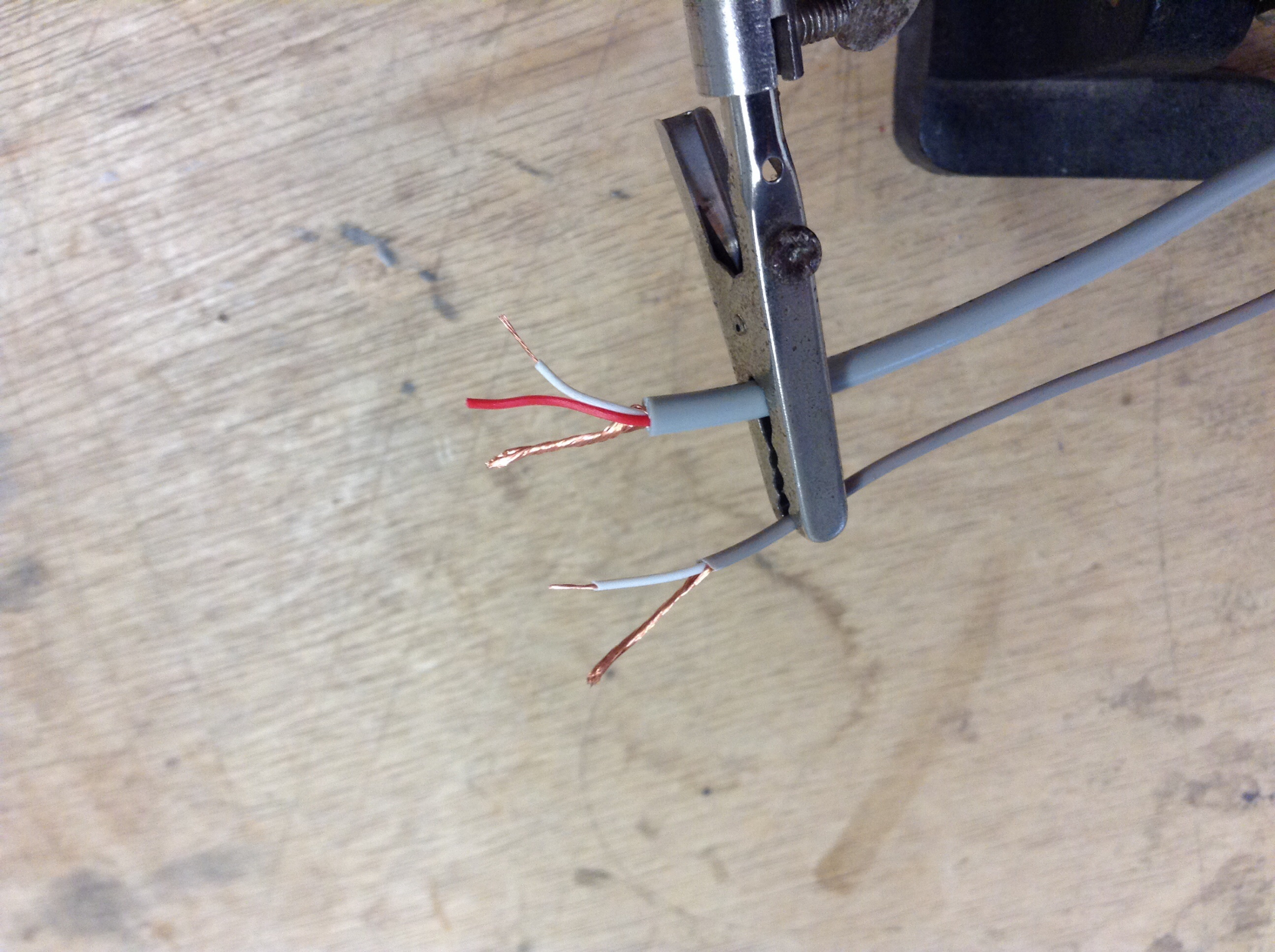

Re: Faking the mini
Hi Jim,
I have this coax, it was only available from the big guys in 100M rolls. The core is 10 x .12, 1.6mm outside diameter. The other is Jaycar dual core for comparison. Don't know if it suits but will be lower mass, makes me wonder why K&K don't use something smaller.
Happy to send you some if you like,
Garry.
Garry.

Cheers Gary, a couple of metres would go a long way if you can spare it. The 3mm stuff I have is the Jaycar single core and I could only find the equivalent on the net.

Cheap RCA stereo leads work fine as a source of lightweight shielded cable in my experience

Good thinking Jeff, I went through the old PS2 box and found some at about 2.4mm so that's a little better than the Jaycar stuff.
