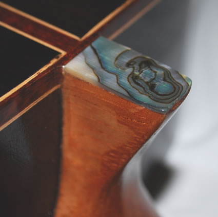

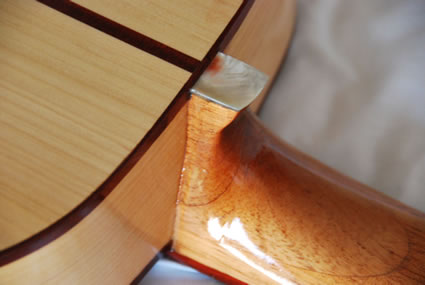

That heel looks like it was done after (or even during) a night on the piss. Whats with the cap??? Looks like a piece of shell has just been slapped on and no attempt to tidy things up.

Re: Interesting reading
Here you can still see the sanding marks in the pearl I would not pay the money he's charging for shoddy work like that.
His work manship is horrible!
Example: http://www.guitarmasterworks.com/images ... _inlay.jpg
And those heel caps. OUCH!
