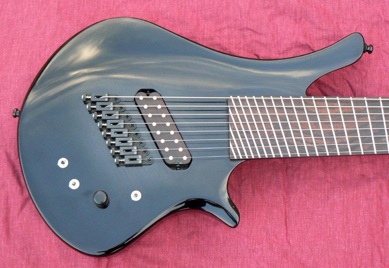

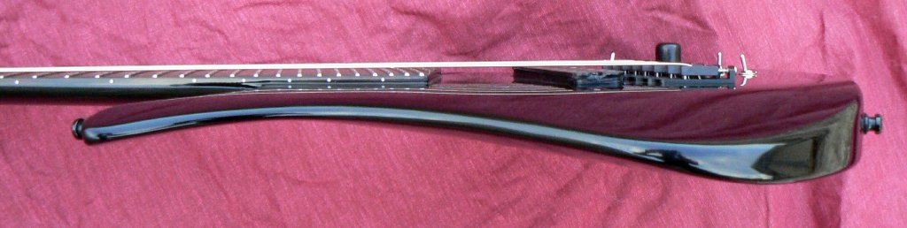

I don't think the tenon and neck is one piece. On all the pics you can see a sort of gasket or joint between them. Also the neck veneer - if it is that - is laid up impossibly neatly around such at 90degree joint. I think it's bolted on somehow. I think the tenon, and the mortise it slides in, are CF, the block being built up around a preformed CF socket.
Just speculatin', of course.
Re: Ken Parker Guitars
In the image immediately above with the gold block, I see what you mean about the gasket at the neck and neck block Mathew but that could just be the way that the gold leaf is laid up. Downloaded this Image, the first link from Allen's post and then magnify. This looks like it 'may' be one peice and is the image I was referring to when I mentioned the feathering in.
Of course there is no reason why this part of the construction could not have been tackled in a number of ways and perhaps what we are seeing is MK1 and Mk2?

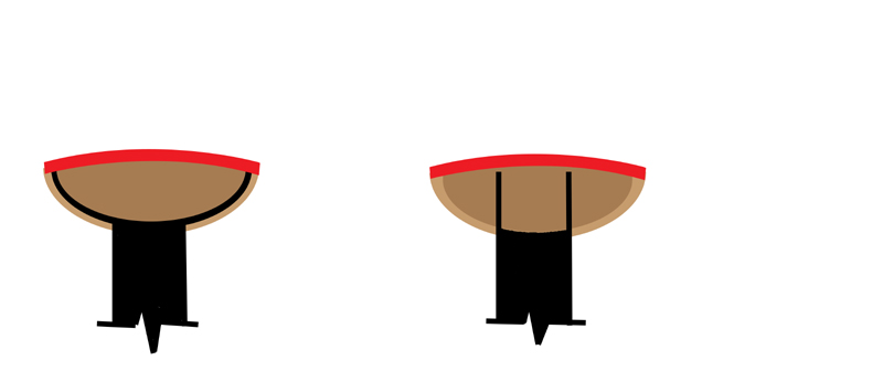

I thought the article was suggesting something like the drawing on the left but I was guessing it would be more like the one on the right. The black being the C.F.
My take of a few of the descriptions I've read (all a little bit vague) is that it was like the one on the left Jim.
