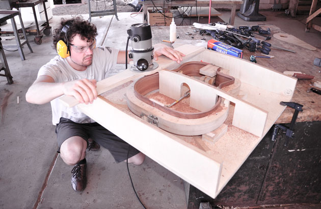

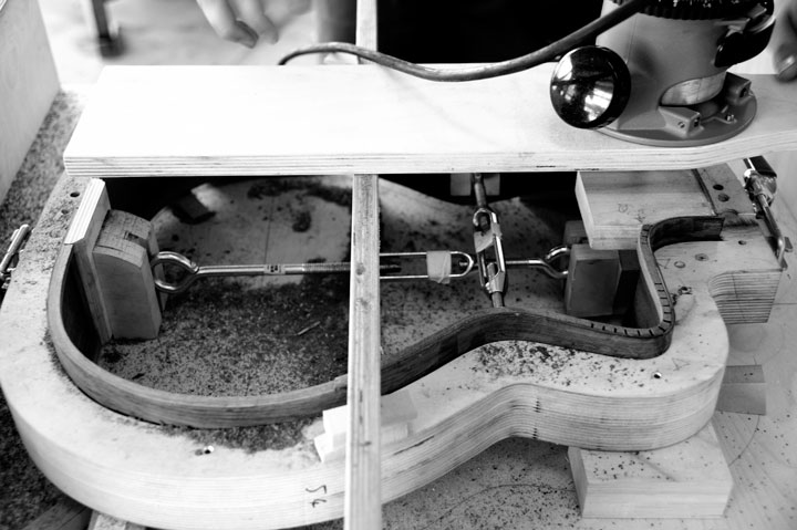

Just to expand on this topic a little: I use an iPhone and have a free app on it called "radius calc". There are also online calculators which can be used. An interesting method for profiling the liners using a router and jig is as shown in a photograph on Michael Collin's website (Michael wrote the book Building A Selmer Maccaferri Guitar). Selmer guitars due to the pliage, have a compound edge profile where the top joins the sides.http://collinsguitar.com/first-week-of- ... ng-course/

blackalex1952 wrote:An interesting method for profiling the liners using a router and jig is as shown in a photograph on Michael Collin's website
Considering the linings and sides can be profiled with a block plane then finished with a sanding stick in under 5 minutes, what's the point of setting up a jig and router? 8)

felix:Considering the linings and sides can be profiled with a block plane then finished with a sanding stick in under 5 minutes, what's the point of setting up a jig and router?
I am guessing that the reason for using the jig in the photos I posted on the Selmeroid designs is due to the pliage and neck angle requirements of those particular guitars. The sides are straight, although the back and top are not parallel at the sides. The pliage and the neck angle along with the arching (because the brace curvature varies) requires this, I assume. Otherwise yes, why go to all that trouble. That is one of the reasons I posted this. To invite comments from experienced builders. Getting a perfect glueing surface on the side to plate joins also would mean that the liners can be finer, perhaps, and that there are no voids that would difficult to see with an inspection mirror, resulting with joint failure down the track. If I am correct, it may be a good method for instruments built on a solera with compound radii on the plates and high arching.I have wondered about this jig and peered at the photos....I just realised that this might have to become a separate discussion to the original question...sorry if I have taken the thread off topic.
