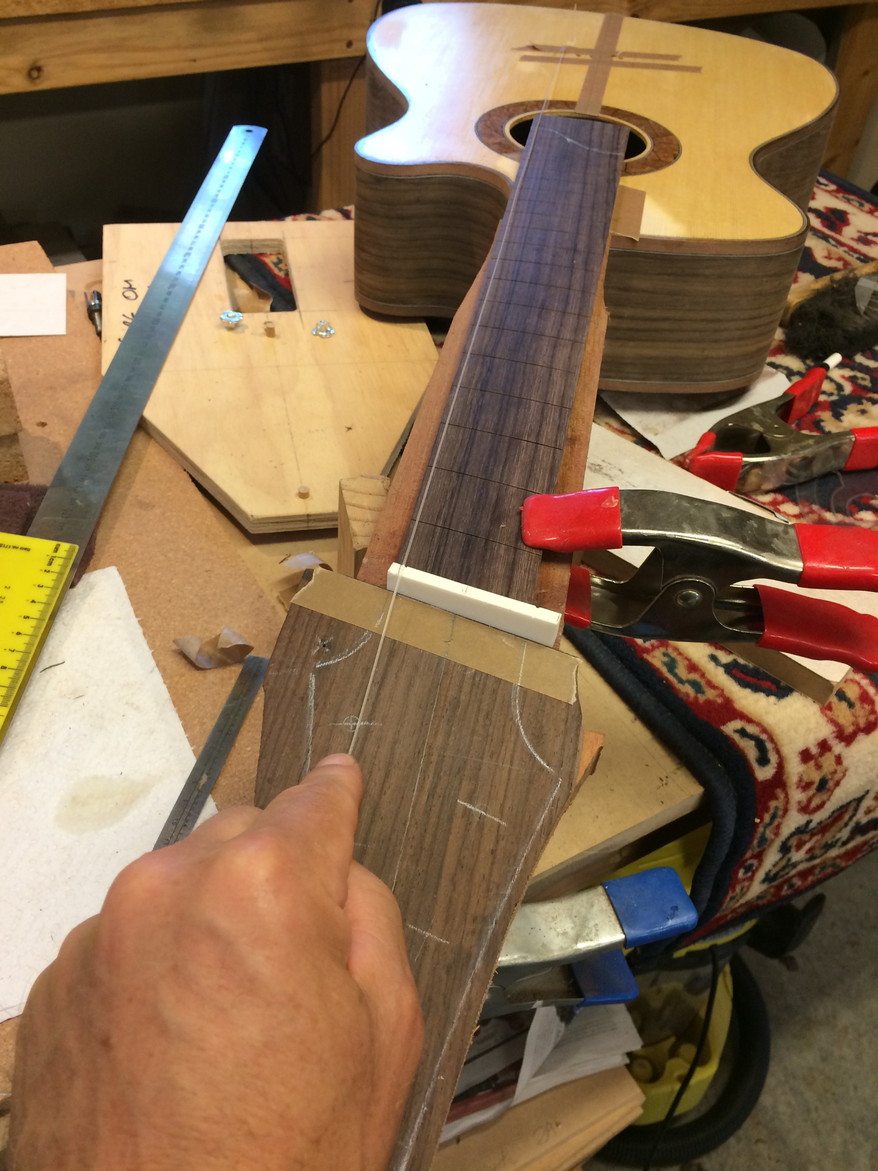

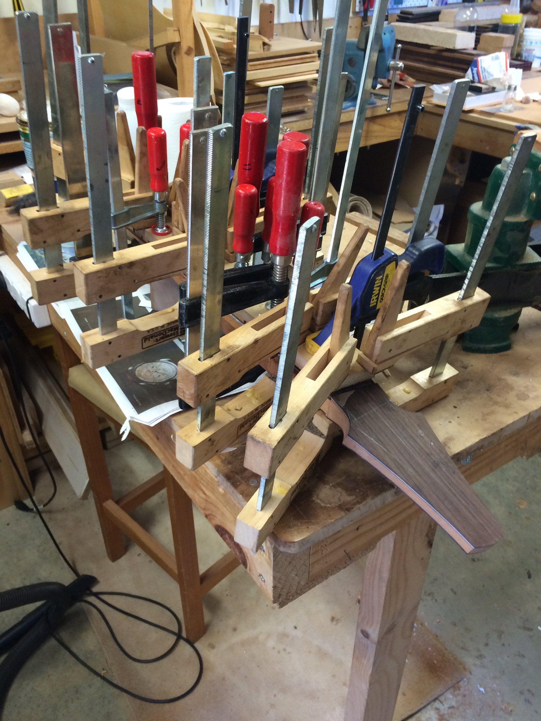

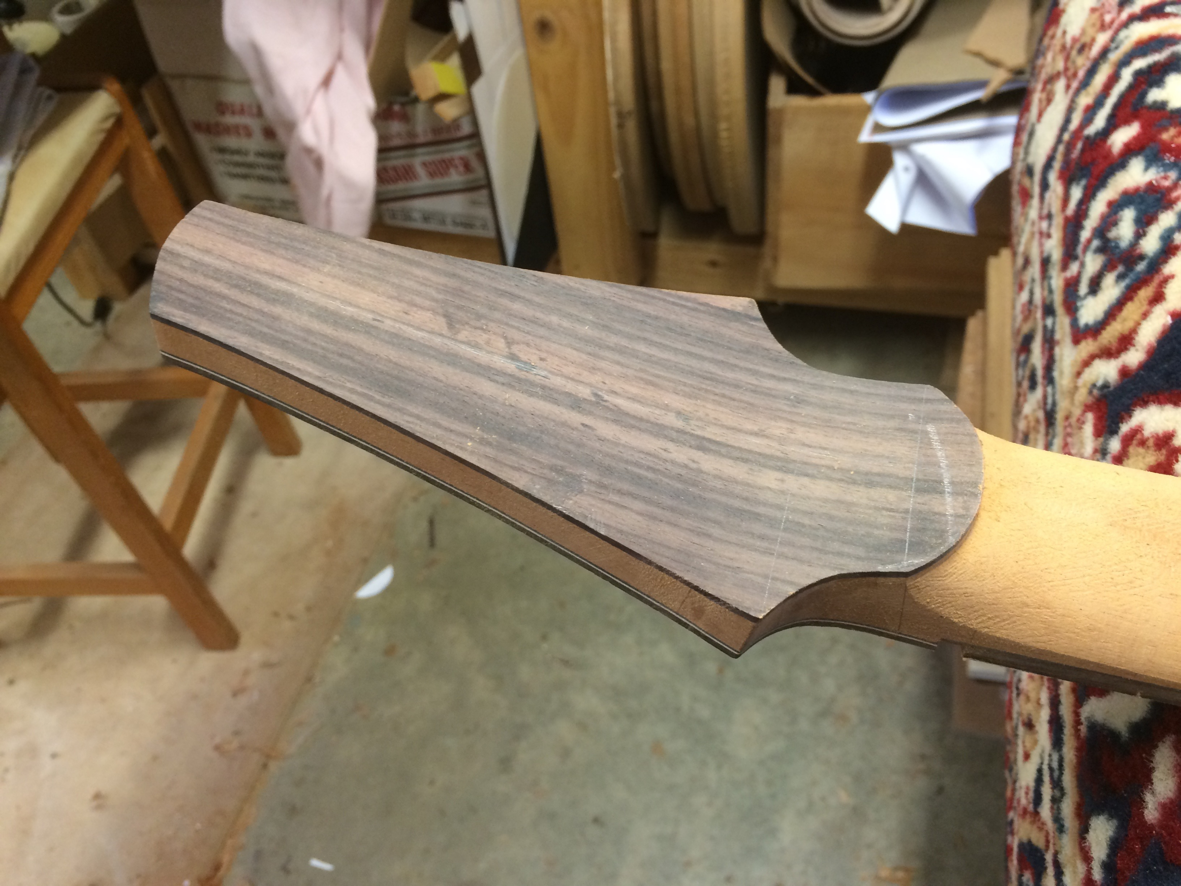

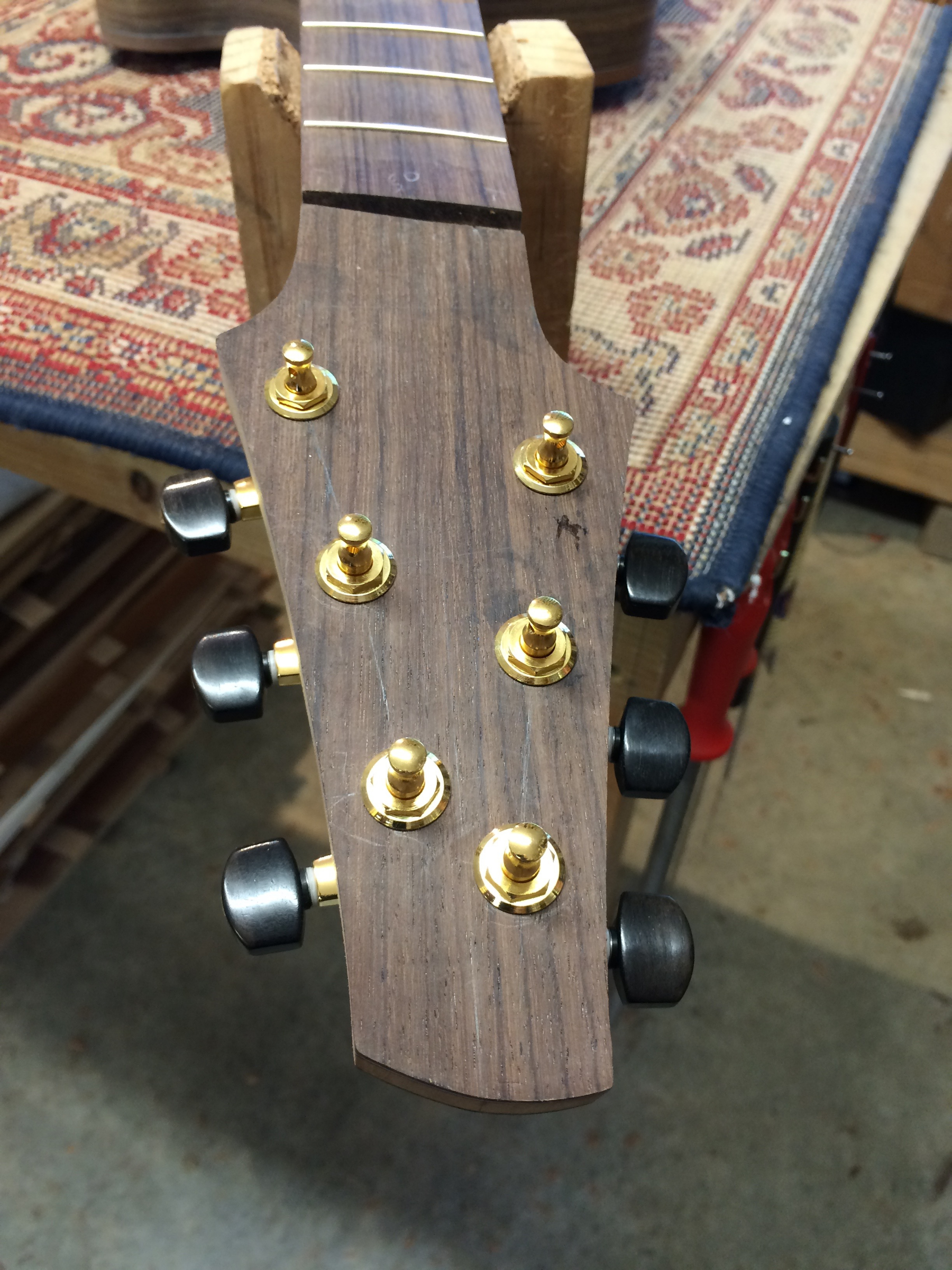

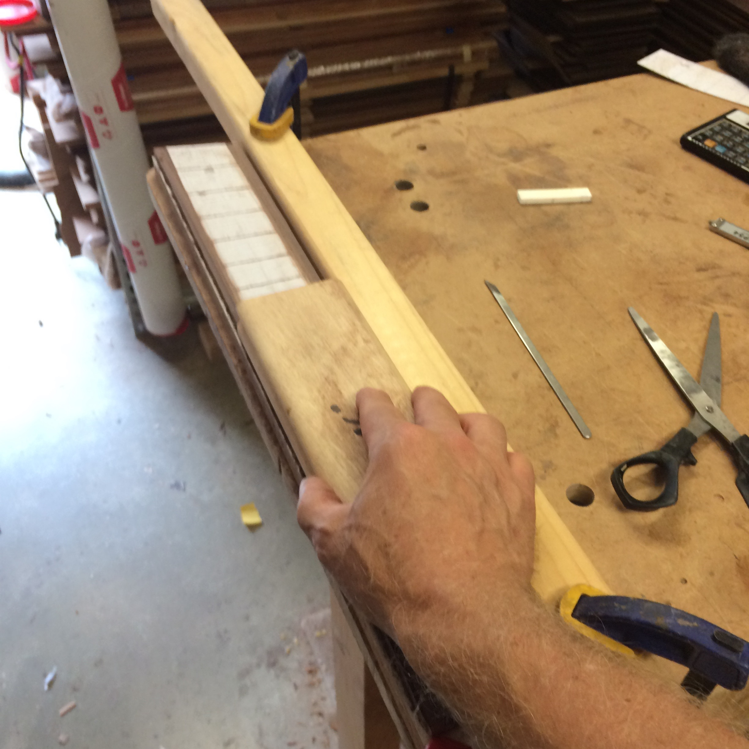

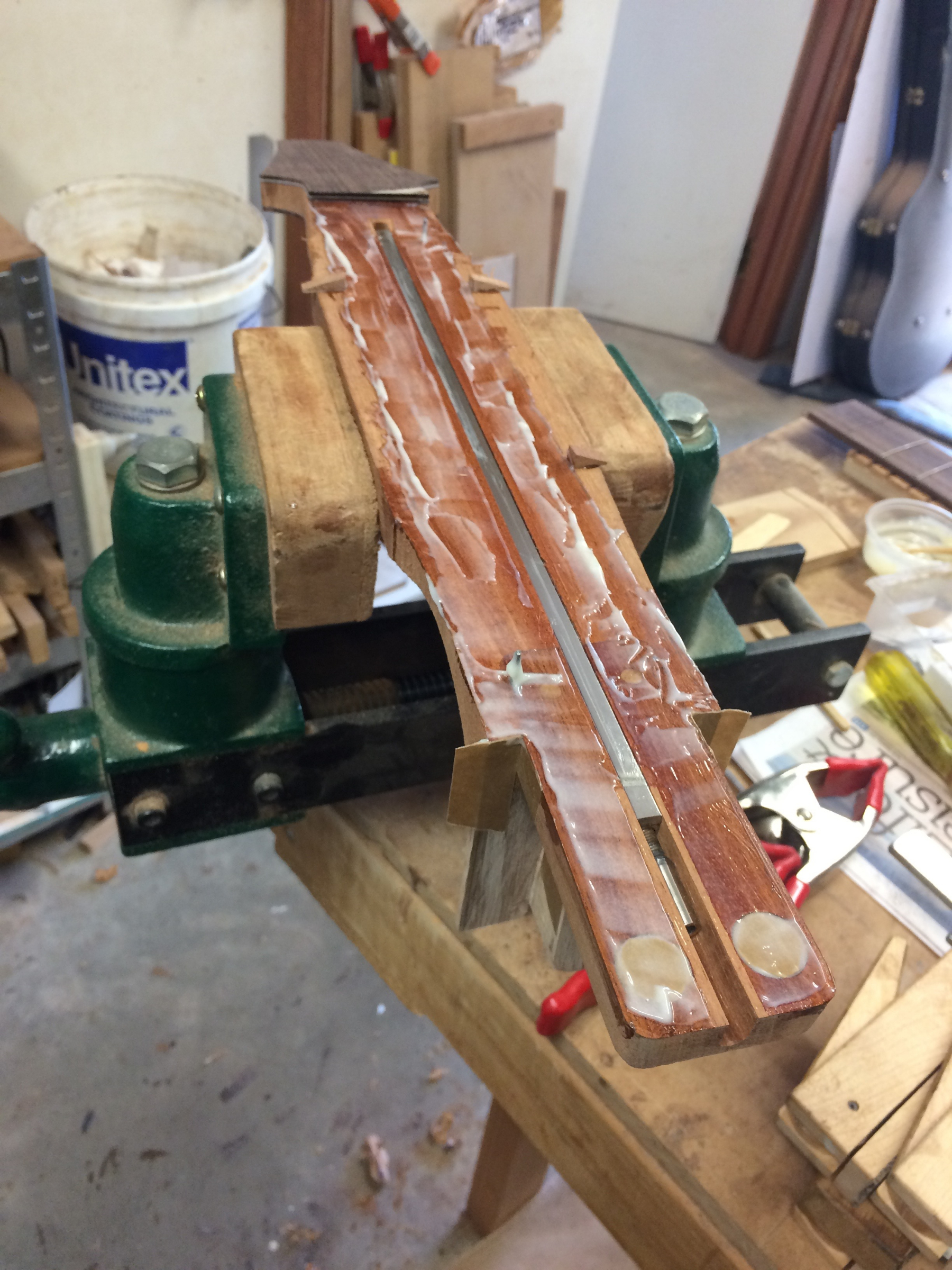

Over the last few days I managed to get the neck boltware sorted and the fretboard slotted. Currently Im waiting on a double bearing router cutter to cut out the headstock. In the meantime Im doing my head in thinking about headstock volutes.....one of my Archilles heels when it comes to guitar making.

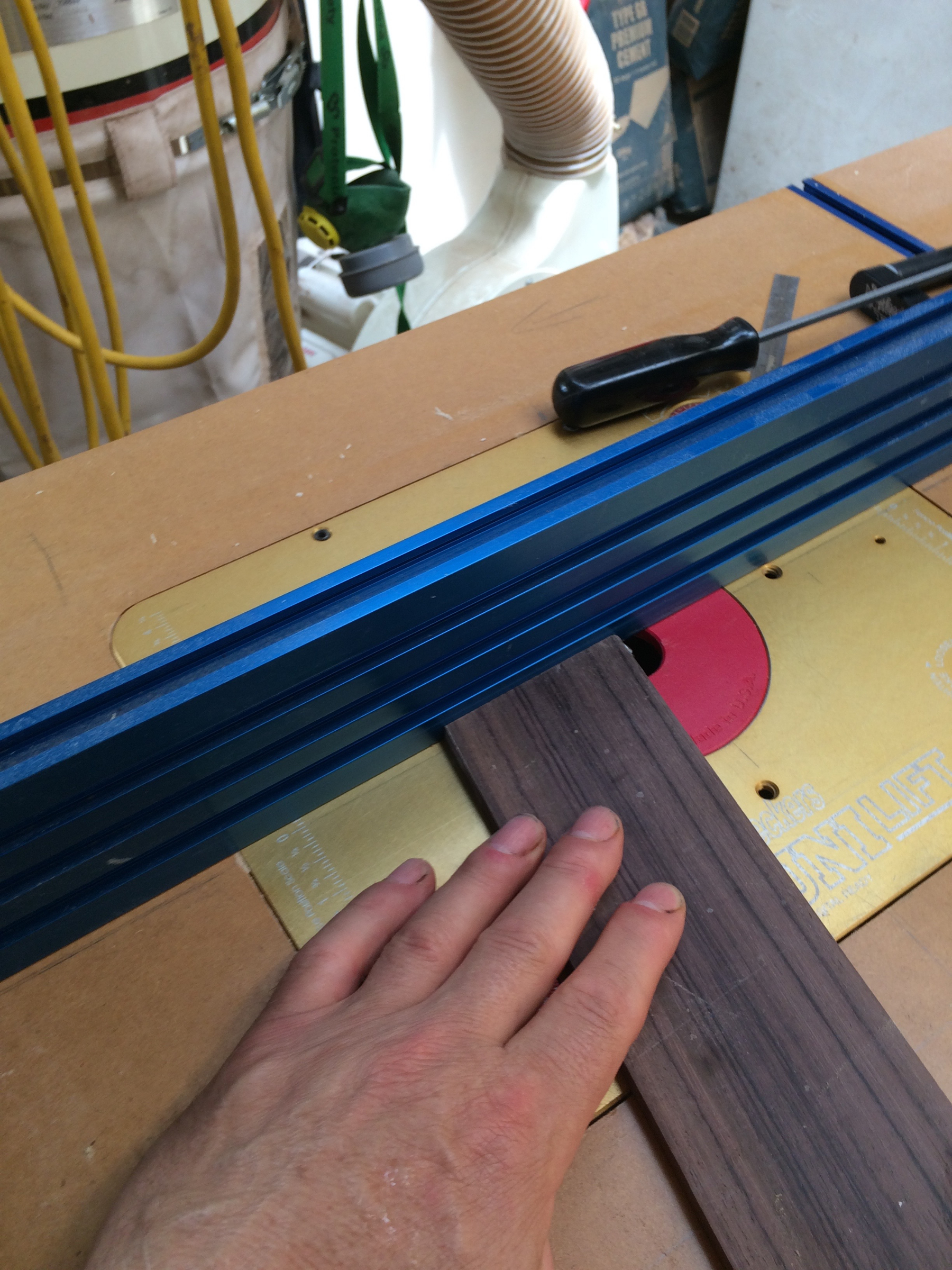

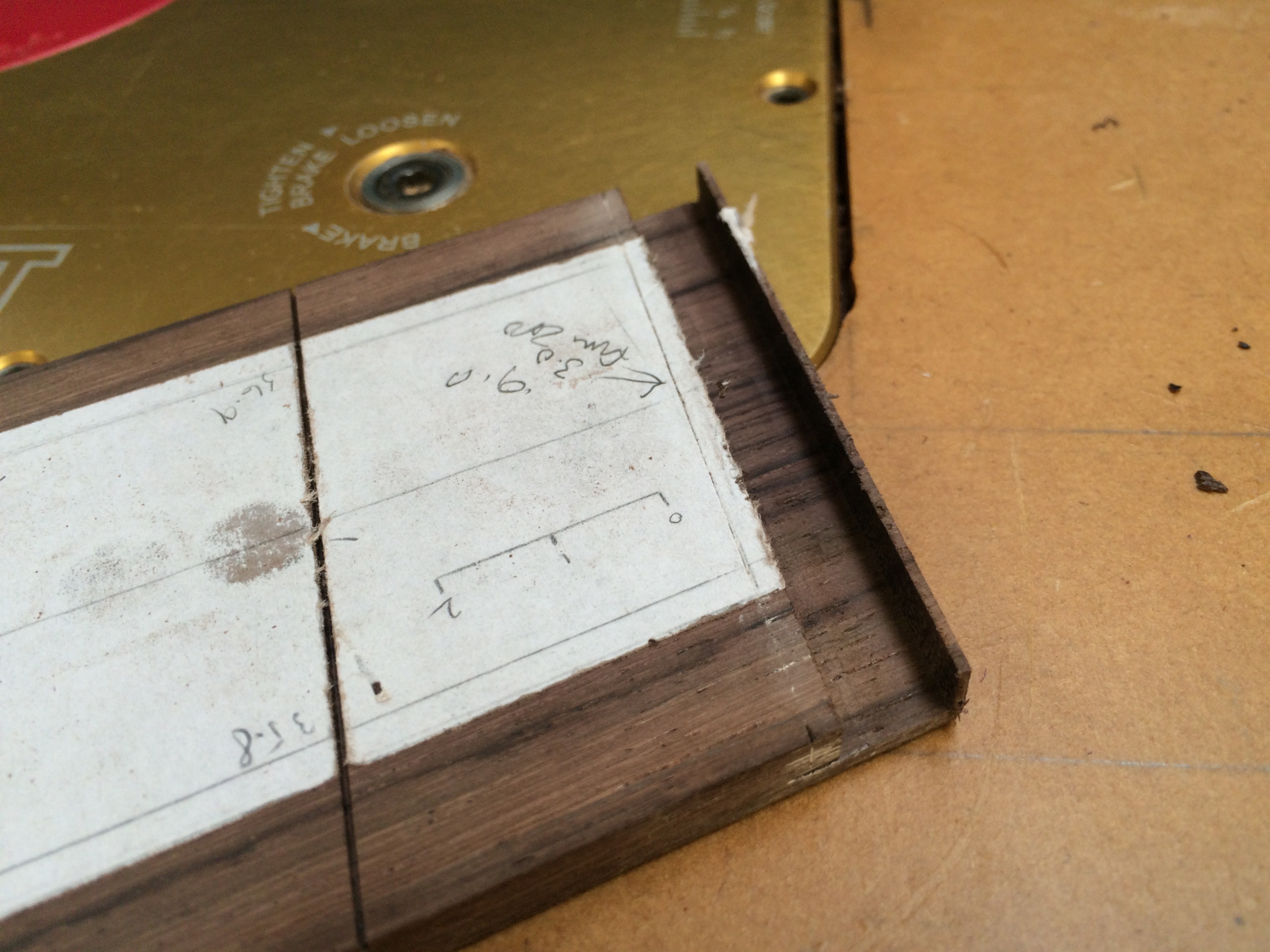

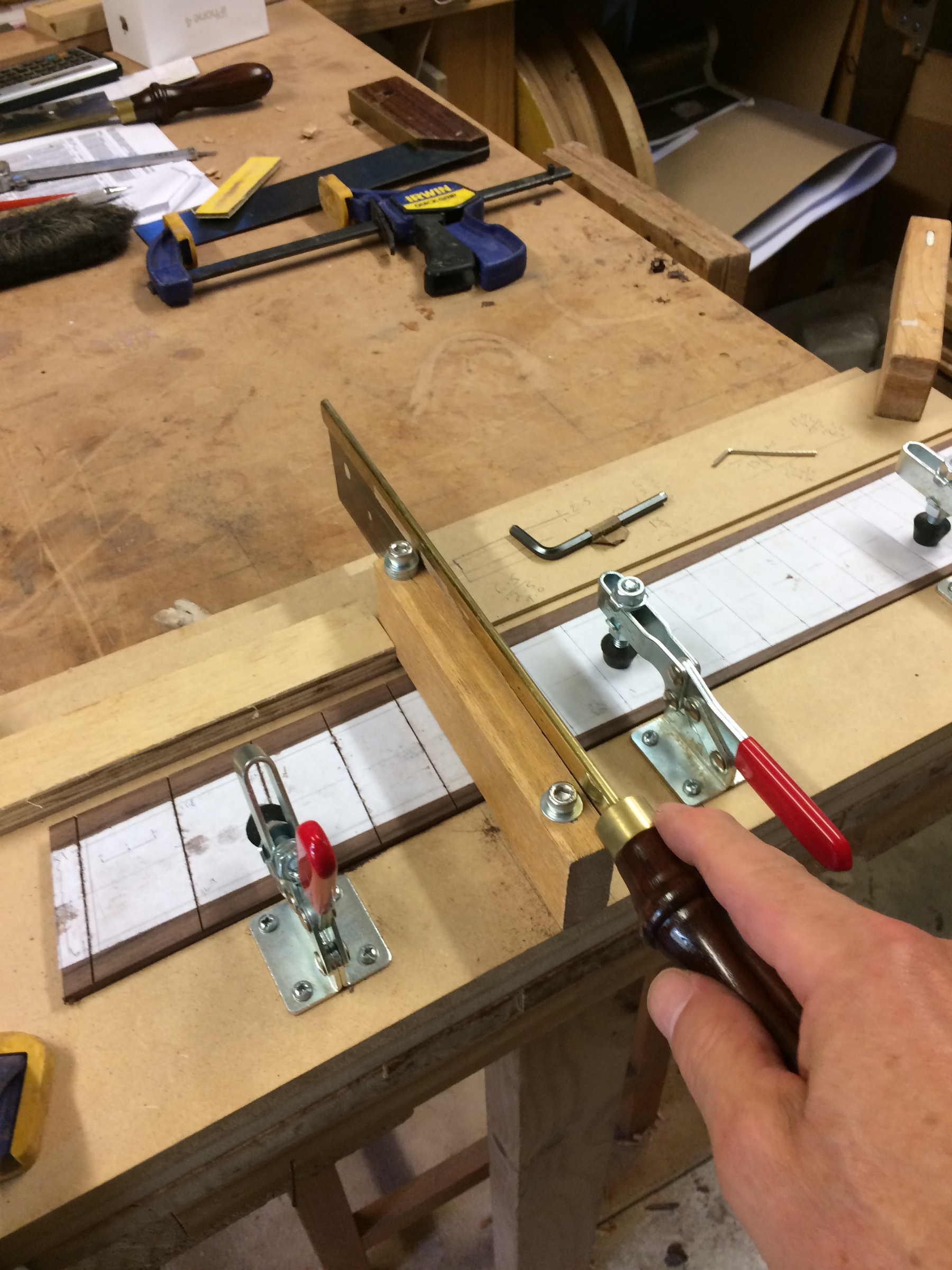

Cutting fret slots
Cutting nut ledge (compensated nut)
Profiling fretboard
Testing outer string layout and tuner post line up.

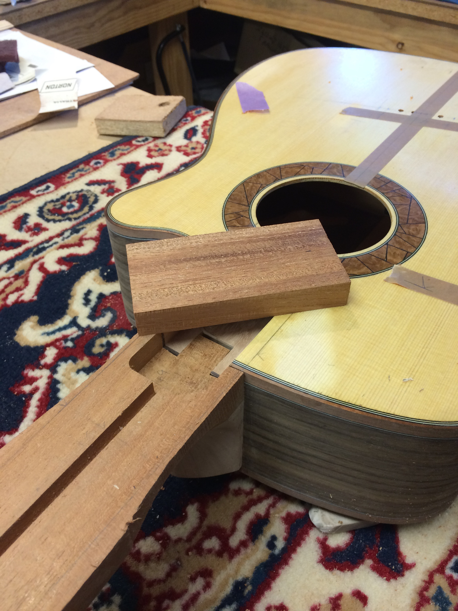

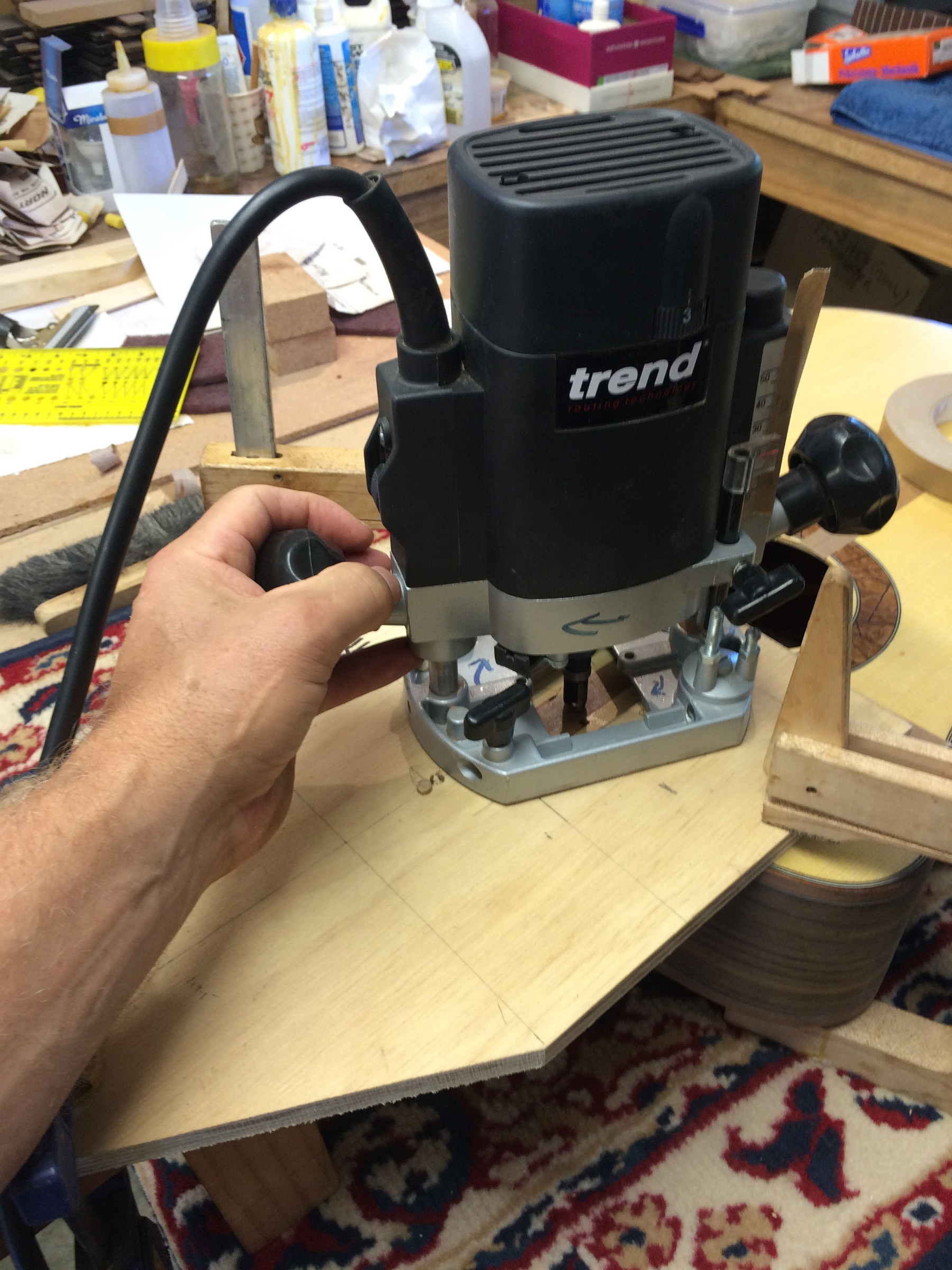

Routing pocket for neck bolt down tenon

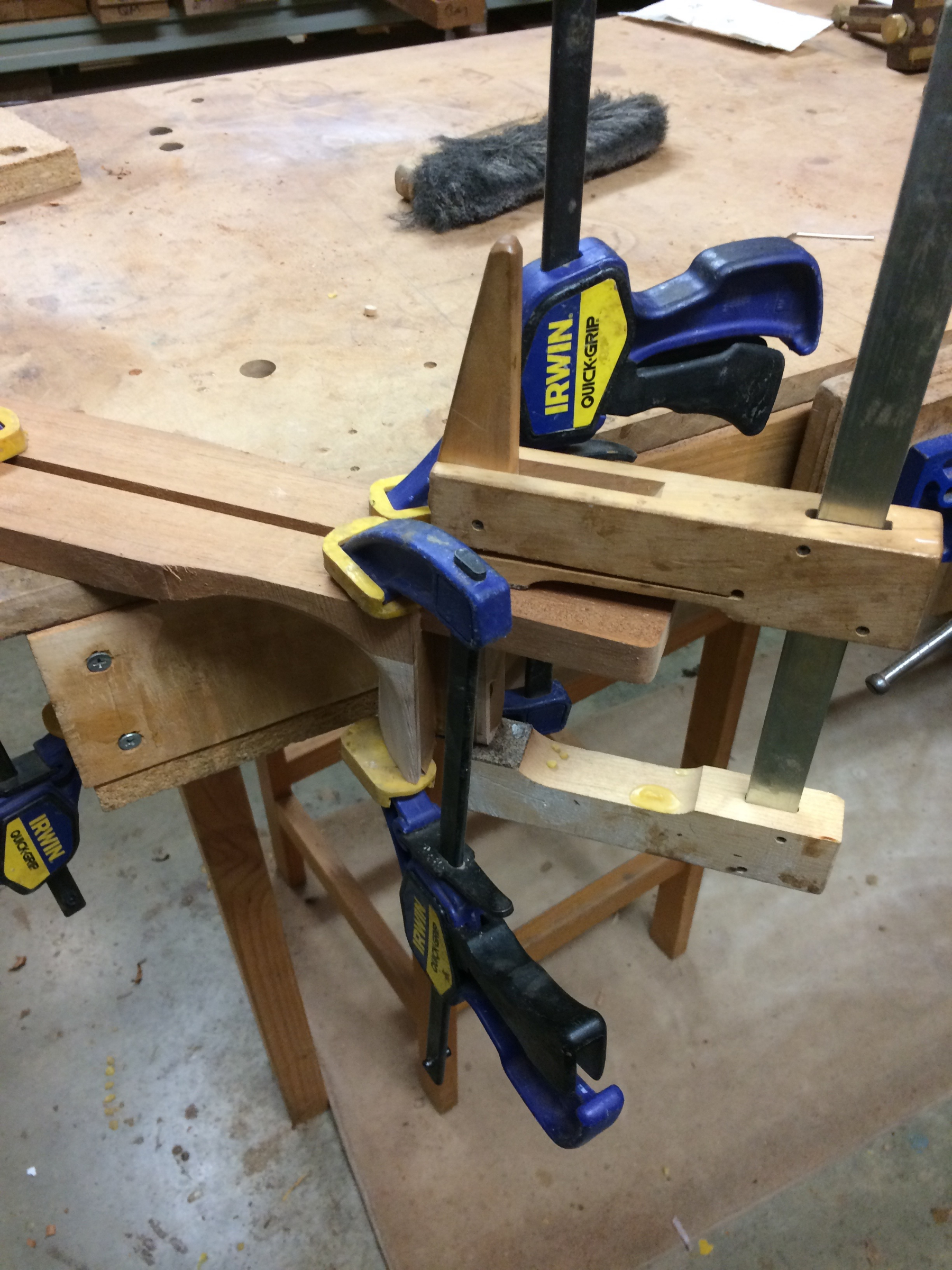

Shaping bolt down tenon. Trevor does this on a router table....I prefer to do it by hand...because I can :D
Bolt down tenon glued to neck. Prior to glue up I install two 6mm dowel pins to ensure tenon doesnt move when neck comes off the body.

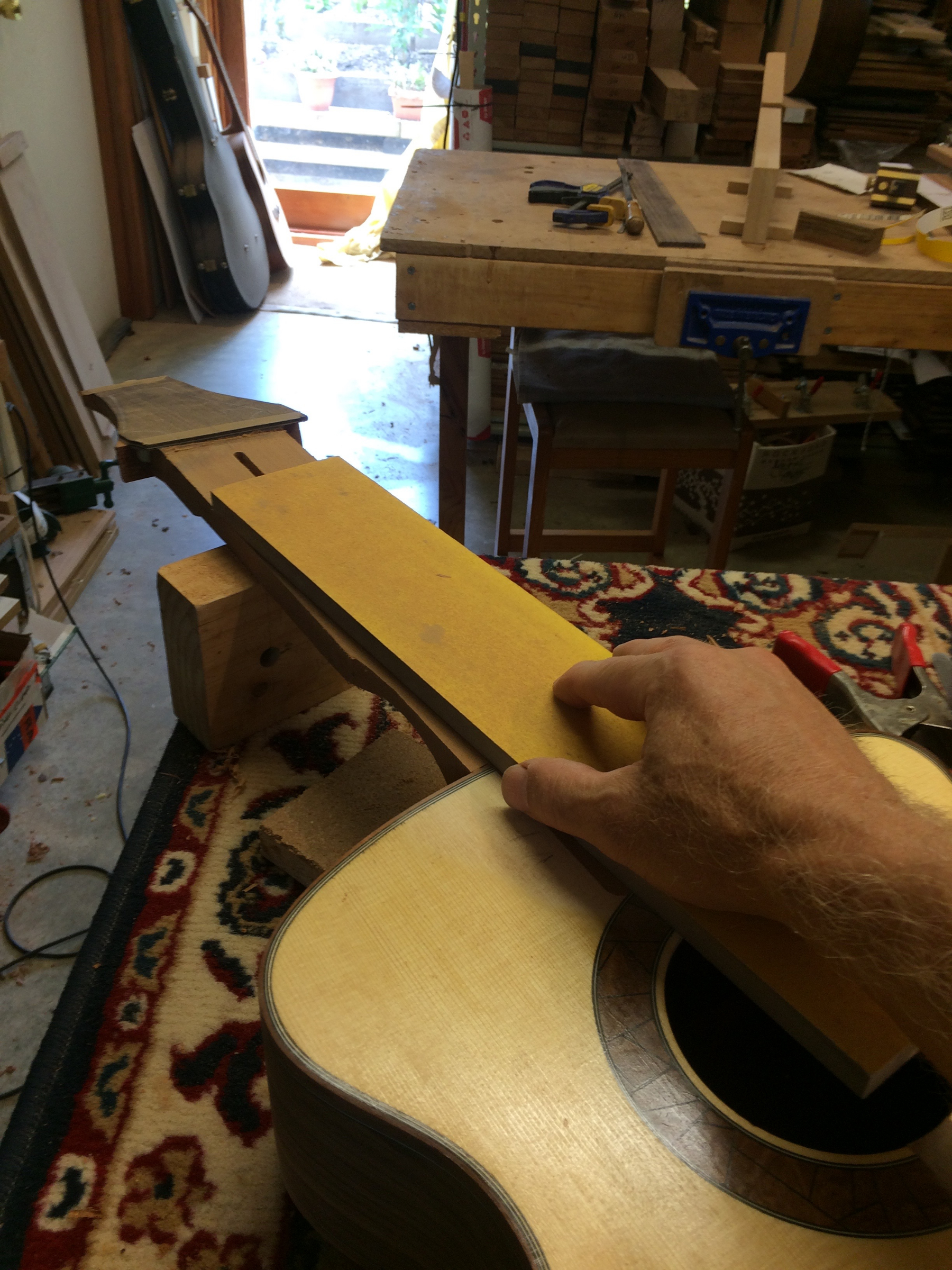

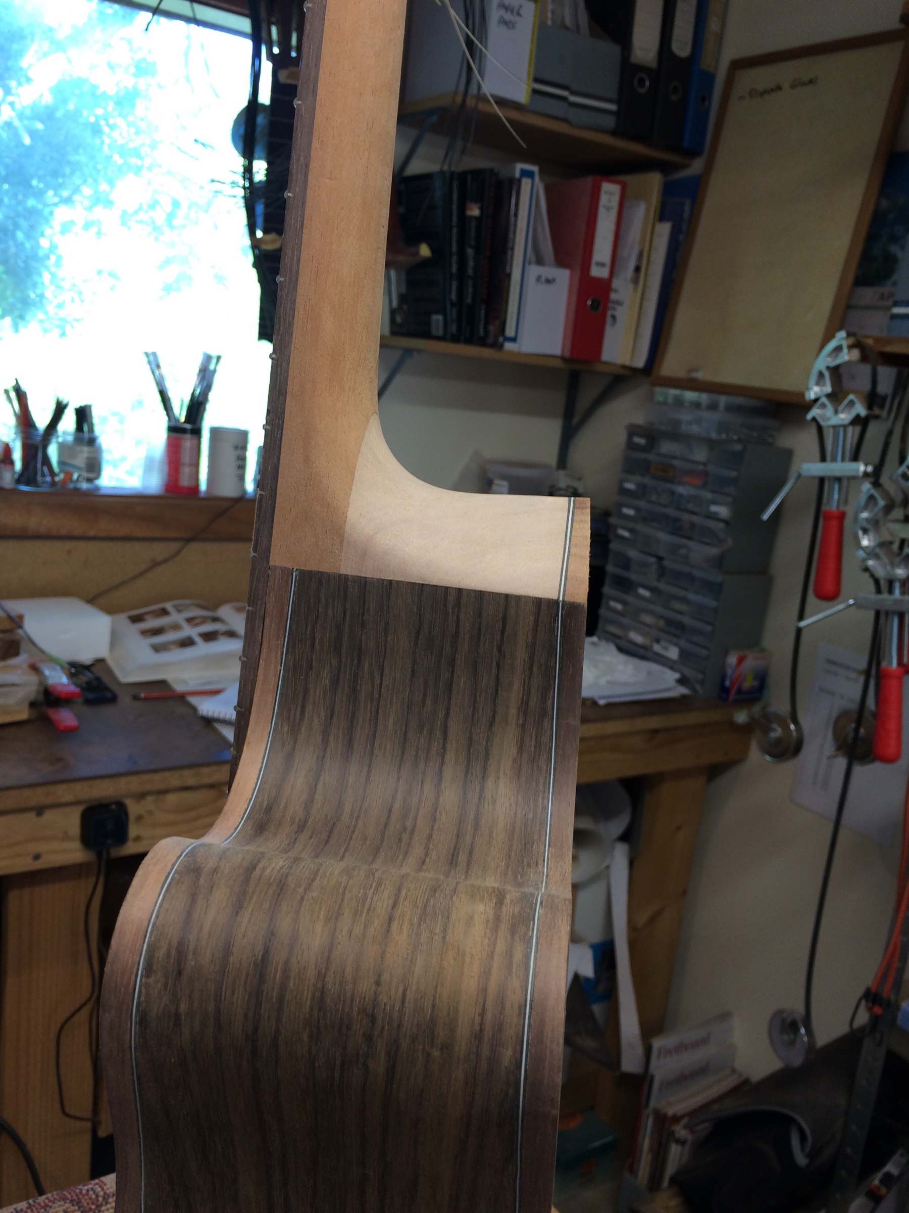

Trimming tenon flush with upper bout. I then had to do a bit of fine tuning to get the neck geometry spot on.

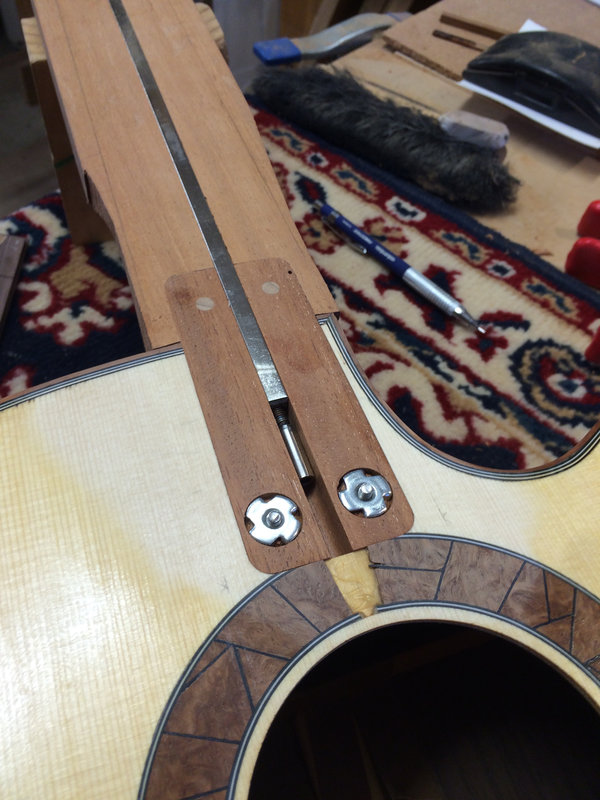

T nuts installed into bolt down tenon. Trevor uses 6mm bolts.....I use 4mm bolts as my neck tenon is a bit narrower than on the plans.

Yeah it looks nice when it's done properly. It can be a P in the A getting the geometry correct but the advantage of this method is you don't get a neck/body "hump" in the fretboard. Frets get pressed in with the fretboard off the neck and then the board is glued to the neck. Minimal to nil fret dressing is required.

Single action truss rod? No CF reinforcement in the neck? What is your opinion re these things? I have found that the CF and dual action directs a lot of the energy that would otherwise be lost from the neck into the soundboard and also allows for finer neck profiles ( if the client wants that ),as the stiffness of the neck is greater. The extra energy available to the soundboard manifests, to my ear, as a stronger attack and longer sustain.If you do use CF in the neck on some of your builds, do you run the CF all the way through the neck extension?
Also: have you hand marked those fret slots, or is there a hidden pin template that we can't see in the pix?
I made all my fretting templates on a milling machine and double sided tape the fretboard blanks to the fret template. The pin holes in the template locate each fretslot on the cutting jig.

blackalex1952 wrote:Single action truss rod? No CF reinforcement in the neck? What is your opinion re these things? I have found that the CF and dual action directs a lot of the energy that would otherwise be lost from the neck into the soundboard and also allows for finer neck profiles ( if the client wants that ),as the stiffness of the neck is greater. The extra energy available to the soundboard manifests, to my ear, as a stronger attack and longer sustain.
1. The truss rod is an LMI double action job. CF reinforcing down the neck.....Ive done it on a few guitars but not on this one.
2. the fret positions were marked out by hand on the paper template stuck to the fretboard. Fret2find supplies you with a PDF option but getting it to print out to correct dimensions involves too much f****ng around with printer settings. I calculated fret positions for outside strings and double checked intersection with centre line against fret2find figures.

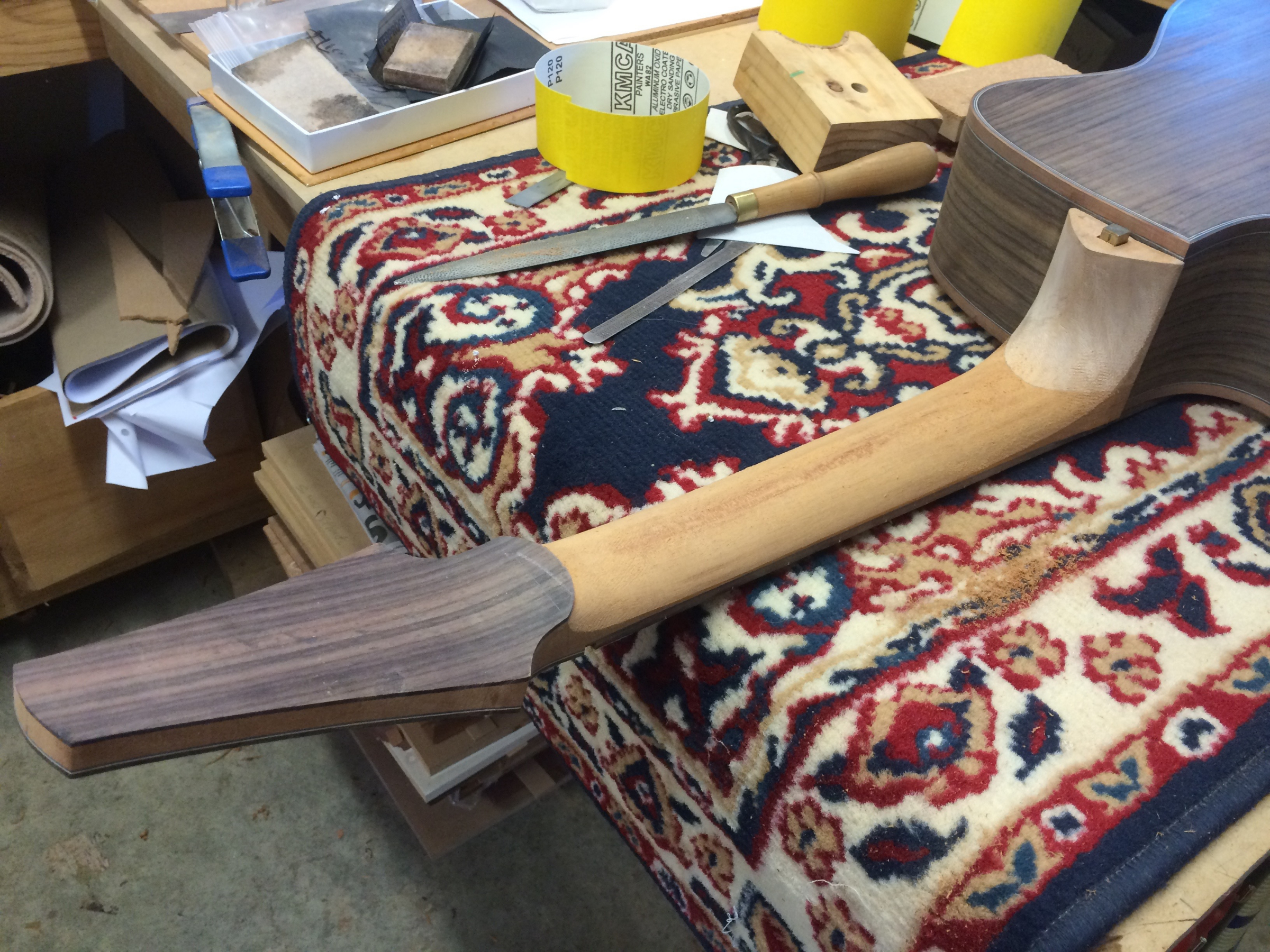

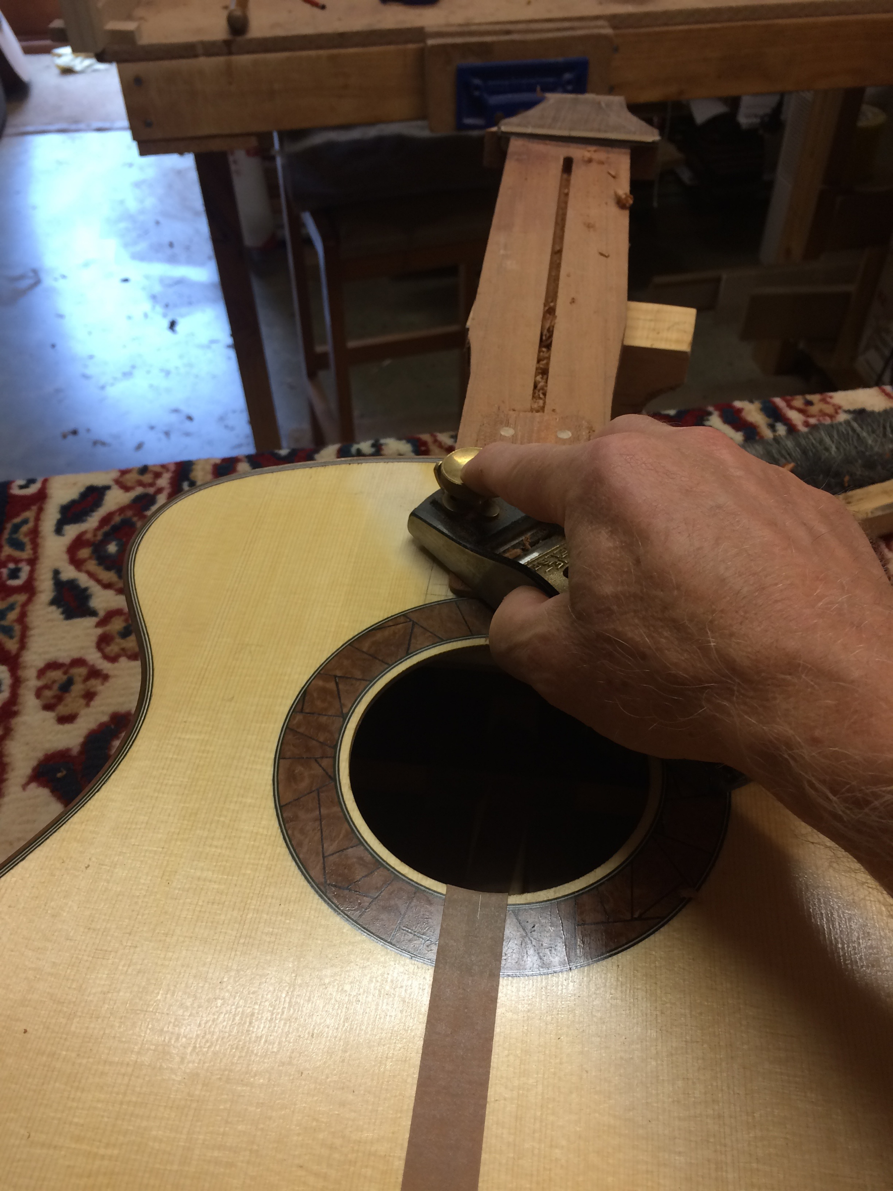

Thanks for the compliments Nick (and others). The upper bout is flat and slightly inclined so that a straight rule laid along the neck skims the top at saddle position by 2.5mm. This does away with the fretboard kink at the body/neck join you see on alot of guitars.
Re: Current Build - Falcate Braced Multiscale OM cutaway
Post by kiwigeo » Mon Jan 18, 2016 6:52 pm

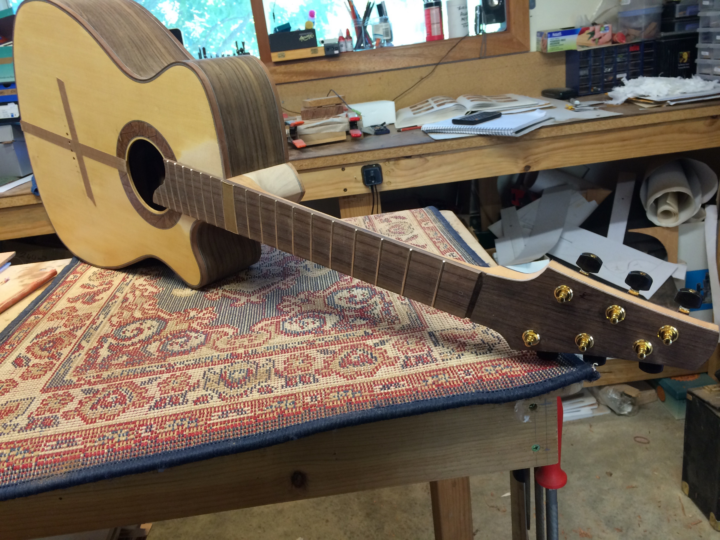

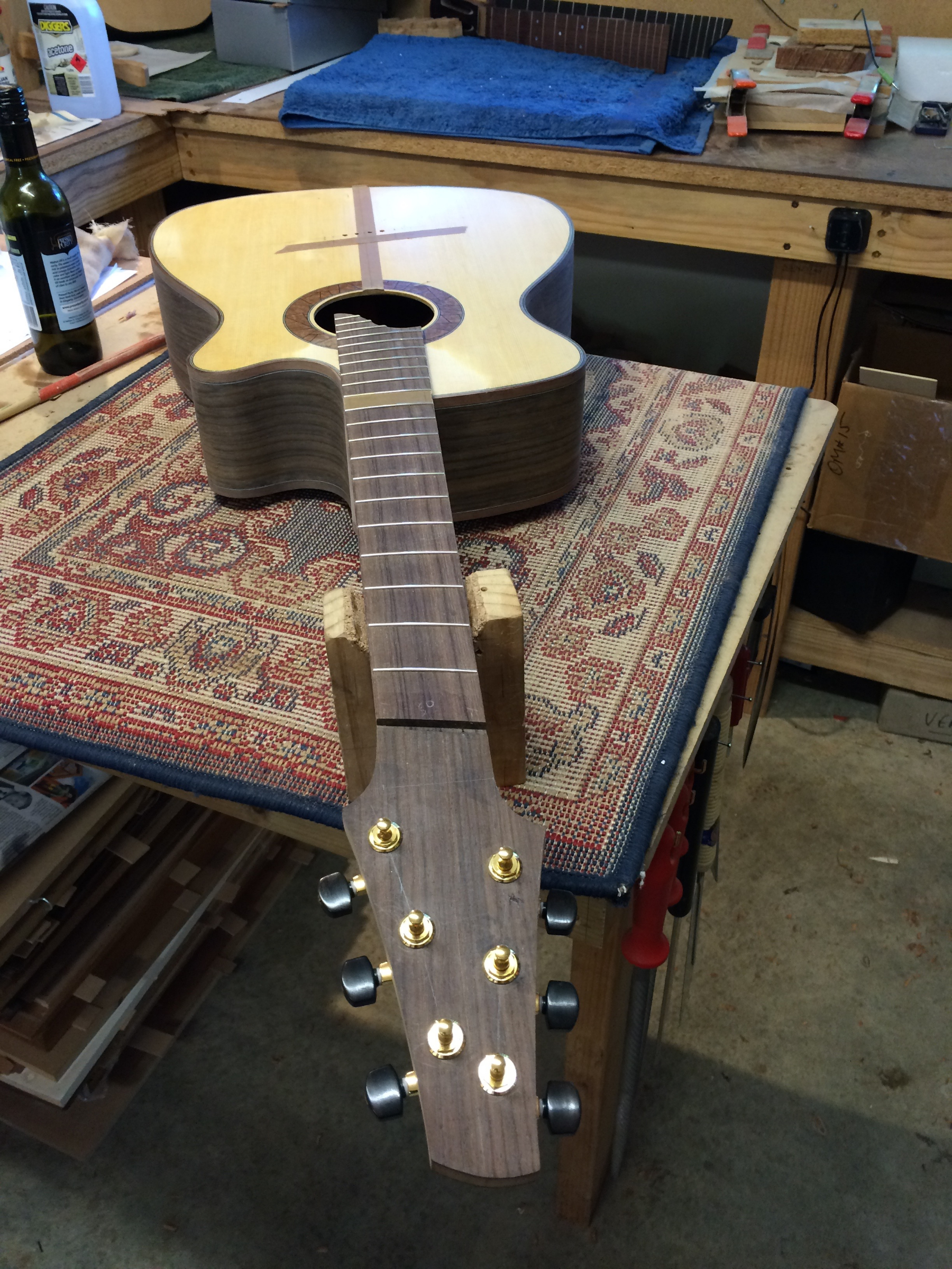

Fretboard has been glued on, the neck has been shaped and the heel cap is glued up and ready to go on. Not much left to do structurally on this buiild.

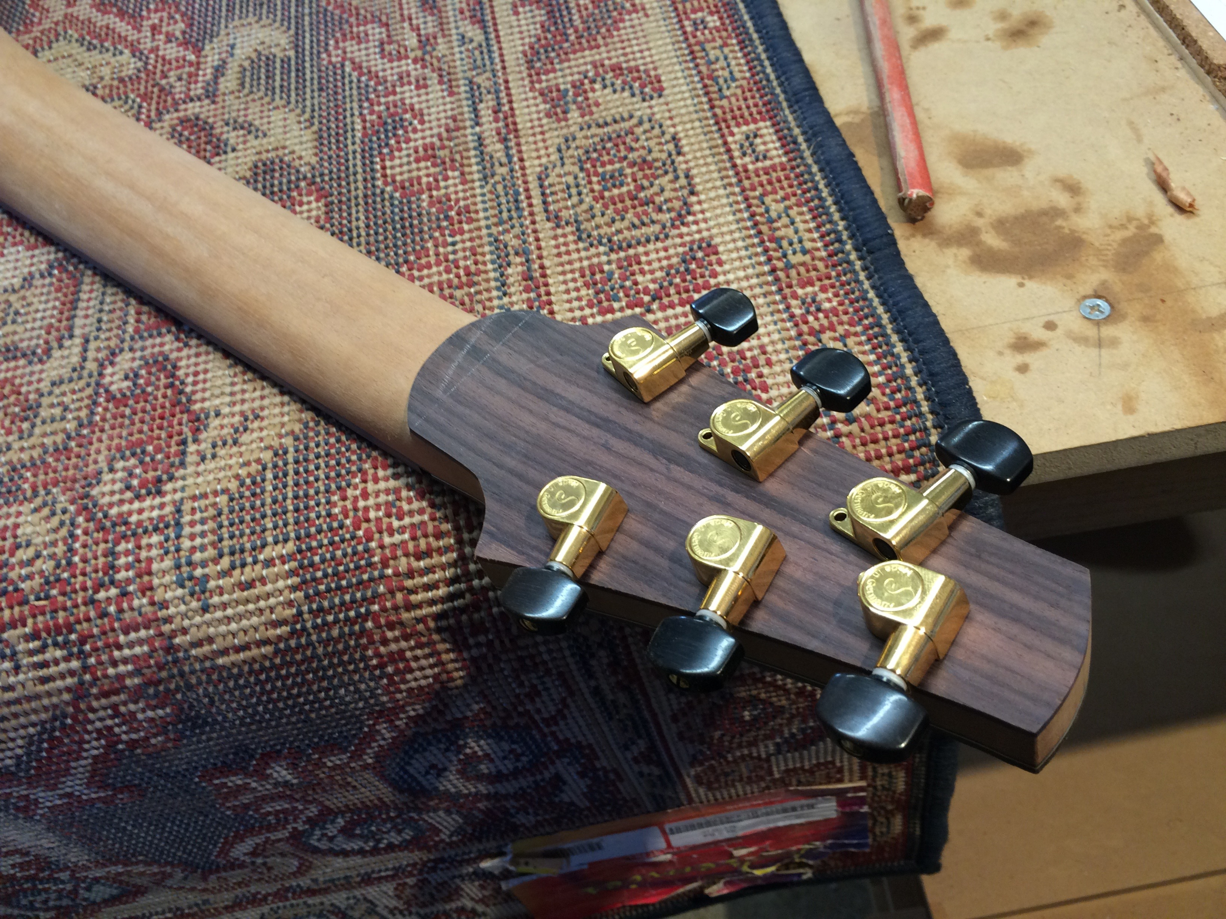

Post by kiwigeo » Sun Jan 24, 2016 9:01 pm
Got the heel cap on. Neck and headstock shaped and fine tuning to the neck body fit. Drilled the tuner holes and the tuners have been test fitted to check straight pull string runs. A bit of fine sanding of the neck and then it's onto preparation for finishing.

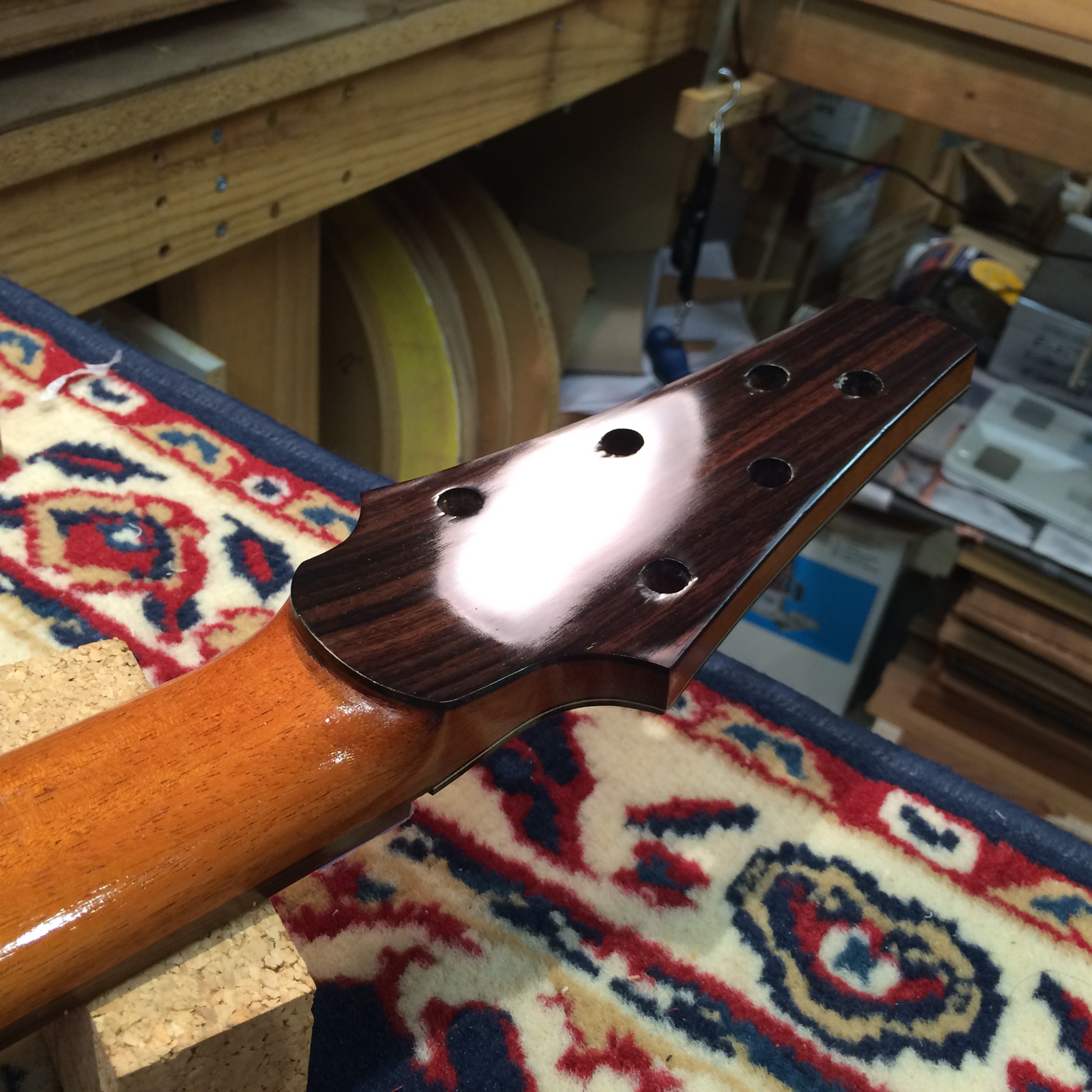

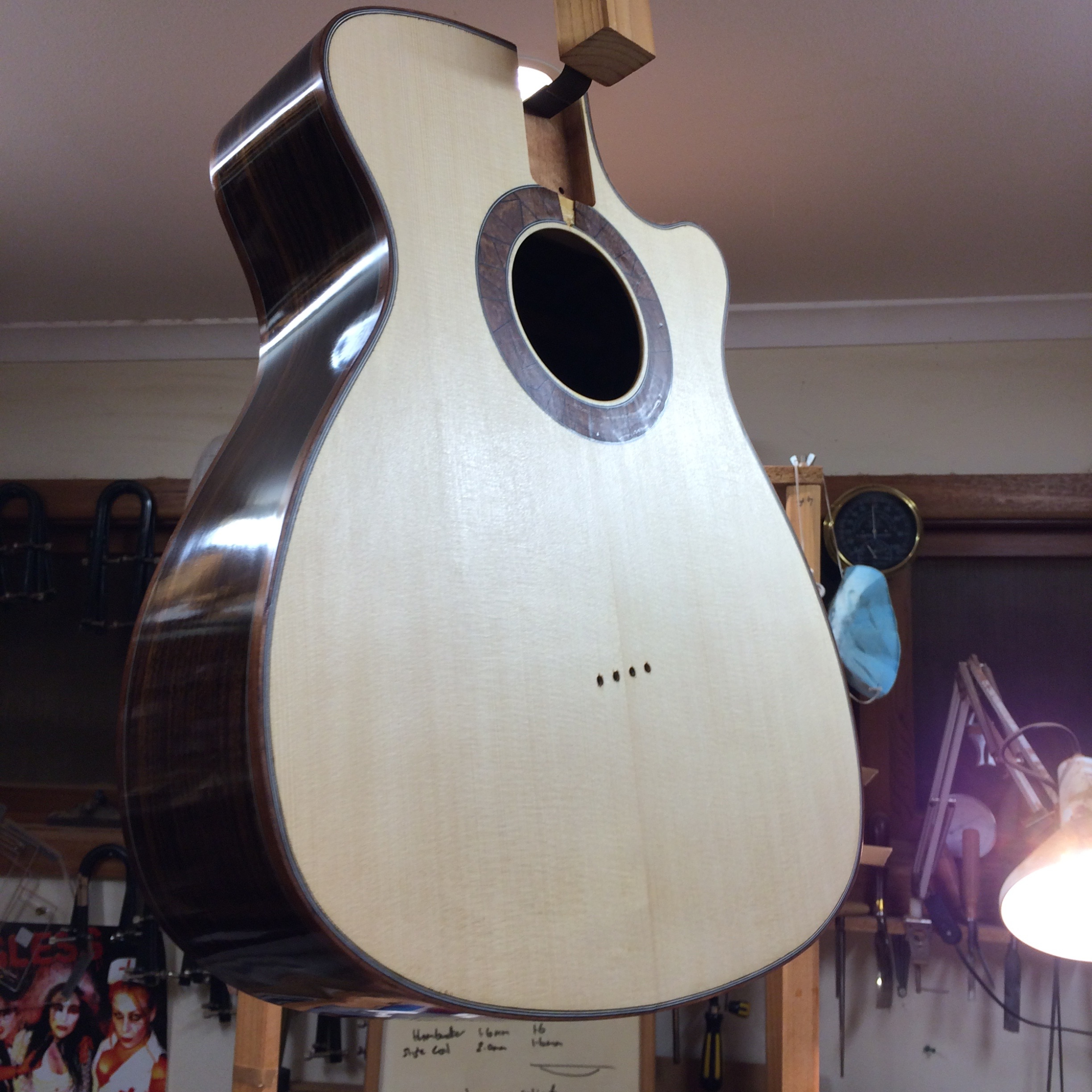

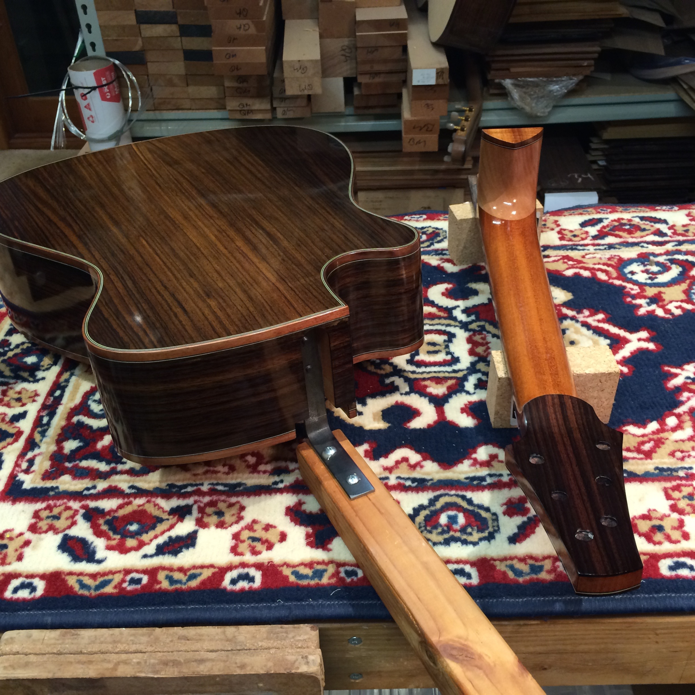

Post by kiwigeo » Sun Jul 03, 2016 8:57 pm
A few up date pics. Currently french polishing and working on a jig to make up the compensated nut.

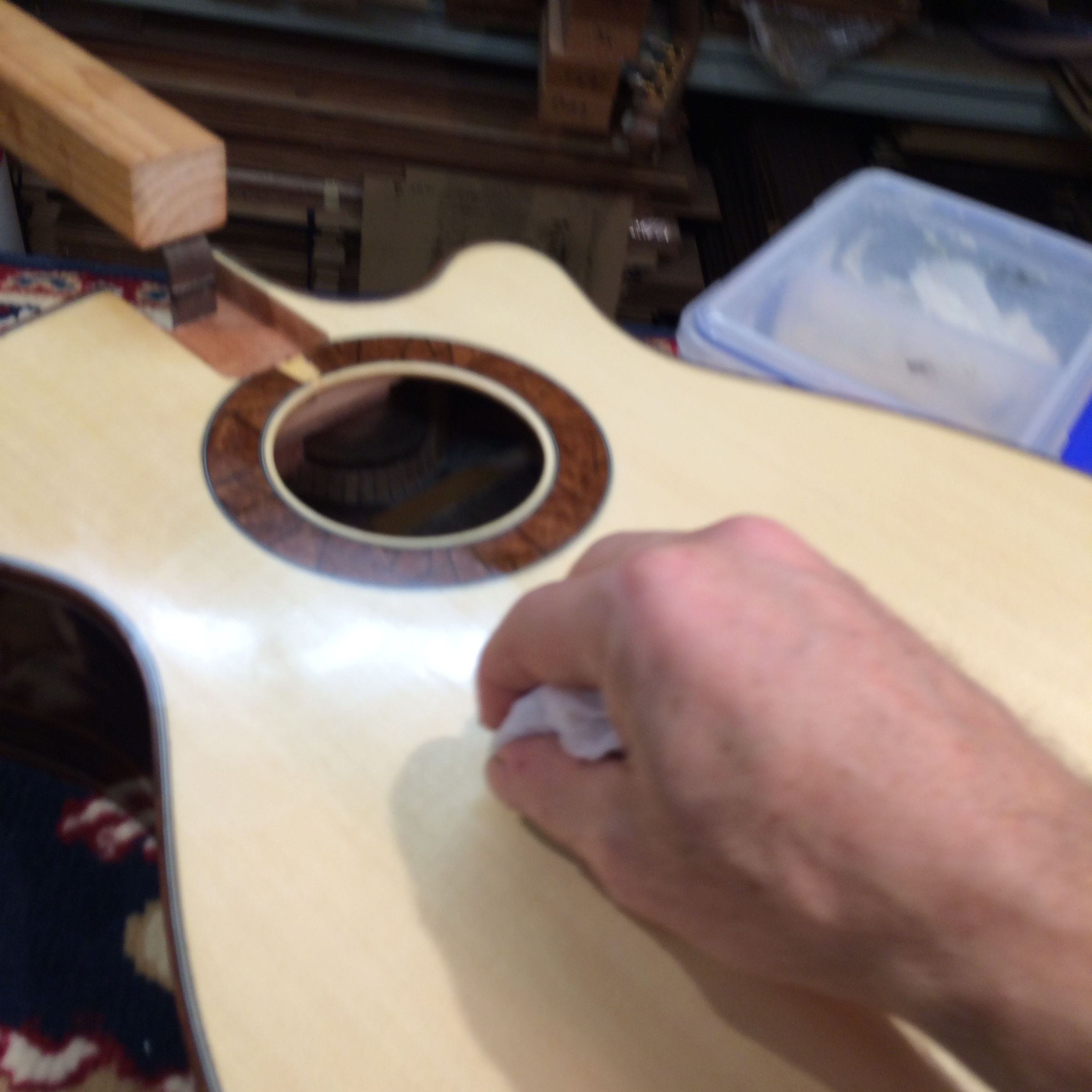

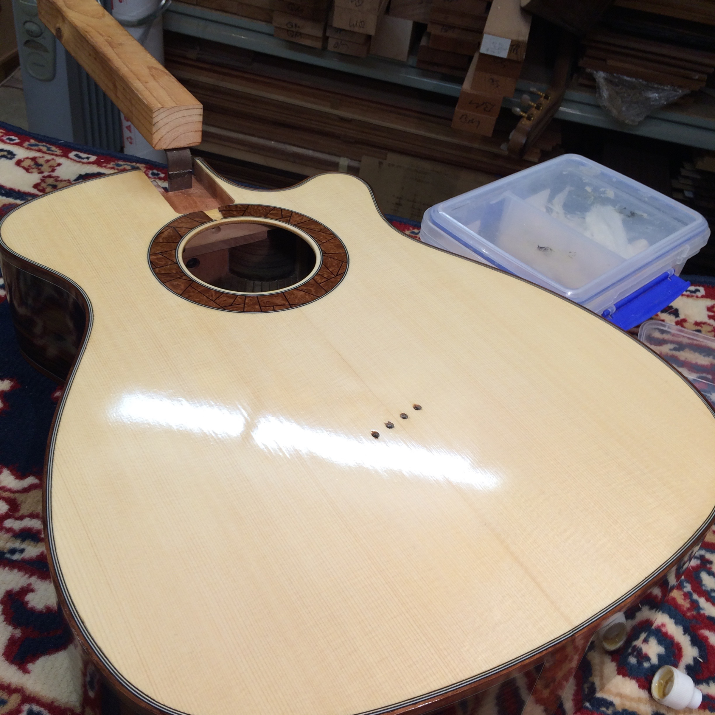

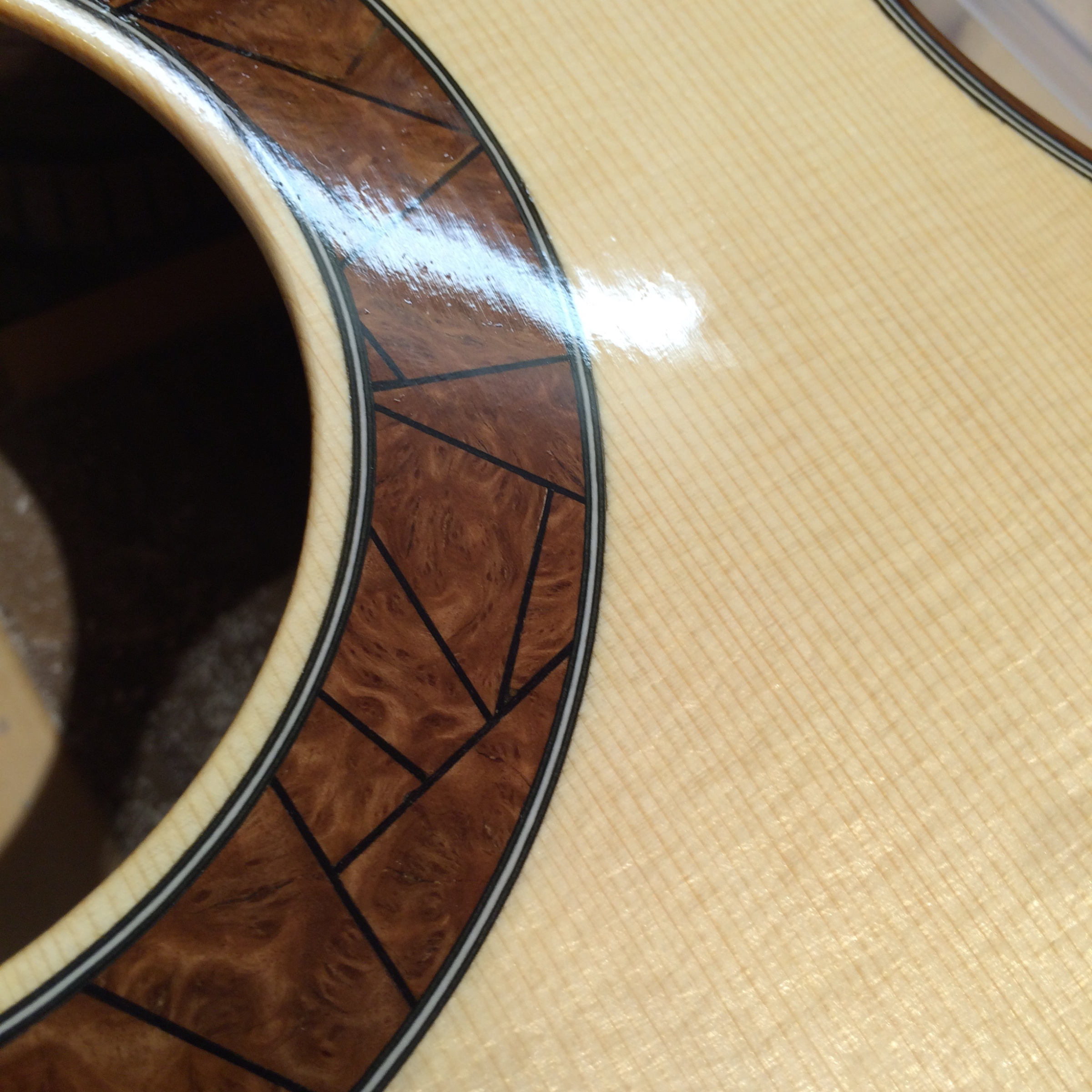

Post by kiwigeo » Sun Jul 24, 2016 4:26 pm
Finally got started with French Polishing on the top....light at the end of the tunnel for this build. There's a little bit of lint sticking to the finish around the sound hole.....I changed to walnut oil as a lubricant and this problem has disappeared.
