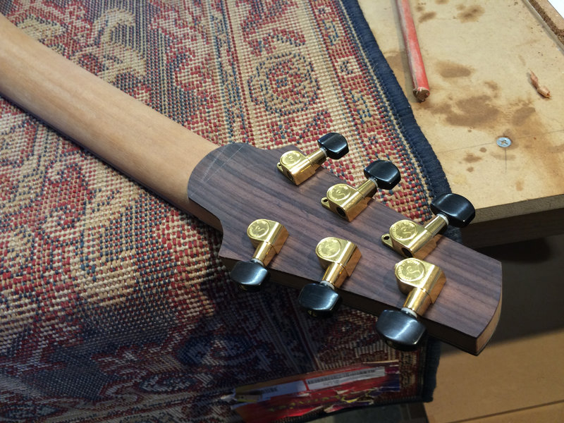

Got the heel cap on. Neck and headstock shaped and fine tuning to the neck body fit. Drilled the tuner holes and the tuners have been test fitted to check straight pull string runs. A bit of fine sanding of the neck and then it's onto preparation for finishing.
