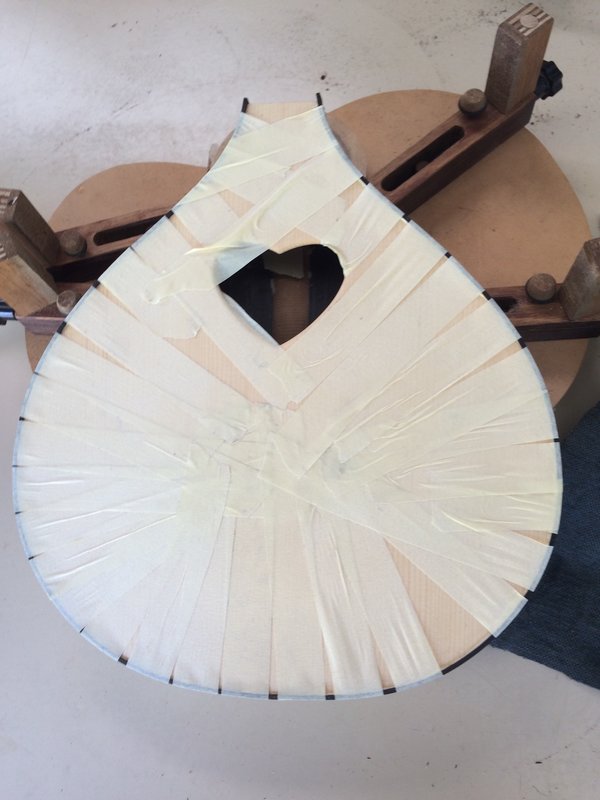

Thinning the soundboard prior to fitting bindings

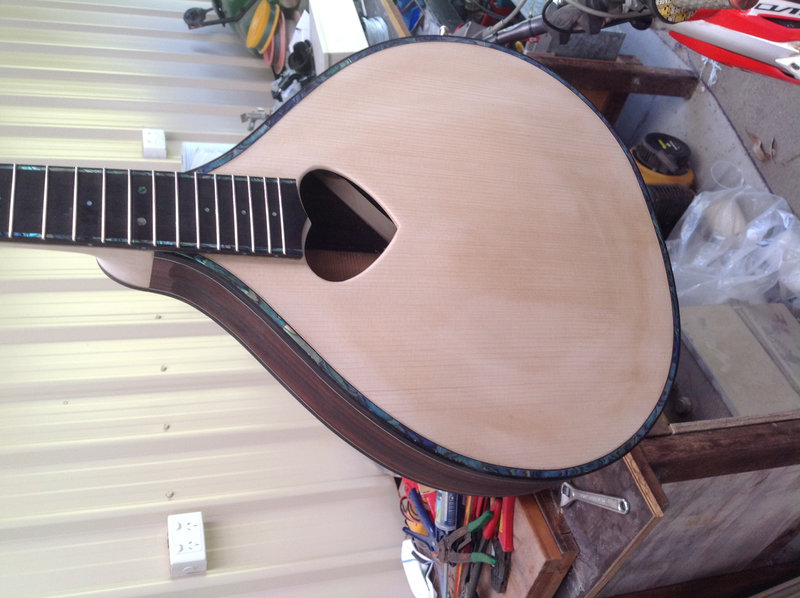

Front bindings on

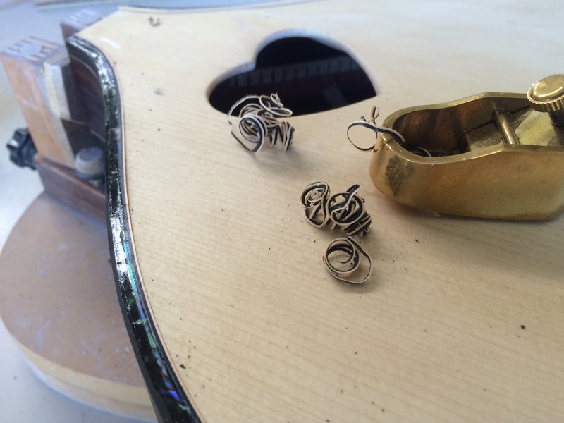

Shell installed and levelling the inside purfling

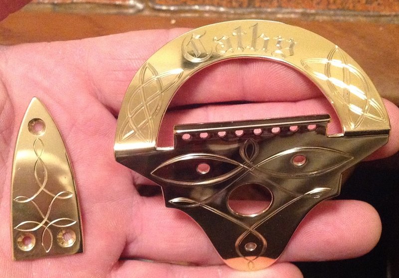

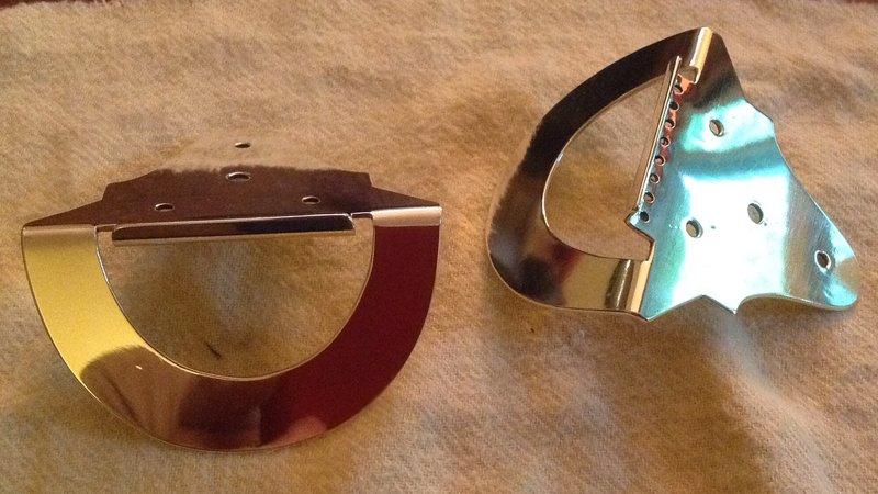

The Tail Piece and Truss Rod Cover are made from 1.2mm brass, engraved and then plated, so hopefully they won't tarnish.

Beautiful craftsmanship Graham, being a Kiwi I'm not a fan of Paua inlay (keep thinking "ashtrays" for some reason :oops: ) but I can see the neat work that's gone into it, I'm sure the birthday girl will absolutely love it.

Cool engraved tail piece I like the need for different way to go ,I covered mine in wood :lol:

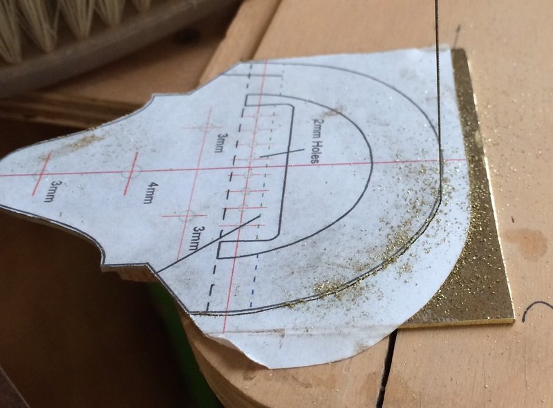

The tail piece was cut from some brass, thick shim material I think.
1.2mm anyway. Then cut out with a jewellers saw.

Graham Long wrote:The tail piece was cut from some brass, thick shim material I think.
Did you do the engraving? Or send it out?

No I didn't, it was done by London Engravers. He does very nice work, this is about as simple as he does.

Yes it looks like a diamond drag tool has been used . :)
