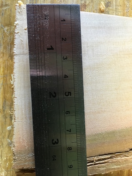

Picked up a piece of Huon Pine yesterday thanks to Bob, i took some pics of an off cut from the billet and going by the growth rings on it the 85 mm piece took about 225 years to grow so,,,, if the tree was about one meter in diameter that makes it about 1240 years old when it died,, Wow!!! hard to tell but it was probably much older than that!!
closeup of annulars, black marks are 10mm apart
70 to 90 mm shows the sapwood and bark.

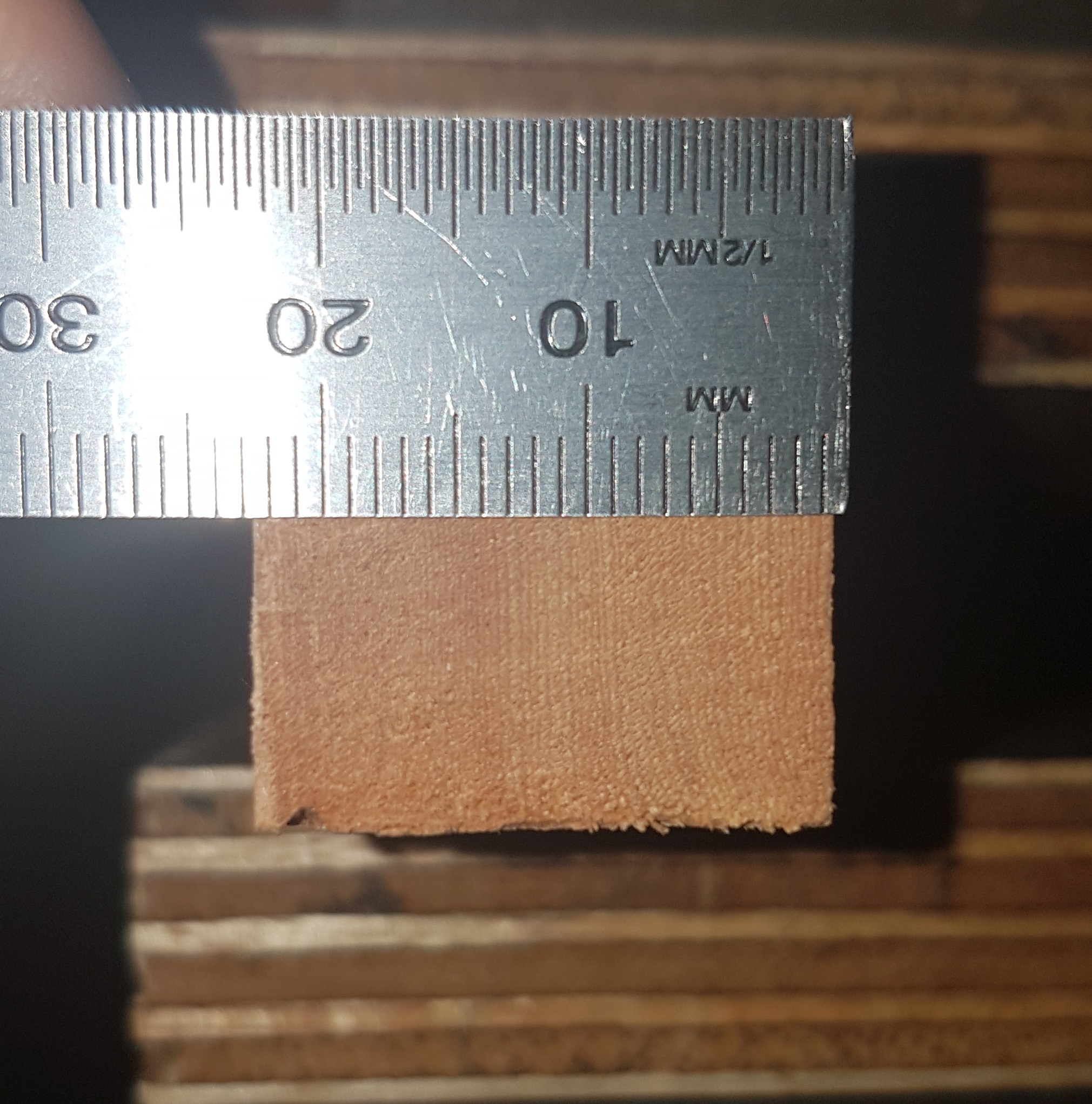

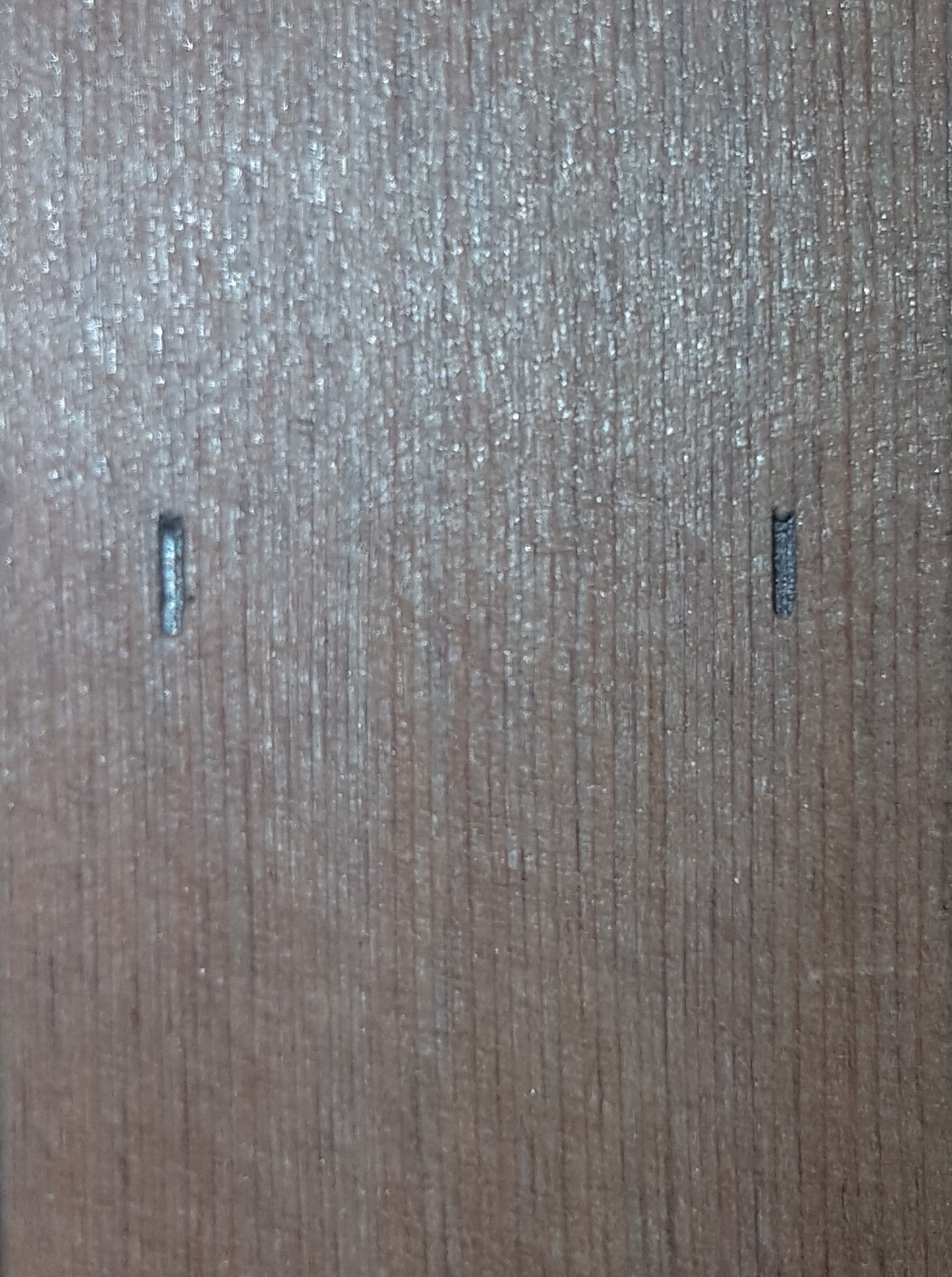

Here's a piece of my King Billy brace material.
Hard to count, but from the right side of this photo is around 33 rings for the first 10mm. the left side where its tighter and where i have cut to get my last braces is nearly impossible to count without a microscope but looks like about 4 -5 rings per mm.
This 22mm wide piece probably took 80yrs to grow. This piece and most my other pieces started out at about 150mm wide (545yrs each). I certainly hope the tree these came from died of natural causes.
10m spacing. FYI: Pencil is stamped as .3mm lead.
Approx 45 rings per 10mm

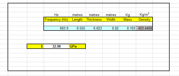

I just measured the Young's Modulus of the King billy - same piece from the end grain photo above and got: 32.98 Gpa
King Billy Young's Modulus
If i understand this correctly it is super stiff stuff.

That's alot stiffer than the stuff Ive got in my shop......the highest Youngs Modulus values I got were around 6GPa.
Your wood is John Holmes wood....perfect for falcate braces.....

Measured a few other pieces picked at random from my pile - ranges from 12 gpa - 38 gpa

Very unlikely, recheck, Id be expecting 5-8 Gpa

I rechecked a few pieces as i was going, it's correct. The one piece pictured above I rechecked again yesterday out of curiousity after cutting some more bracing from it, and yep was the same results - although at a smaller piece.
Keep in mind this is all super close grain - most are 25+ rings per 10mm. Yesterday I also picked the 'worse' piece visually (that i could see, didnt check all of them) out of the stack and it was 12rings per 10mm. With 10 gpa.
I checked a couple of pieces of my engelmann brace stock - ranges between 7 - 13 gpa which is about right for engelmann so i hear. Not people with good king billy to compare results to.

Using your figures Felix, I get the same result, But at 5 times the regular stiffness without a high density there is something happening, perhaps an interaction between modes that is preventing you measuring the fundamental frequency?
It would warrant static deflection testing to confirm.

I've never done this testing prior to this (so it is likely i am mucking it up somewhere) but i dont know where I could be going wrong. The dimensions and weight are what they are - unless my scales and/or ruler is out :o .
Which leaves only the frequency.
The above one: The Freq is the 1 of 2 peaks i get when useing the method shown by Trevor. The 2nd peak is much lower in db (i would hardly even call it a peak, but its there) then the 693 shown and is up around 2500hz by memory.
The spreadsheet was provided by Trevor, so i can only assume the formula is correct.
The fact im getting what would appear to be normal results for my engelmann stock useing the same methods makes me think I'm doing it all correct.
I will consult 'the book' tonight and double check.

The calculations look fine, the measurements and weight are producing an appropriate density, the frequency is what I would suspect.
