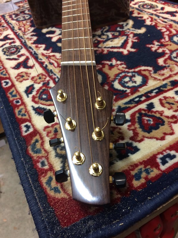

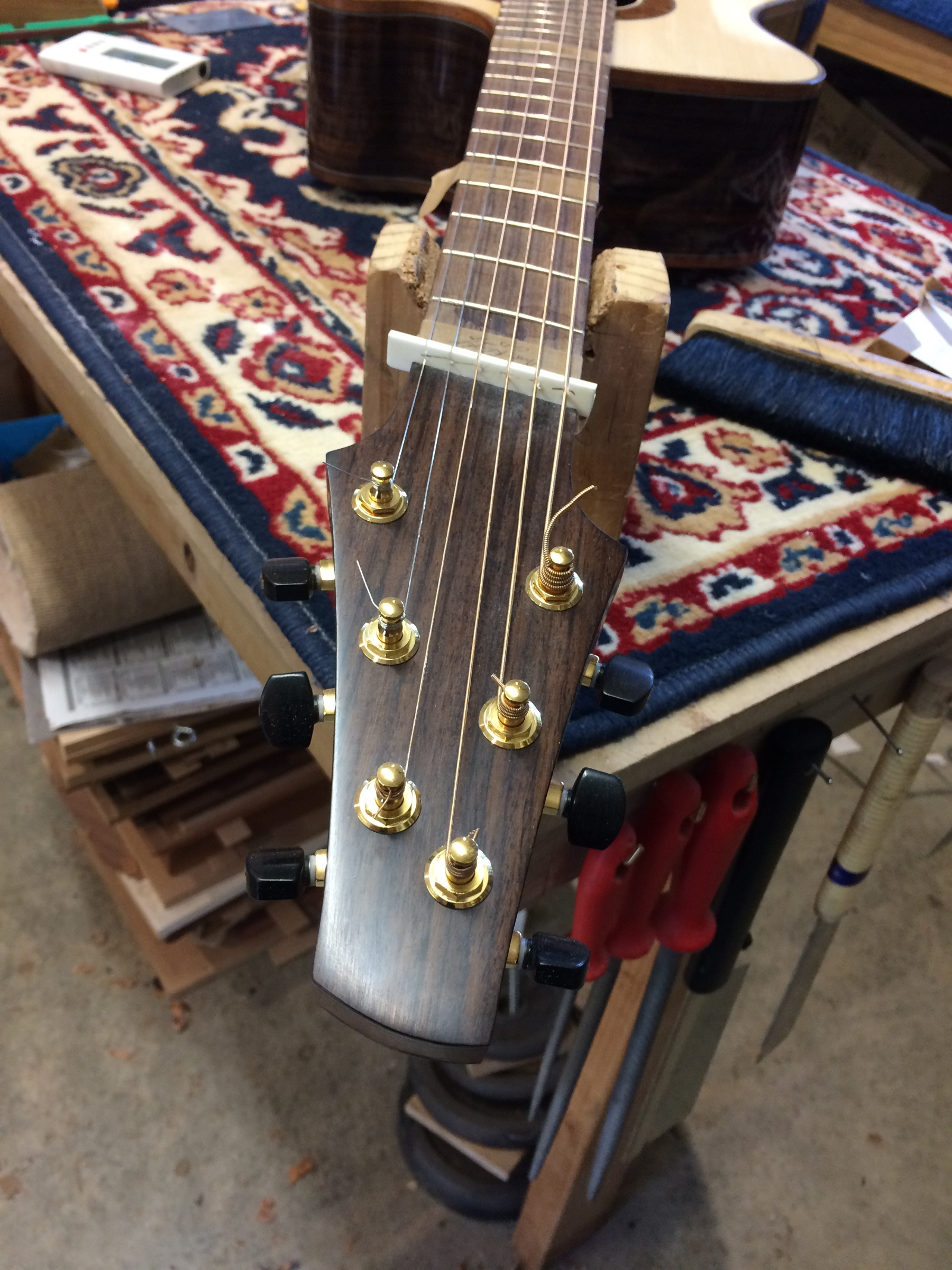

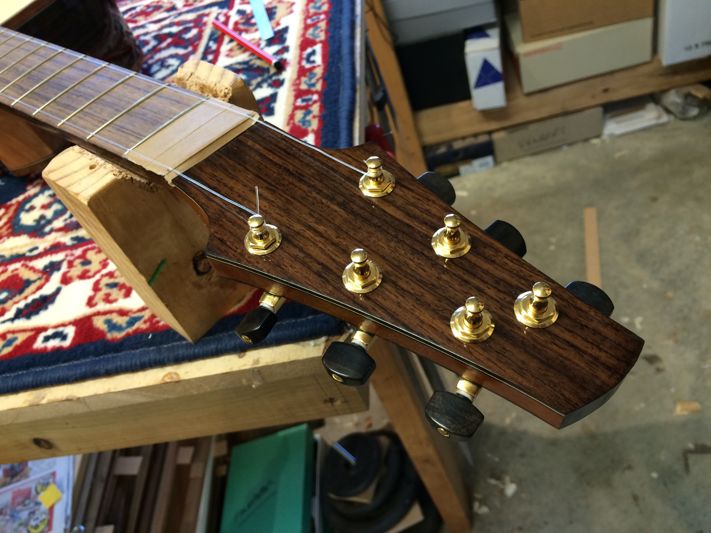

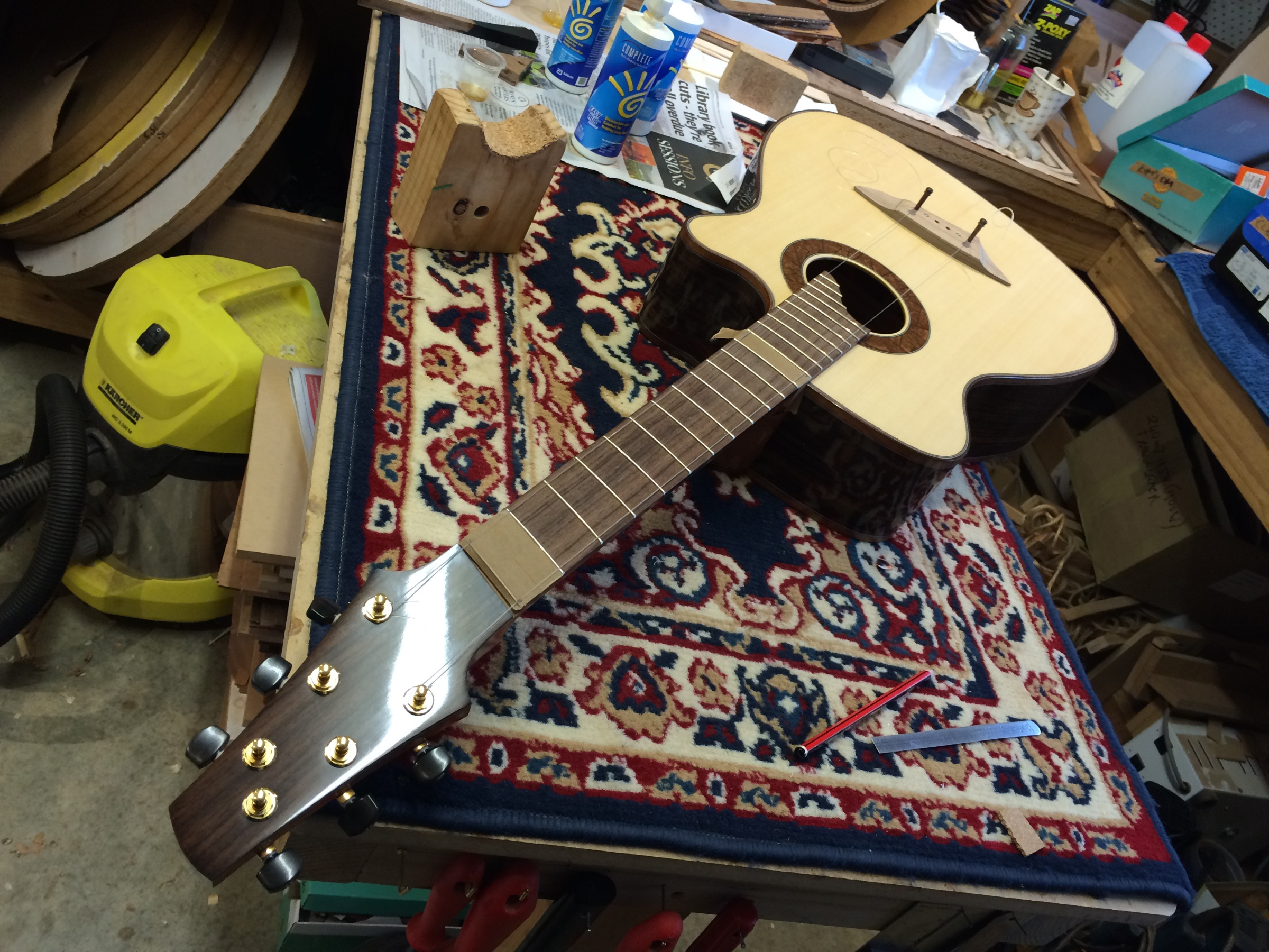

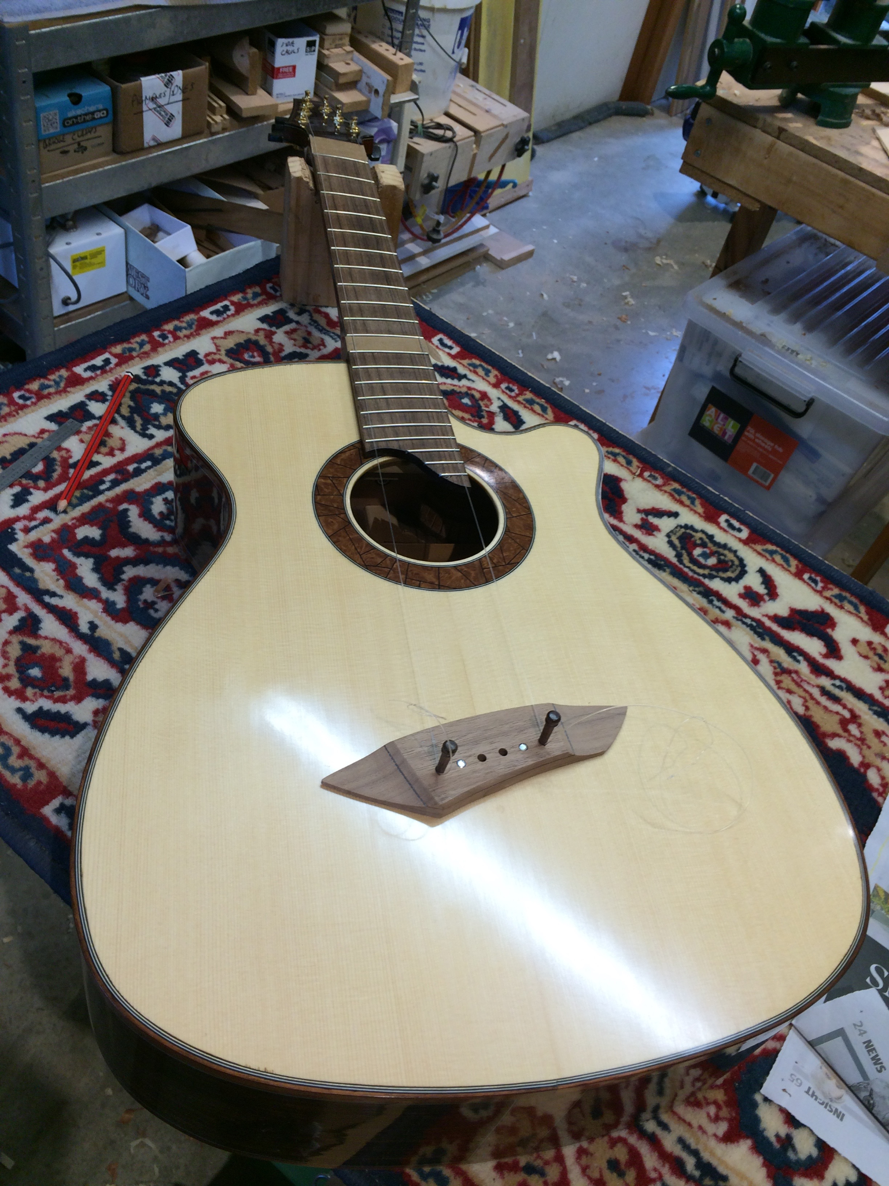

Slow progress on the OM but theres light at the end of the tunnel. The guitar has been french polished and today I bolted the neck back on and fitted some tuners in order to test string runs. The bridge is not yet fixed to the top.
Re: Current Build - Falcate Braced Multiscale OM cutaway
Post by Mark McLean » Wed Sep 14, 2016 6:30 pm
Looking tantalizingly close now Martin. I bet you were tempted to pluck those strings while they were on it - how did it sound? But I don't like those fret position markers at the 1st and 12th. Really spoils the whole aesthetic.

Unfortunately the two strings are nylons and the bridge isnt glued on yet. The shellac on the top hasn't fully cured yet so string up is still a week or two away......

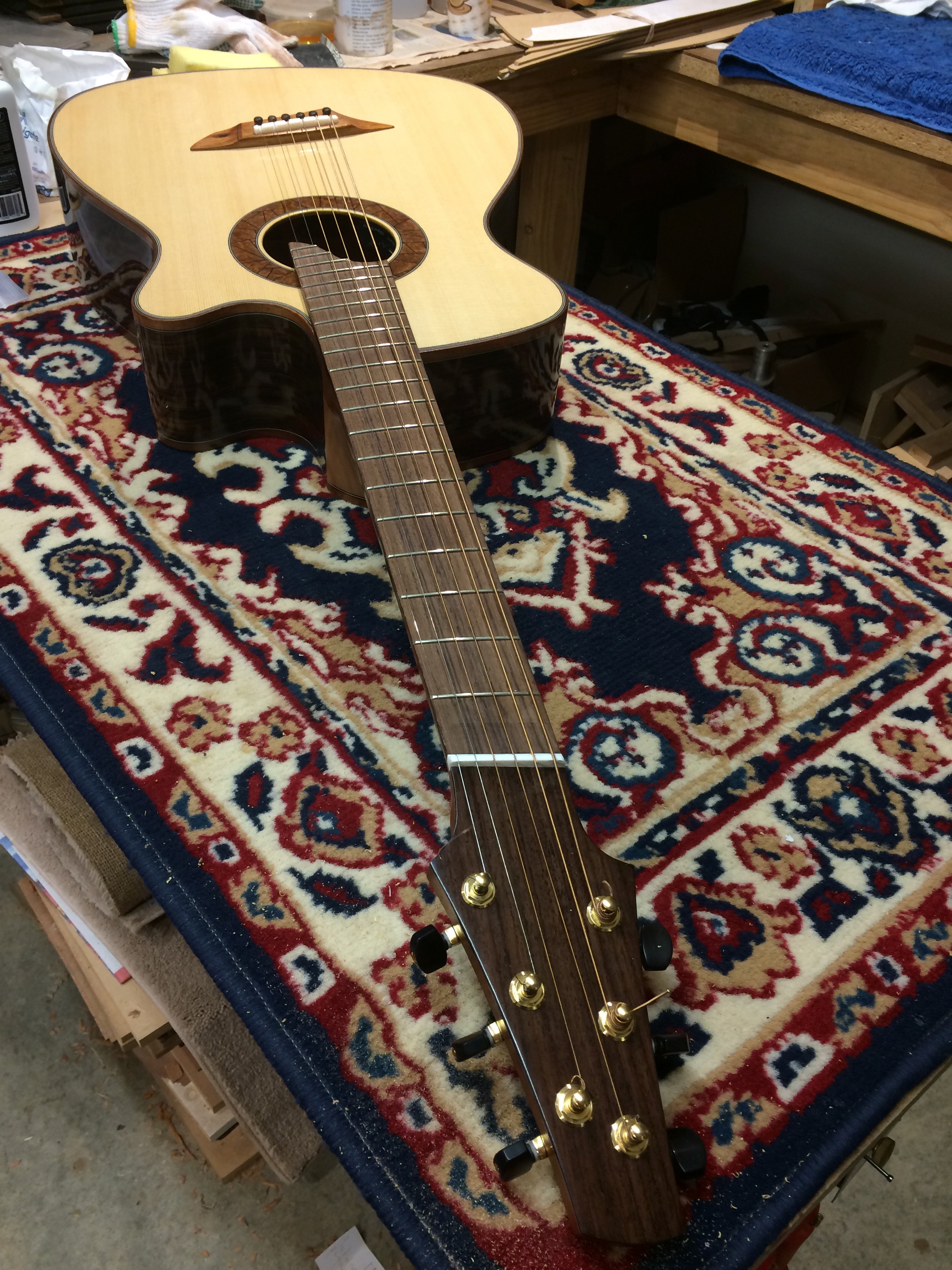

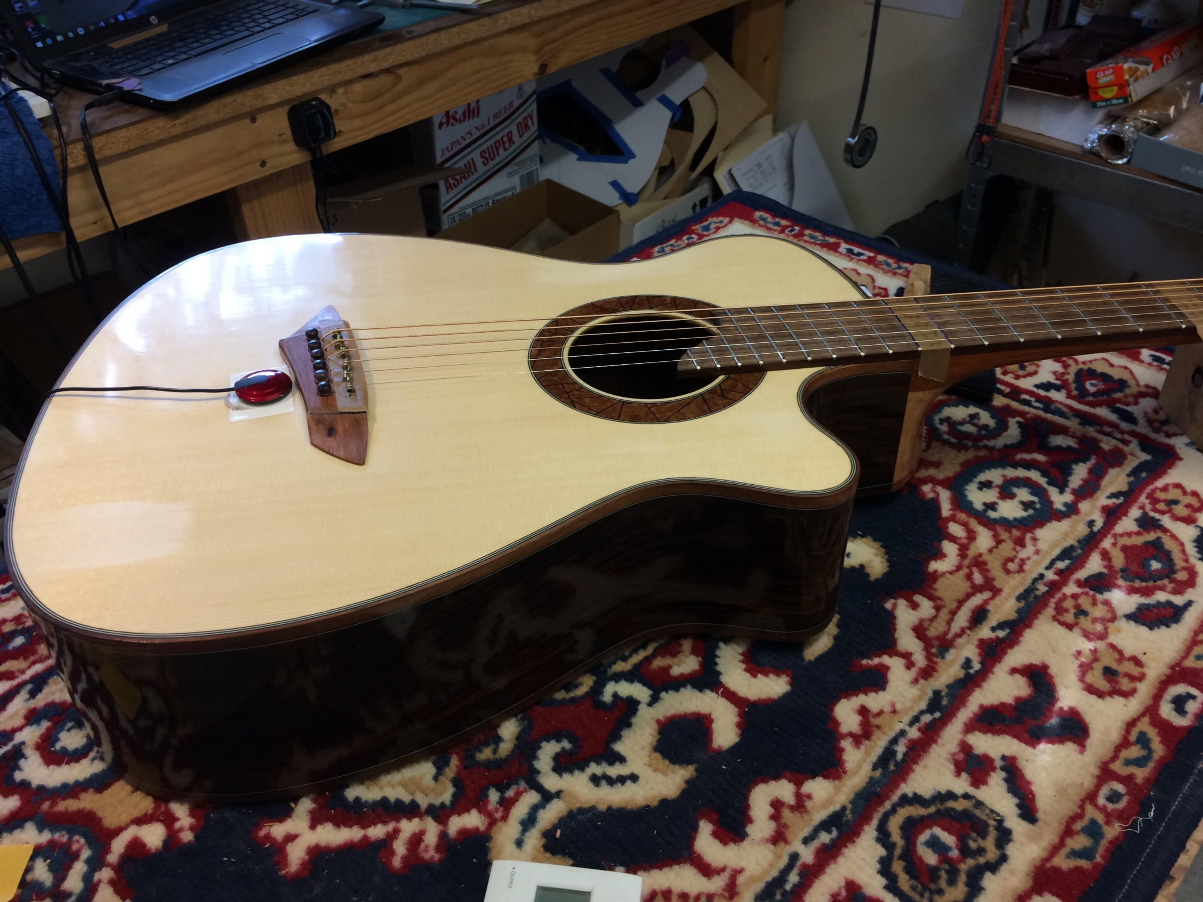

Slow progress as usual on this build but I finally got some strings on and am currently in the process of determining saddle compensation before cutting the saddle slot. The top finish needs a bit of touching up but that will wait until everything is set up.

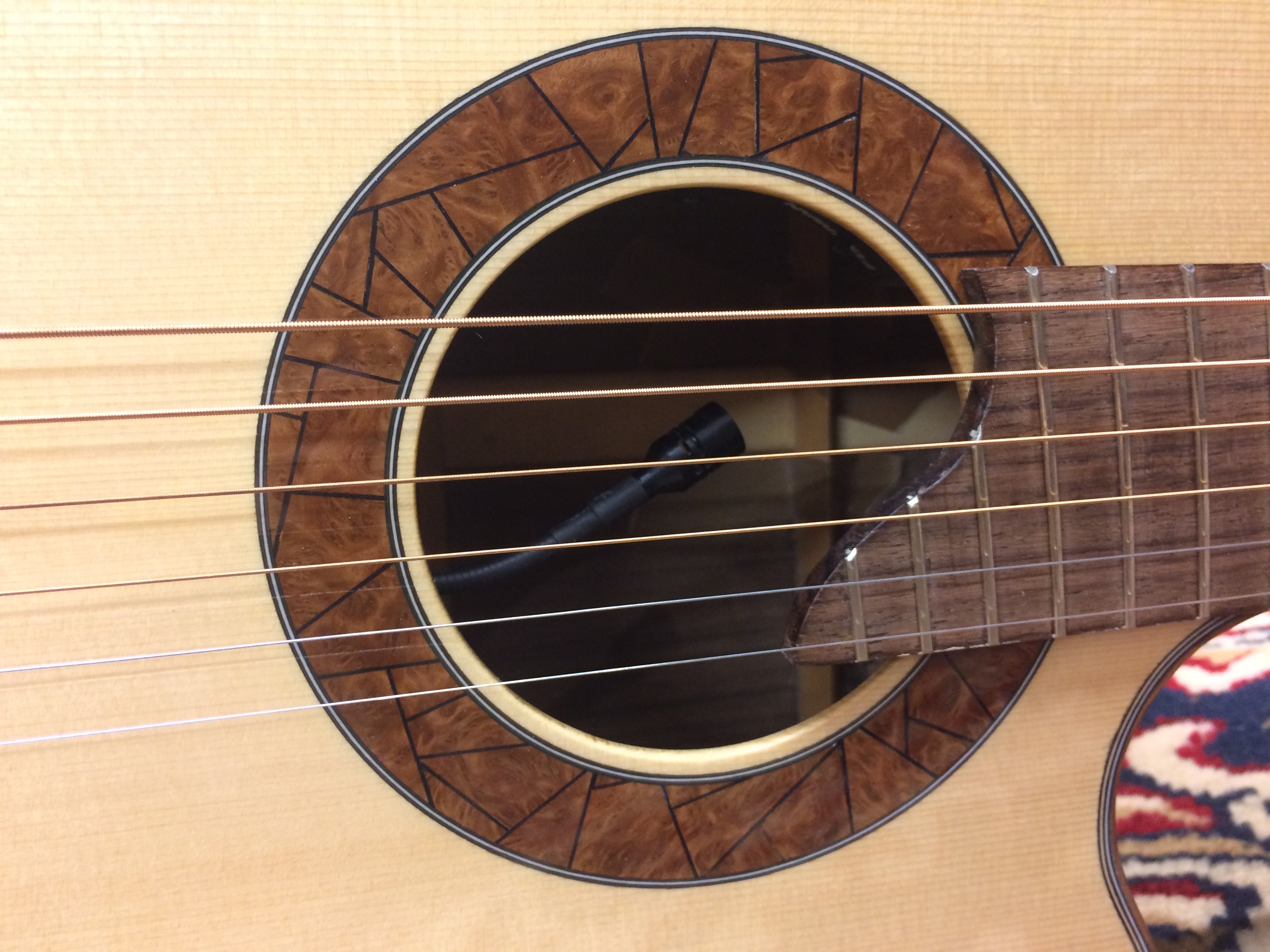

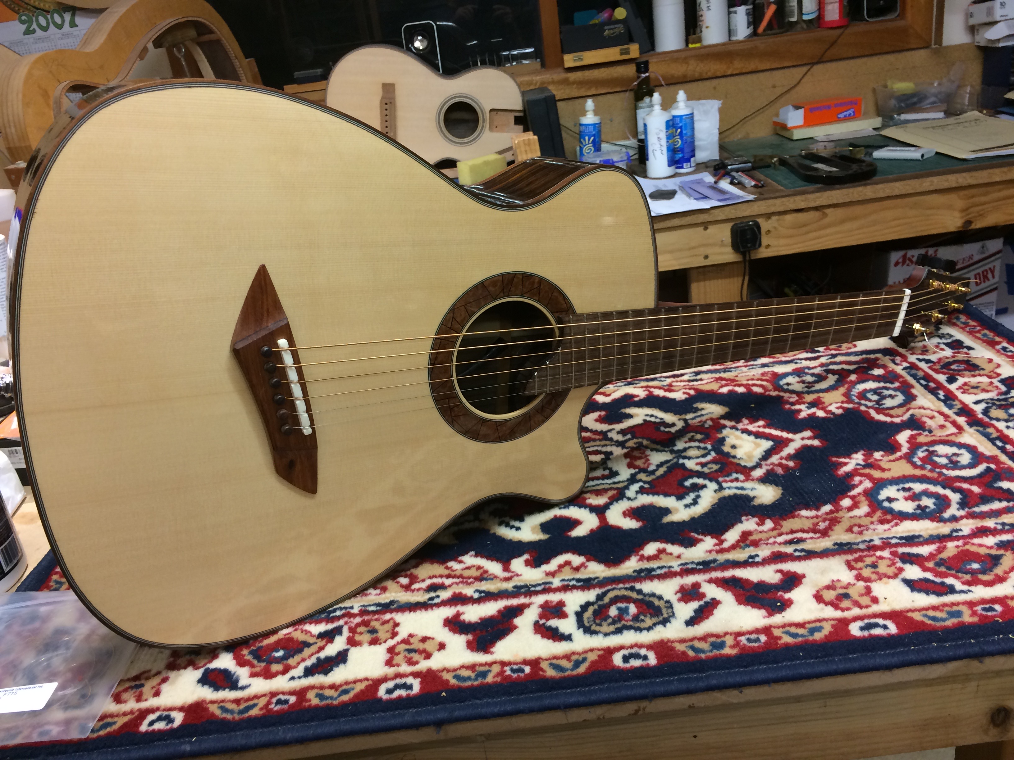

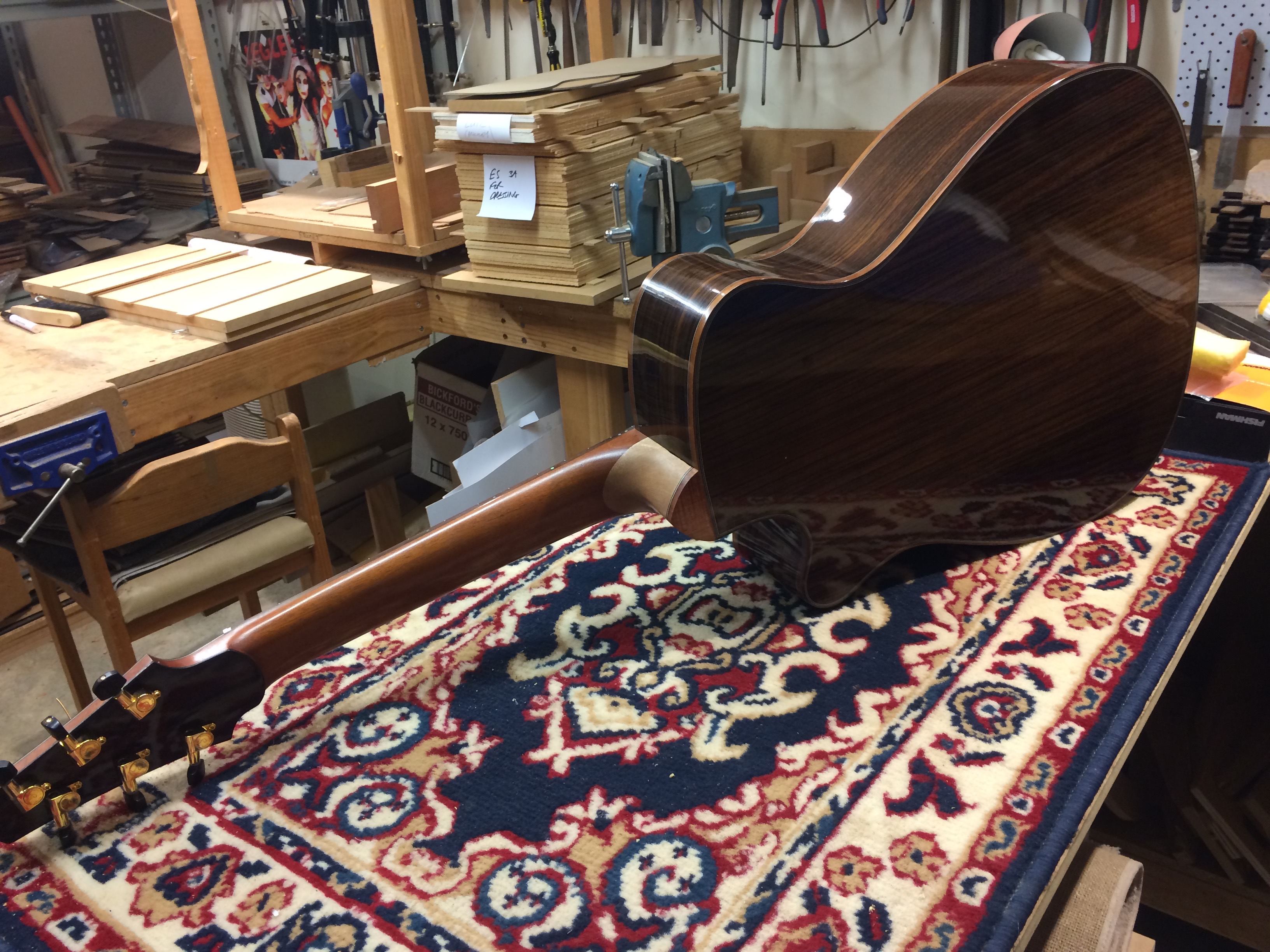

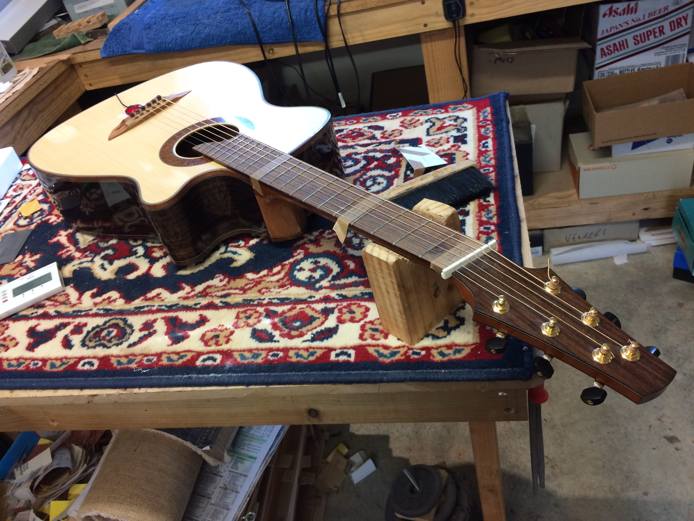

Pretty well finished work on this build after close to 2 years. Got the Fishman pickup system fitted and the guitar strung up after a few months of dealing with finish issues and it's currently "running in" for a week before final twigs to setup.

That is a great looking guitar. It has been fun watching it come together. I love the look with the fan fret, unique looking bridge and gorgeous rosette.
Post by Mark McLean » Wed Apr 19, 2017 6:24 am

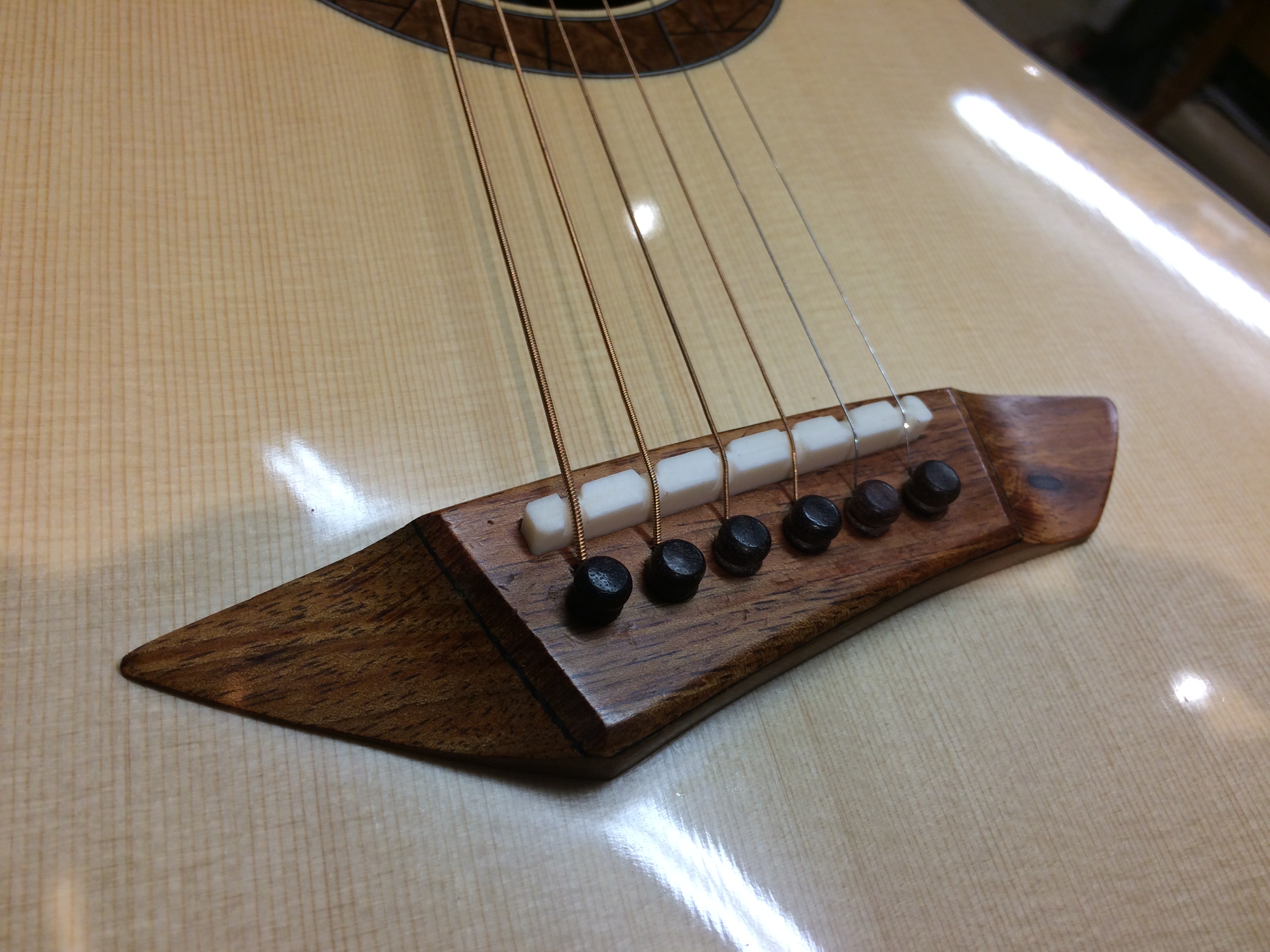

Very nice Martin. I was playing some Lowden fan-fret guitars recently and they were great. It feels very natural to play - no adaptation required at all, it feels more normal than a standard guitar to your left hand because of the ergonomic position. And the string tensions feel good too. You just need to get used to the look of the asymmetry, and I think your design makes a real asset of that. The one thing that I disliked about the Lowden multiscale design is the ugly enlarged bridge.
Your design is a much more elegant solution. I note that you skewed the bracing so that the wings of the slanted bridge cross the primary falcate braces in the appropriate locations. I think Lowden kept the usual bracing layout and then had to make a weird bridge shape so that the wings could stay put while the saddle went on a slope. Not so good IMHO - although they do sound nice.
