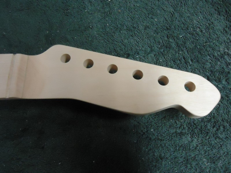

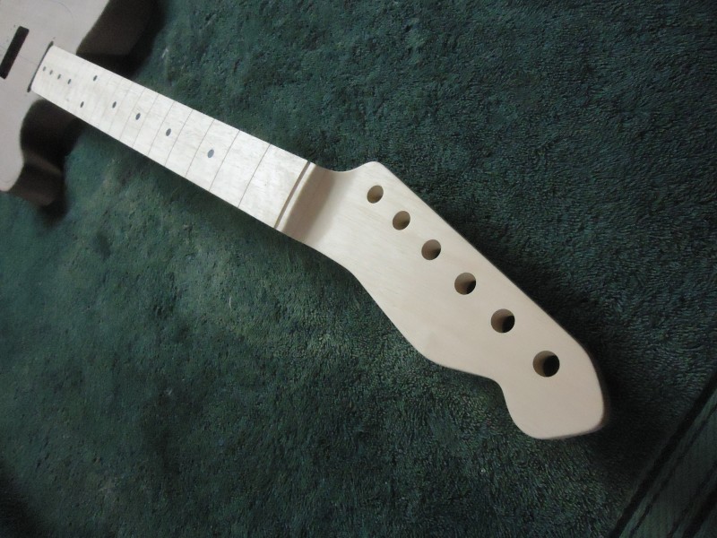

So here is the headstock with what I feel is at least a 25% change
Silver ash neck with Australian ebony marker dots

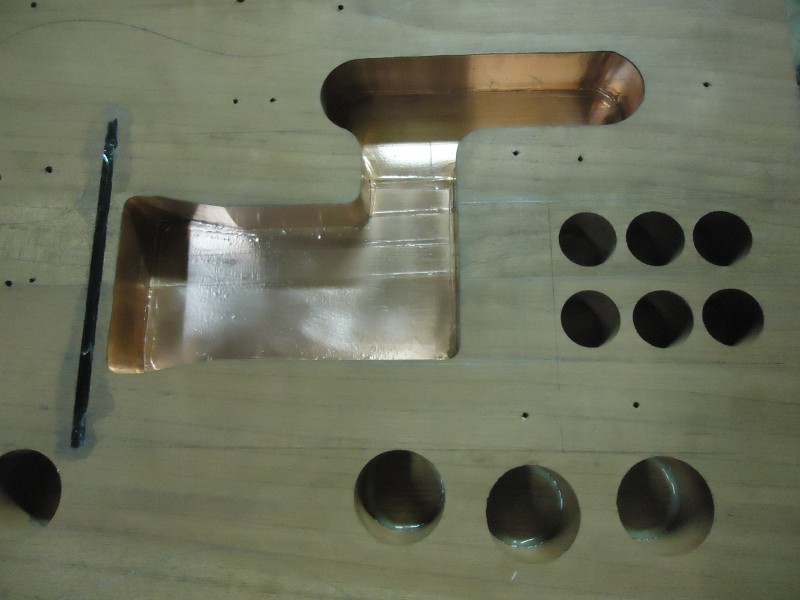

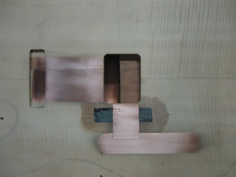

Faraday cage cause once the top is glued on that wouldn't be real easy.

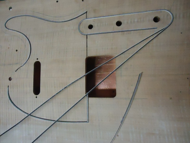

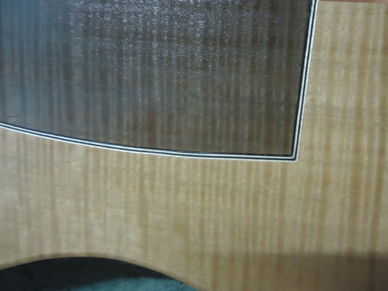

Rebating the purfling to define the pick guard shape ( the only non Aussie wood)

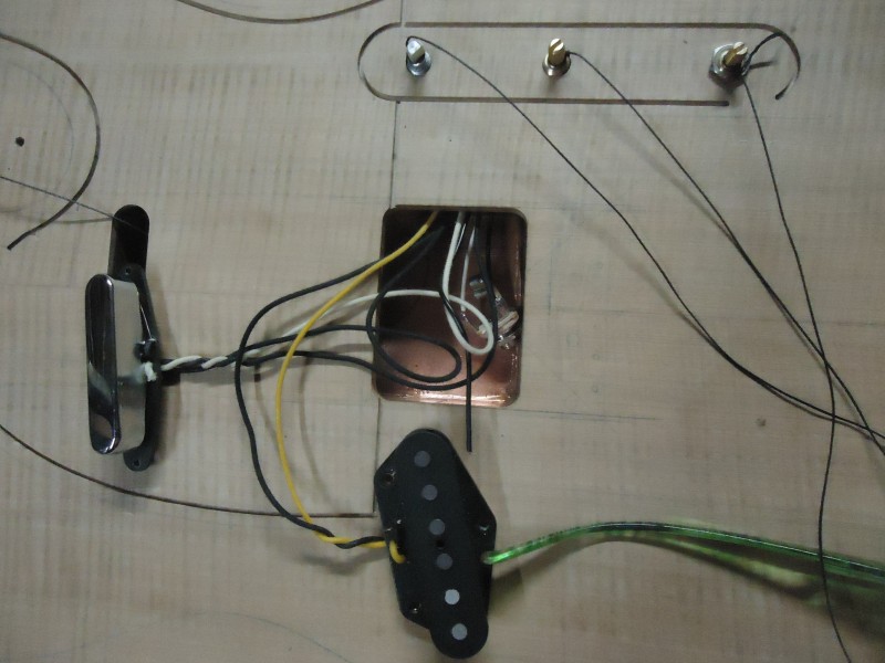

Checking to see if I can get all the gear in through the bridge pup cavity before I glue that top down

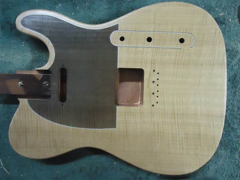

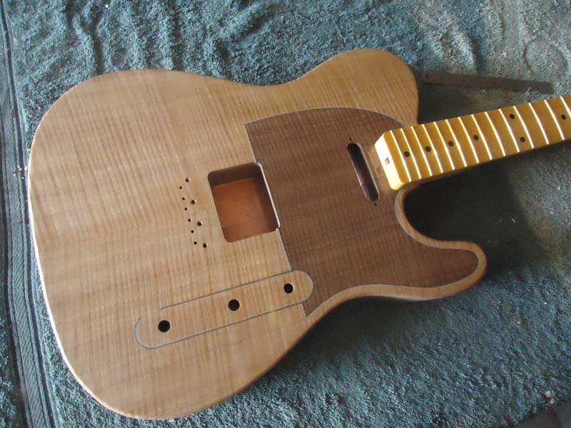

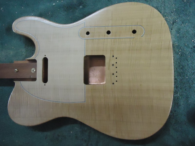

Pick guard area masked off and a couple of coat of lacquer on the rest
The rest masked off and a bit of black tinted lacquer to further define the pickguard
Close up, I may still take a bit of black off, lighten it a bit maybe.

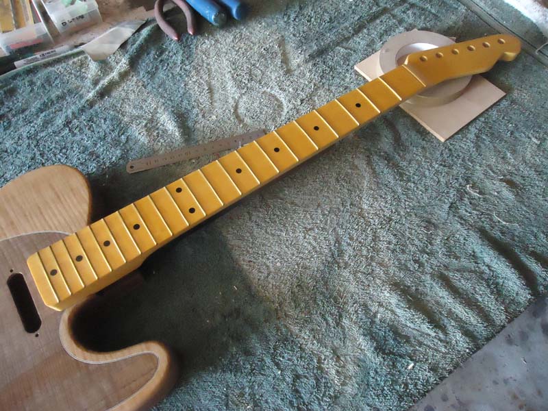

Post by DarwinStrings » Fri Nov 25, 2016 5:05 pm
Spray time, today I put the first build up of paint on, added a little colour to the neck, gloss on the top all the rest satin.

Re: In Lieu of Lurking
Post by Hank » Fri Nov 25, 2016 6:01 pm
loving the look and ideas, how you gonna adjust the neck?
Post by kiwigeo » Fri Nov 25, 2016 6:21 pm
Hank wrote:loving the look and ideas, how you gonna adjust the neck?
Unless you can get a special spanner down to the adjuster you take the neck off and then do the adjustment.
Post by DarwinStrings » Fri Nov 25, 2016 7:36 pm
Yep Martin, Hank, no special spanner so remove the neck. It is a Mark Blanchard differential rod, so nice fine adjustment(not the "group buy" China made one) He high strength brazes them rather than welds them now and all S.S. parts
