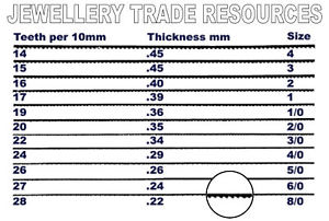

As to your inlay posts, I find that 400 grit still leaves fine scratches particularly visible in slab inlays like the one in the tute. I have seen MOP which varies in hardness, and sometimes jobs which need inlay fixes have used celluloid and plastic inlay material which is even softer. I go to at least 600 grit. (Same with frets.) A sharp scraper is best for inlays if they are sitting proud, and if necessary go thru the grits. Also, I don't like inlaying with epoxy, but will sometimes use it mixed with fine wood dust as a filler around inlays if I have to (depending on the wood), in which case I have used casting resin. I have found that a chain saw sharpening stone in a dremel is great for fine tuning the shape of inlays once I have cut them and needle files for the finer shapes in the inlay. The other point re inlays that I have learned is the rule for jewellers saws. There needs to be a minimum of three saw teeth within the thickness of the material being cut for the saw not to grab. The thinner the material, the finer the saw needs to be.- Ross

To elaborate on my comment
I have found this chart. Might be helpful to someone. Maybe on the Tutorials page?
jewellers blade sizes.JPG (18.77 KiB) Viewed 18502 times
