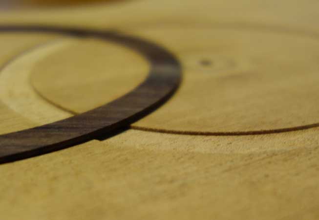

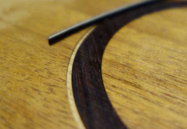

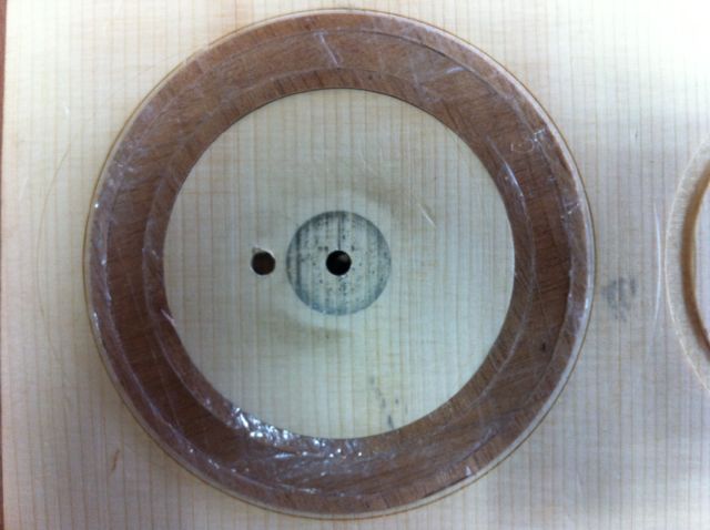

The 3 rings below obscured under the sticky tape are just cut and pushed into a practice piece with no glue.

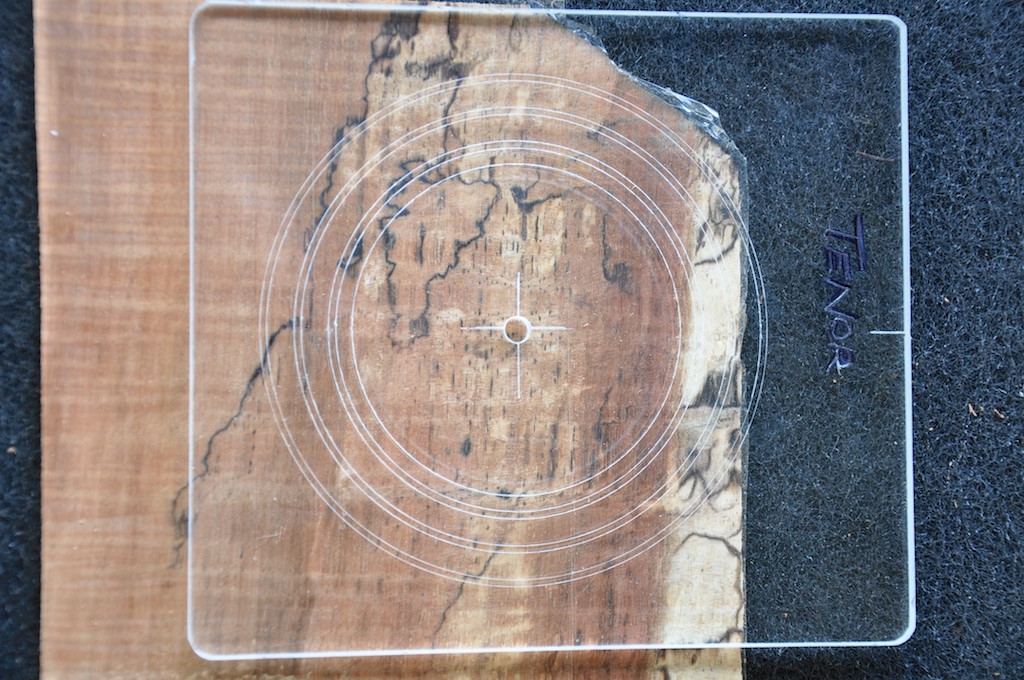

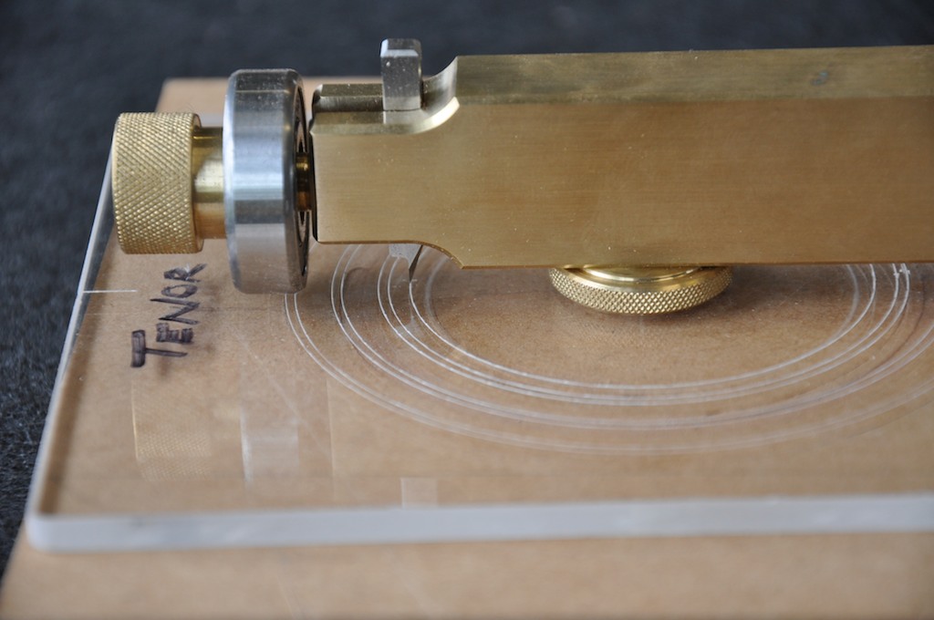

Here are a couple of photos of how I use a perspex template. I have them made up for each size of instrument I build, and if I want to do something different, then it's not hard to make another. Keeping in mind what side the blade will face is probably the trickiest part for me at least. Easy to get confused and have the bevel to the wrong side unless you plan out your steps. But putting the blade back in the scribe line doesn't get much simpler.
The beauty of making the template full size is that I can place it over the inlay material that I want to use to determine the color pattern and figure that I want to incorporate. Then it's dead easy to mark out the centre and away I go. As well I highly recommend putting clear sticky tape over the rosette material before trying to cut it. Very easy to break on most woods.
These were some photo's I took of the building process for Honey's Tenor uke.

So, again, the same line is used for both the edge of the rosette inlay and the edge of the rosette channel.

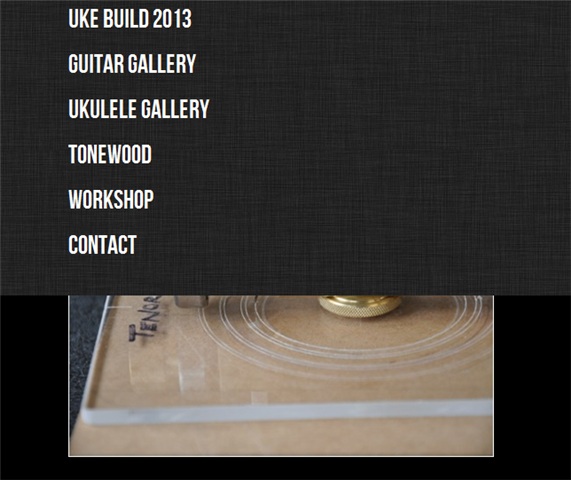

Btw Allen, I have trouble veiwing your new website layout.
The title banner/menu on the top of each page overlays the beginning of each page.
Here's a snapshot...
Allen's Page (Small).jpg (65.68 KiB) Viewed 31032 times

Yes, the same line.

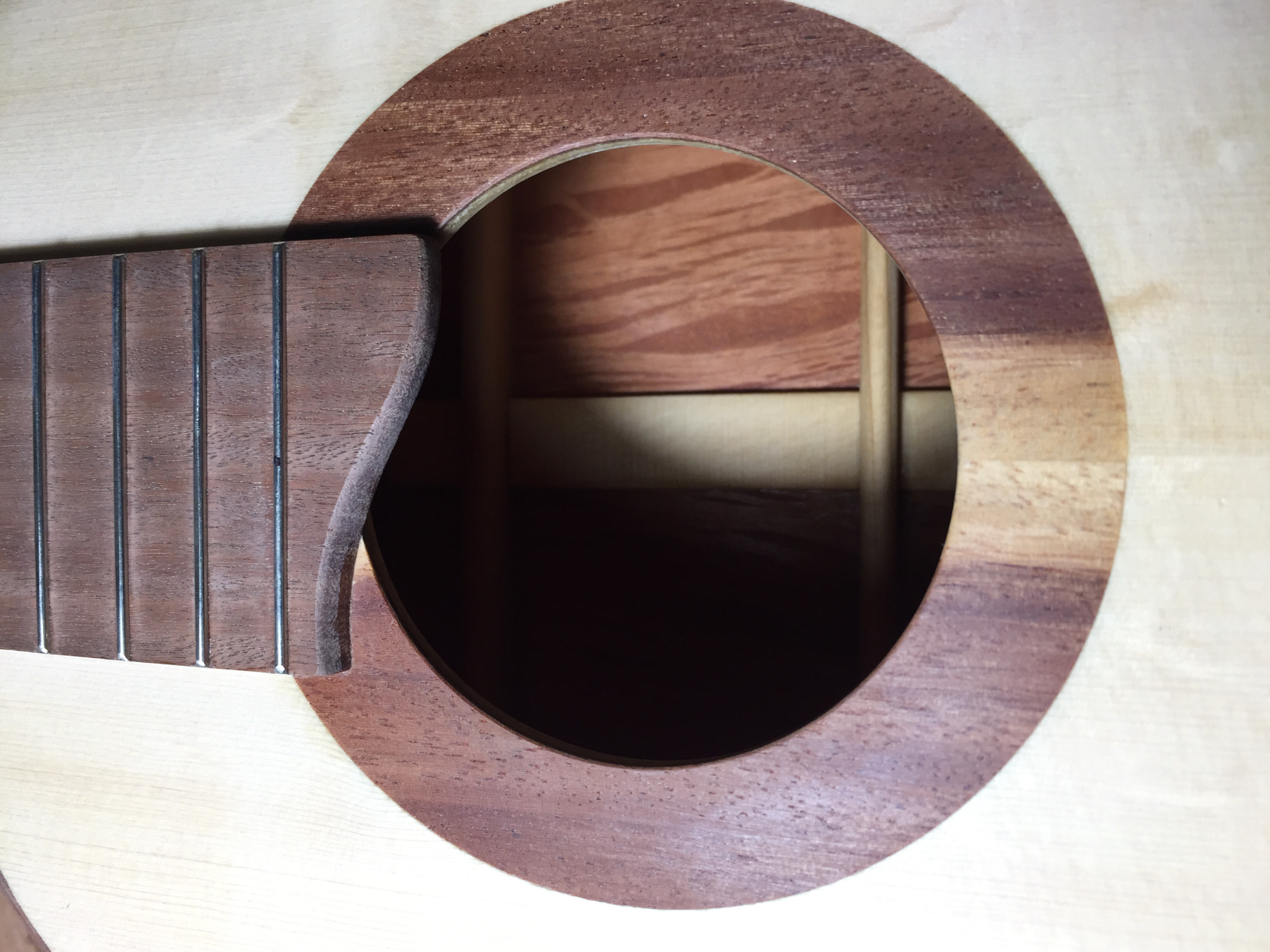

used mine for the first time last weekend - love it. Used it to cut rosette and channel - nearly left it at that coz it fitted so well, but went ahead and next cut channels for purfling and lastly sound hole. All cuts super clean, did not need any tweaking or tidying up at all. Light scoring on a perspex storyboard is a simple and elegant way of ensuring perfect re-positioning. Really happy with the way it performed and it gives me confidence to try and be a bit more adventurous in design next time.
Kevin

Thanks for the reply, that is a beautiful installation, perfect fit! I don't mind paying for something that performs that well, I just have to wait until Michael makes a new batch.

Now Kevin that is a very nice job mate!
No wonder your happy with the tool.

But all I really did was guide the thing round. Micheal's tool was rock solid, the blades nice and sharp and the weight enough that it did all the actual work :cl
It made the exercise a real pleasant way to spend some nice and quiet time - took something that I found a little daunting and fraught and made it an almost meditative experience
