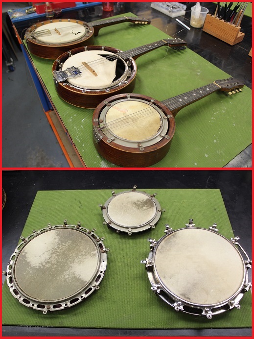

Hey folks,
Do not know about everyone else, but Christmas was just ridiculous workload from the schools.
Have finally gotten back on top of that, so first job for yesterday was three banjo skins.
I remember other forum posts where people have asked how to do this, so this may come in handy for some.
http://www.mirwa.com.au/HTS_Banjo_Skin_Replacement.html
Banjo Skin HTS.jpg (167.13 KiB) Viewed 14492 times

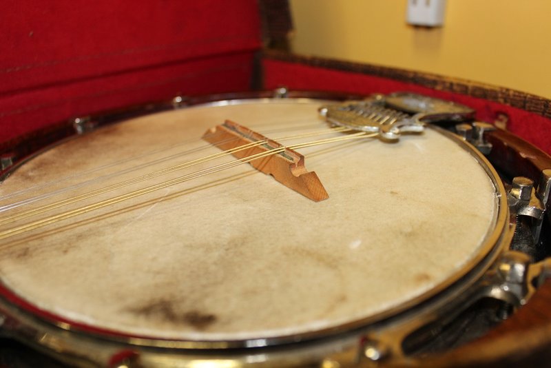

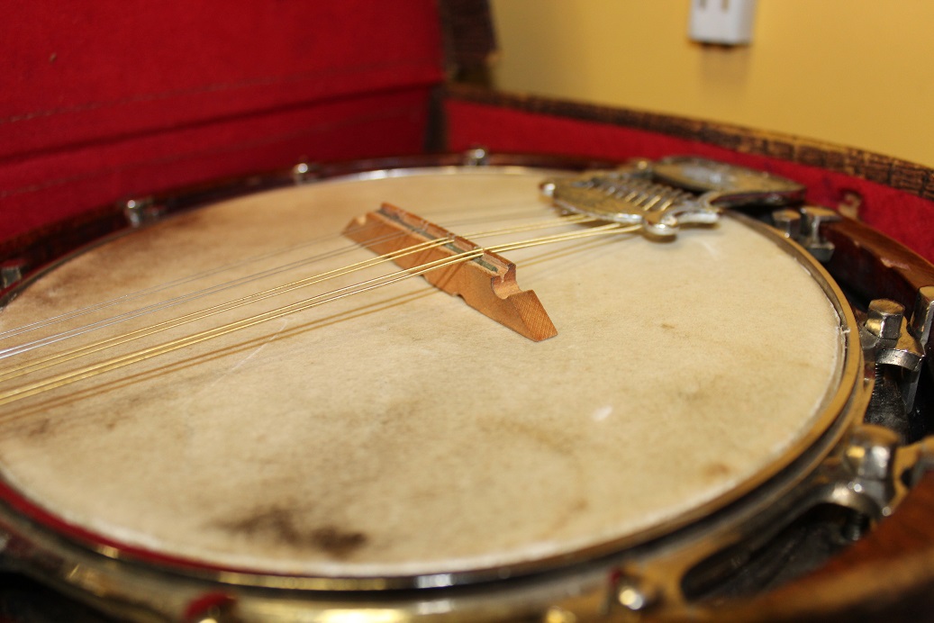

Here is a close up side view in tension, very small deviation of the skin head
The outer shell is almost flush with the skin head.
In theory your meant to tension it until you get an A from tapping the surface, I find this to be incorrect, I adjust for best tonal sound.
If this was a calf skin, then the deviation of the head would be far greater and the head would be way more resonant as the calf skin is a lot more pliable. However this was roo skin, and that is nice strong and gives a bassy tone.
