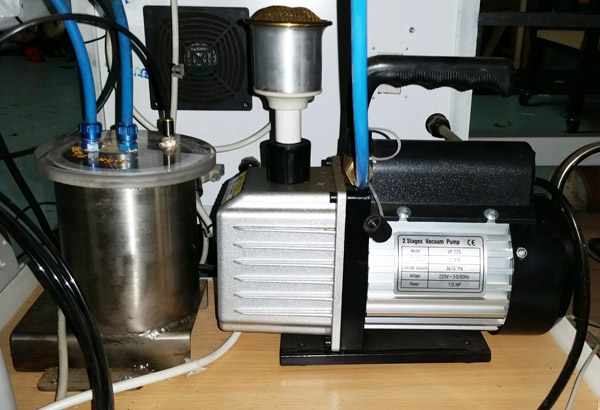

I use a catch pot similar to this acts as a secondary storage and all the foreign particles end up here not in the pump :)

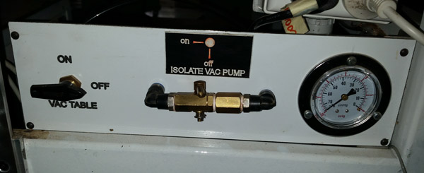

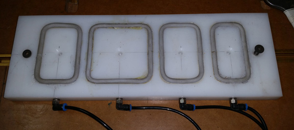

I have worked on most pumps ,I know a gasket cutter that uses quite a large one he pulls the gasket material down onto a foam bed .For me I was originally going to(still want to ) Vac bag fiberglass so my set up even for cnc is fine have used the small vac bed i routed for quick stuff ,the Vac pump is a two stage one off ebay $ 100 or so built the tank myself I have had it running a lot no problems .First thing I did was buy some good oil :D ,the rubber in the bed is for vac holding soft as, I have a place up the road Schmalz Vacuum Components I wanted 6 mmm dia they only had 8 .
The panel I made so I can lock off the Vac where i need it and a cheap gauge away you go ,I do have a Veturi it needs constant air works well but with the Vac I can just shut it off and hold ,so thats my easy set up hope it helps .

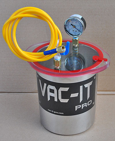

Stuff pumps..just hook a hose up to this vacuum reservoir... :mrgreen:

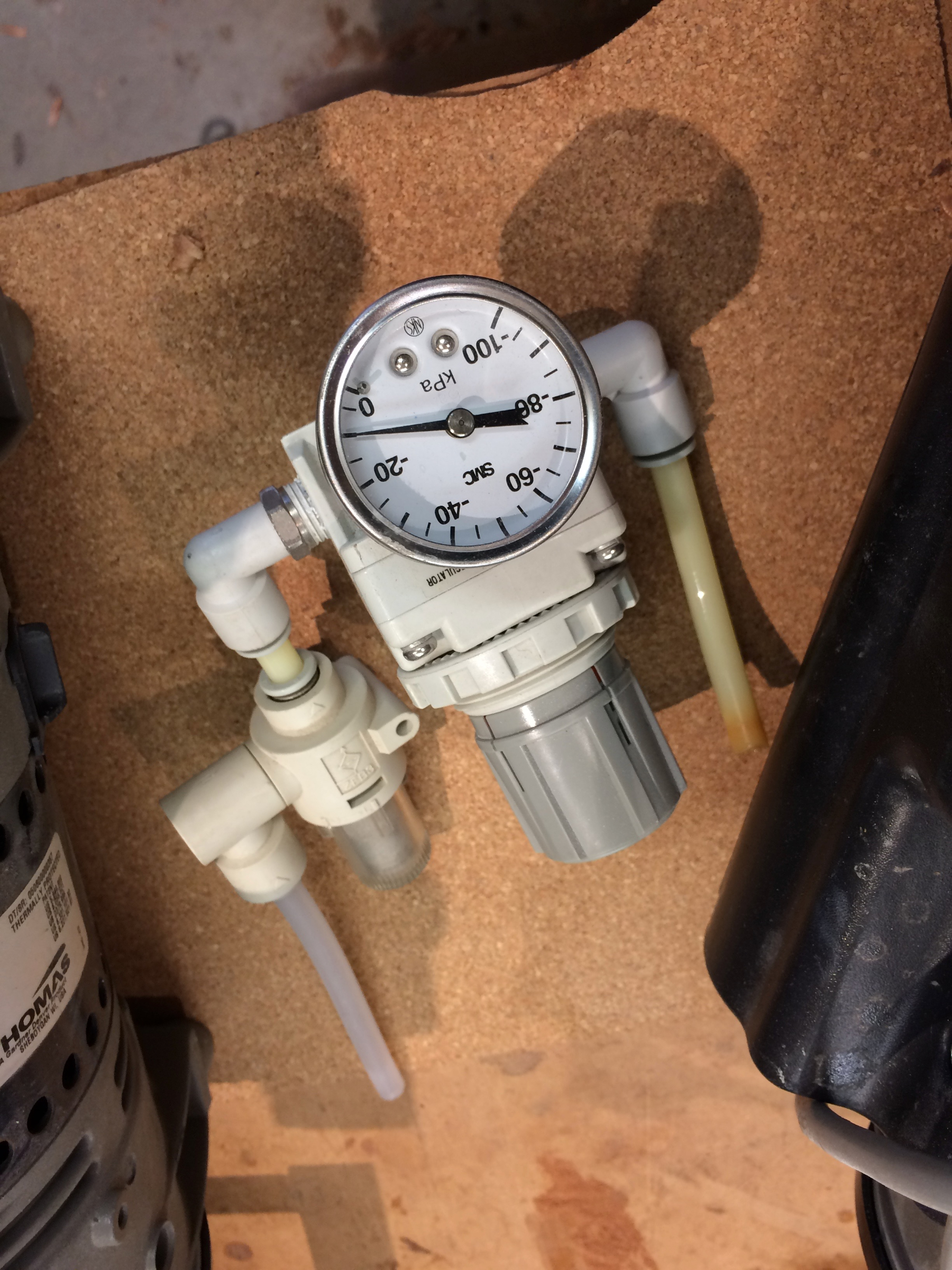

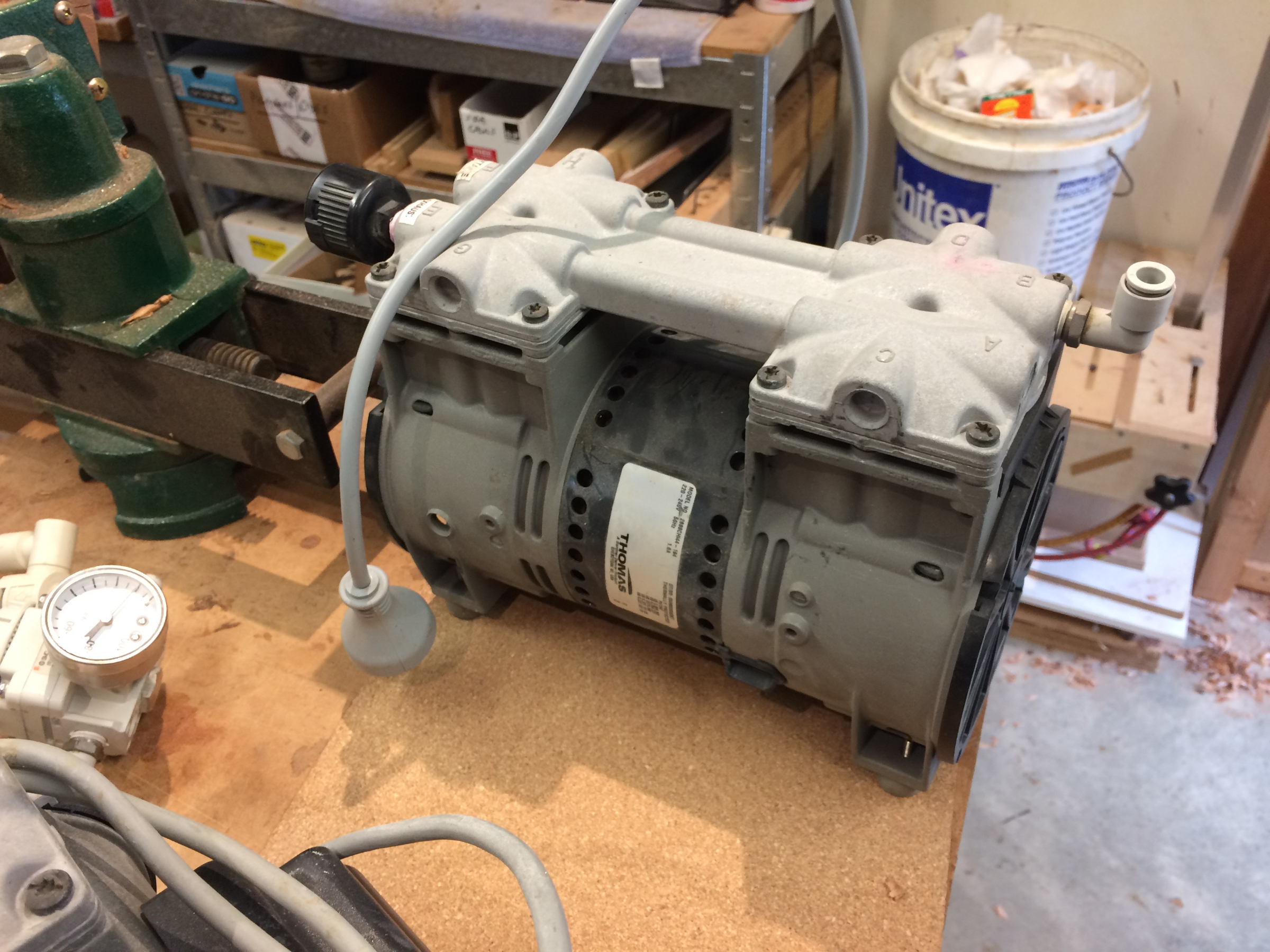

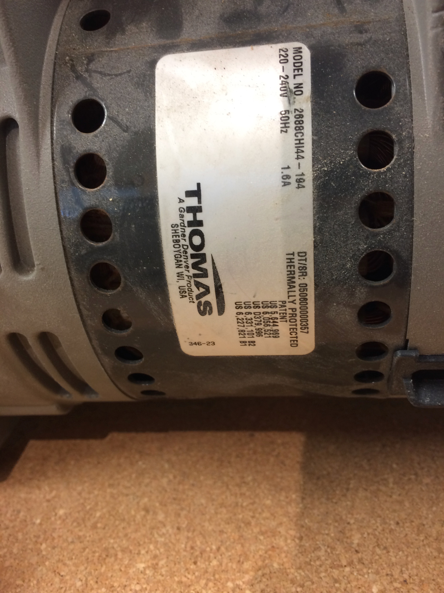

Rod, I had a dig around today and found a complete vacuum kit that I think was part of a group purchase years ago. There are two vacuum pumps...both Thomas 240volt 2688 series pumps with accompanying regulator and filter. The pumps came from Joewoodworker.com in the US so theyve been serviced and ports set up for vacuum clamping use. http://www.joewoodworker.com/docs/thoma ... ctions.pdf
I can spare one of the pumps if youre interested.

Re: vacuum pumps
Post by rocket » Sun Mar 12, 2017 5:04 pm
Thanks Martin done deal, I'll pm you
