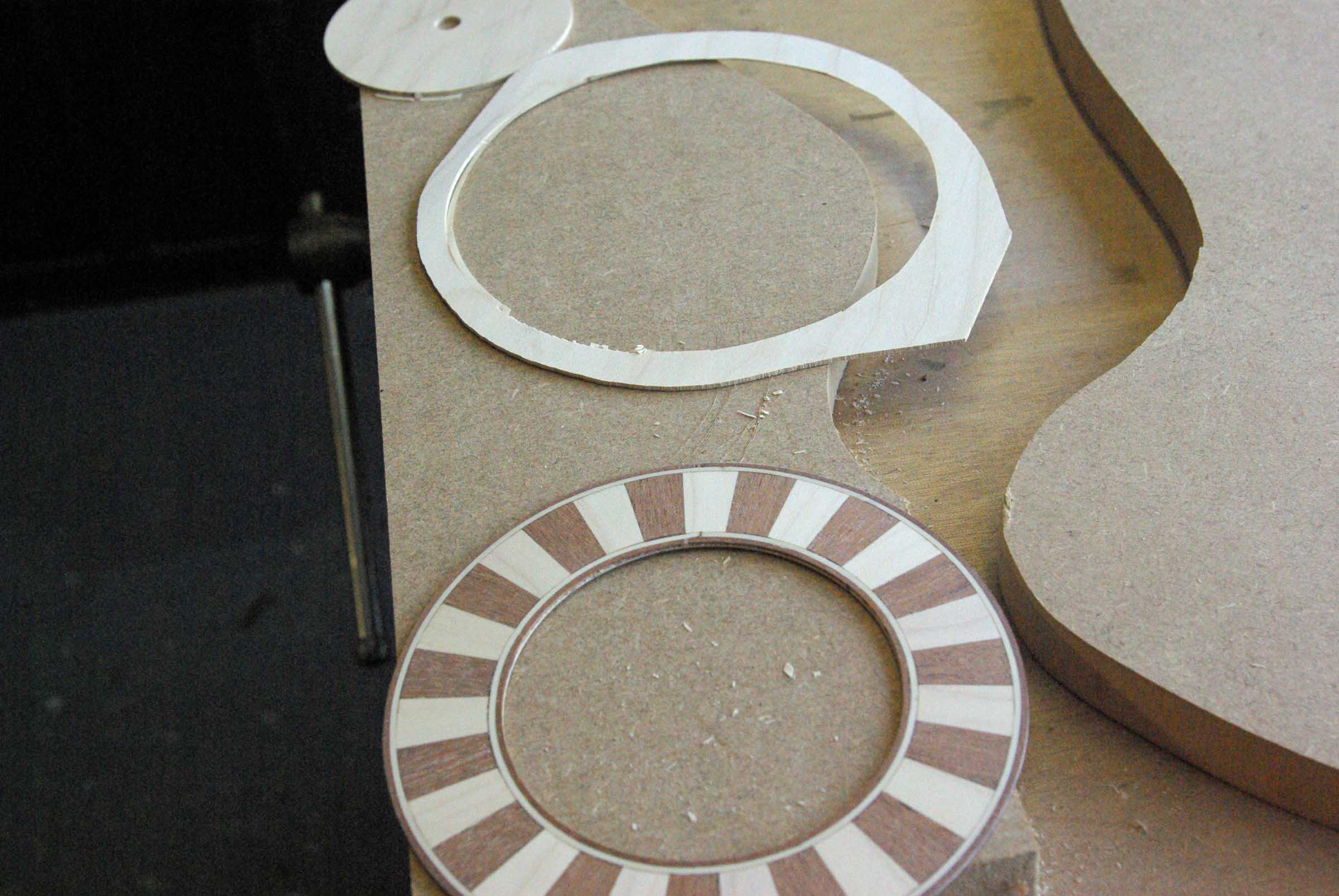

Just for interest this is what I ended up with, using bits of technique from all over. It is in mahogany and sycamore - woods with similar hardness, but the white rings are in holly because I happen to know that this sycamore does not want to bend.
