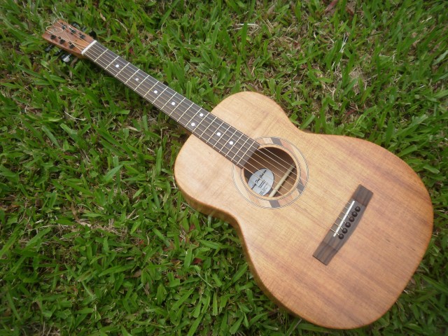

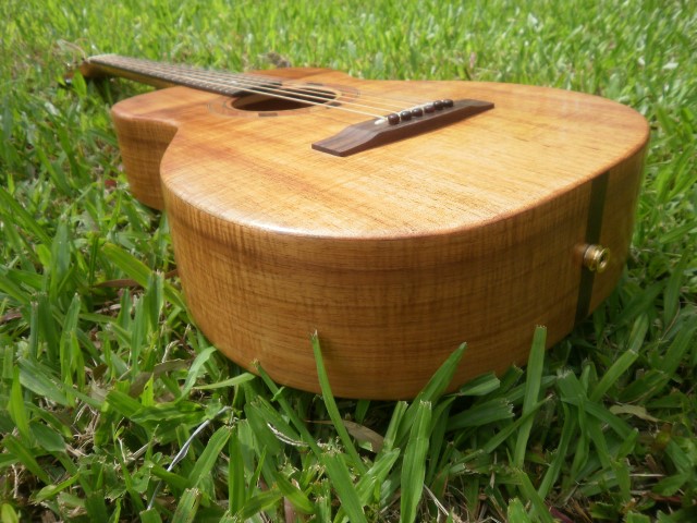

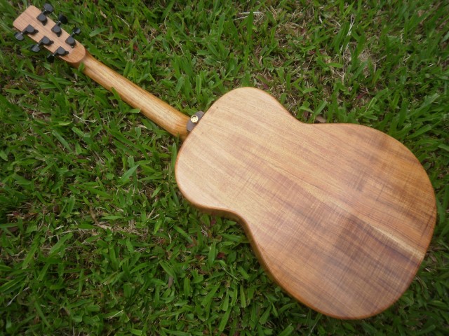

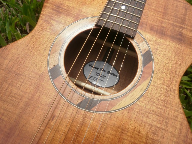

Re: Blackwood guitar
Hi Jim,
I built a 018 all Blackwood sometime back and I thought it was very good tonally.
My Son uses it and likes the guitar with a k&k Mini Western system.
Here are a few pics.
Beautiful Alan, I'm inspired. Very sweet looking little number. Yeah, I think I'll give it a go.
Thanks Jim.
The top was especially chosen for this build.
It was stiff, light in weight and responsive.
Not sure if you have material but if not, give Tim Spittle a call and he can select suitable top, back and a sides set for you.
Yes my top was chosen by Bob and is Ottway Blackwood.
Unless you know the right person that has the experience to choose a top it will be difficult to build a good sounding guitar.
