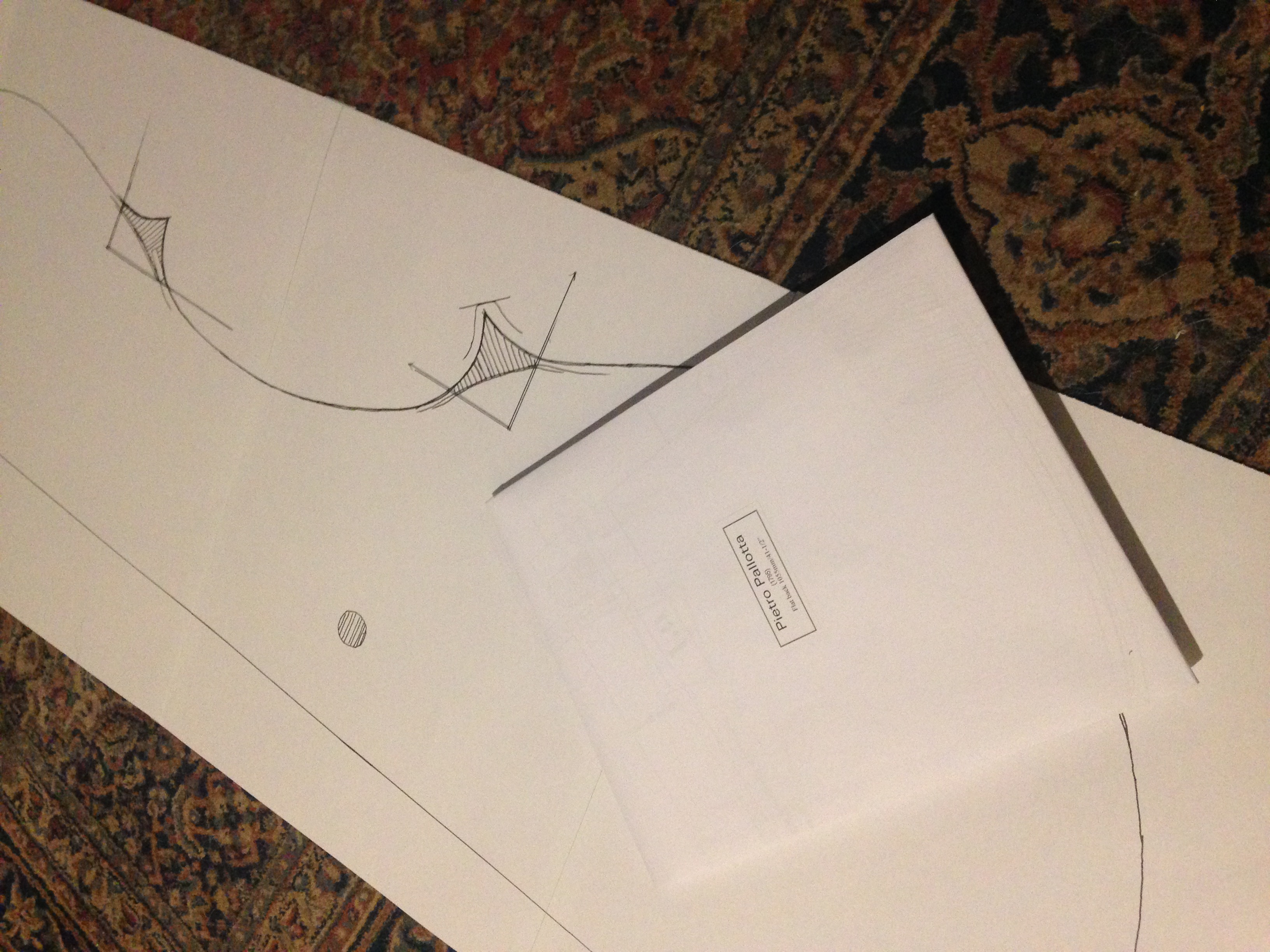

Thanks Jim, I'm still thinking about the top wood. Also need to save up a bit more money because on Friday I bought some Ottways Blackwood for the ribs from Curly Pete (thanks Pete) and some English Willow logs for blocks from a Cricket Willow farm, which I spent Saturday cutting up and waxing endgrain.

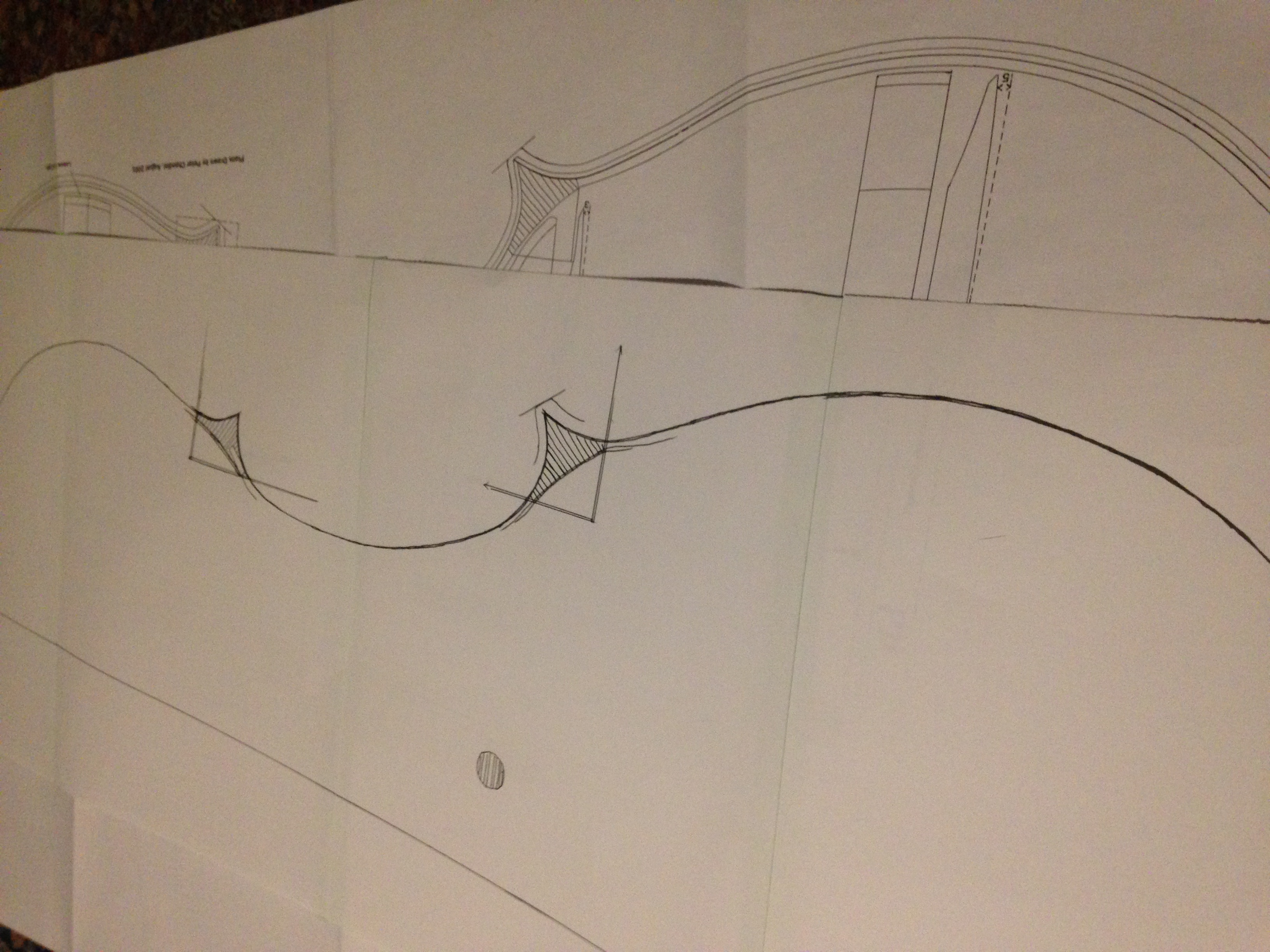

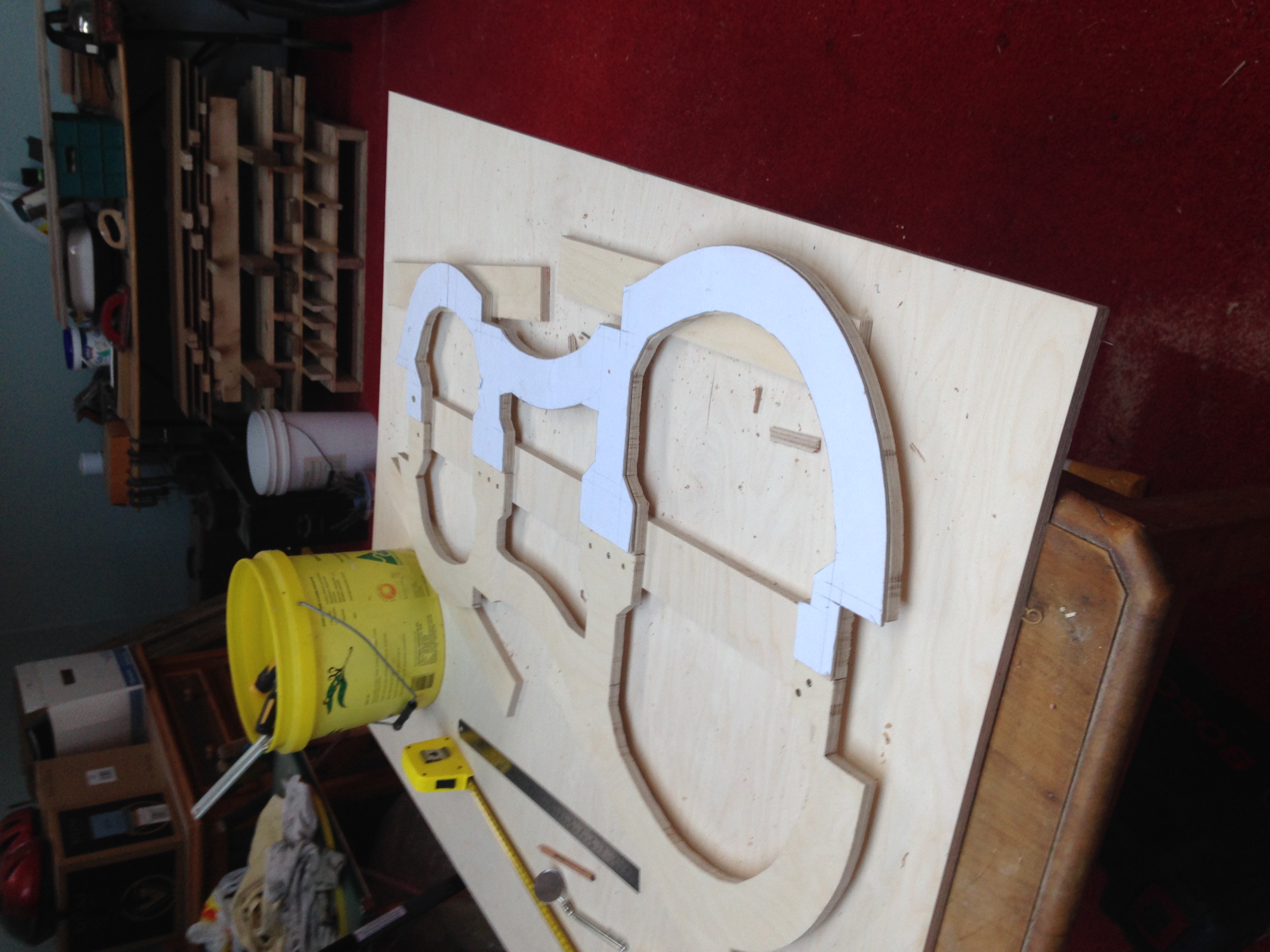

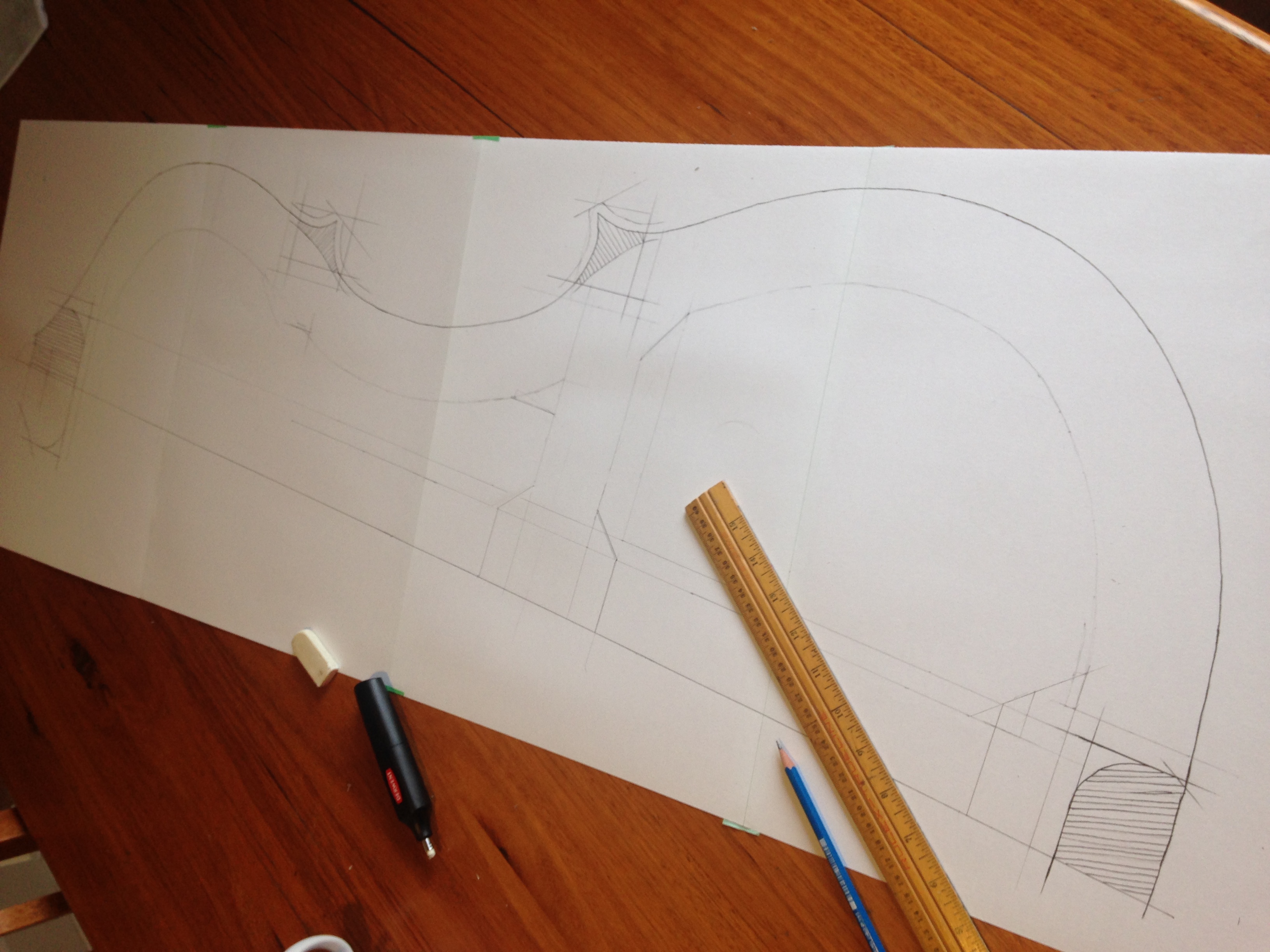

Plans have arrived this week (
), so I'm preparing a mold outline for the template.

Still working out the plan for the mold this week. Hope to start cutting the template on the weekend.

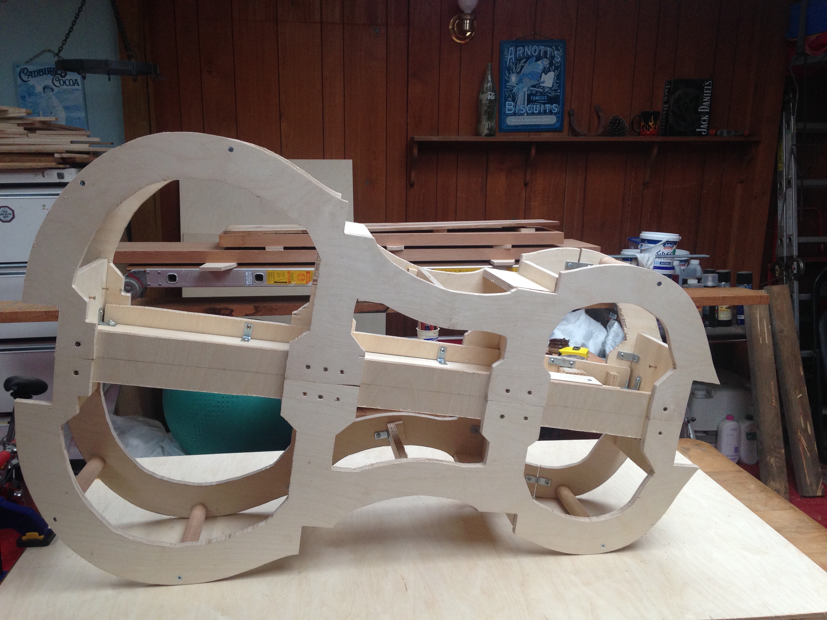

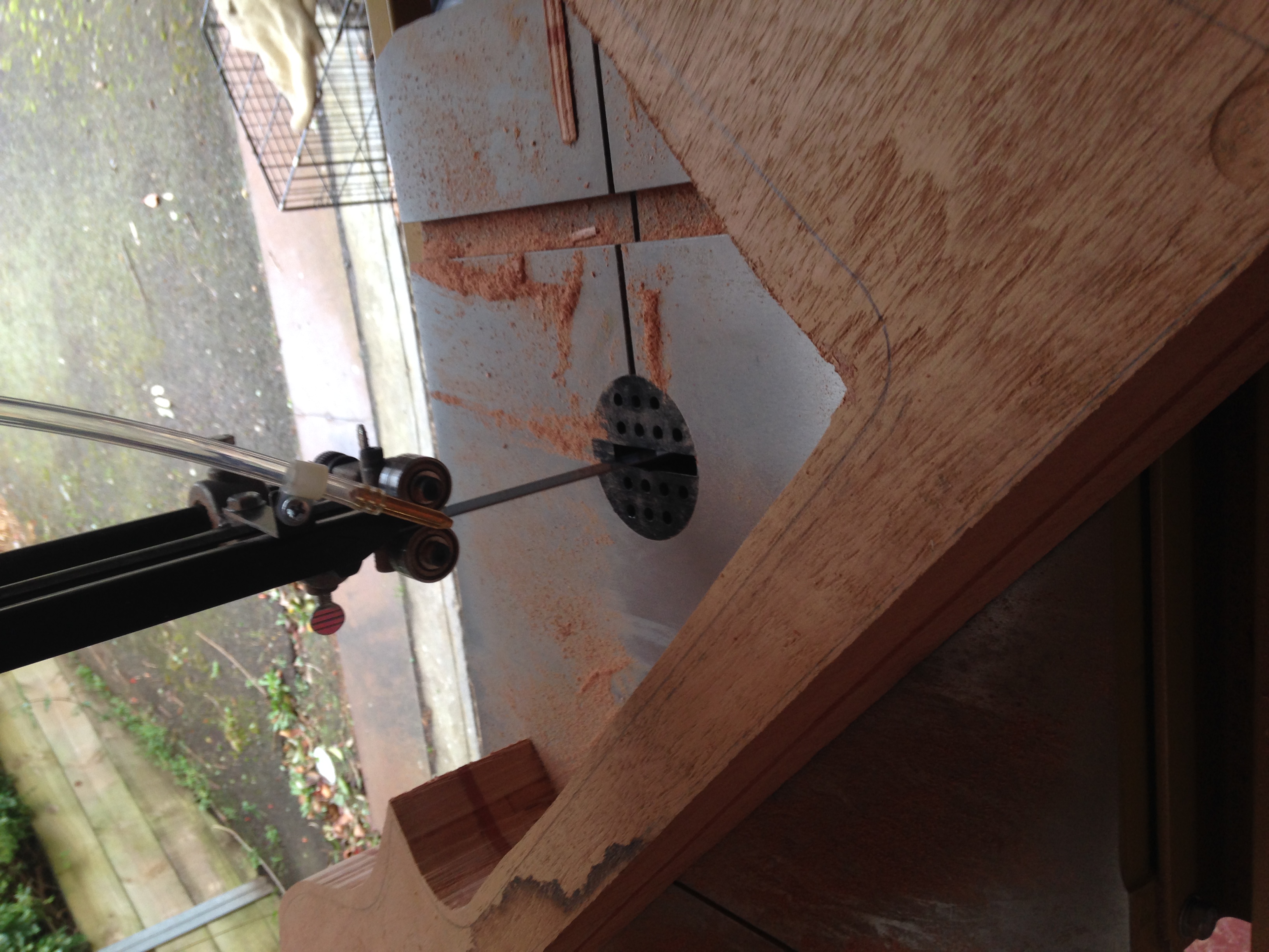

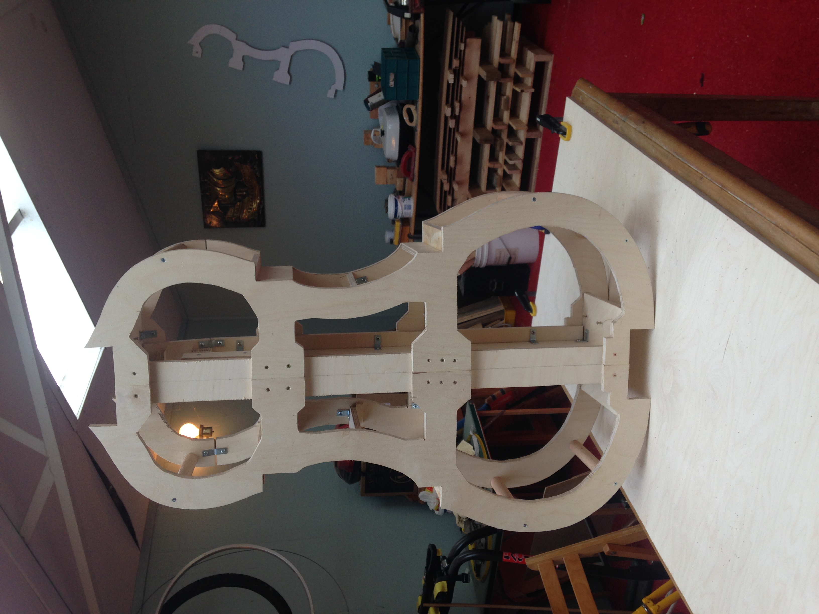

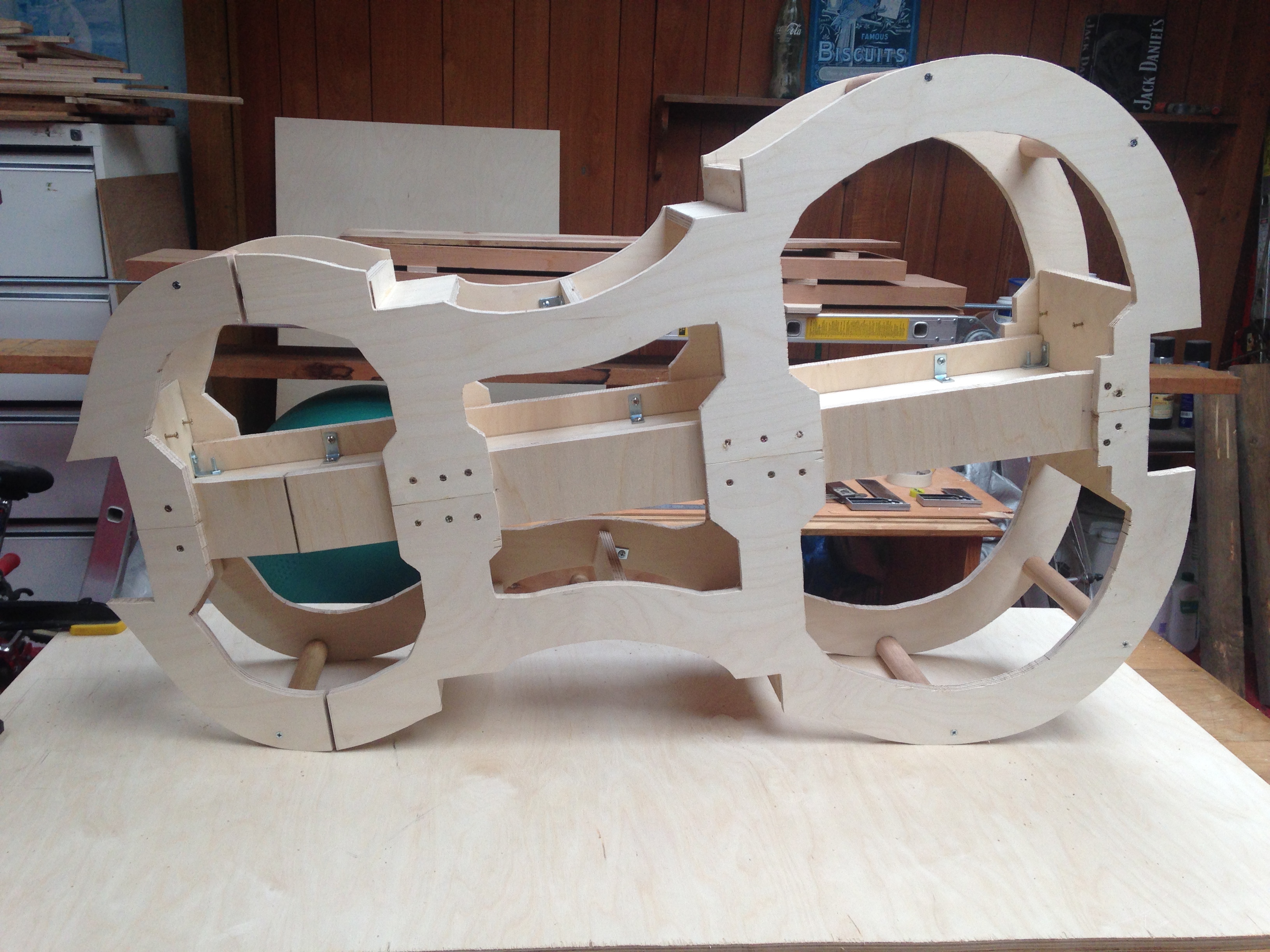

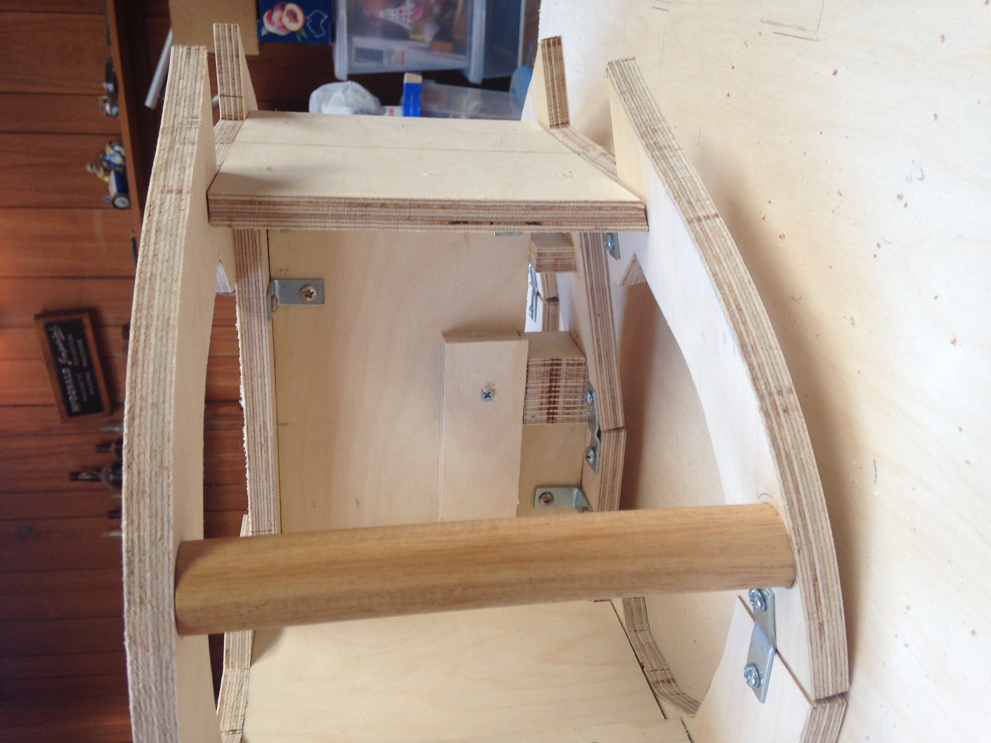

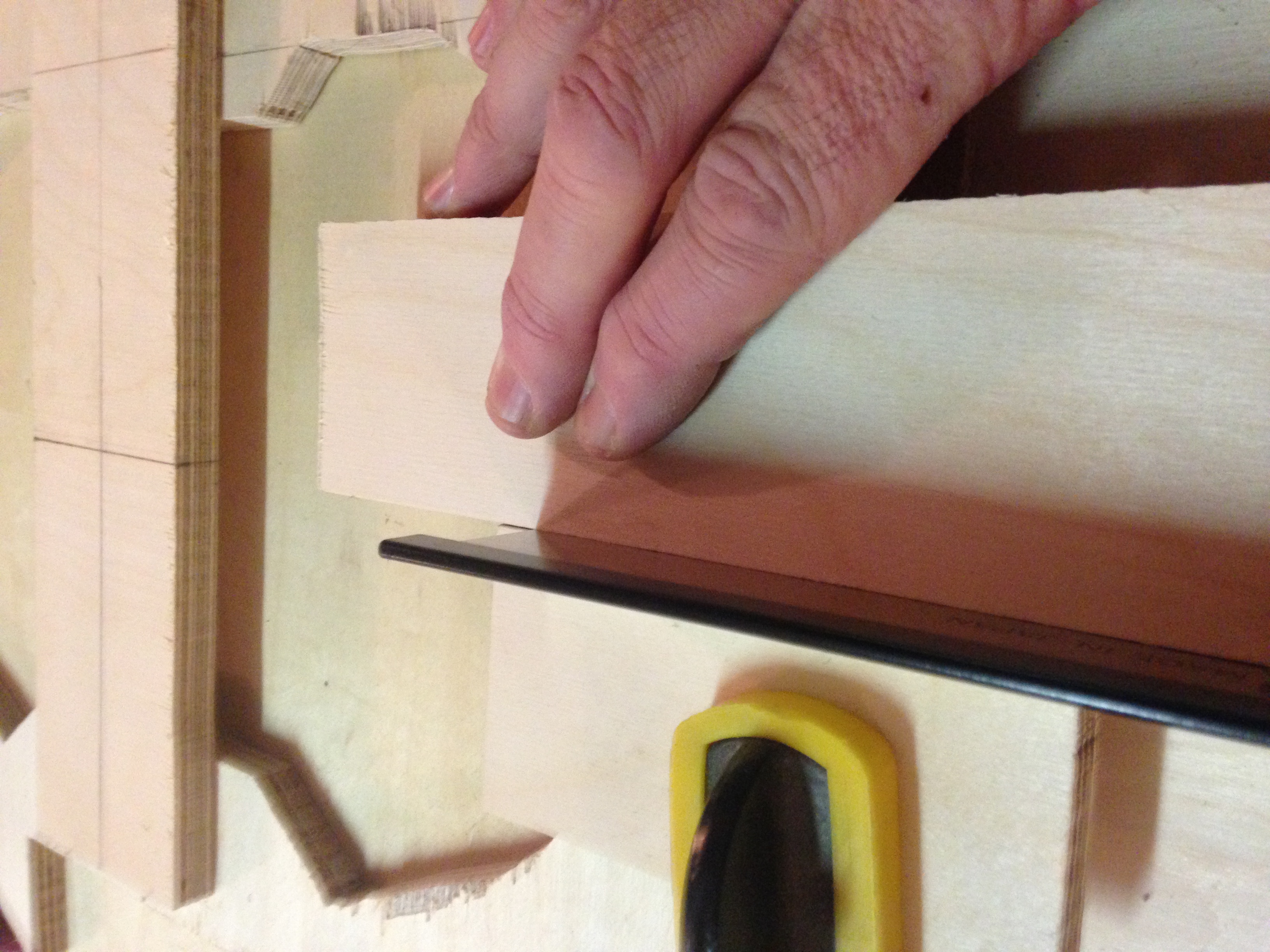

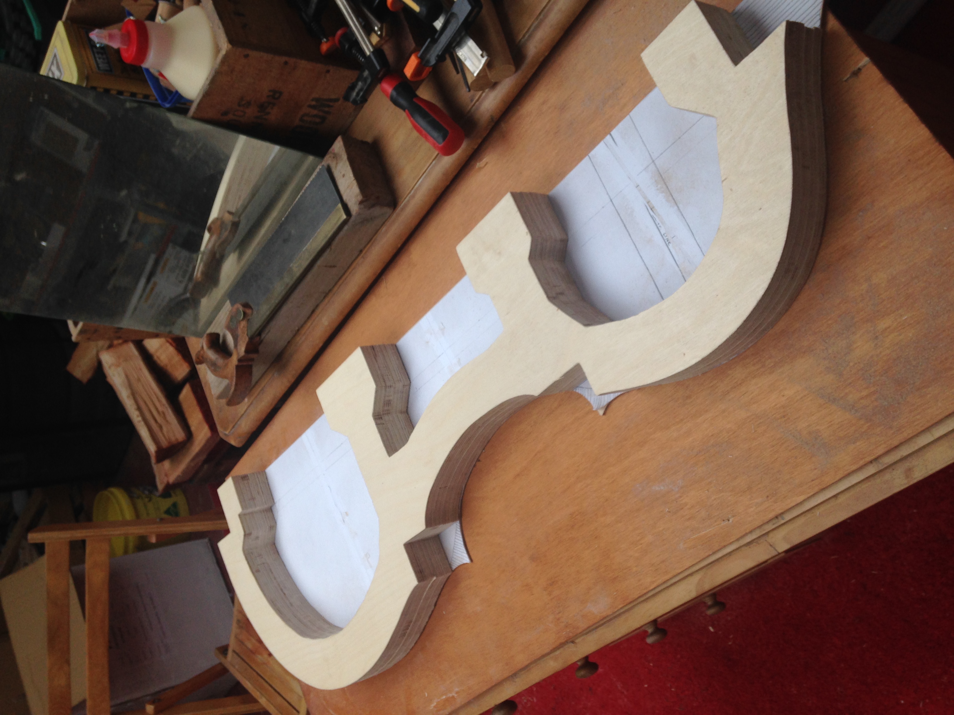

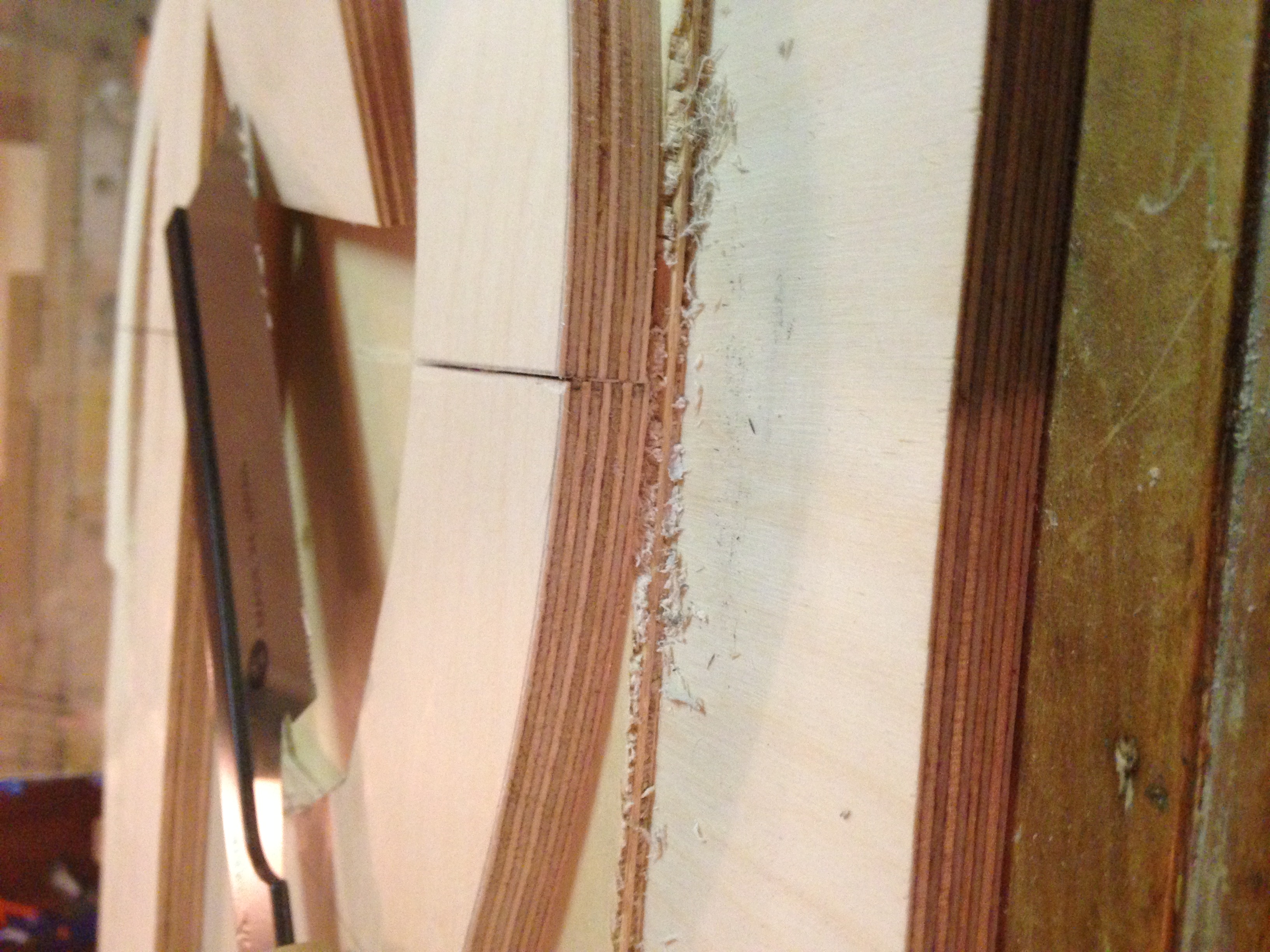

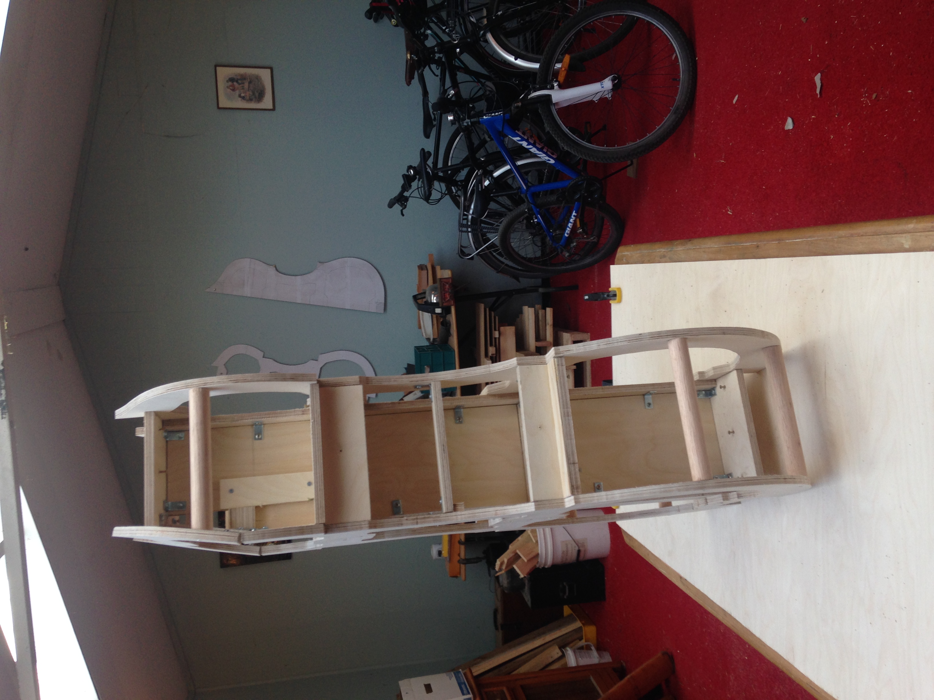

Re: New member new build update - Double bass mold "finished."

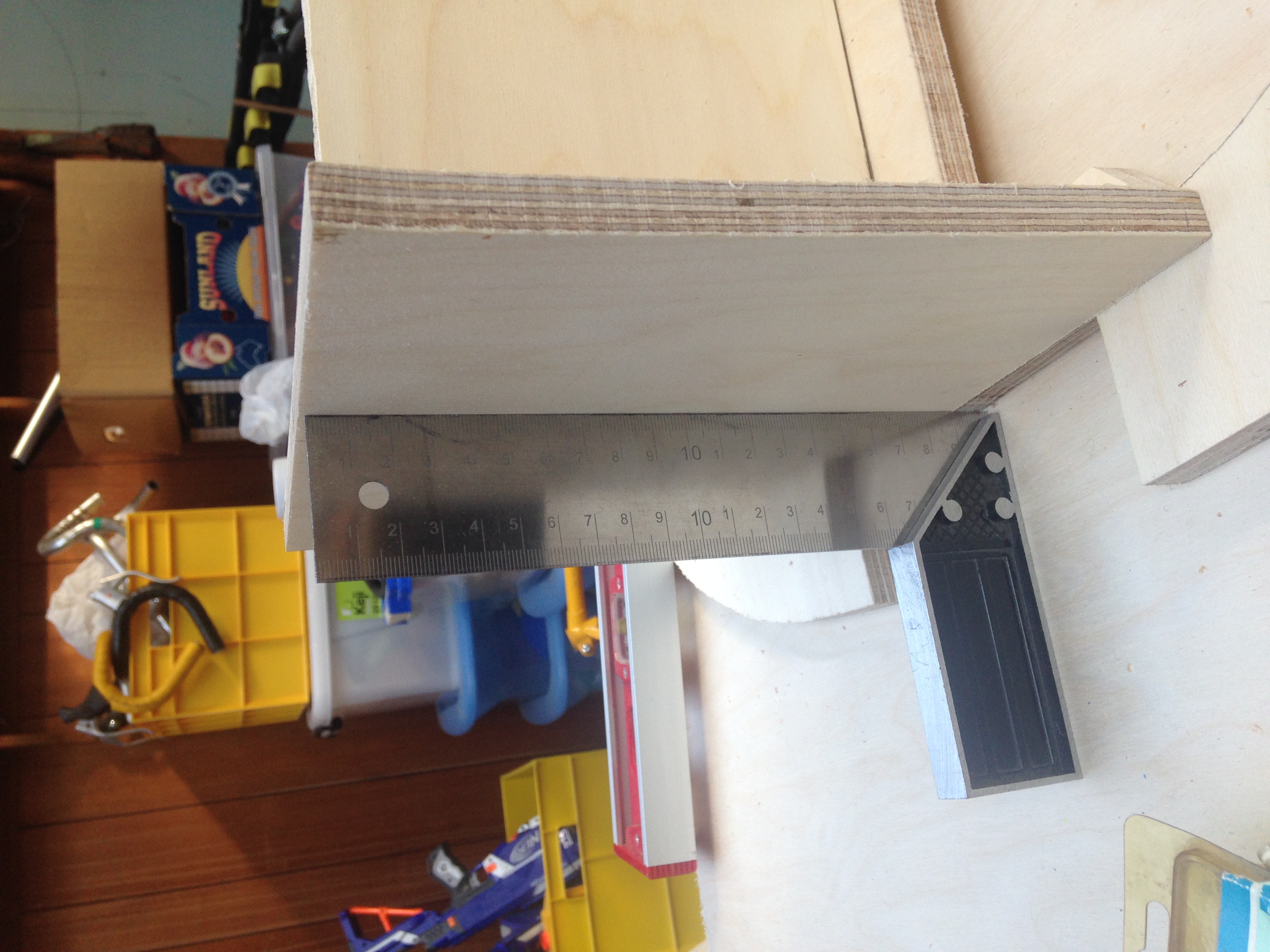

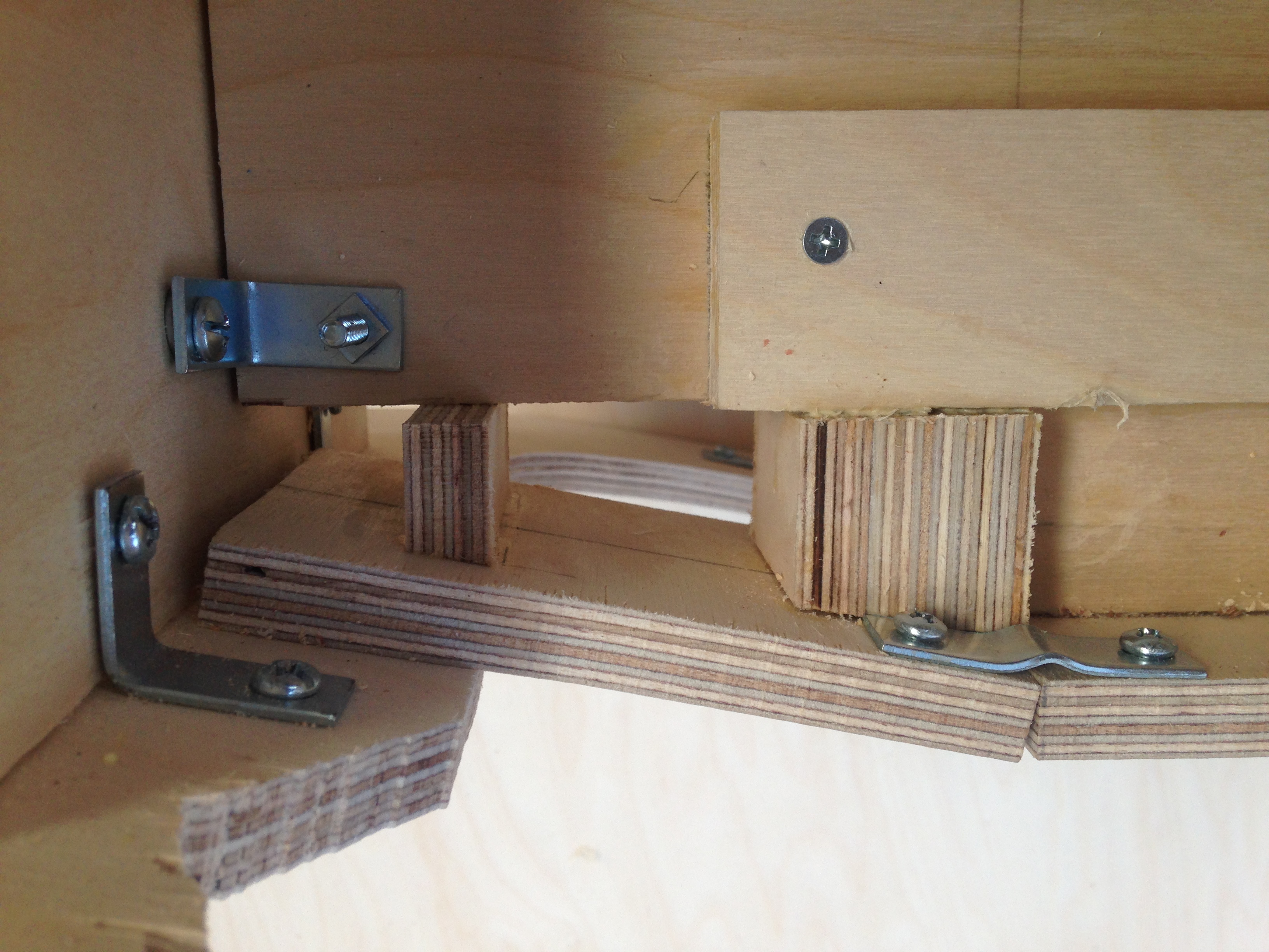

Been busy these past few weeks working on my first double bass mold. Anyway, give or take a few small adjustments, it is "finished."
A bit like making a lute.....nearly as much work in the mold as in the actual instrument. Looking forward to watching this build.

Nice jigs
Mathews Timber in the east not many specialty sellers in Melb ,looks like you have time on your hands so you don't have to be Rushen.
Michael, i'd just whack a neck on it now and string up the mold it looks good enough.

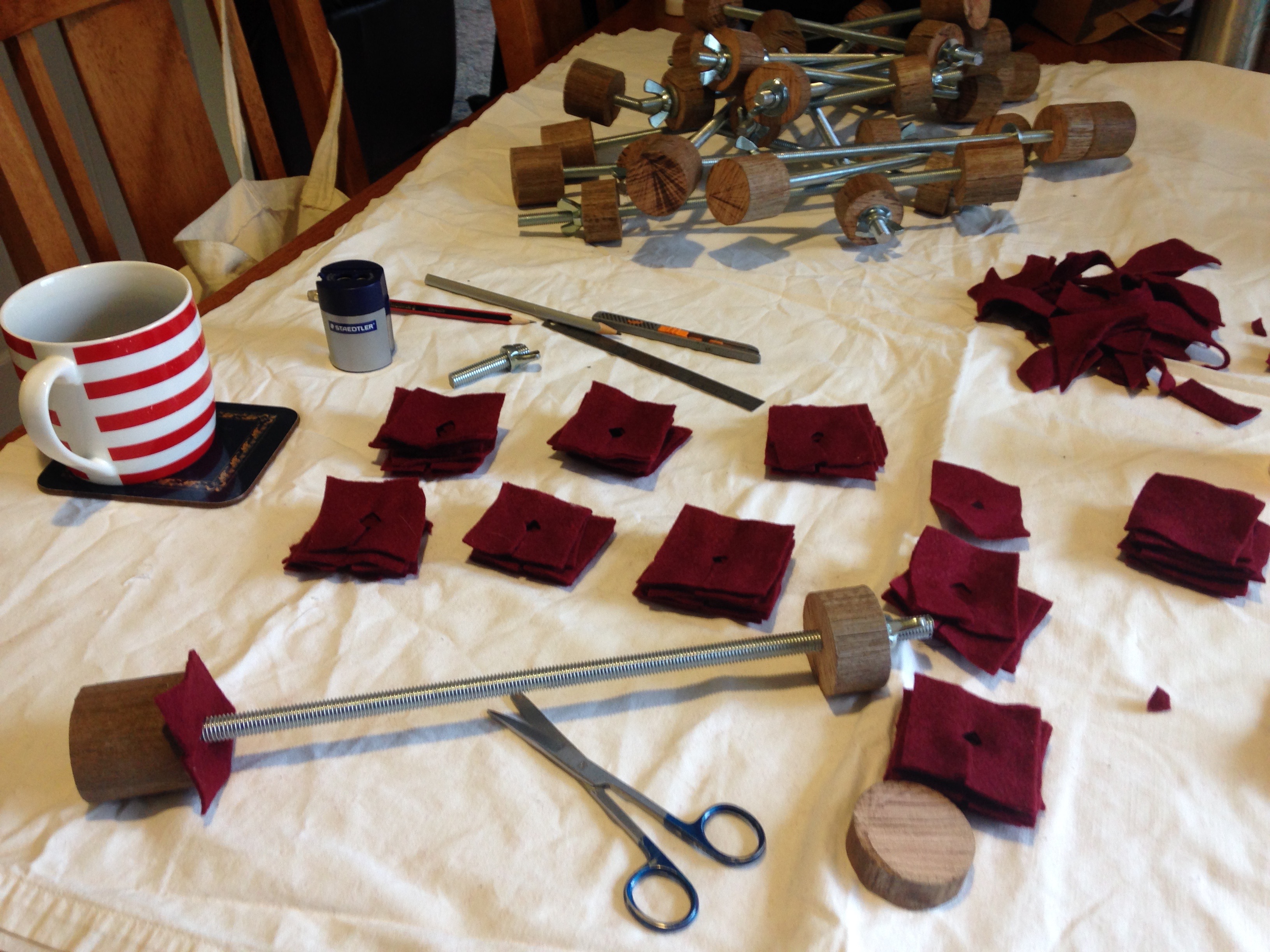

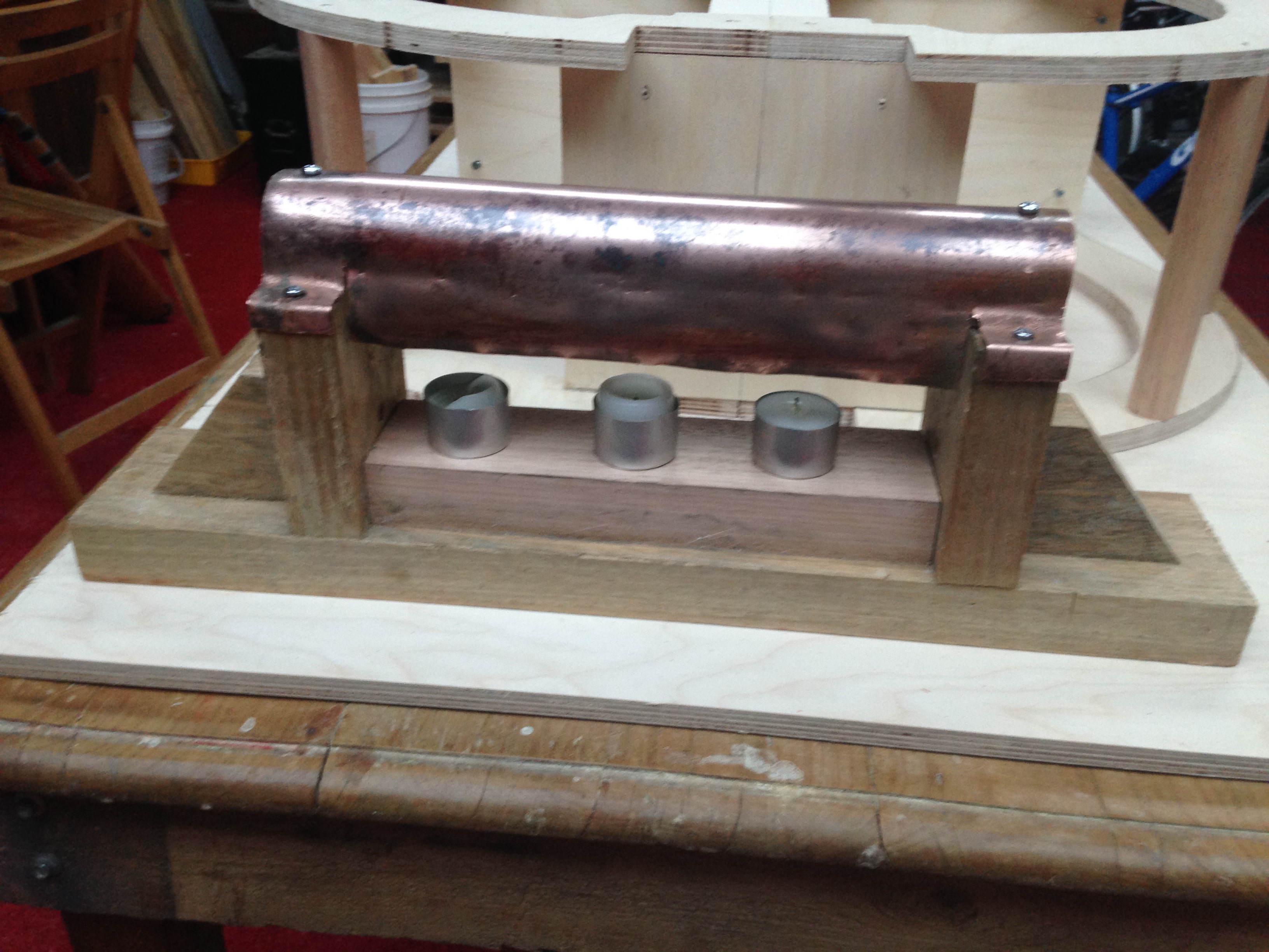

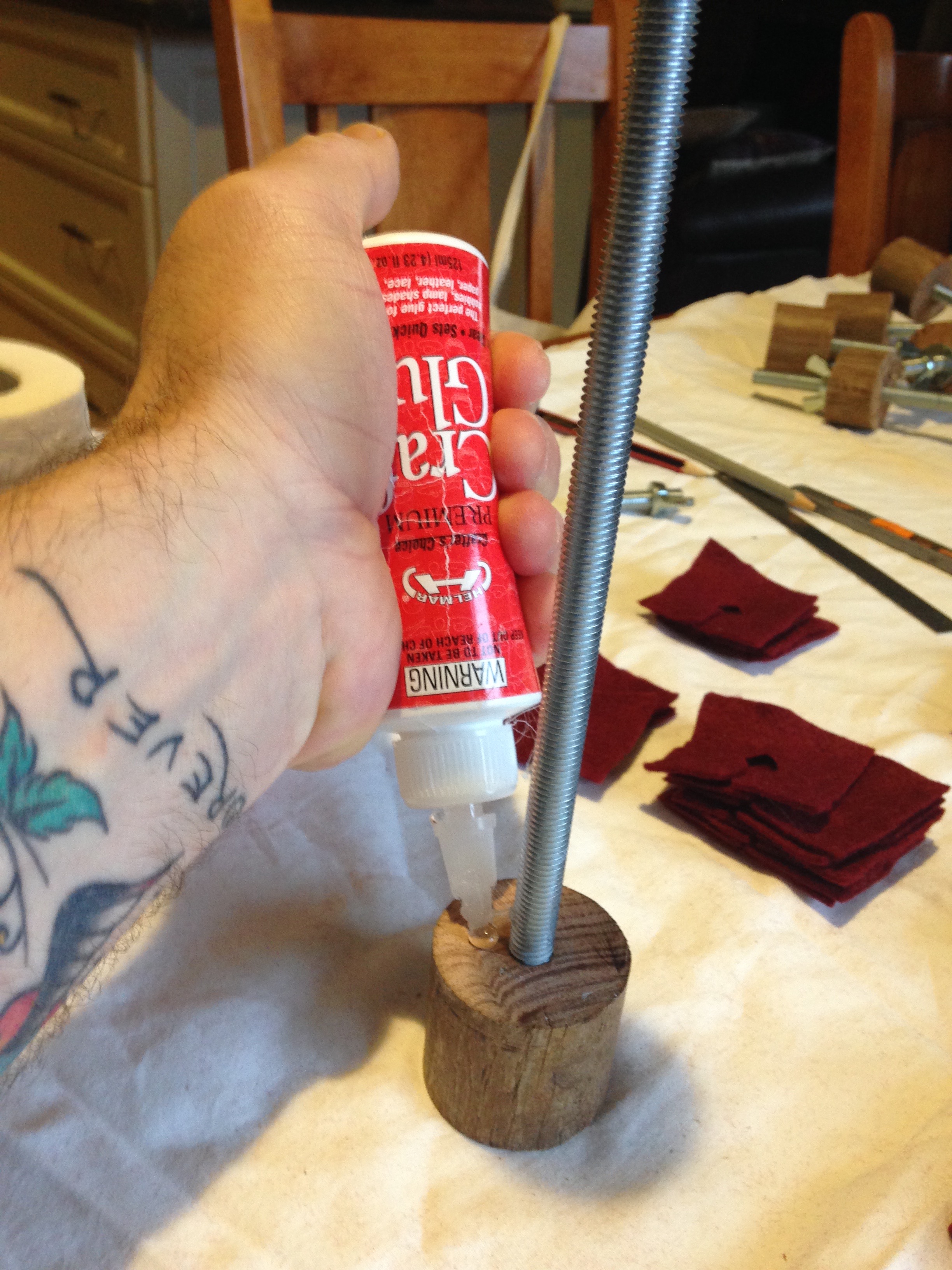

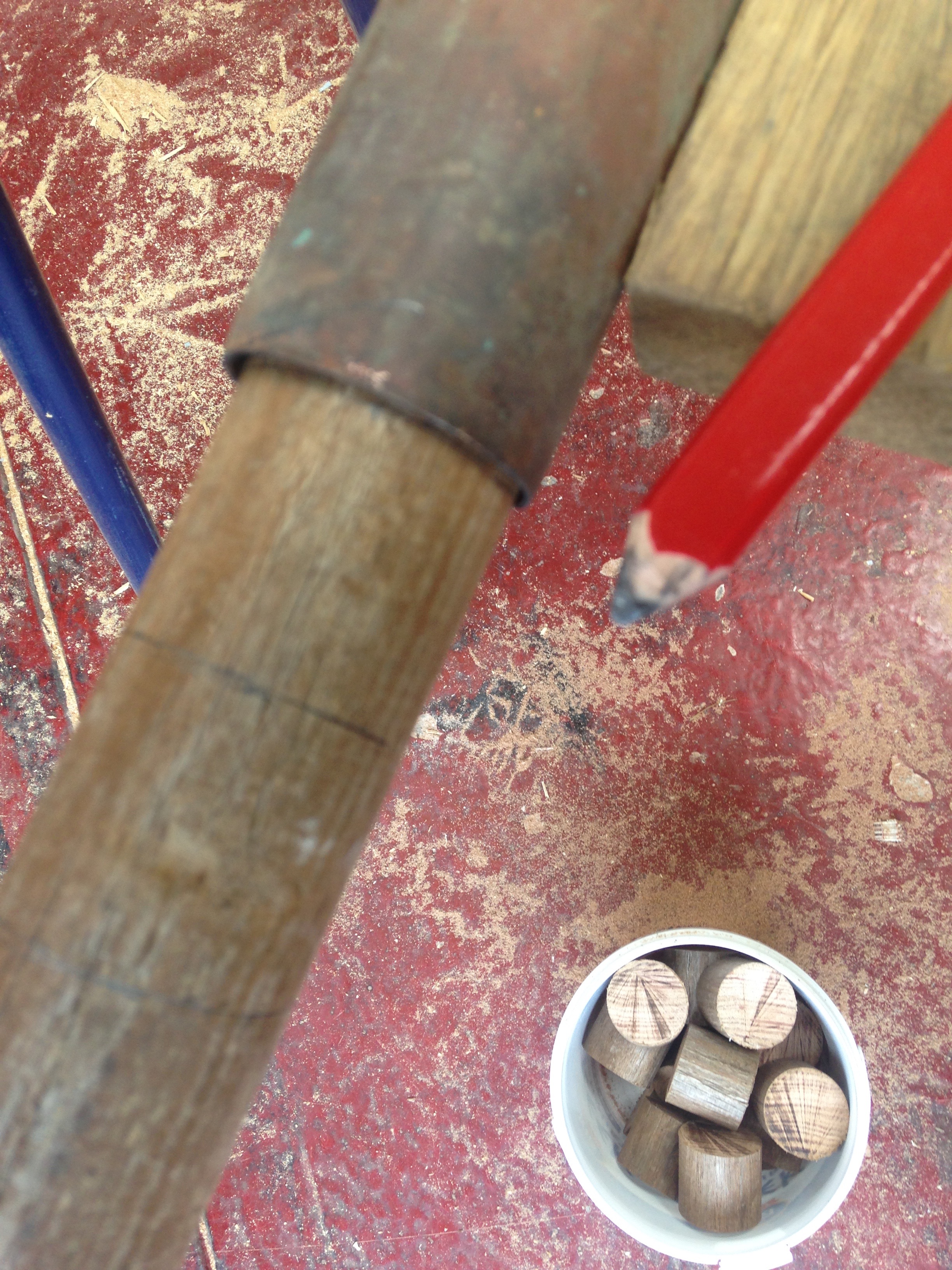

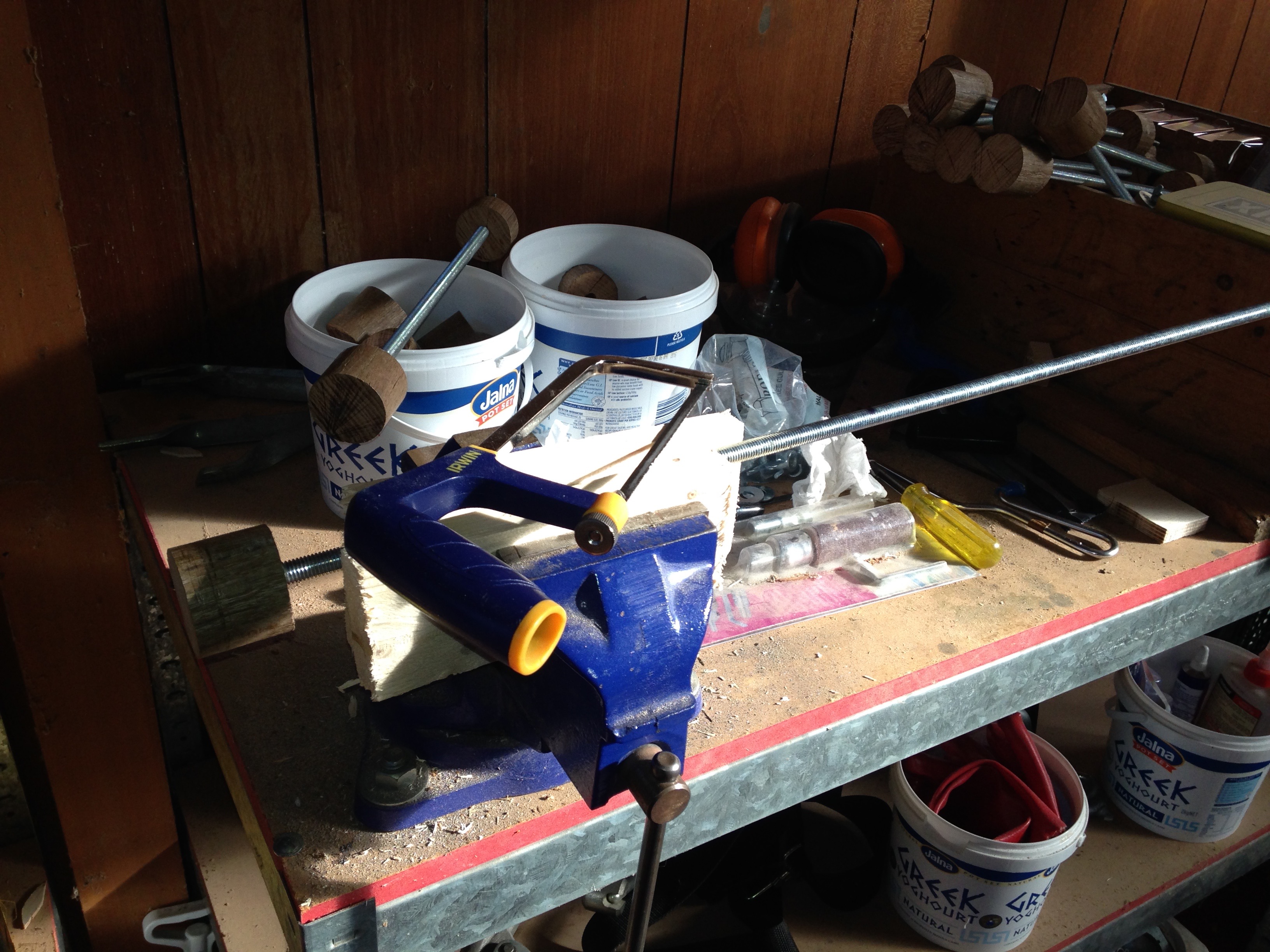

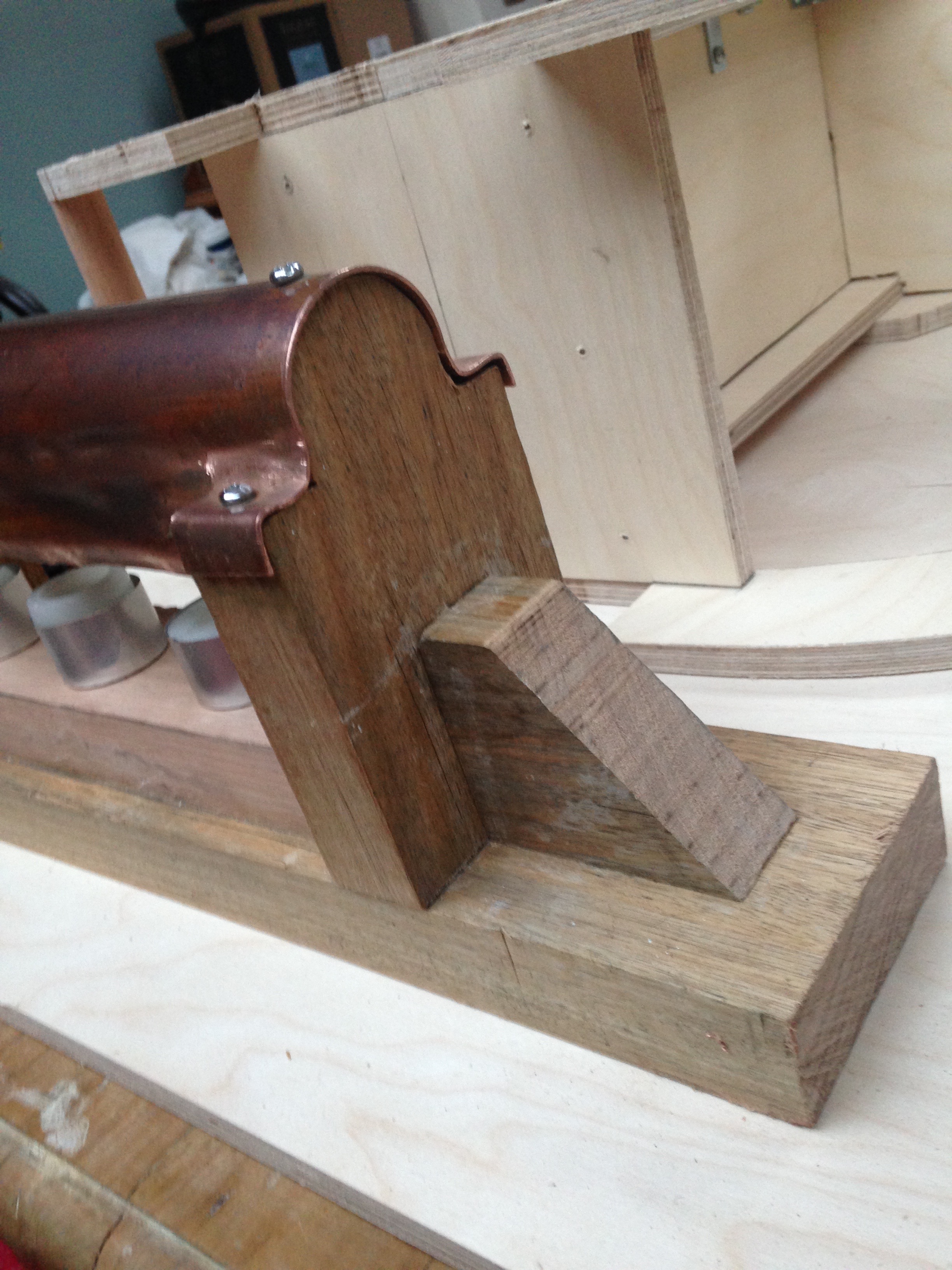

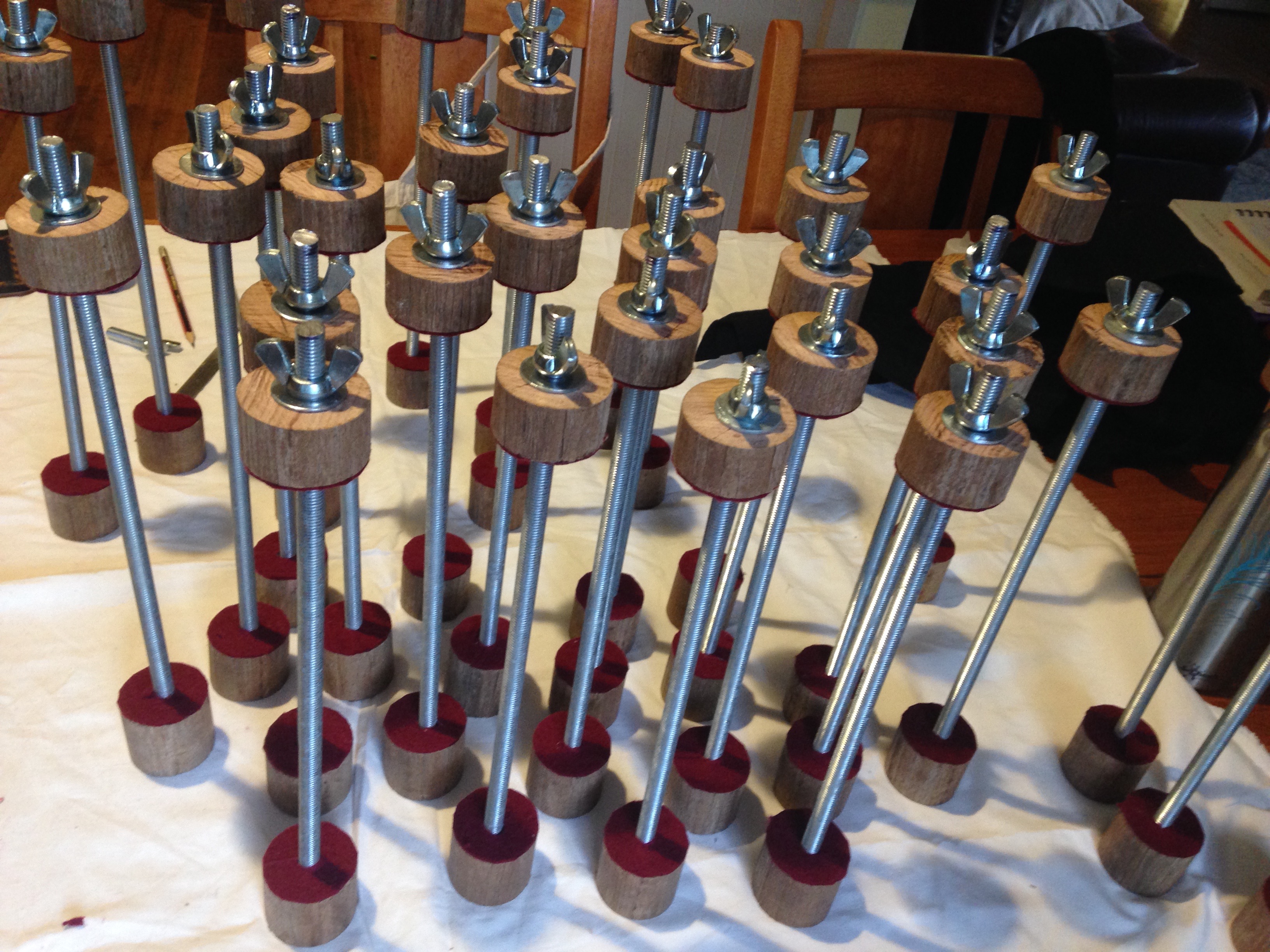

Re: New member new build - clamps and bending iron completed

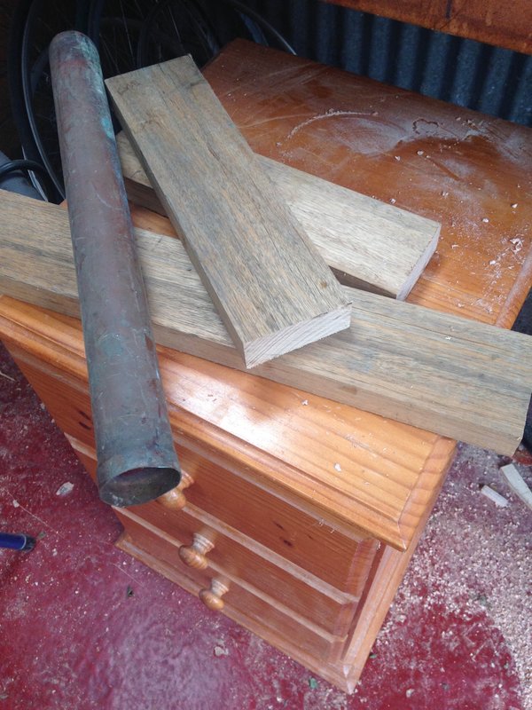

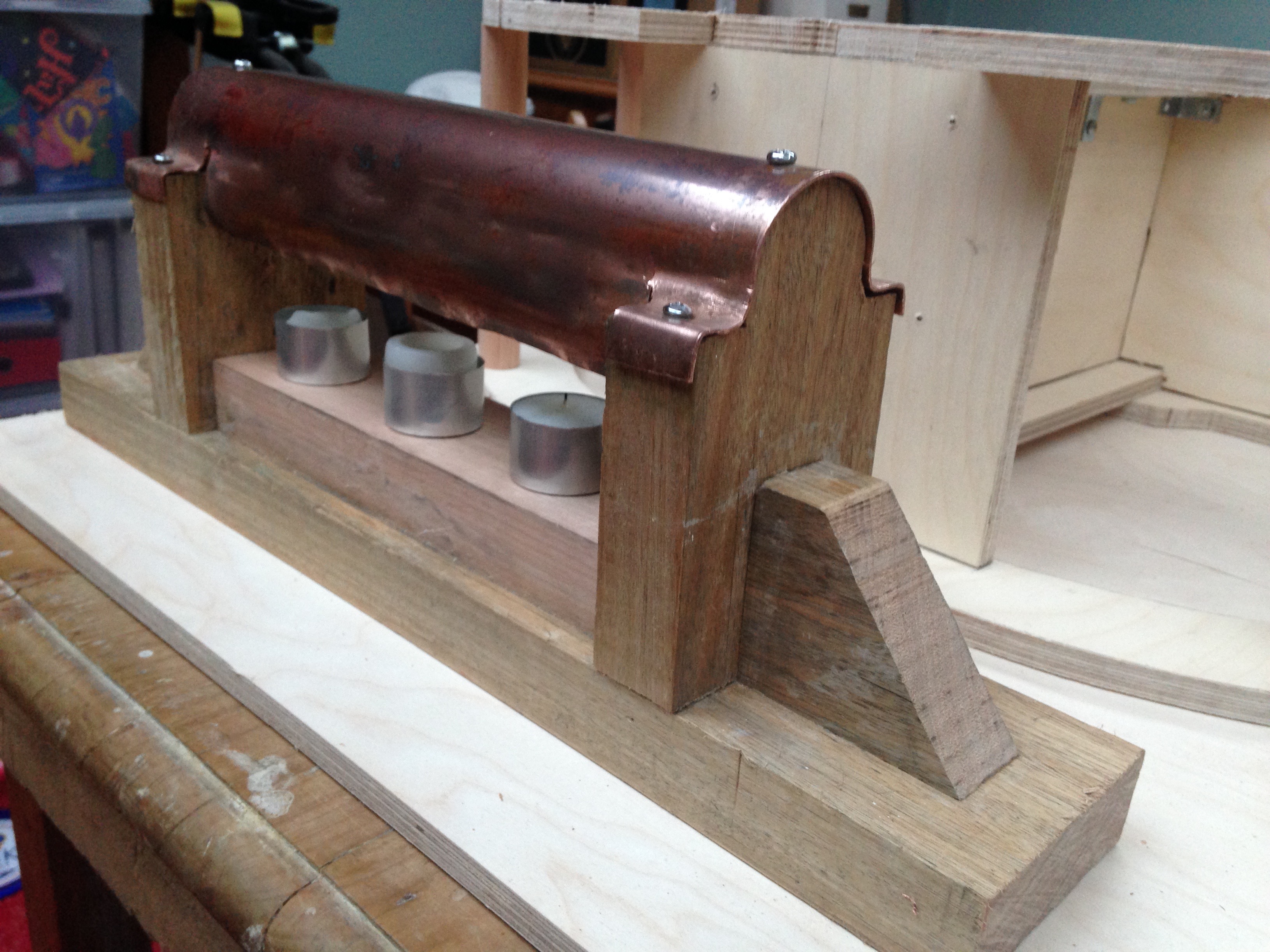

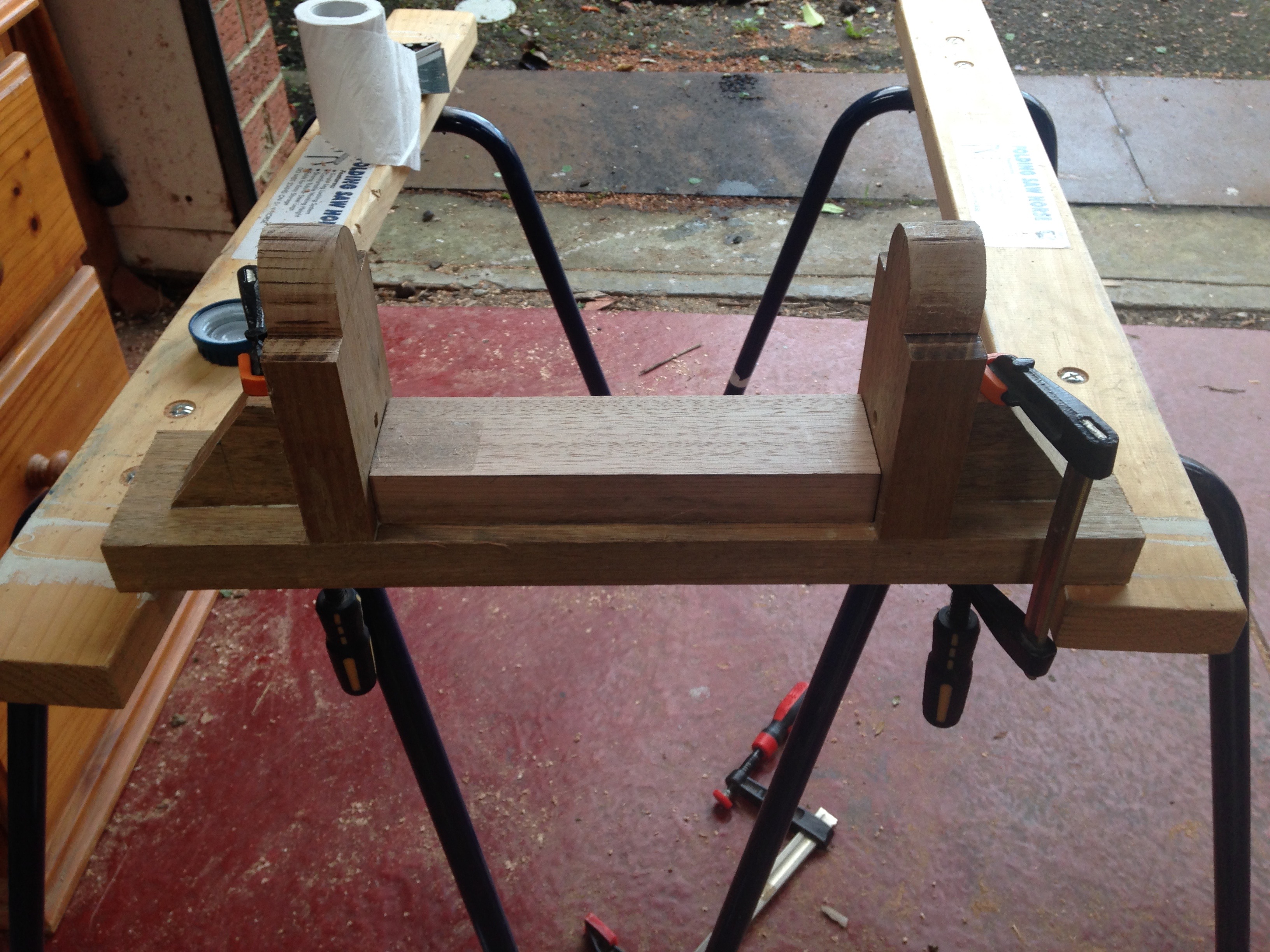

In the past few weeks I've been building clamps and a bending iron from bits and pieces found at the tip shop, steel rod from bunnings, wing nuts and washers from Ferntree Gully Bolts, and stuff I already had. I Bought 3 metres of 45mm dowel form the tip shop for $3 which made most of my clamps. Also a length of copper pipe ($5) and a Tasmanian Oak board ($2) for the bending iron.
The candle powered bending iron is a larger version of one I made a few years ago for bending violin ribs, and which worked brilliantly. I got the idea from a violin making friend of mine, Warren Nolan Fordham. It is probably pretty similar in concept to what the old Bresican makers like Gasparo da Salo and Giovanni Battista Rogeri used. Not counting screws, etc, that I already had, it cost $7 to build.

Mate! Ya got more jigs than an Irish songbook! You may have to up the candlepower to a four burner for thicker larger bass sides!
A better idea would be methylated spirit burners. I have some made with small bottles which have metal screwtops, soldered copper tubes to hold round wicks. The alcohol burns hotter than candles and leaves no carbon residue. My mother used to use them for heating brass wooden handled formers when making artificial silk flowers the traditional way. If you need something stronger still on the cheap, Chinese heating elements and a Chinese PID controller on eBay. I made my own bending iron with a wooden shape which was then used to sand cast aluminium. I drilled 10mm holes in it to install the ceramic elements. I have also made one with stainless steel tube, scrounged of course, and melted aluminium then poured it into the tube. !0mm holes and elements after that. I have even seen a similar thing with two soldering irons pushed into either end of the tube. The aluminuim conducts the heat. You could even try soldering irons and copper pipe. The old Spanish, Mexican and South American luthiers bent sides on a pot belly flue. The further up the flue the cooler the pipe, so the bending heat sweet spot can be found. I look forward to your posts. Make sure you tell us if the candle powered bender works effectively or not.
I have met both Warren (who probably has more tatts than you!) and his mentor Kevin Williams. Williams was an apprentice with a famous English violinmaker who lived in Sydney and used Australian timbers, one of the first to do so. His violas are legendary and fetch high prices.
Cheers!Ross
Cheers!Ross

Thanks for the idea on spirit lamps, Ross. I'll look into that.
It also got me thinking about the small spirit stoves that camping stores sell.
Also, I have a huge electric soldering iron that once belonged to my wife's grandfather and came to me - as many things do - because no-one else wanted it. It could be a candidate for a future bending iron build!
Warren is very much a mentor of mine and I am lucky enough (thanks to my lovely wife) to own one of his magnificent violins. I have the 'f' holes of my violin tattooed on my forearms. Warren does indeed have more tatts than me - and we spent plenty of time talking about tattoos - although I was catching up on him until recently, when he got more done.
A few years ago, when I wasn't working and he was at WORCO in Thornbury, and after I'd completed my first violin build, Warren invited me to spend some time with him learning some of the better ways of doing things in violin making. He was very generous and lent me books, etc, and gave me a lot of ideas. He was helping me build a violin until I got a full time job back in education and had to put it aside. I'll get back to it once I complete this double bass!
Warren talked to me about Kevin and I'd love to meet him one day. It was Warren who inspired my interest in Australian timbers.

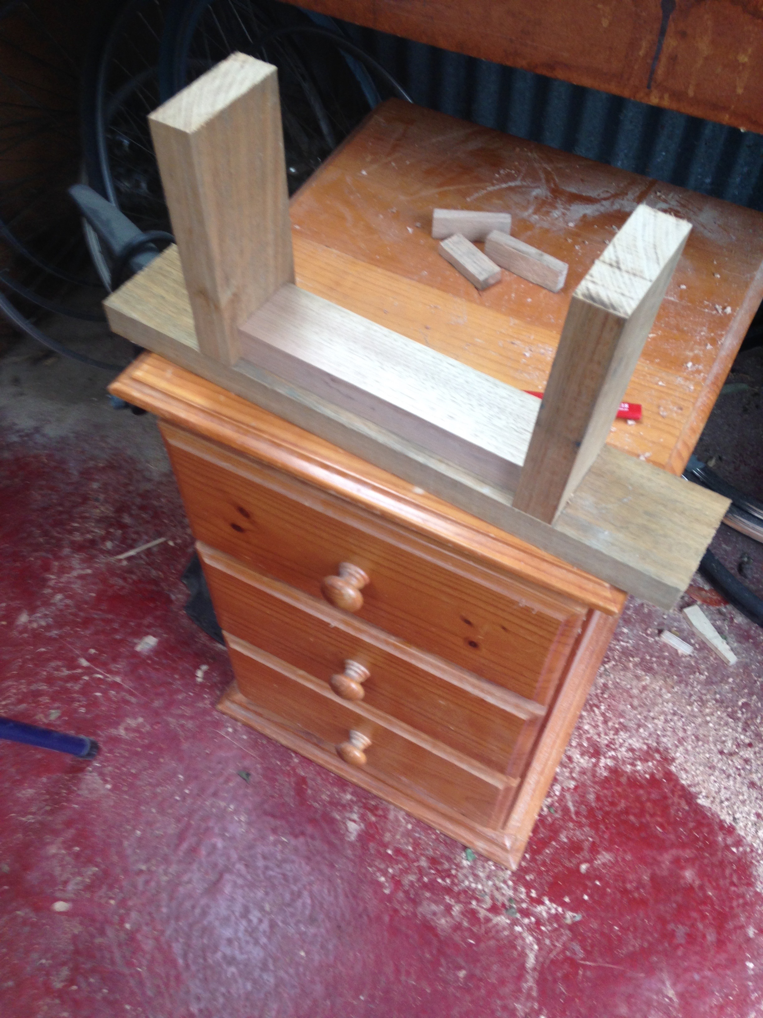

The next step is to make a start on carving the neck and scroll. I have a board of Queensland Maple which I'm thinking of laminating together to get the right width. I might even put a 3mm veneer of blackwood through the middle. Should I use hide glue or Titebond for this? If hide glue, then I may wait until the weather (and the shed) is a bit warmer.
Cheers, Michael
Cheers, Michael

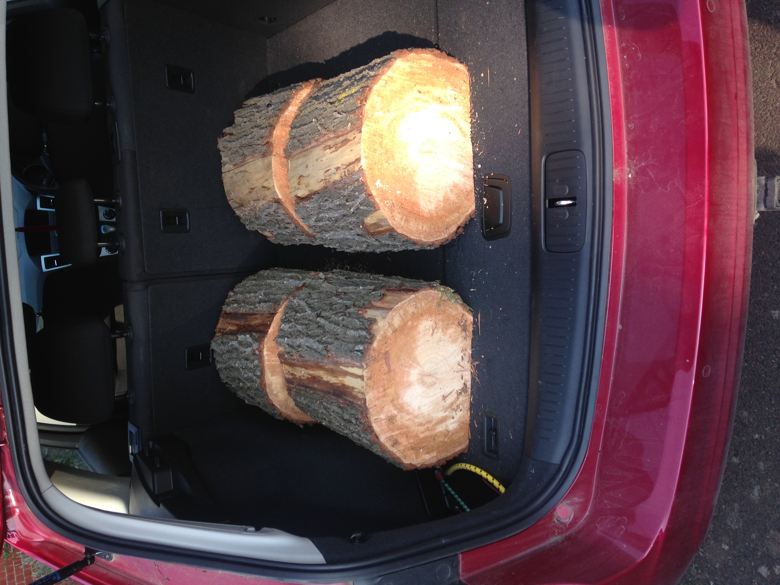

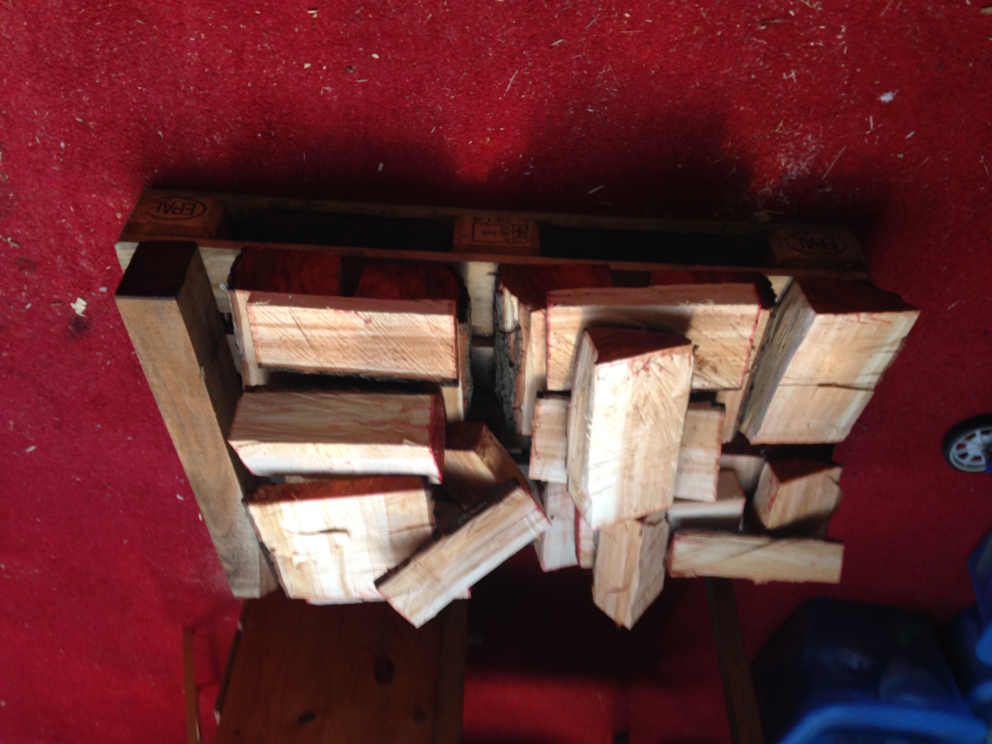

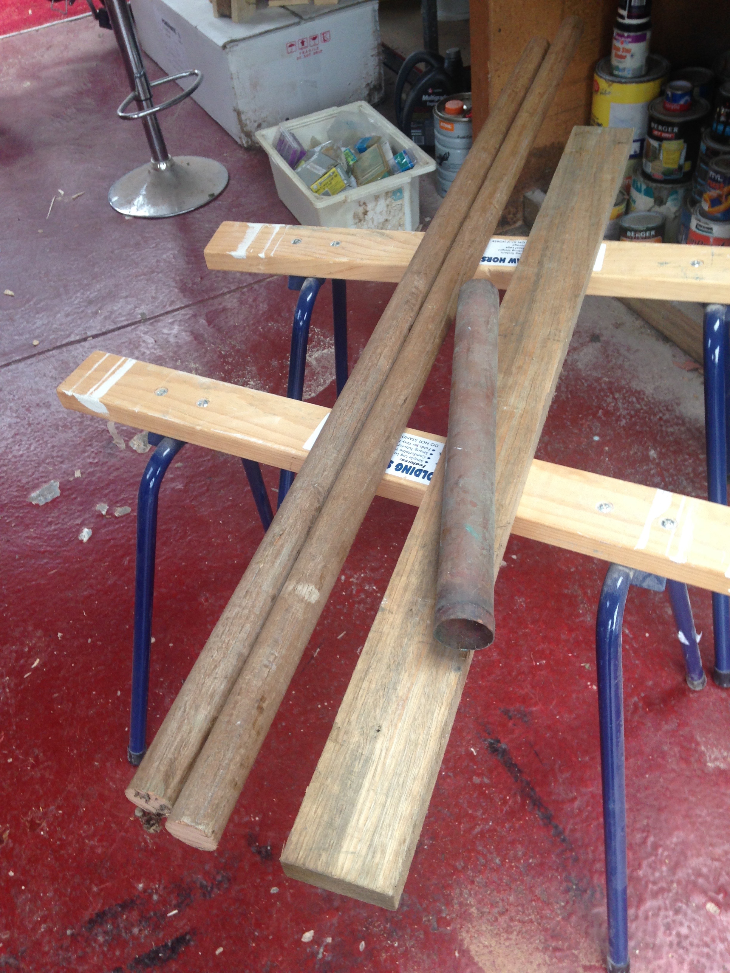

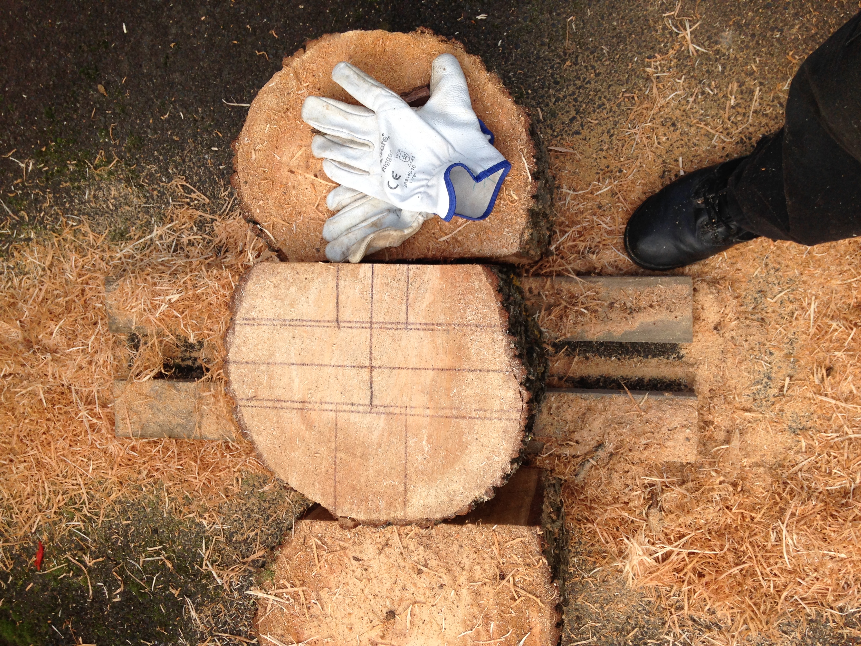

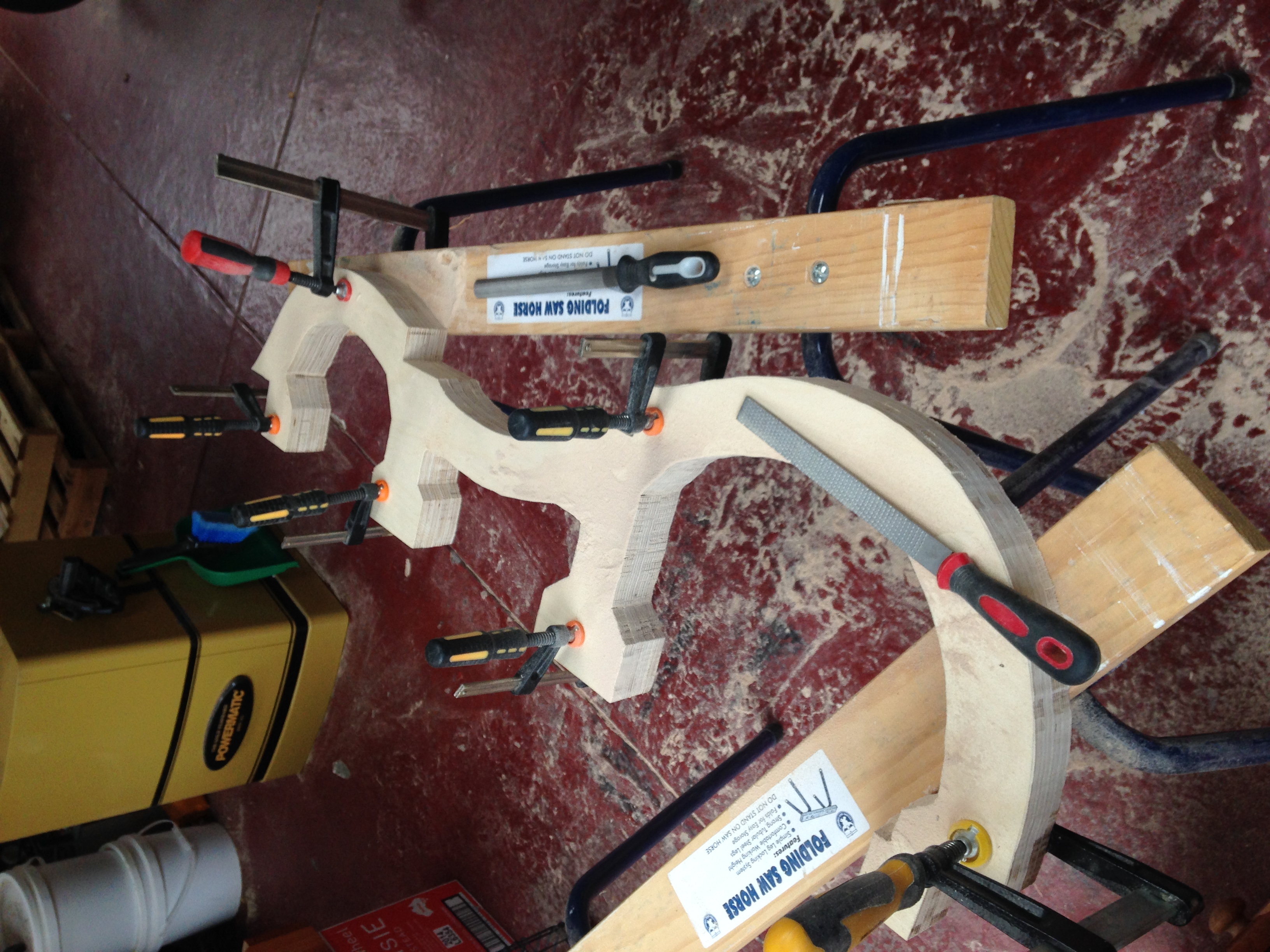

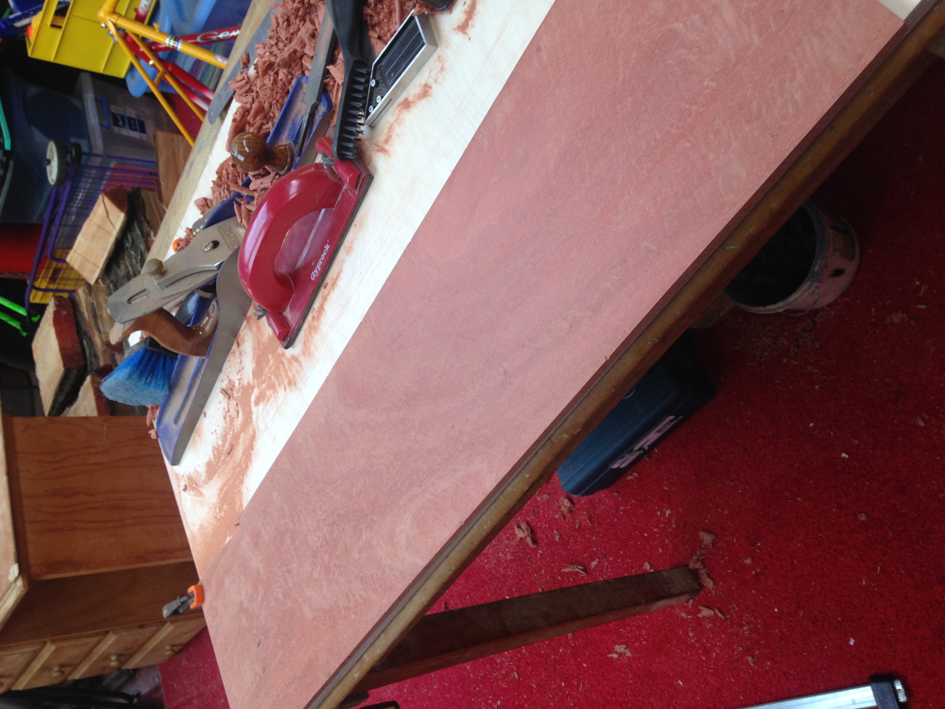

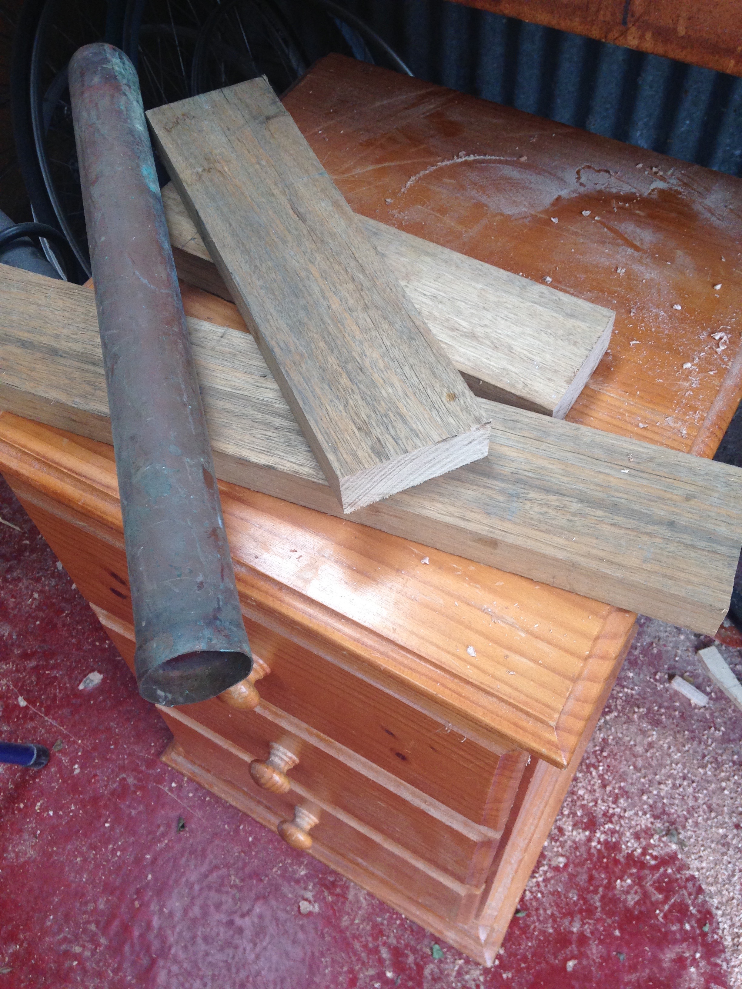

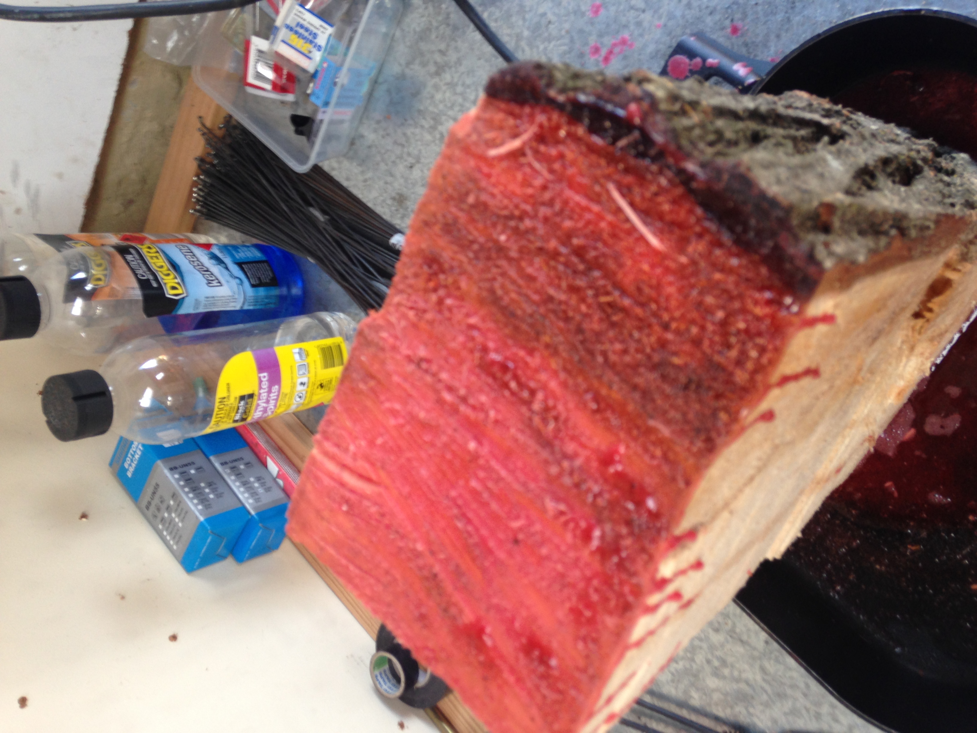

Nothing like dressing a nice bit of redgum to get some morning exercise!

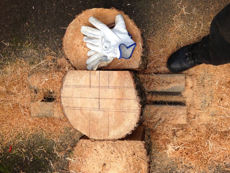

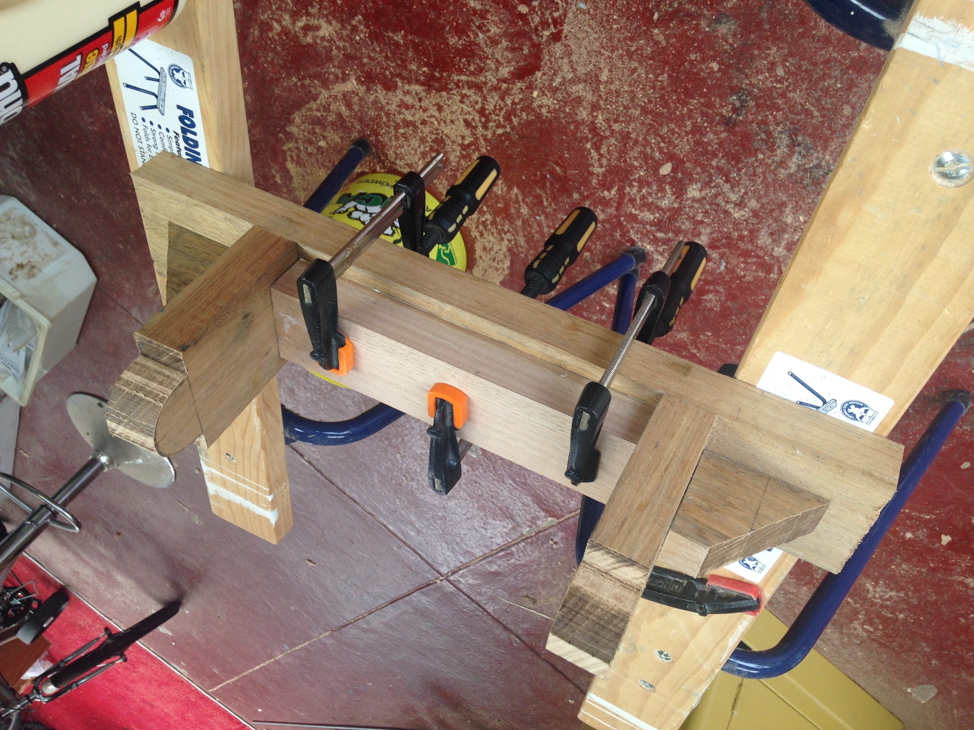

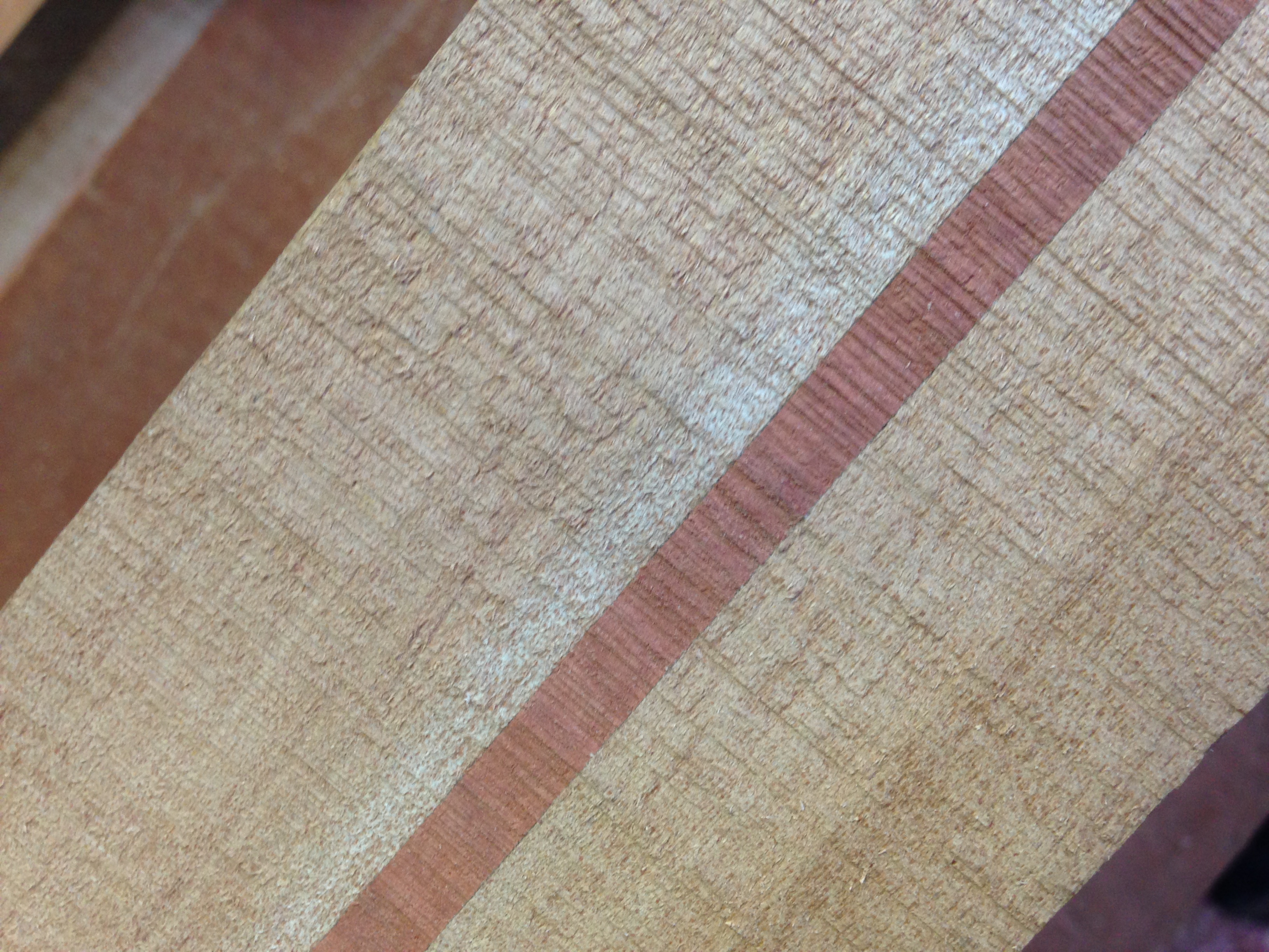

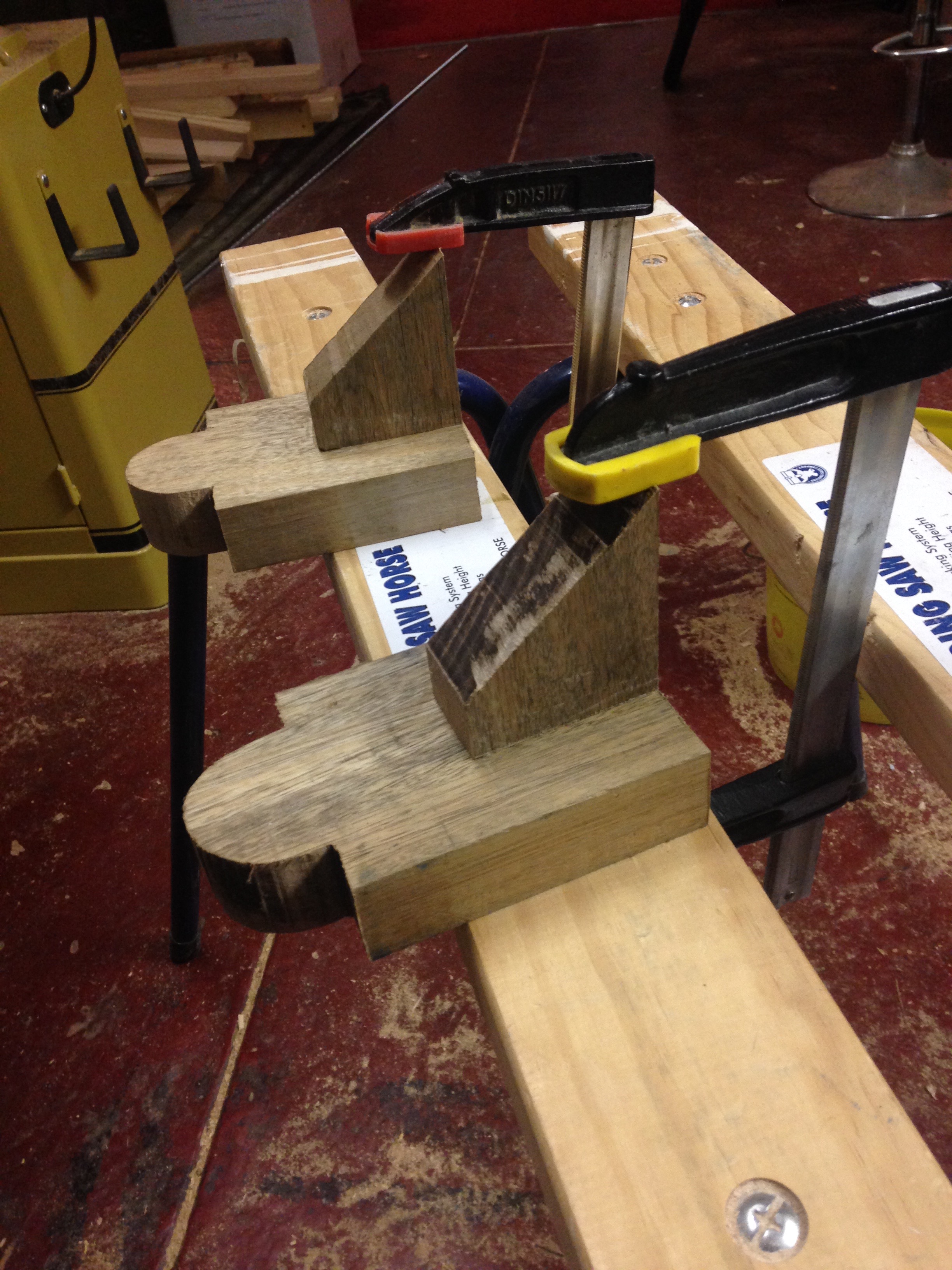

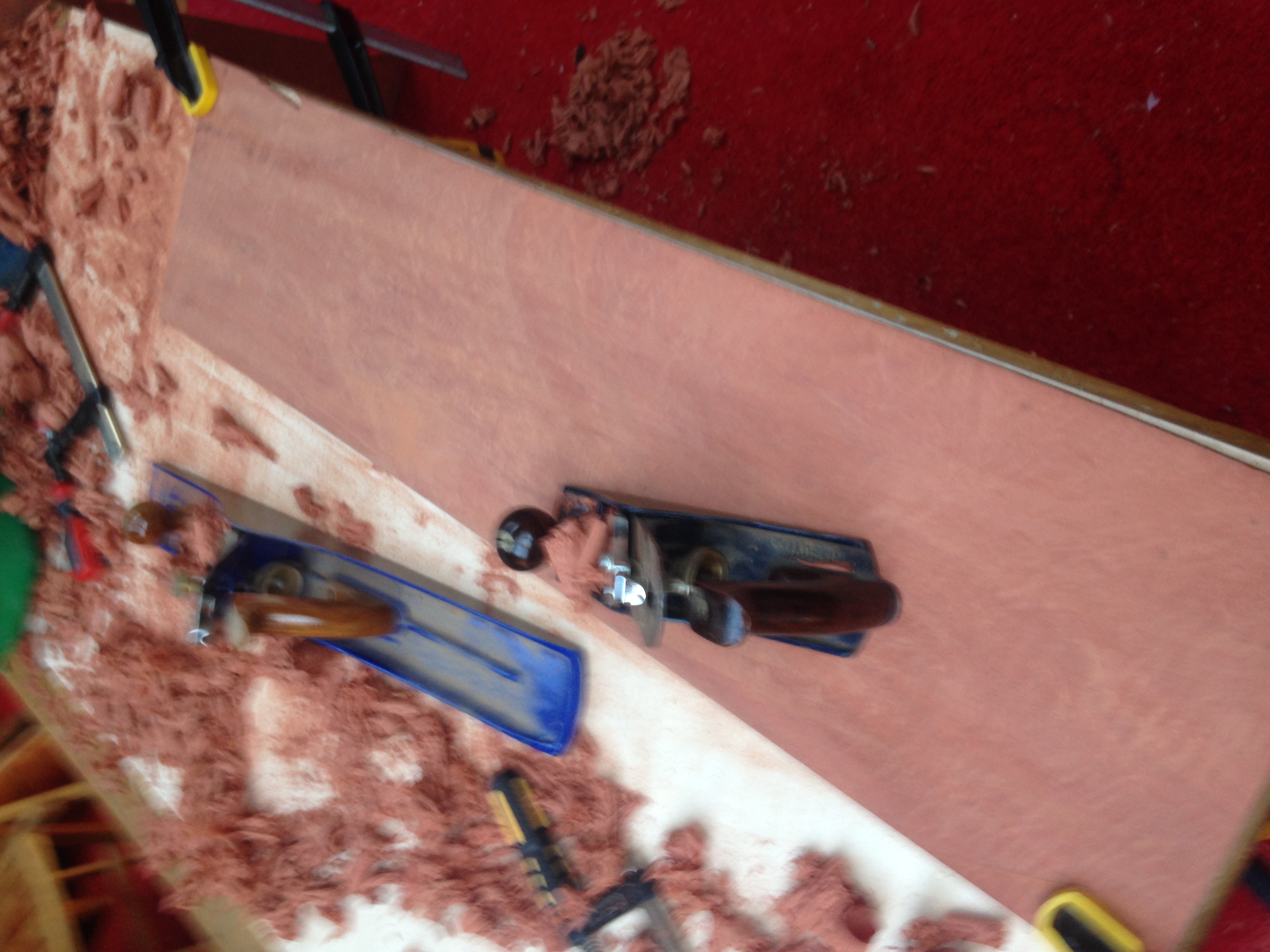

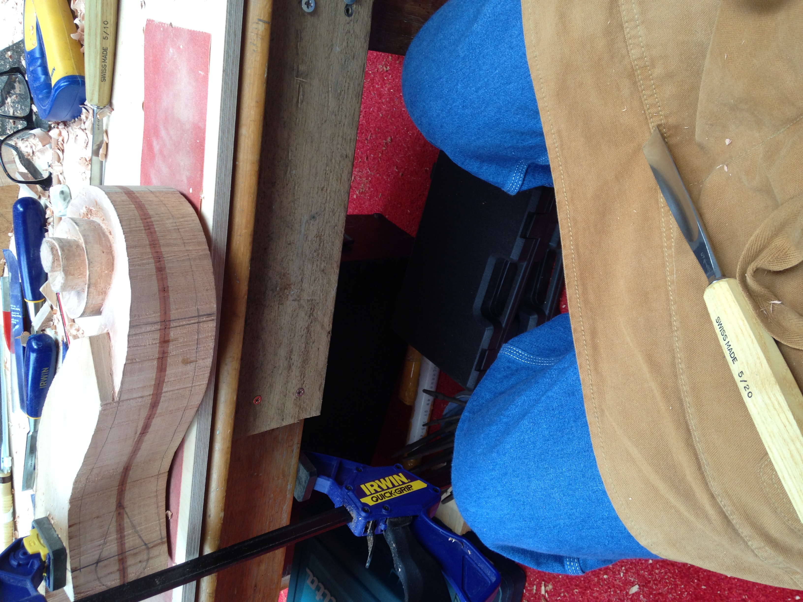

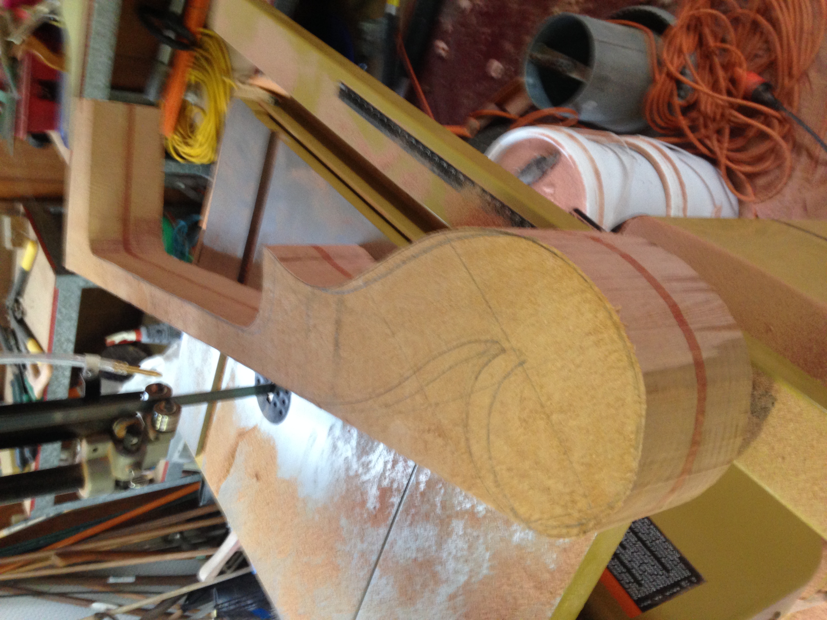

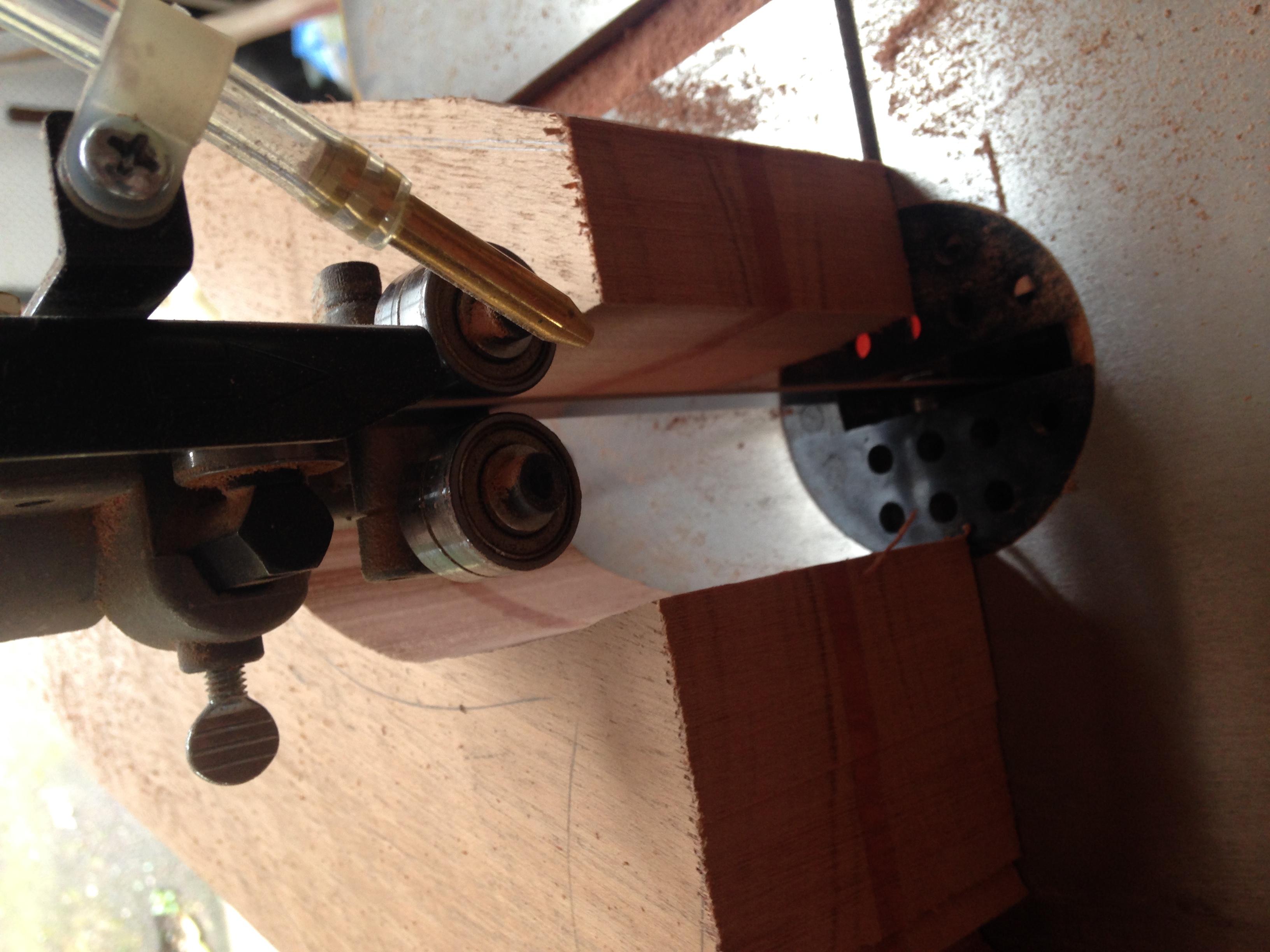

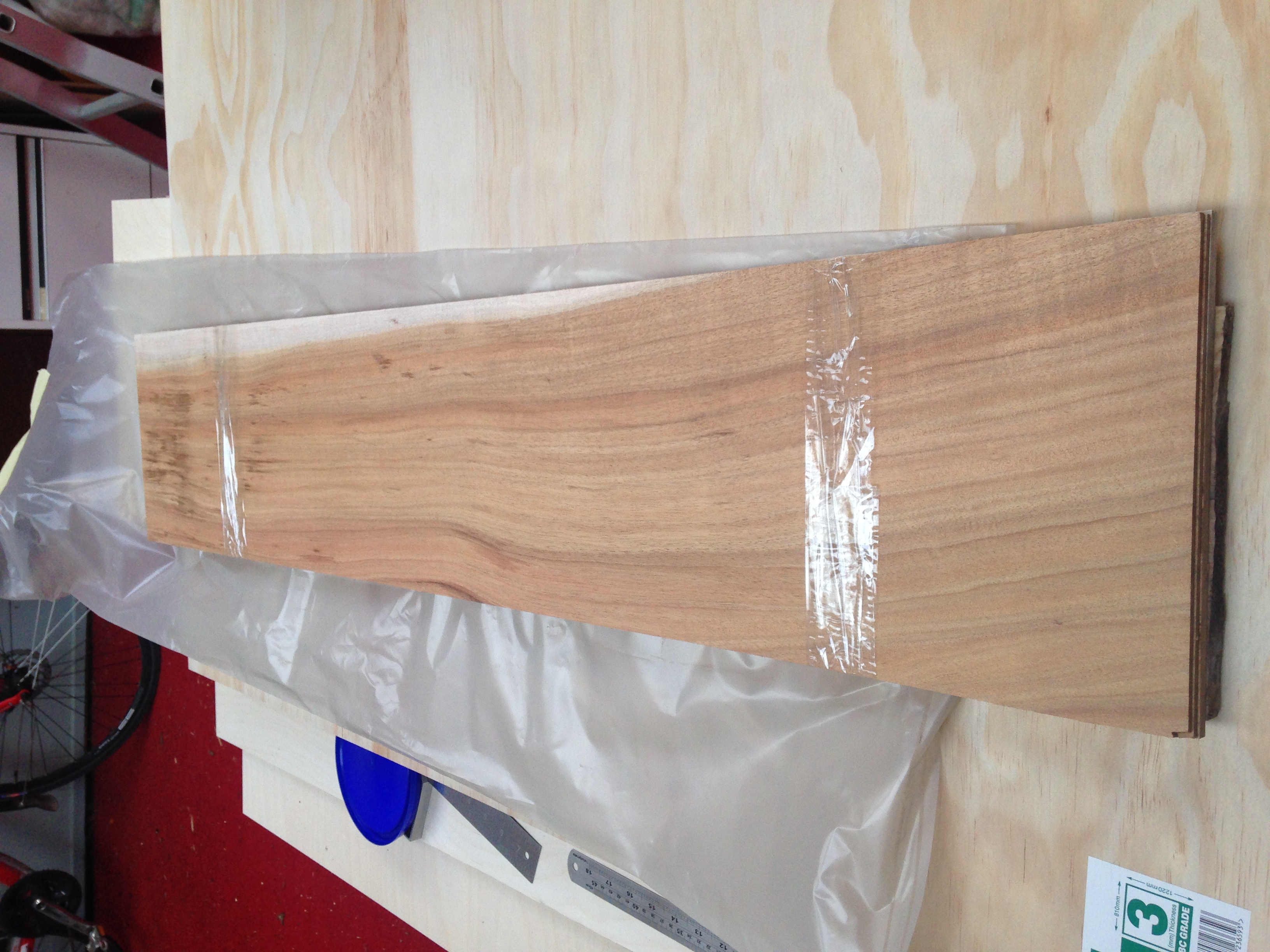

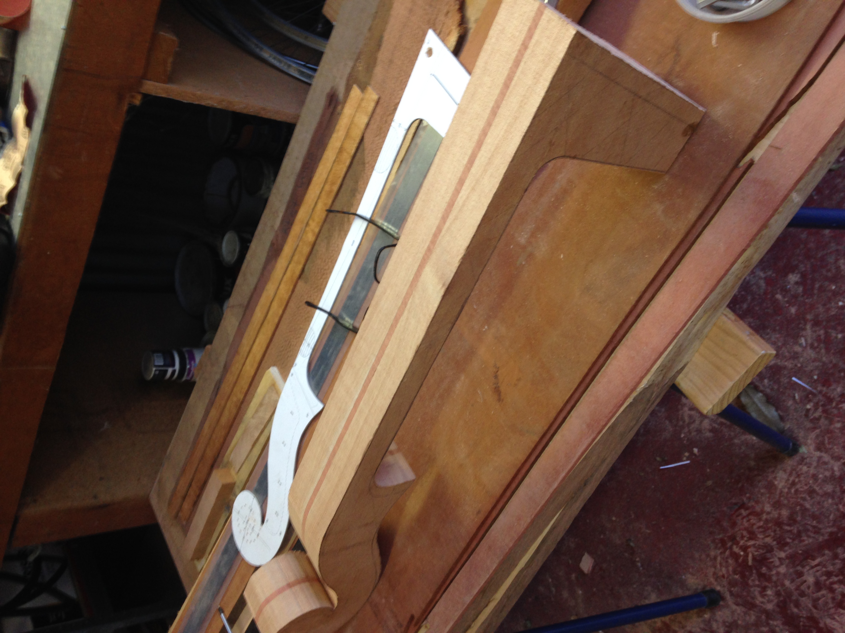

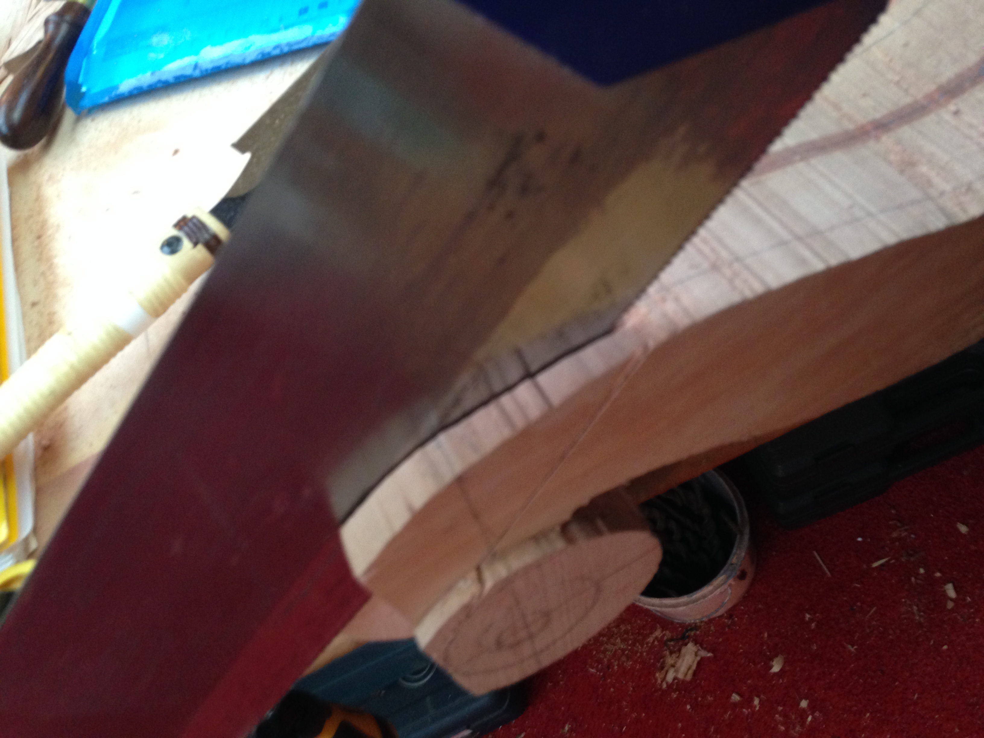

Had a bit of shed time this arvo. Cut a neck blank from the Queensland Maple boards I laminated with a redgum centre board during the week. The join turned out olay for a first effort. Room for improvement, but so far so good.

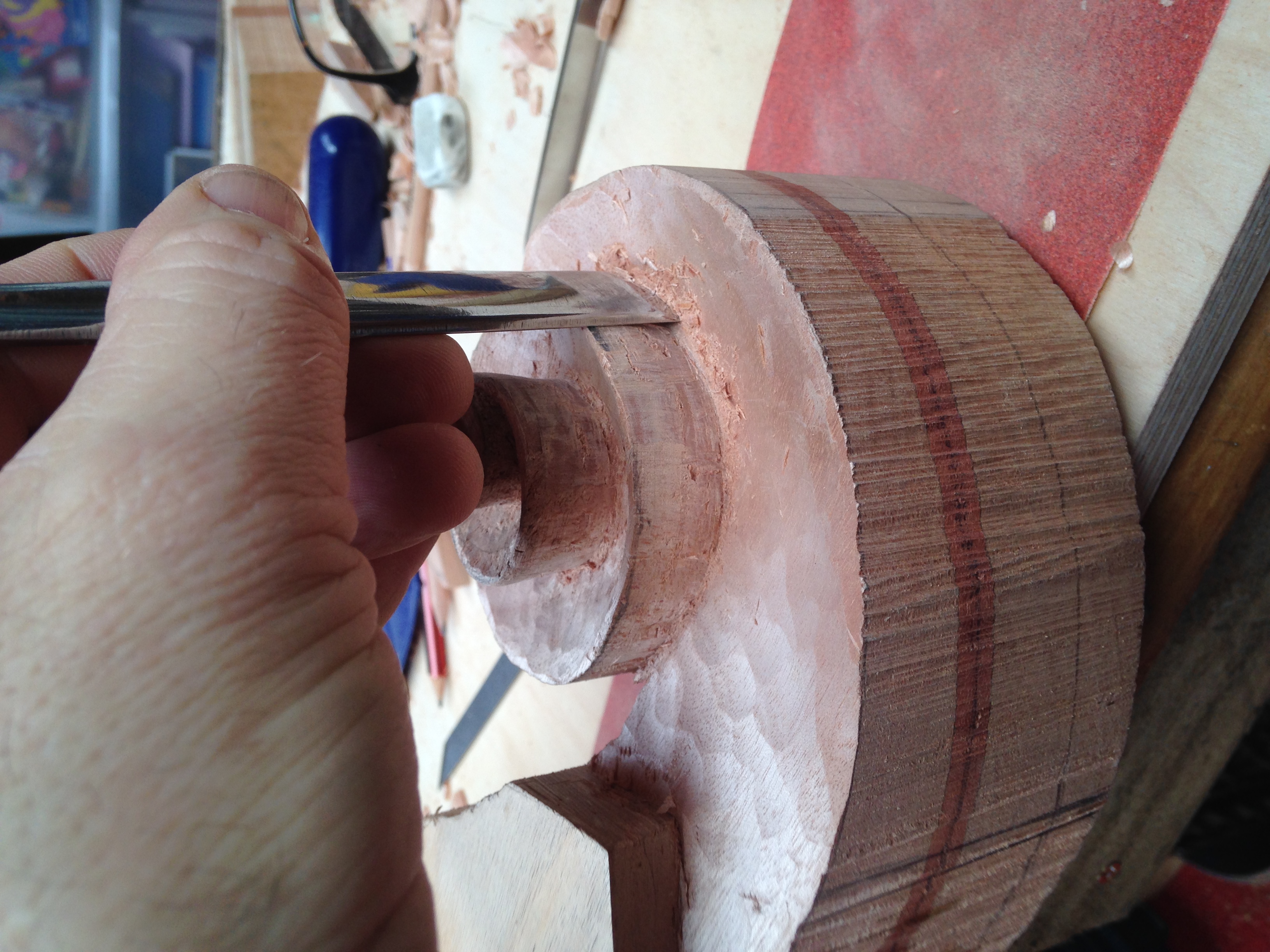

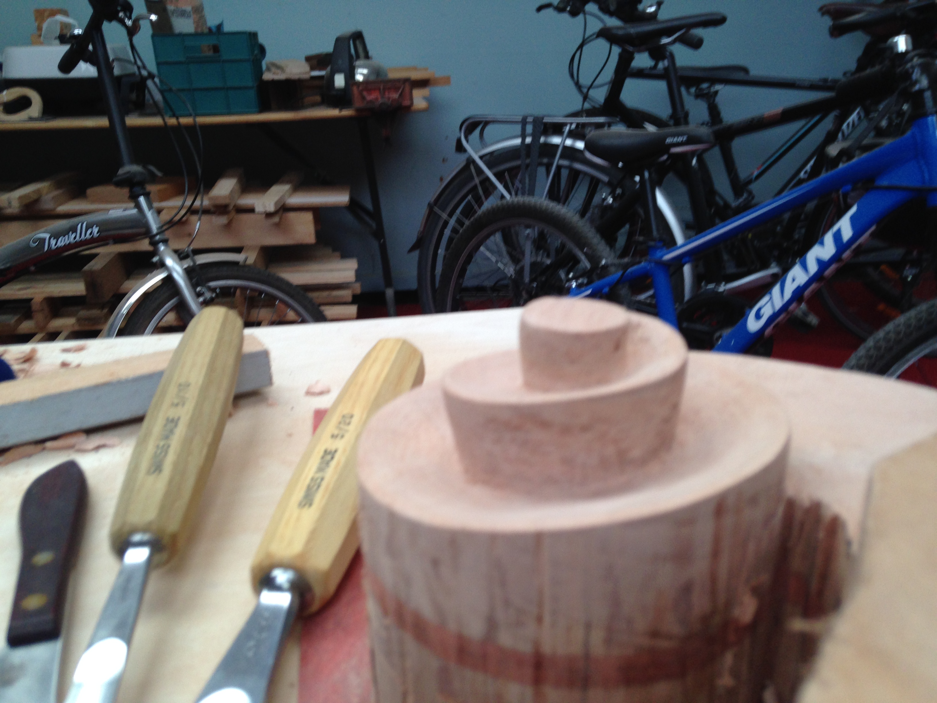

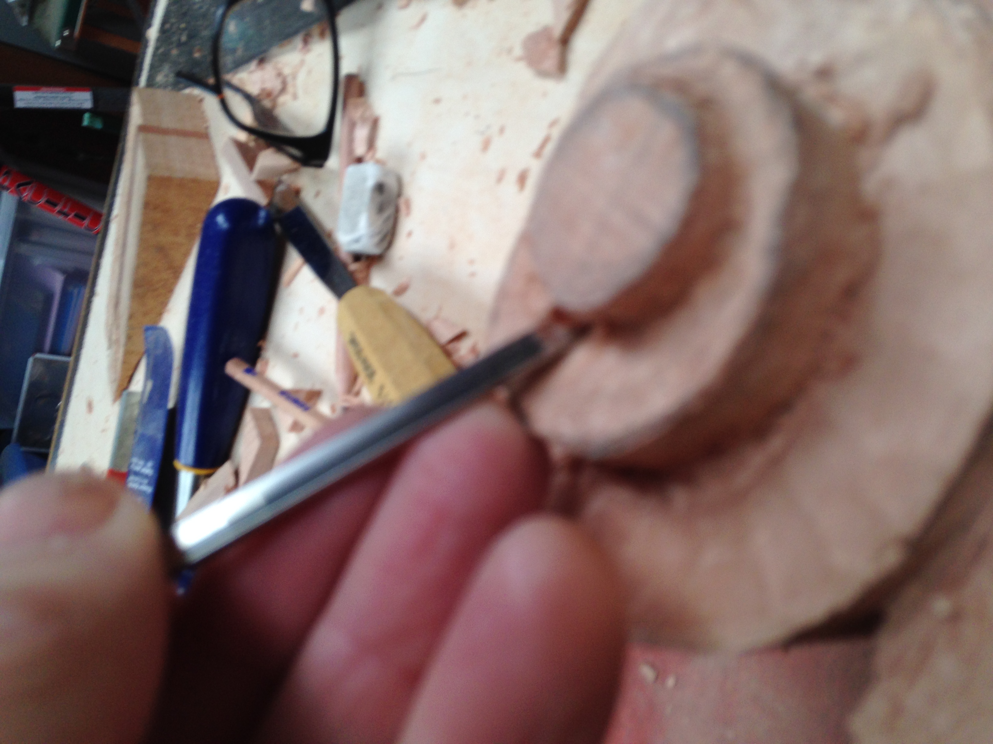

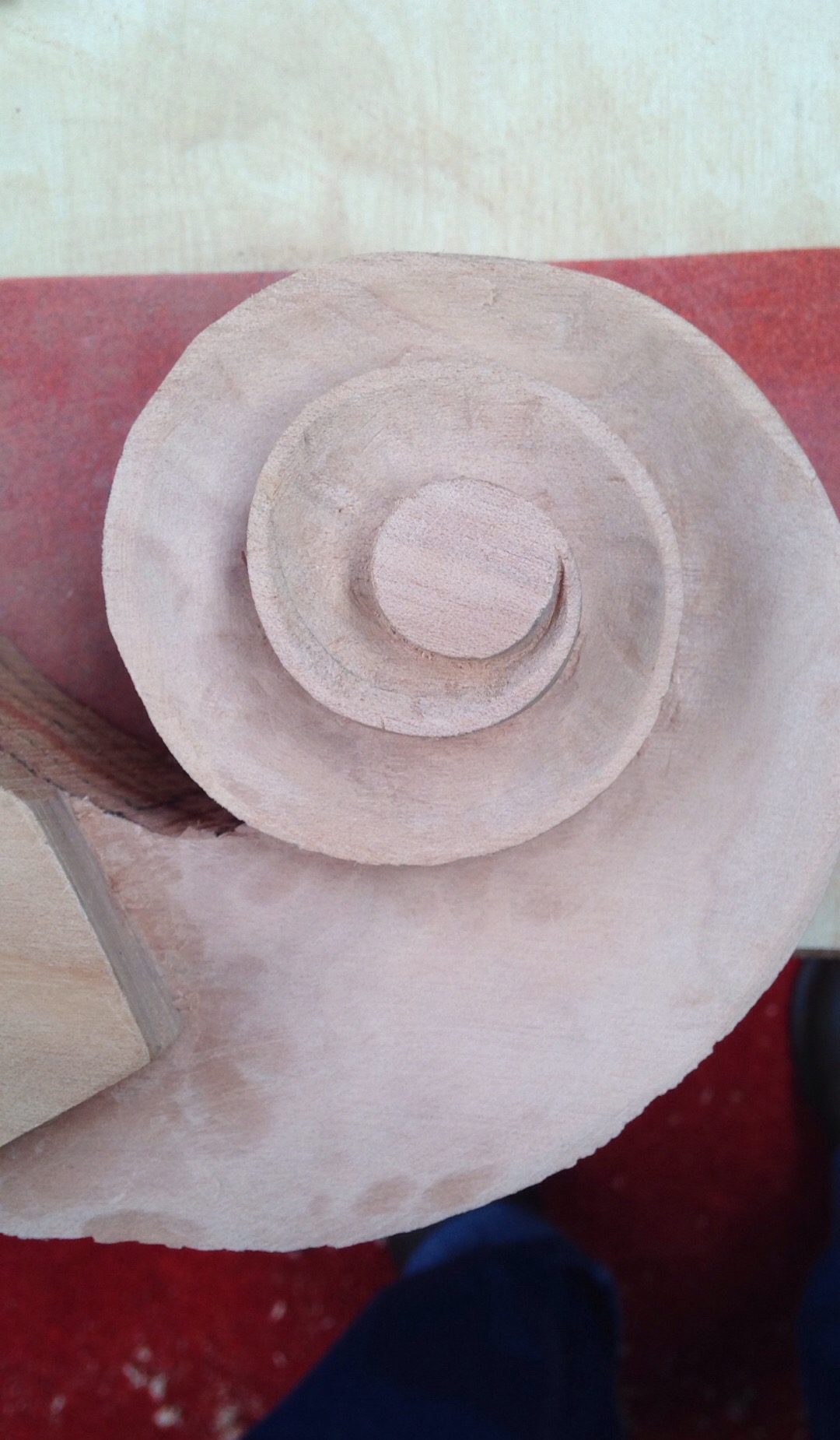

Re: New member new build - carving the scroll

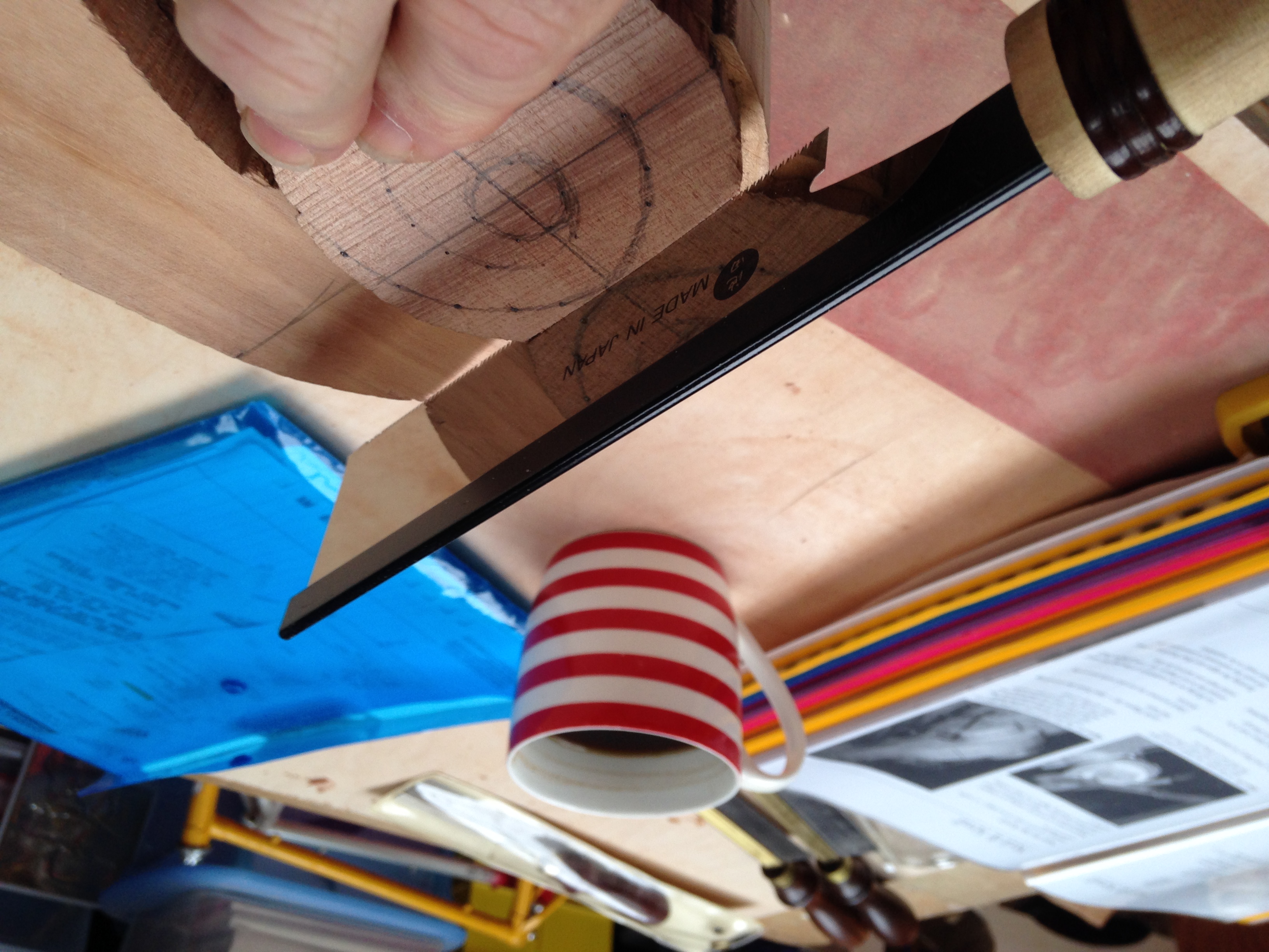

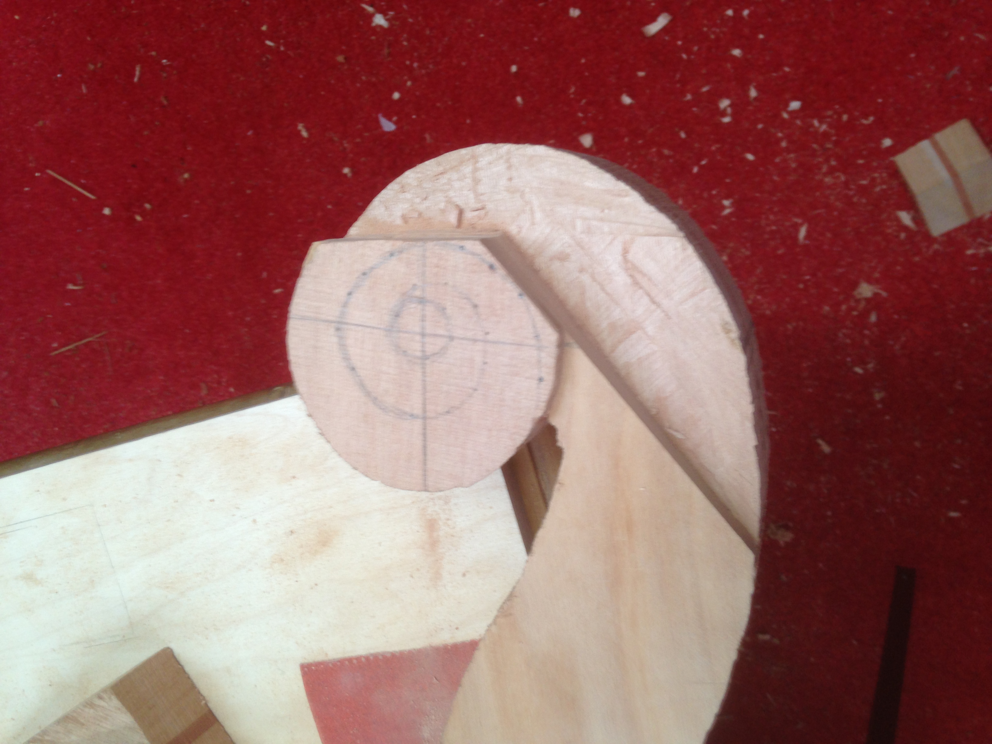

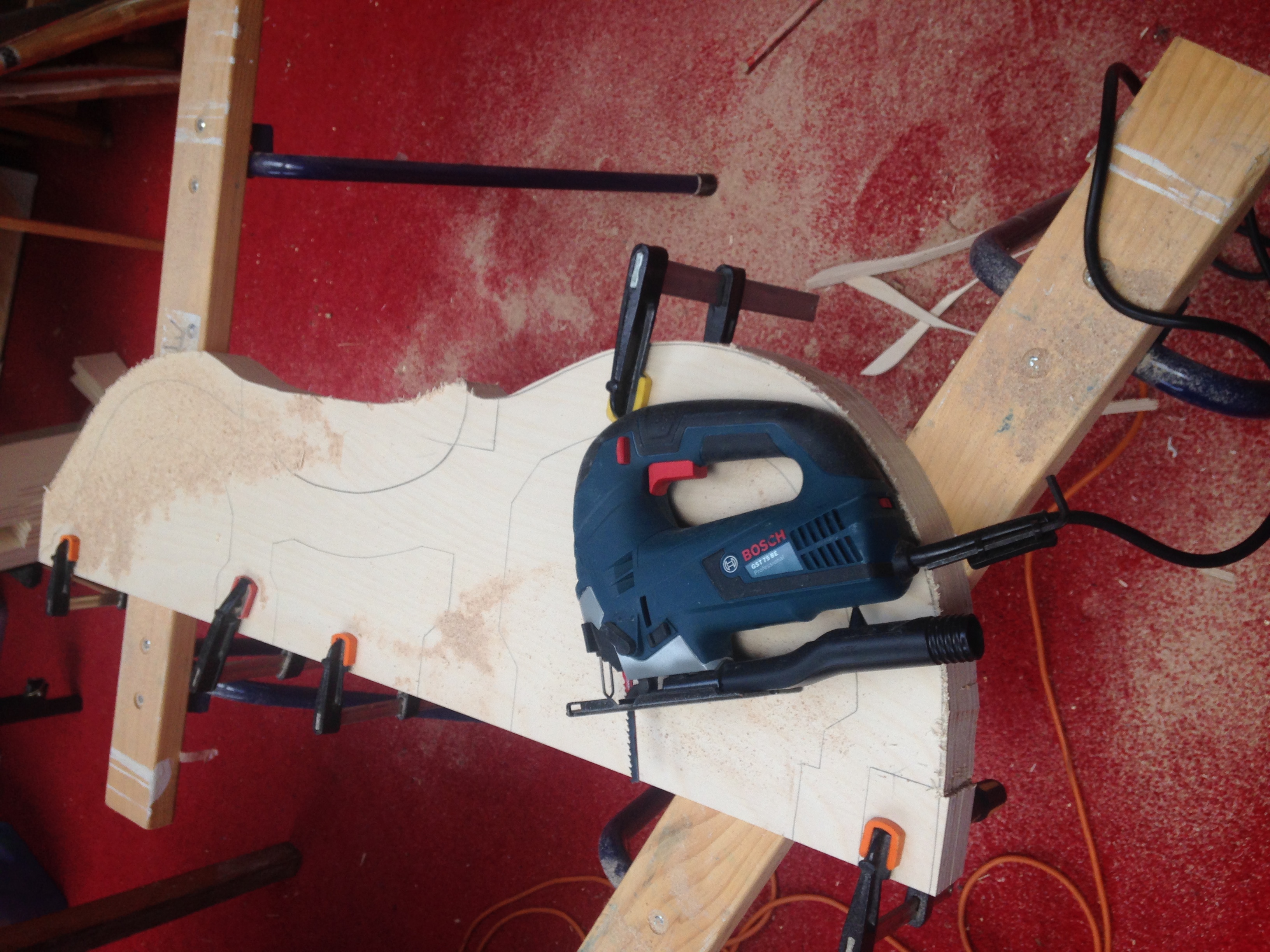

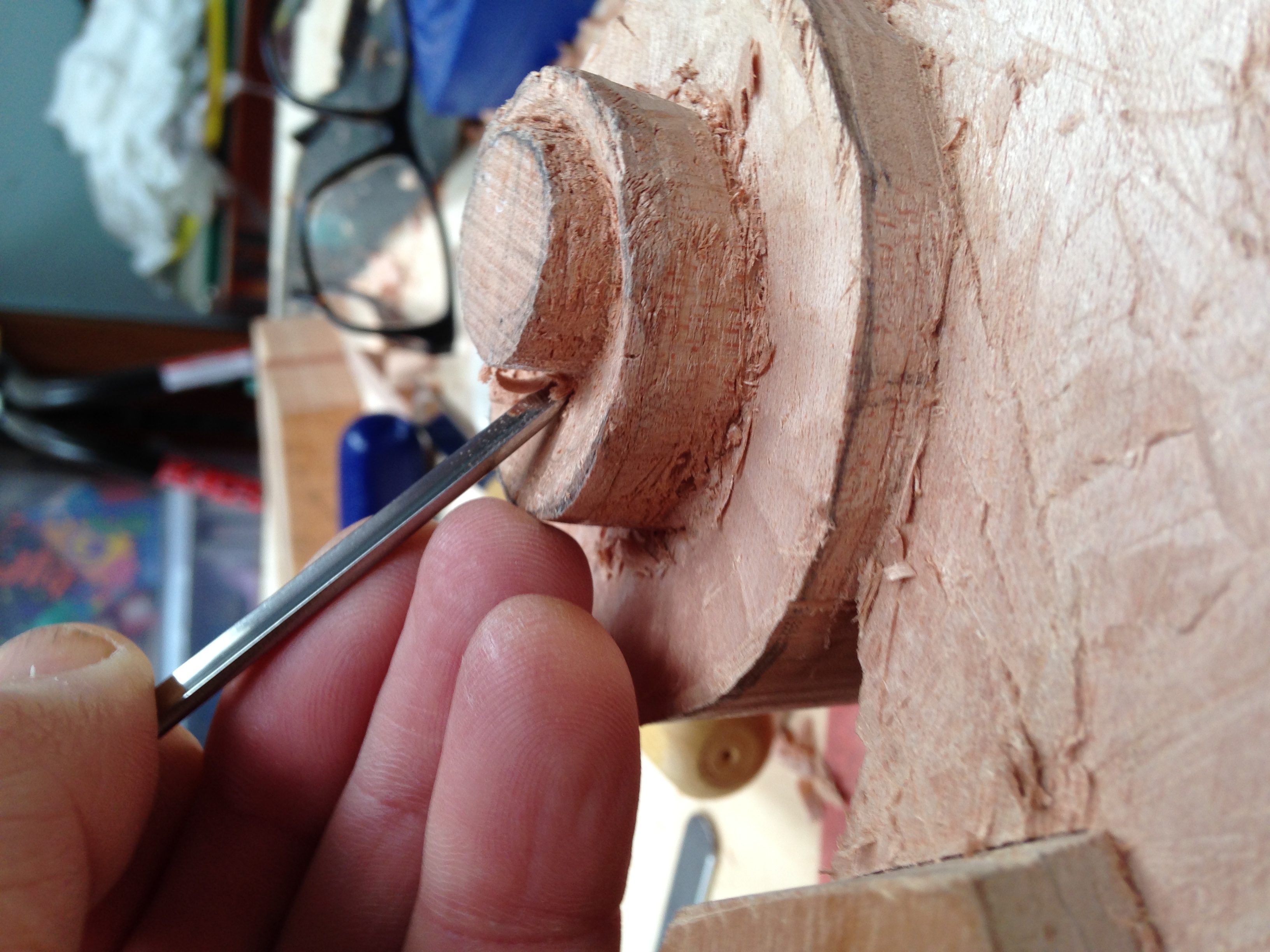

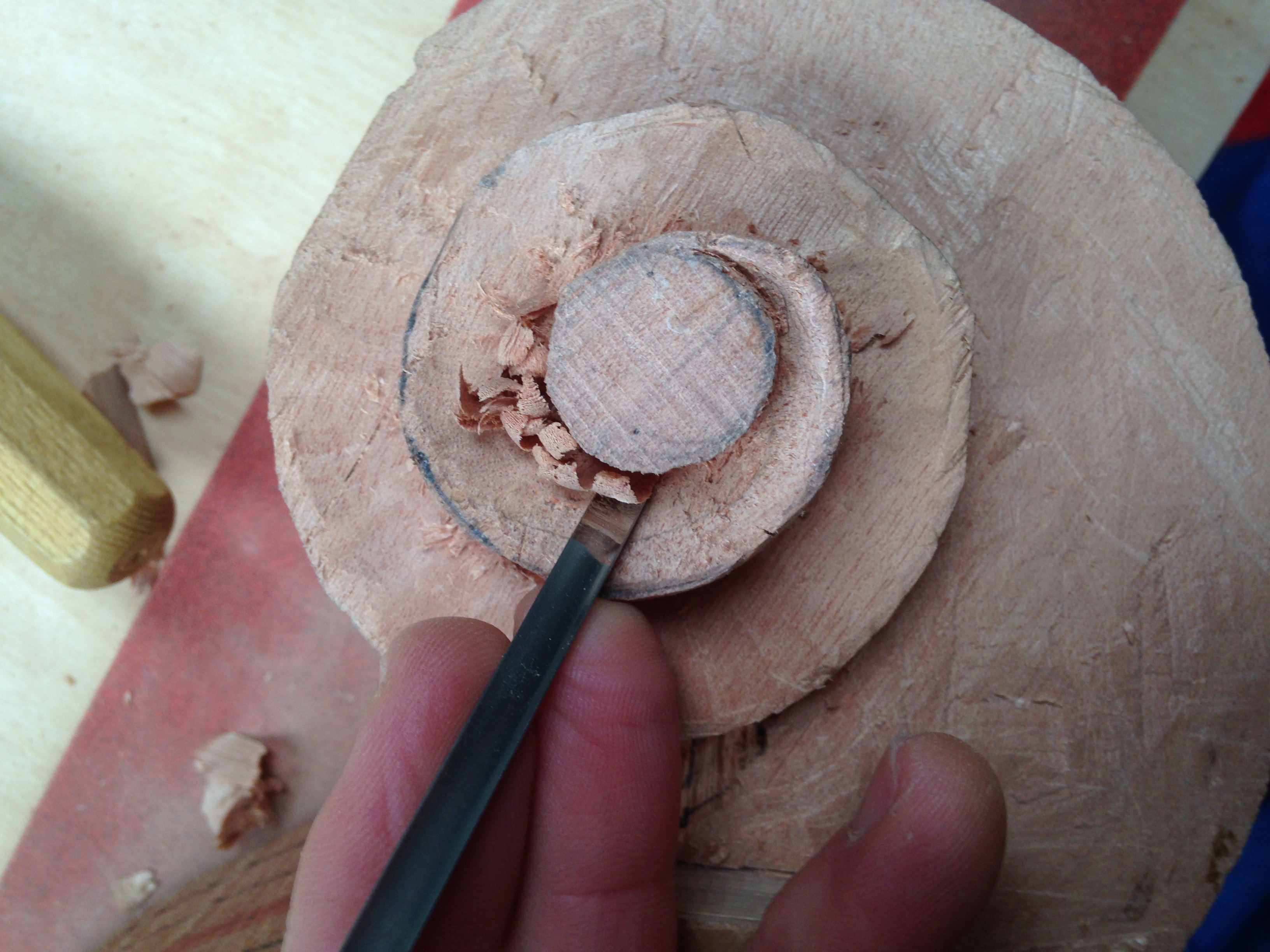

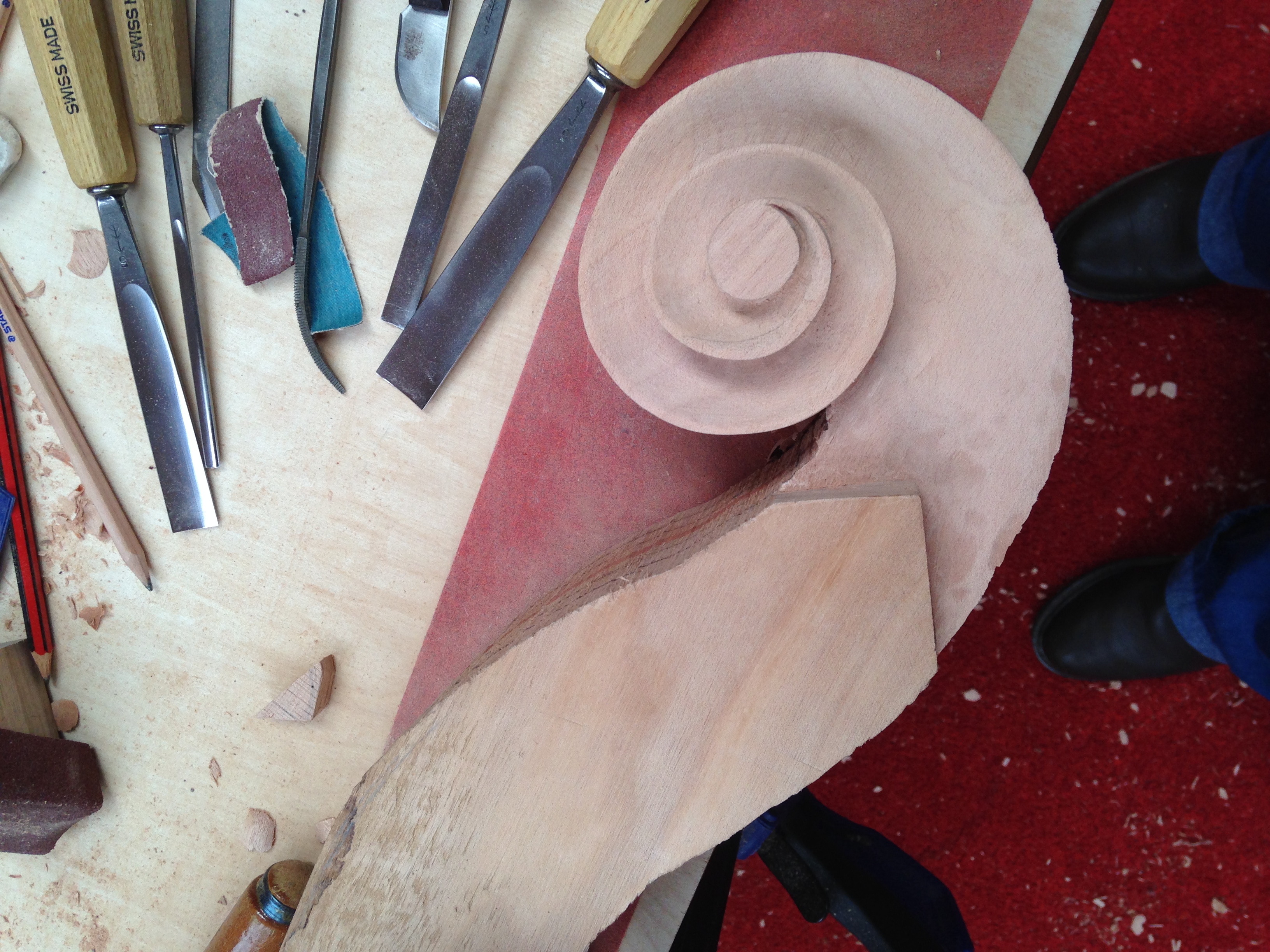

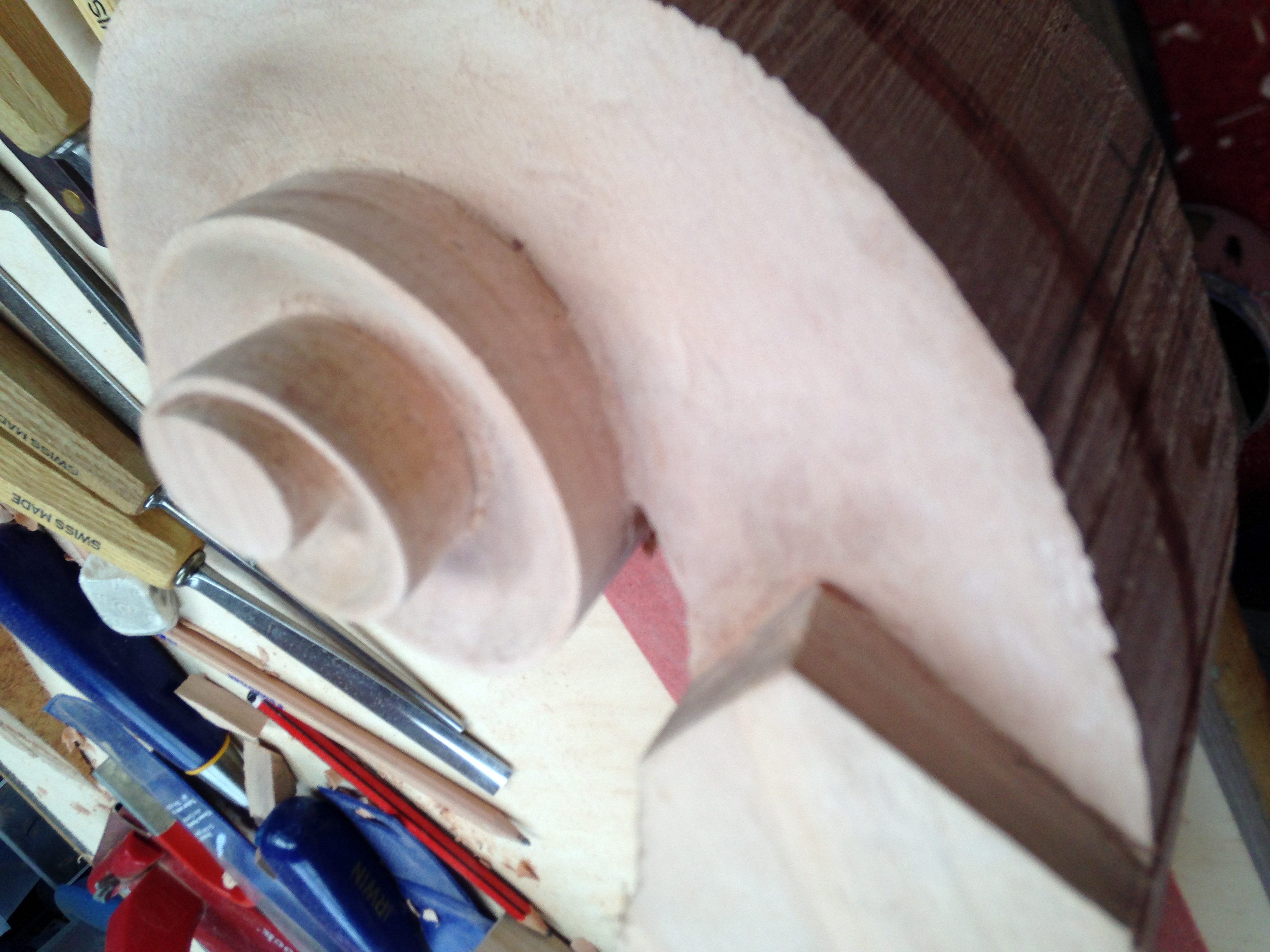

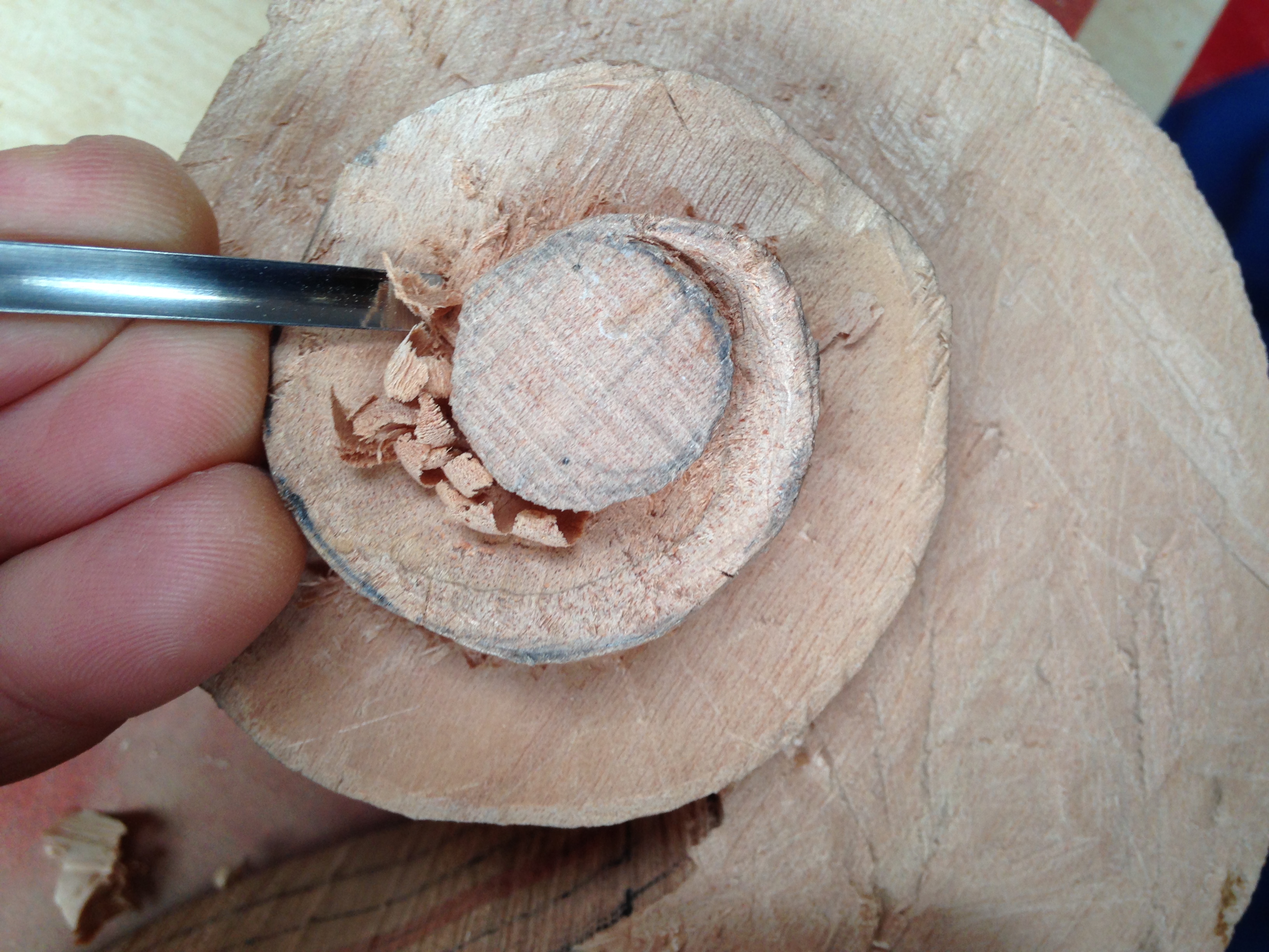

Hi all, it's been a while since I posted as I've been busy running around after family and playing a few gigs on double bass. The double bass build continues slowly and steadily as time and finances permit. Today I've been out in the shed carving my first double bass scroll. So far so good.

Thanks for the detailed documentation of your project.

No worries John, I'm enjoying the journey and everything I'm learning along the way. Can't wait until I'm finally playing a bass I've built.
