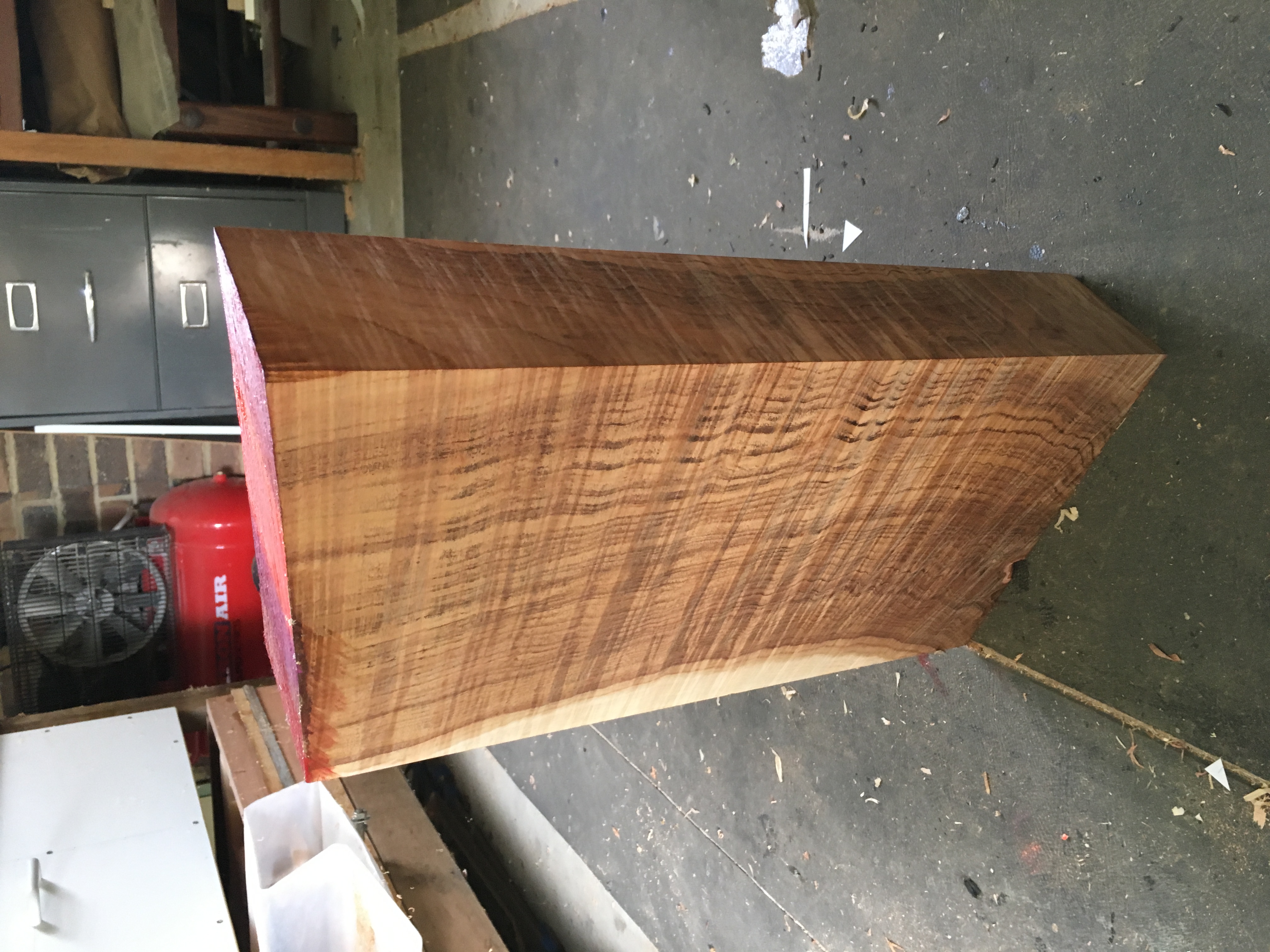

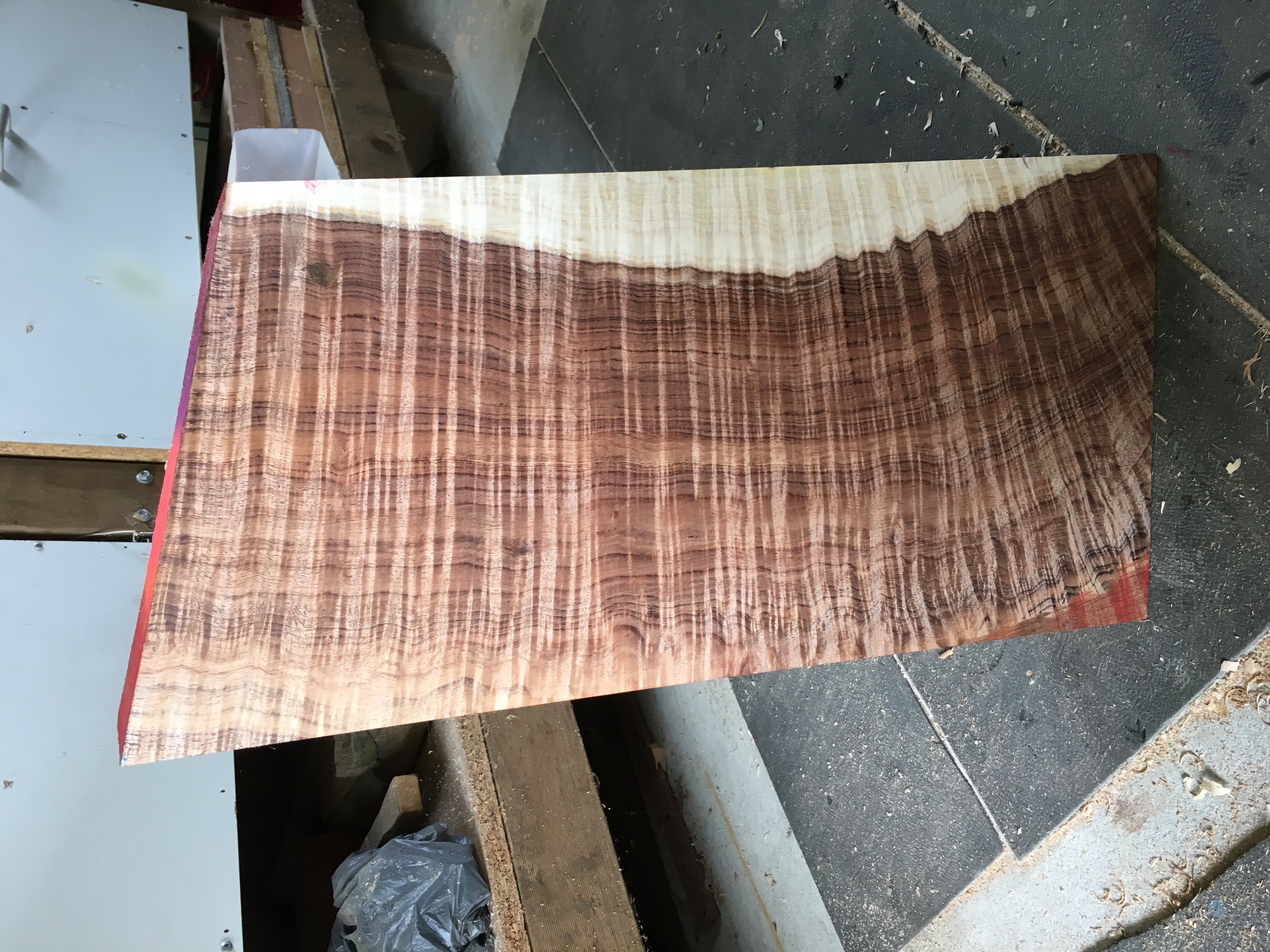

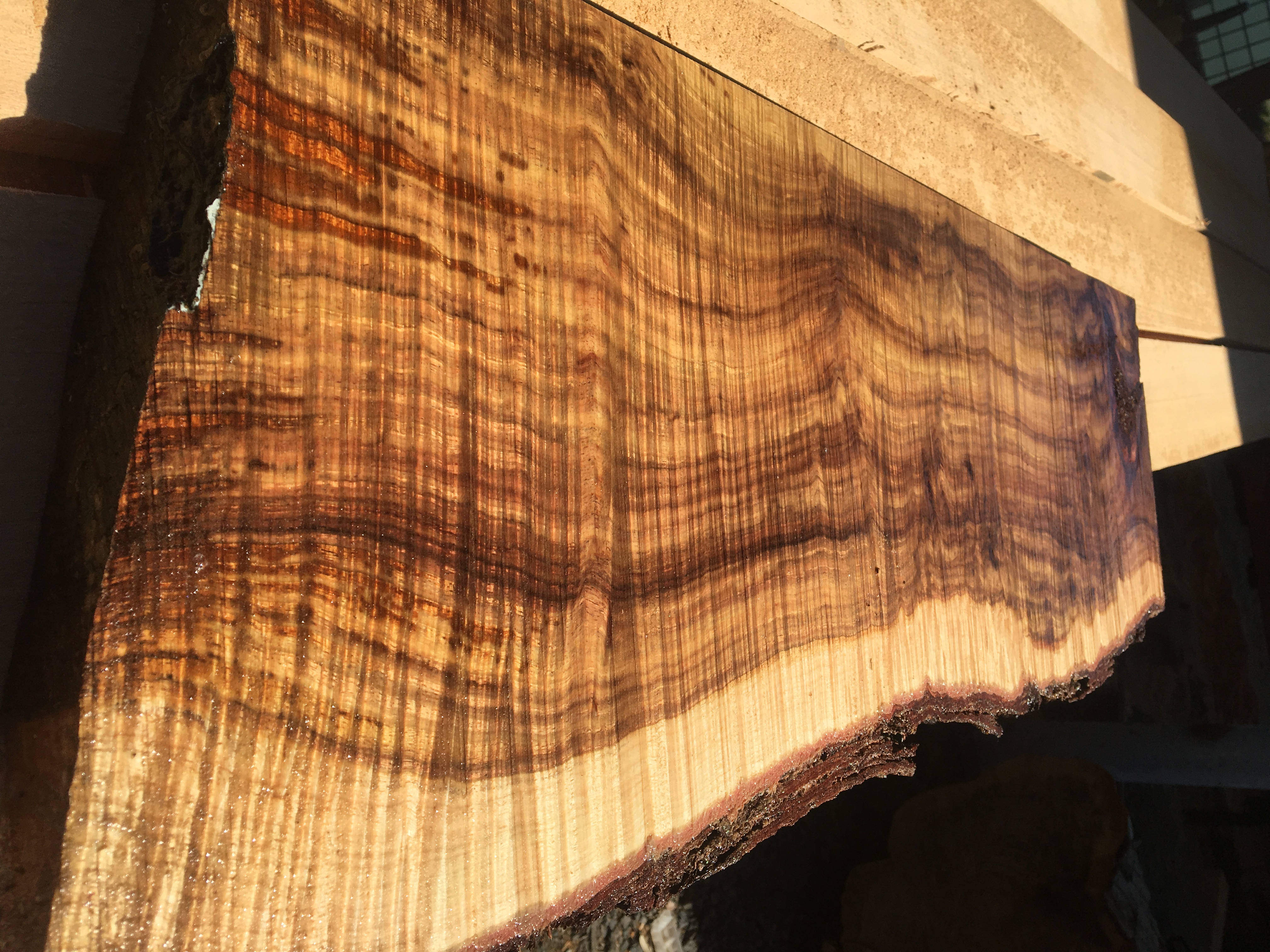

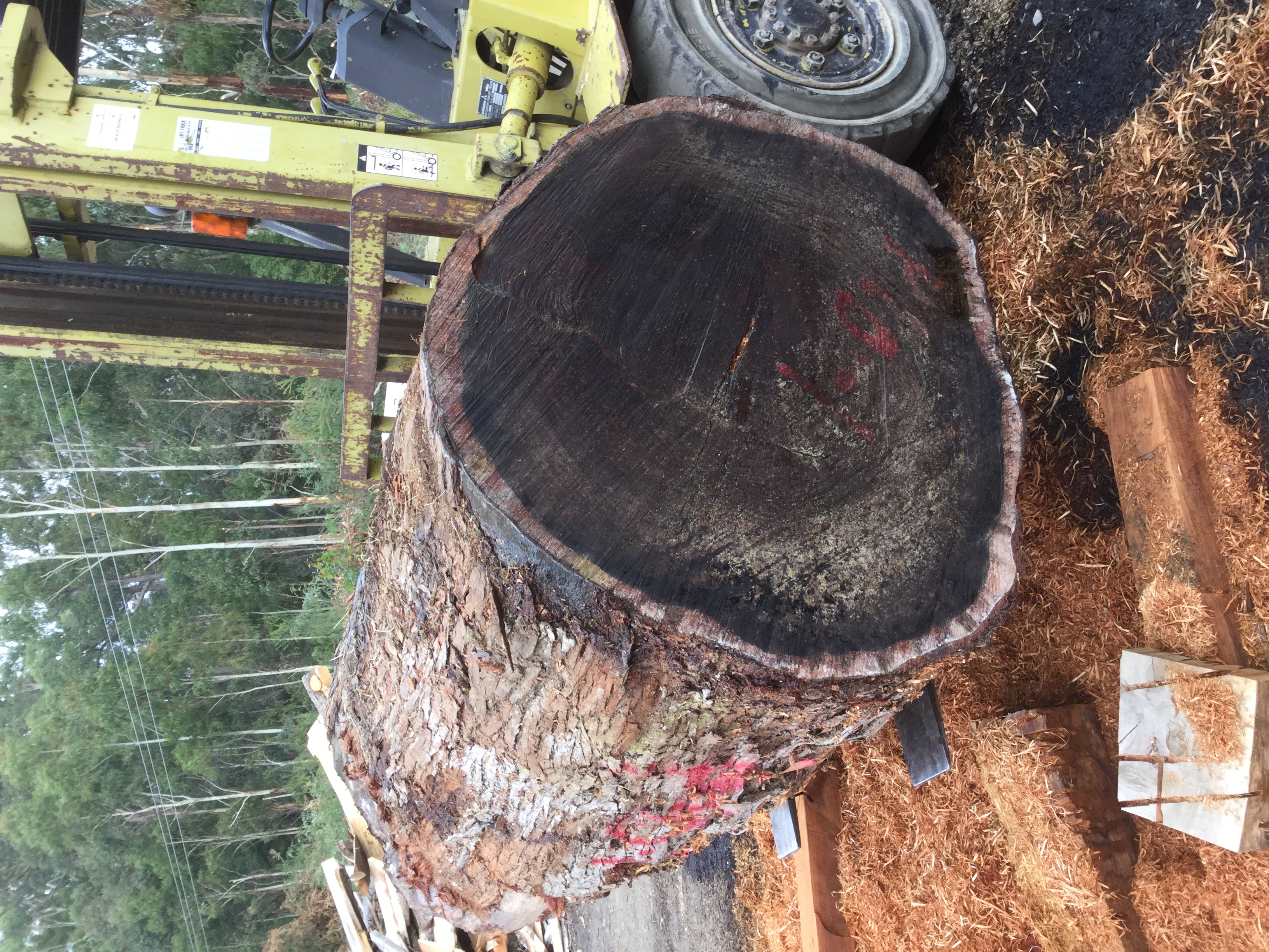

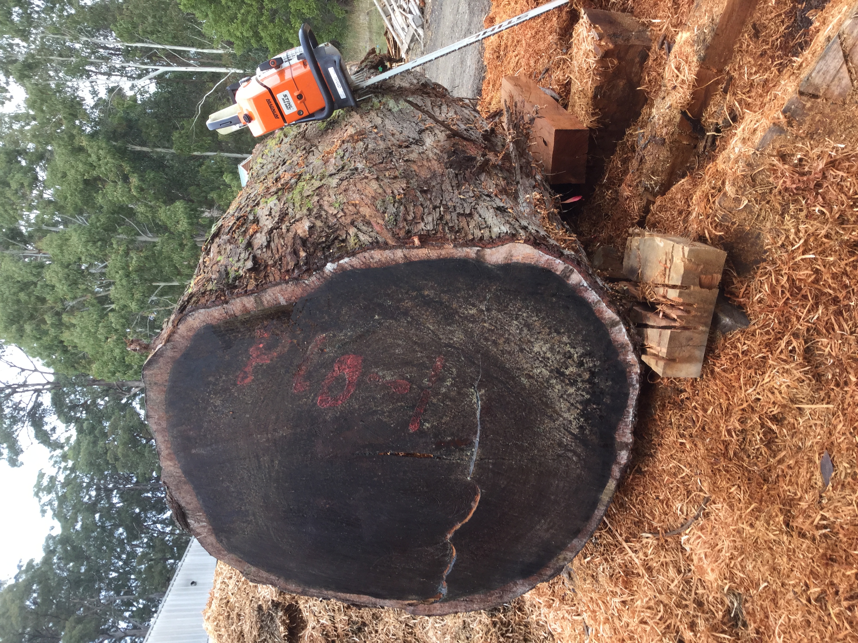

I put this whopping great Blackwood across the mill today , creatively named P10 . I'm Pete and this was the 10 th tree I cut this summer past ( got to 16) .
If only they were all this good , huge , round full of colour and figure . A proper metre diameter and 1900 long in the first Log , 2700 in the second . Then the stump which run out to master fiddle .

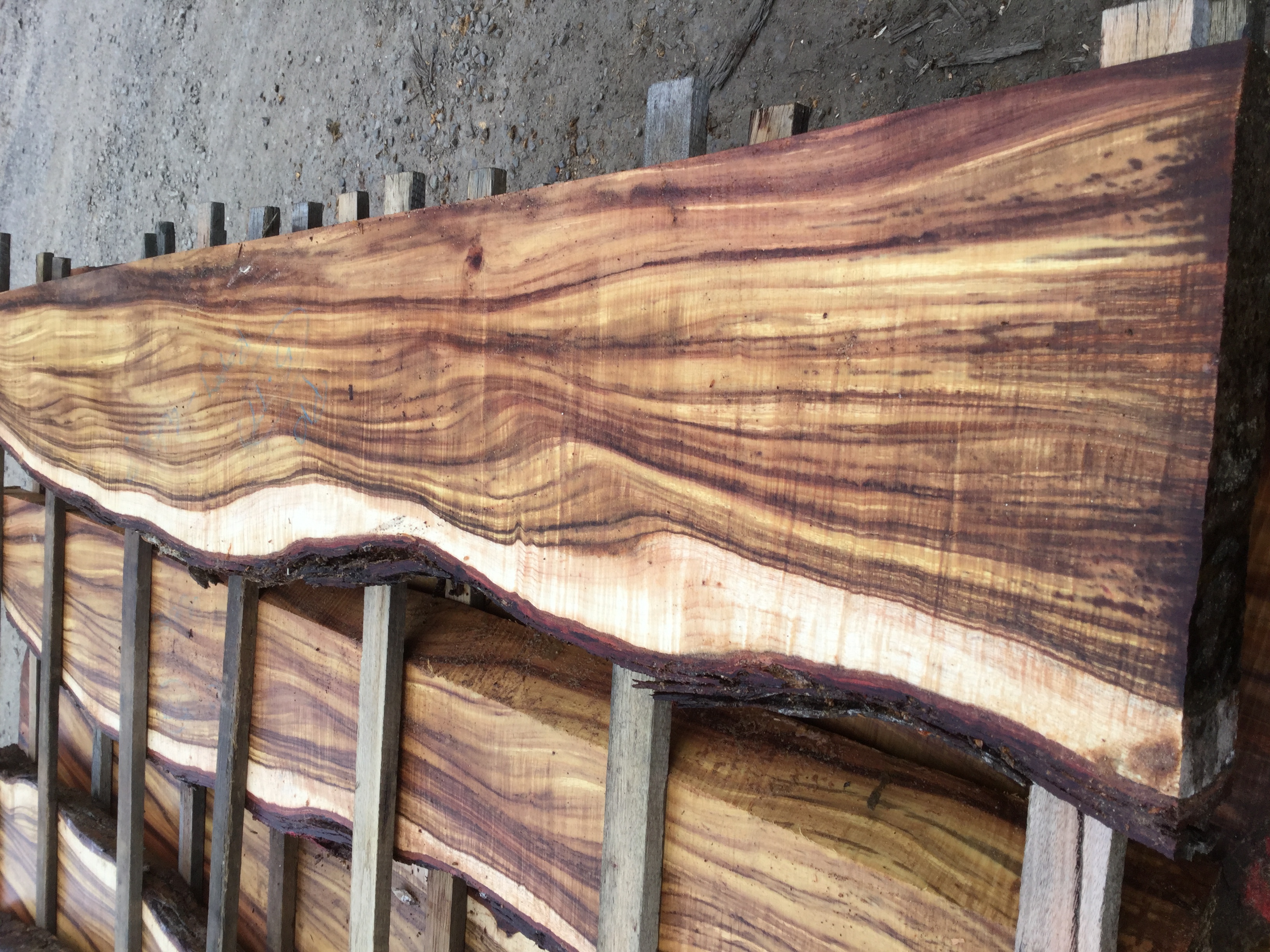

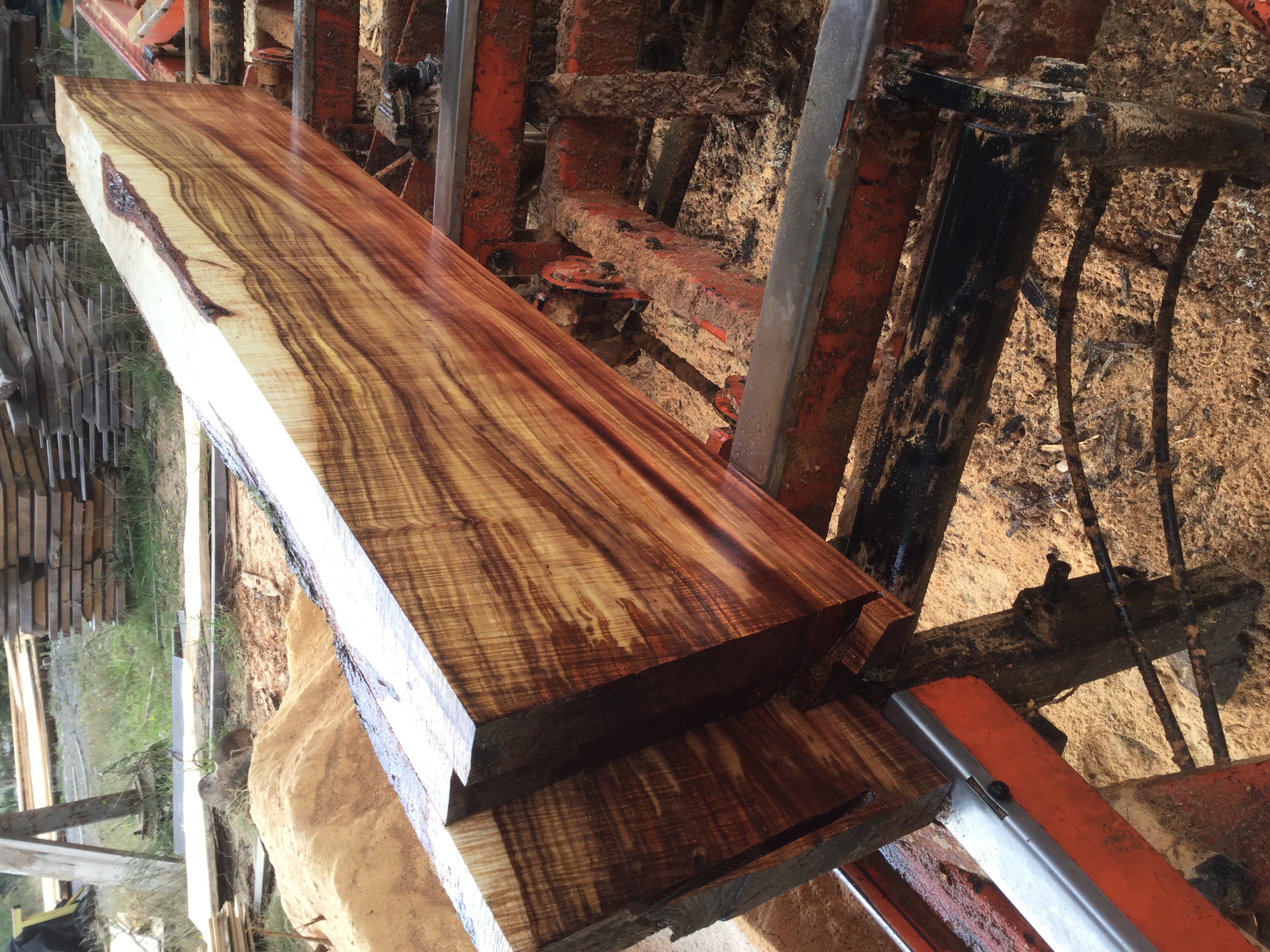

Happy days , in one day i milled a full cubic metre of quarter sawn musical flitches, with some matched boards up to 480 wide on the quarter for cello and double bass backs . As you can see its full op ropey cross washed colour .
No particular reason to share this excepting that I'm chuffed and figured you lot might be interested . Missus certainly wasn't . That's nice dear ......

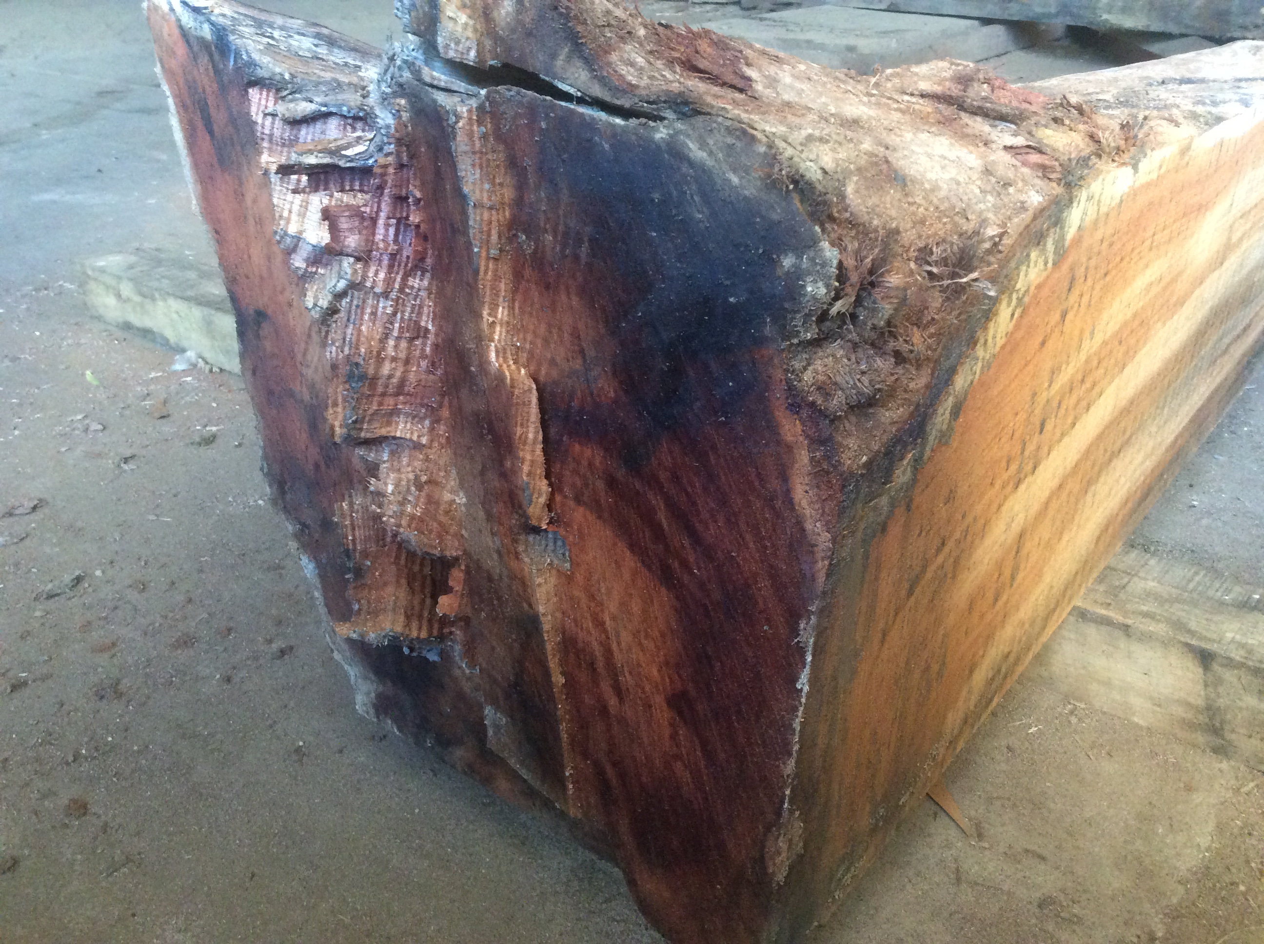

Nice looking stuff Pete, this billet comes from the same region, not ready to use it yet but will yield two archies when I'm ready.

I tend to run Blackwood sawn to 50 or 60 mm on a one year turnaround . It's probably the easiest timber to dry that I deal with , it readily lets its core moisture go without adverse moisture gradients . The year tends to be 9 or 10 months air dry with the remainder in a dehumidifier dry box which is just ambient temperature dried air moved around with fans .
That block is beautiful Rod , that Murray is pretty good !!

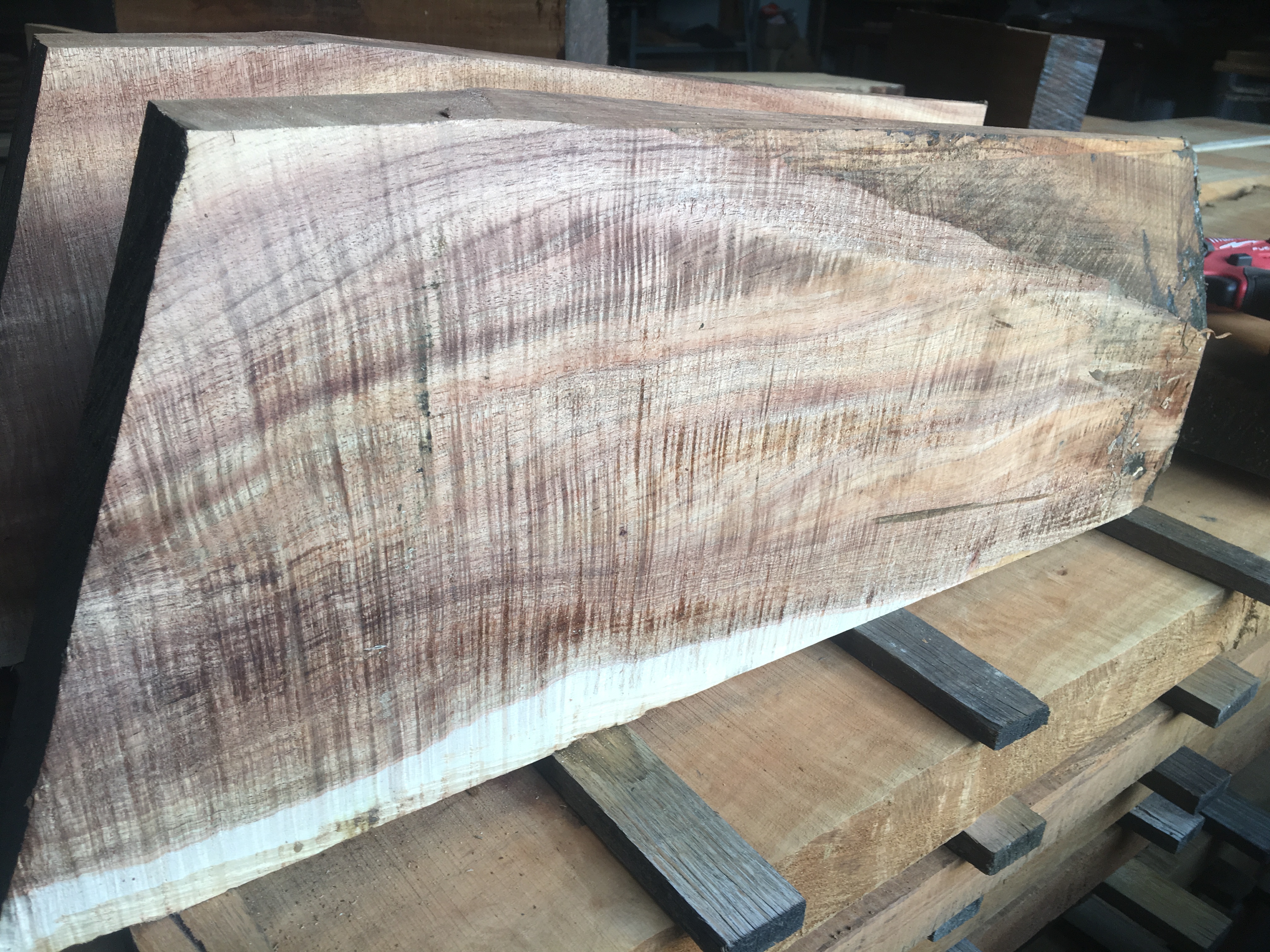

Pete I see you have the boards stacked vertically. Is that the way you dry them rather than in the more traditional stickered stack?

And Dave I flat sticker same as everyone , just popped them on edge to try to photo without the bloody laser light in the shed roof reflecting .

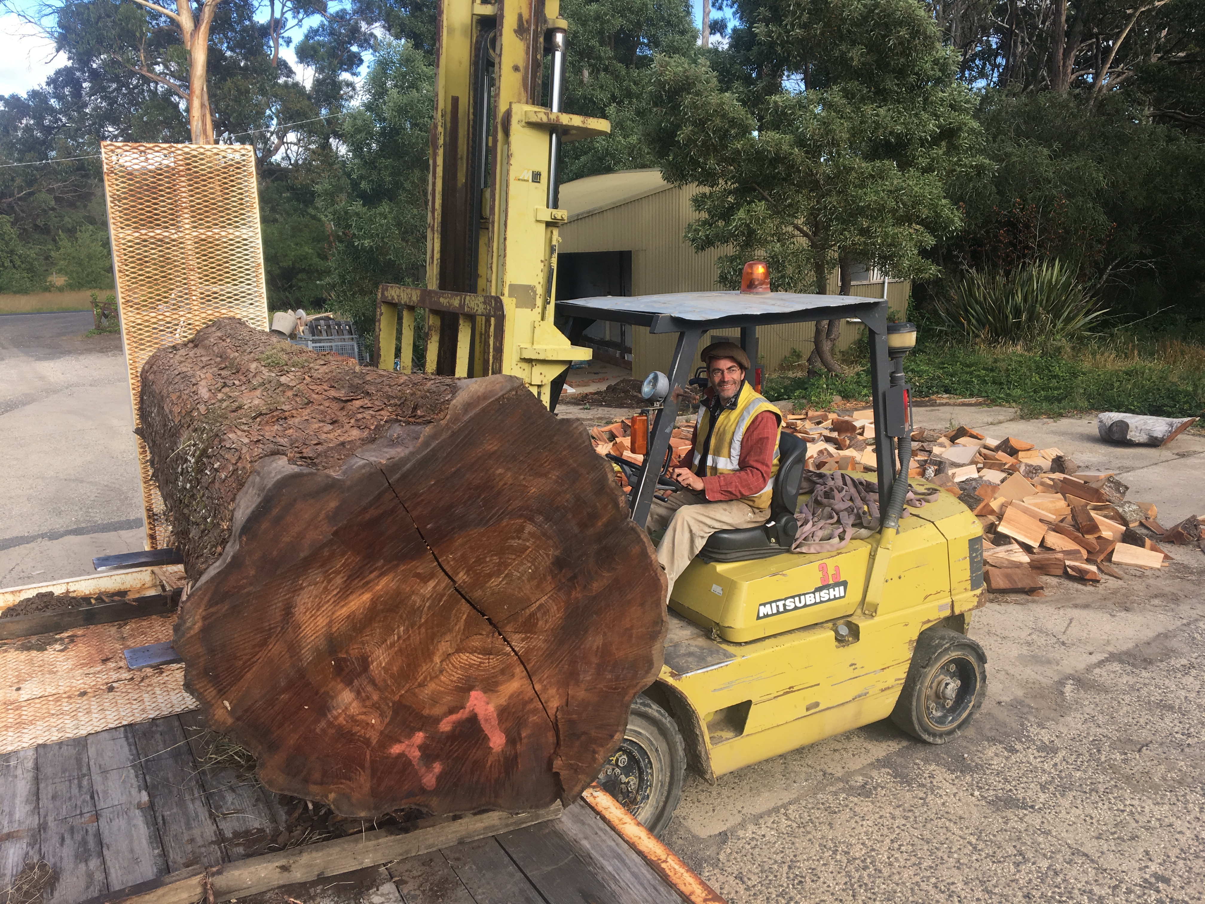

The photos of a workmate with another whopper . The fork that looks tiny is a 3.5 ton machine
