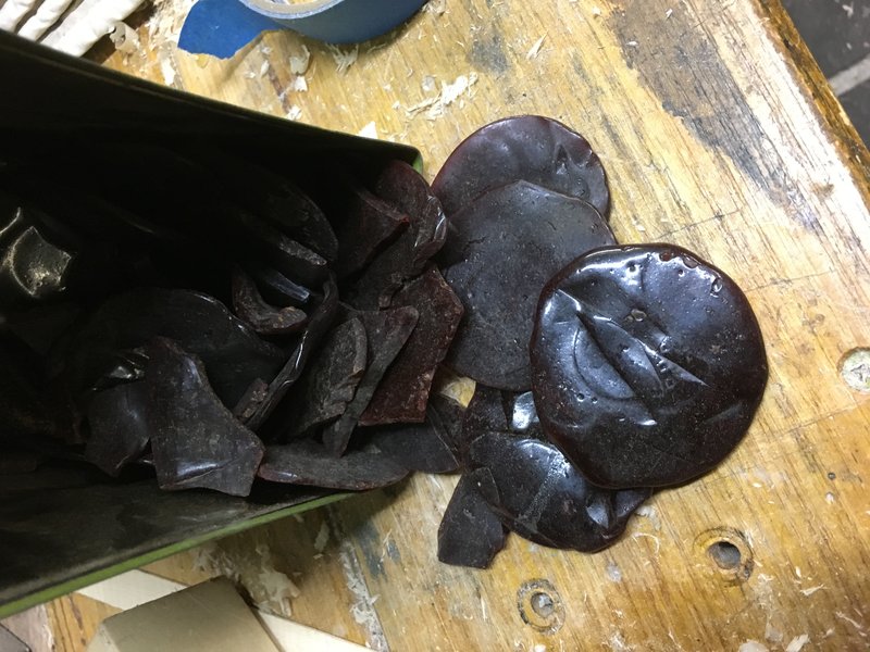

I came across a stash of shellac buttons,dark brown in colour.
Can anyone tell me what if any are the advantages over the flakes? And what is the mix ratio.

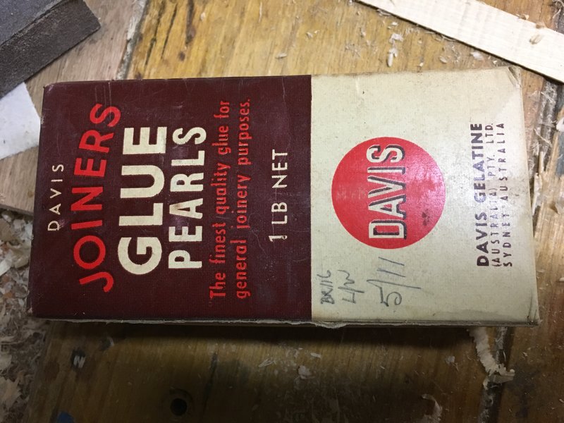

Also some old packets of glue pearls, 5 shillings and eleven pence a packet, I'm guessing this stuff is hhg?

I believe button shellac gets made up same way you'd make up the flakes. It has more wax content than the dewaxed blonde shellac so tends to be more flexible and moisture resistant. The downsides? It's alot darker than most of the flakes so might only suit darker woods.

I used Davis pearl glue in the 80's . It was all you could get back then. Seemed to work ok.

I smash up Button Lac with a hammer and toss it in a spice grinder to beak it up so it will dissolve much quicker. If not it's going to take days to dissolve. It will also have lots of wax in it. You can use it that way, or let it settle out and pour the cleaner shellac off, or filter it out.
That darker color would be used over some blonde shellac to tone the workpiece a richer red. Works a treat on mahogany. Just on it's own would be a bit too much for my taste, and if the timber has pores can make for a really wierd look.
