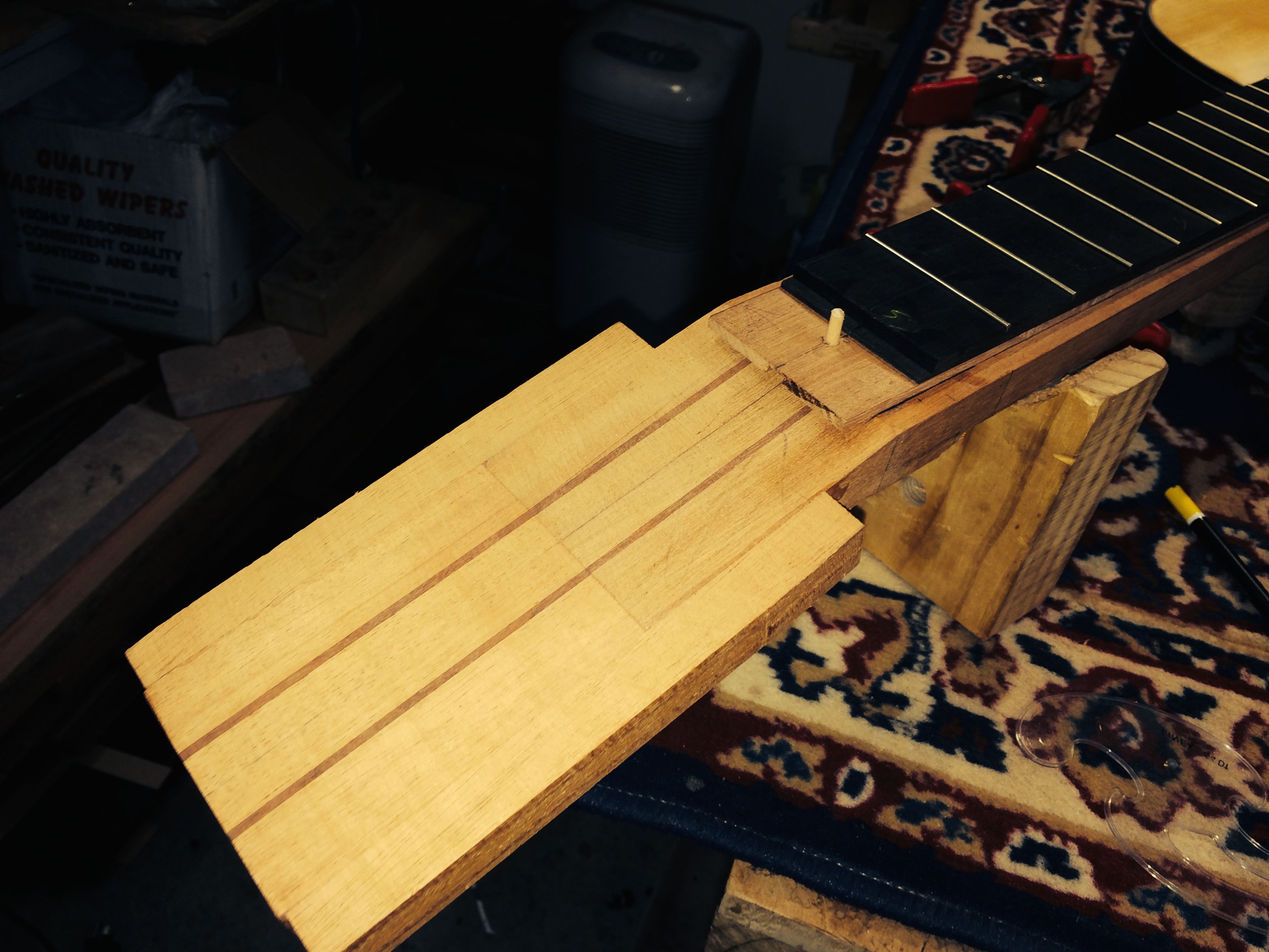

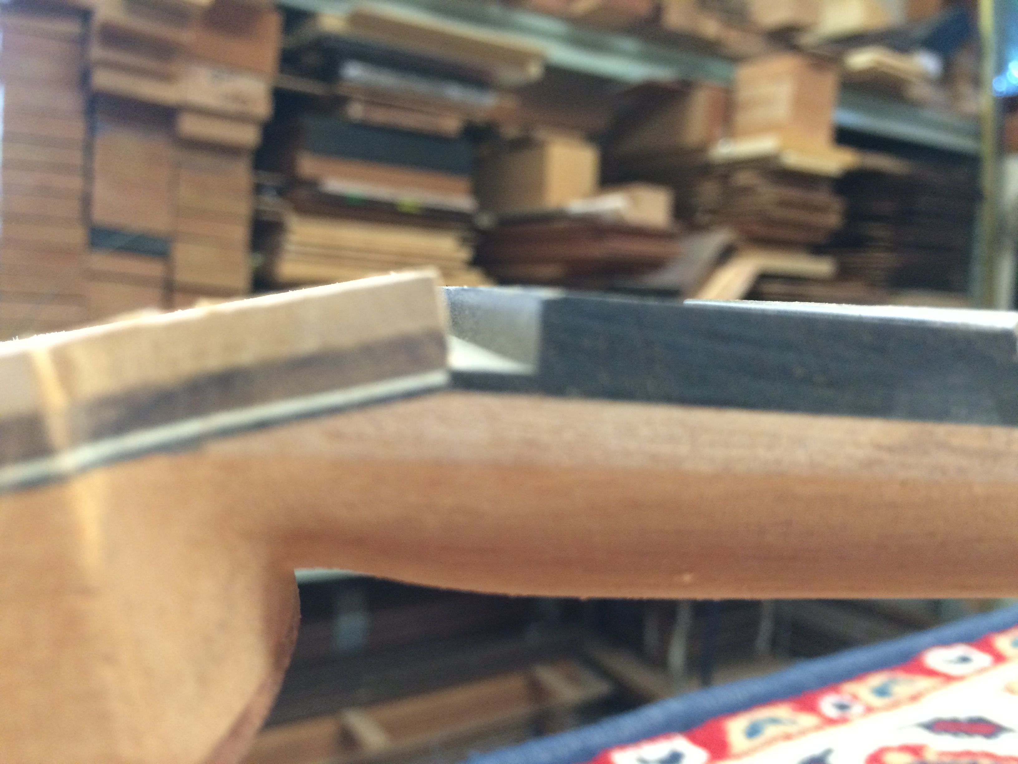

On Trevor's classicals he takes care of the positive neck rake by inserting a long wedge shaped piece of wood between the neck and fretboard (thick end of wedge at headstock). At the headstock end of the neck allowance must be made for the presence of the wedge.
Here's a pic of one of my Gore classicals showing the end of the wedge projecting out from under the fretboard.
In this pic the end of the wedge has been trimmed flush with the face of the headstock before application of the headstock veneers. Ignore the MDF routing template stuck on top of the headstock veneers.

The wedge should work body-wise as the the top follows the neck with a Spanish heel construction. I think the issue will be the length of the neck as it has to take into account the wedge becomes part of the peg board. See Martin's picture. The wedge, nut position, nut width and peg head veneer transition would need to be worked out. A bit difficult when laying out up front.
Yes as I have already veneered the headstock, I should be able to account for this with a higher nut? I am using planetary tuners so had cut my scarf joint at 15 degrees. Presumably the wedge will change the angle of the strings break but is there anything else I should consider?
